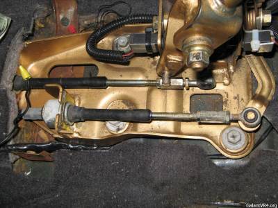

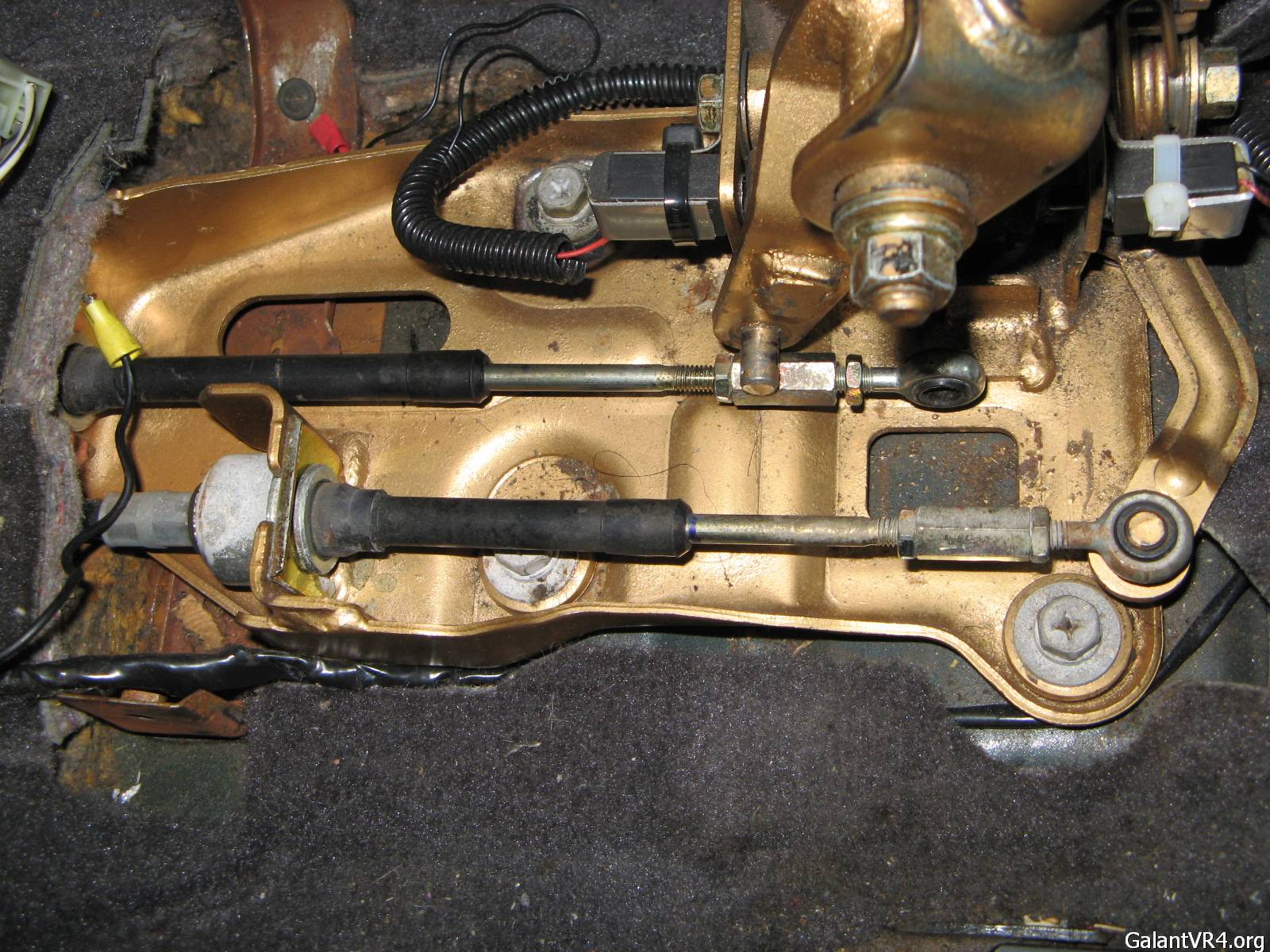

One of the shiter cable end on the tranny did not look to good nice so i changed it but one of the new cable i replace it with did not have the adjustment on the console side
There was no change with the new cables installed

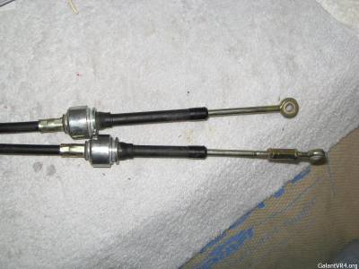

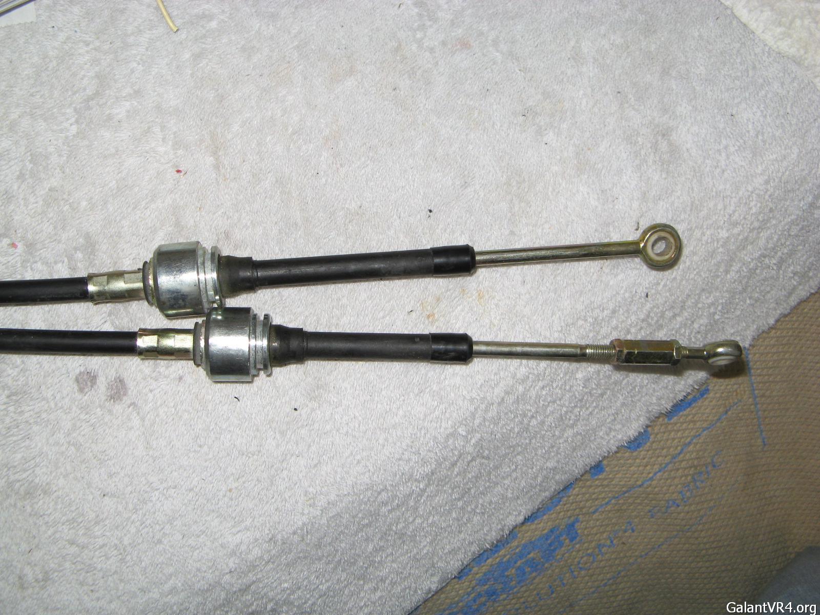

this is the original cable it has two adjustment on it
this is the new one with only one adjustment

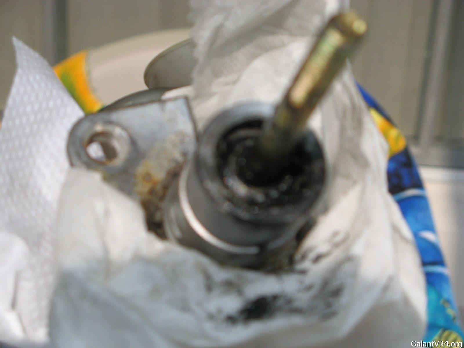

Danville,Pa

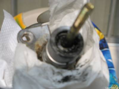

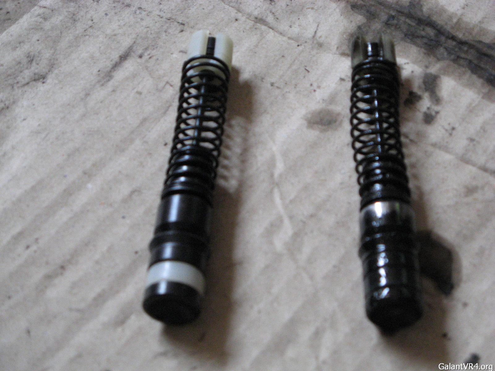

u might need to replace the master cylinder or rebuild it, that happened to me once and took the master cylinder apart and replace the shaft and internals and it fixed the problem and just did the same with my buddies Galant, it wouldnt disengage correctly and it was the master cylinder
boostx
Apr 24, 2003
4,326
Orlando, FL
ok i replace it when i get home
and it does not fix the problem what next /ubbthreads/images/graemlins/bawling.gif

The trans isn't from a '90 is it? If it is, the shift arm on the trans as well as the cable mounting bracket are different. If you use a '90 trans without changing anything, it will barely shift.
