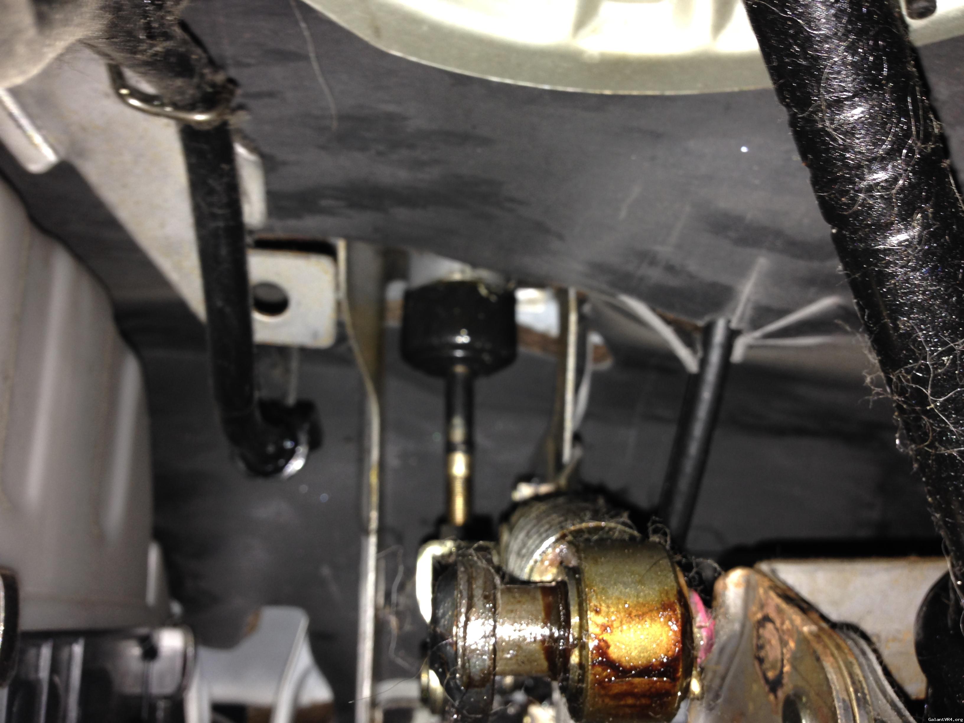

Is the boot wet? It's hard to tell. How much adjustment is left in the push rod?

I didn't have much time to look at it since I was just on my lunch break. I will be adjusting it out when I get home.
Yes, the boot appeared to be wet. I am going to go ahead and get a new Master ASAP. I still have to check out the slave cyl when I get home.
manikbastrd
Nov 19, 2009
660
So I just looked and the Pedal is adjusted all the way out, upon closer inspection I noticed that the clutch master does not appear to be leaking and the slave does not appear to be leaking. The pedal does not feel loose, or anything weird...I am a little more stumped than when i started now...I know that it had a new clutch kit 3K ago, and that 20k ago, it got a new clutch master and slave. I suppose they could have gone out. Any other suggestions from anyone??? Anyone had any experience or good results from any specific product?
