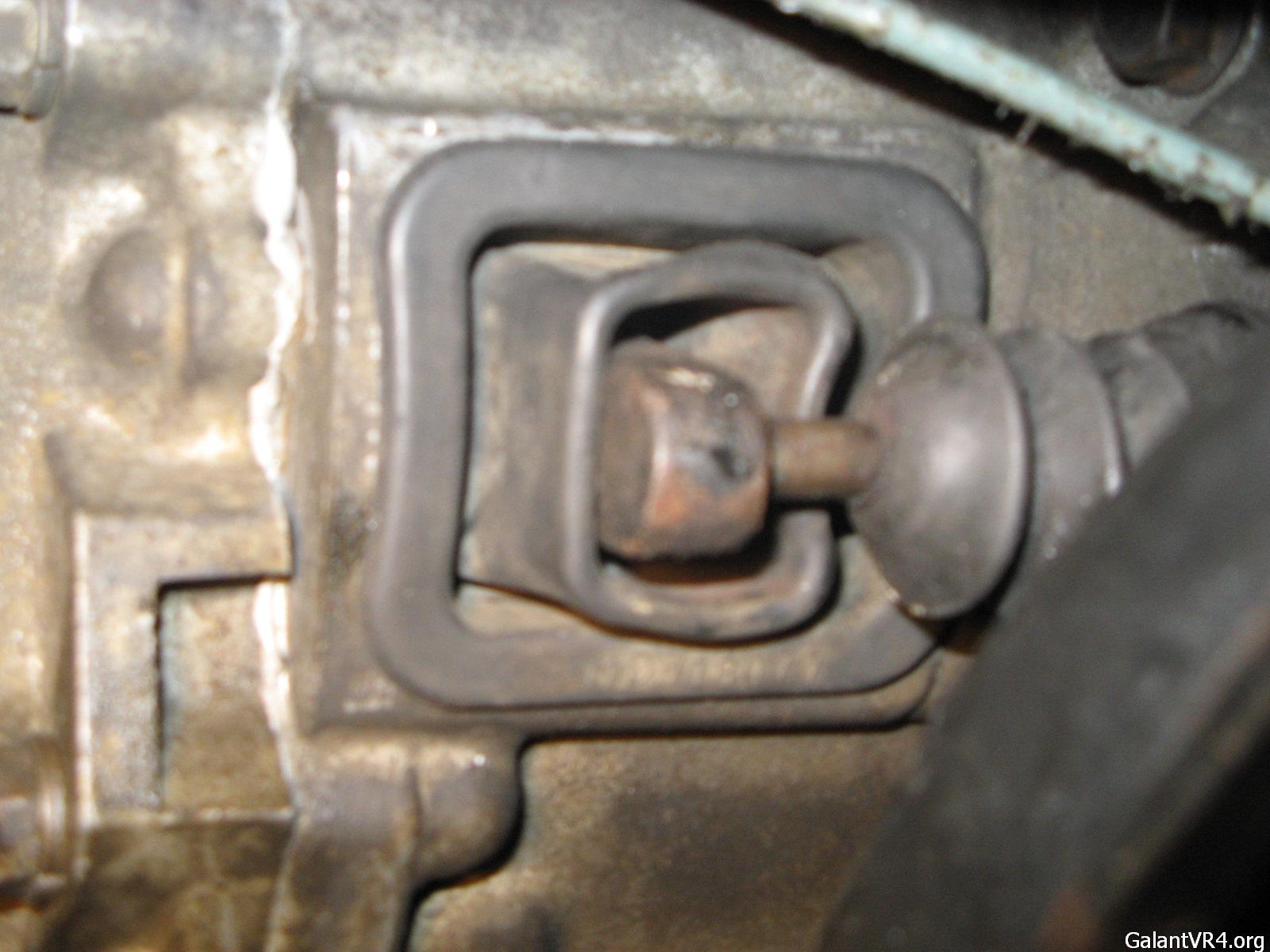

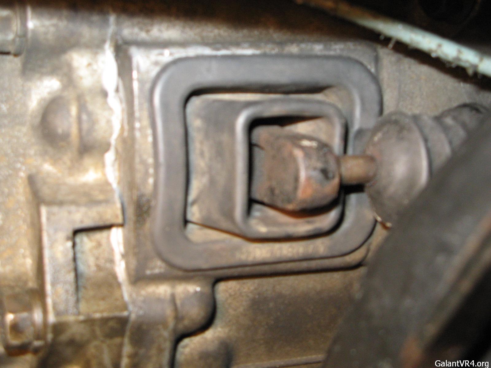

Is this enough movement for clutch engagement and disengagement?
The second picture is with the clutch pedal to the floor

You might need a master and slave. Also you can use a thick or a couple of thin washers behind the pivot ball to help out with the disengagement issue and or an extended rod. I had to install a new master, slave, hard clutch line, 2 washers & an extended rod to make my shift feel stock and disengage fully.
Jason G.
Oct 7, 2003
3,279
Anderson, SC
Those copper crush washers on your turbo oil feed line work good for shimming the pivot ball. I thought I was the only one to swap a tranny then immediately replace a clutch after getting the tranny done. /ubbthreads/images/graemlins/banghead.gif

bent fork?
i just changed one out yesterday, the fork had broken in 1/2
from memory, there should be slightly more movement in distance than the pic..
did the slave bleed okay?

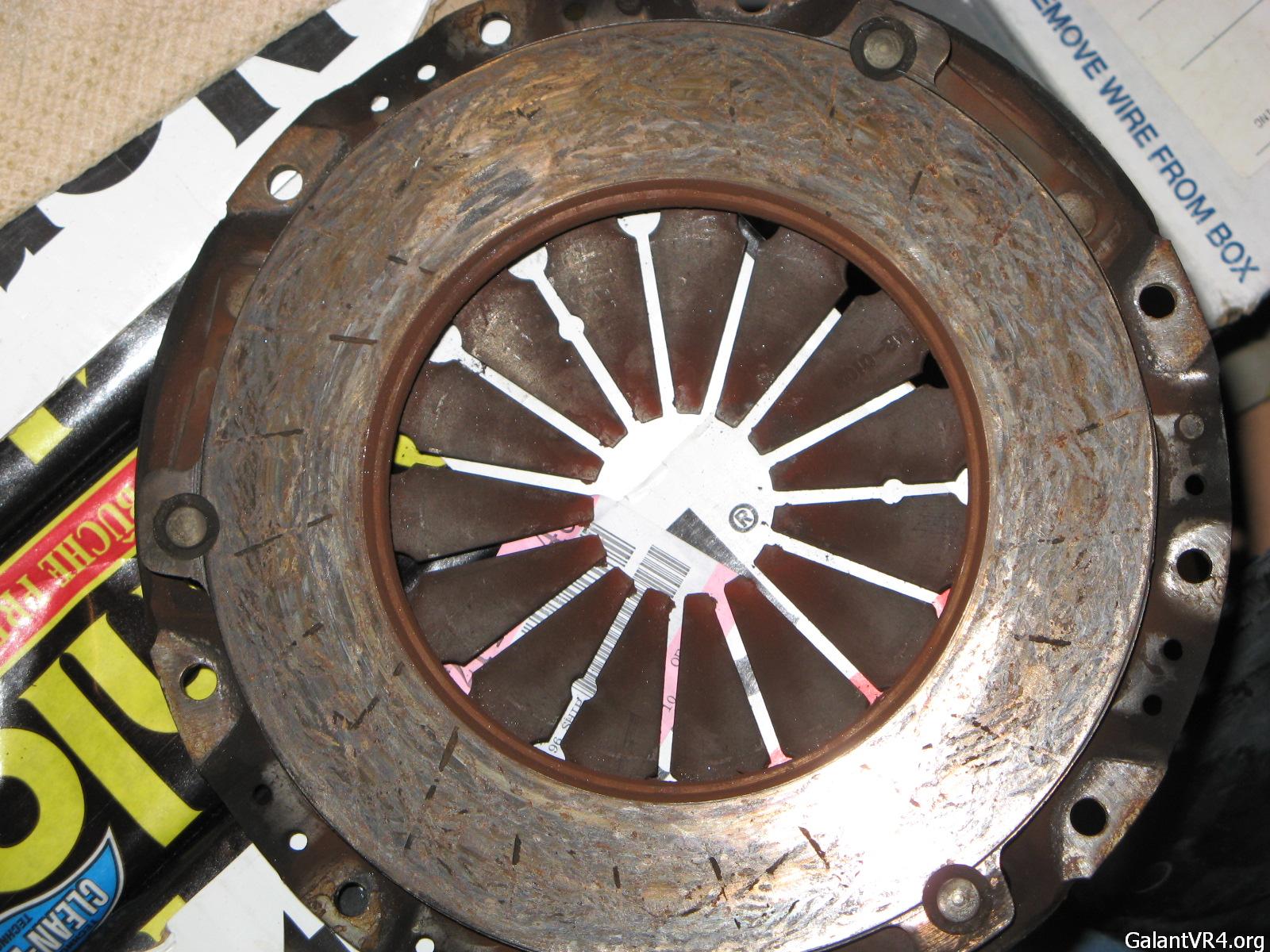

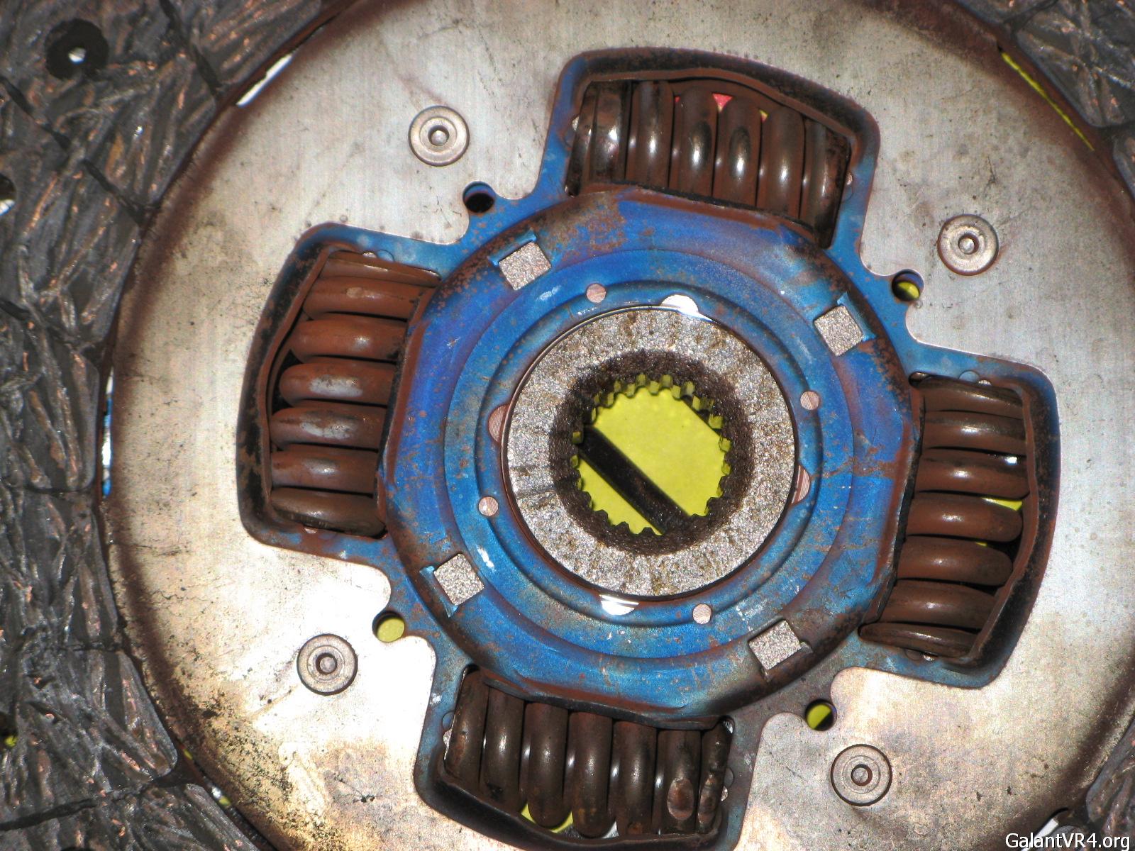

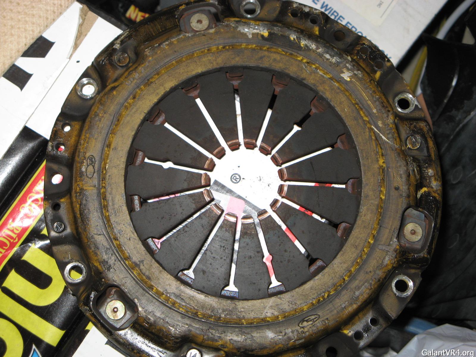

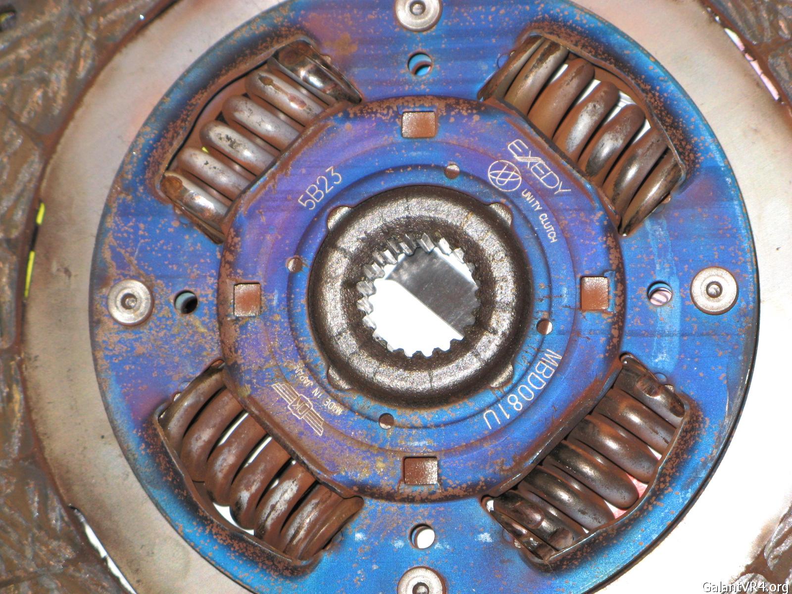

this is what the clutch and the PP look like
In the third pic down- from looking at the PP and the "wear-ring" you have on the tip of the fingers looks like you also may have a bad TB.
CP
Aug 30, 2004
8,940
West Simsbury, CT
...the TOB with the plastic sleeve that wraps around the shaft (easy there Steve...take a deep breath).
