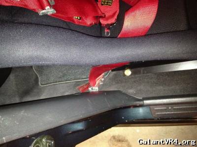

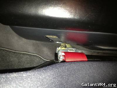

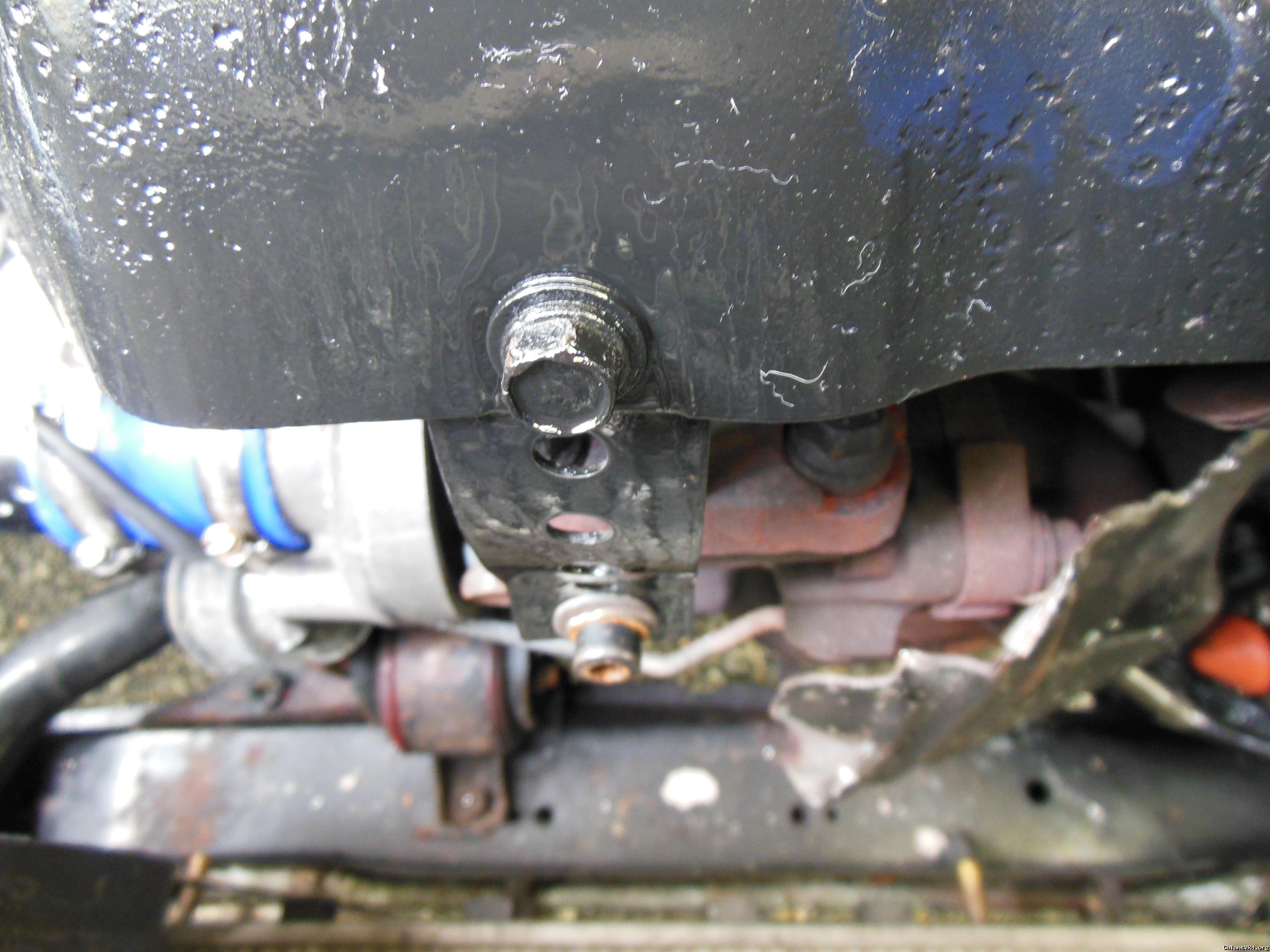

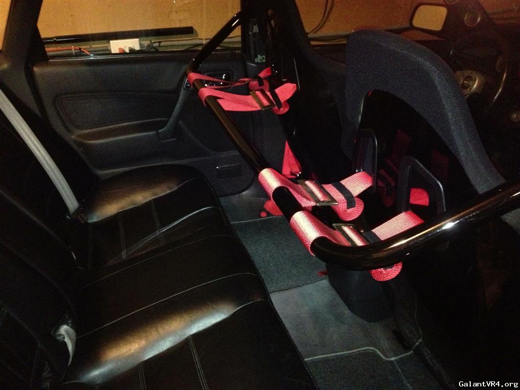

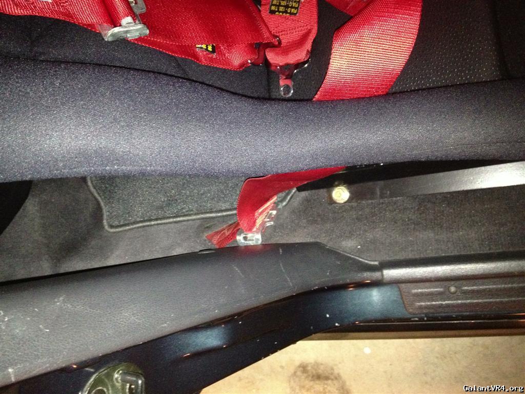

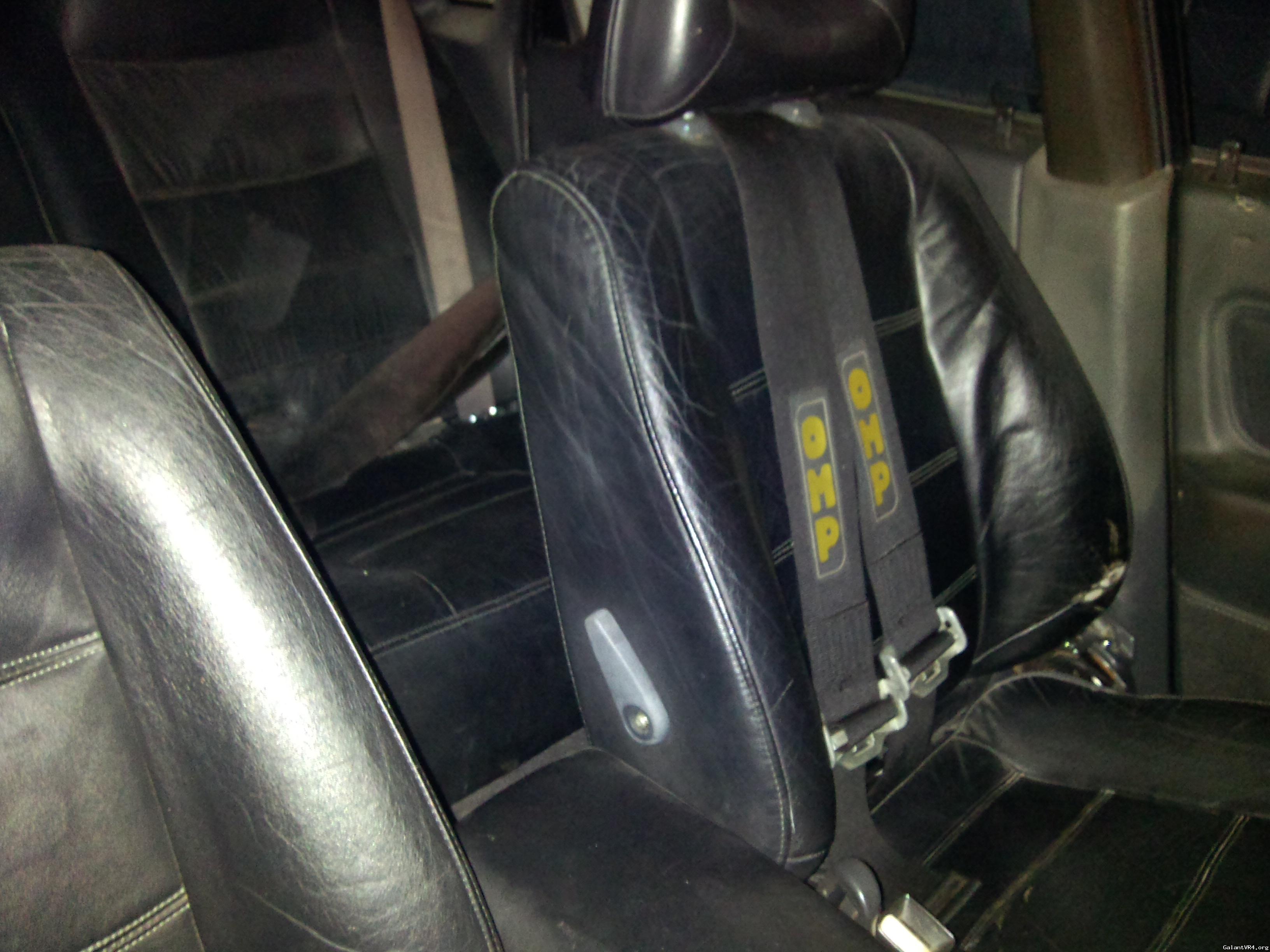

Took a couple quick picks of my OMP belts mounted. Just have to buy the harness bar now.
4Grim
Sep 30, 2004
2,522
Orlando FL
Mount them where the stock lap belts bolt up to. I just need to buy the eyebolts to hook them up.
11,993

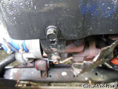

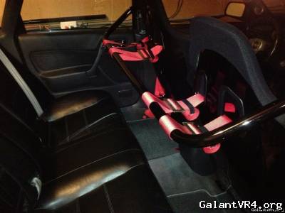

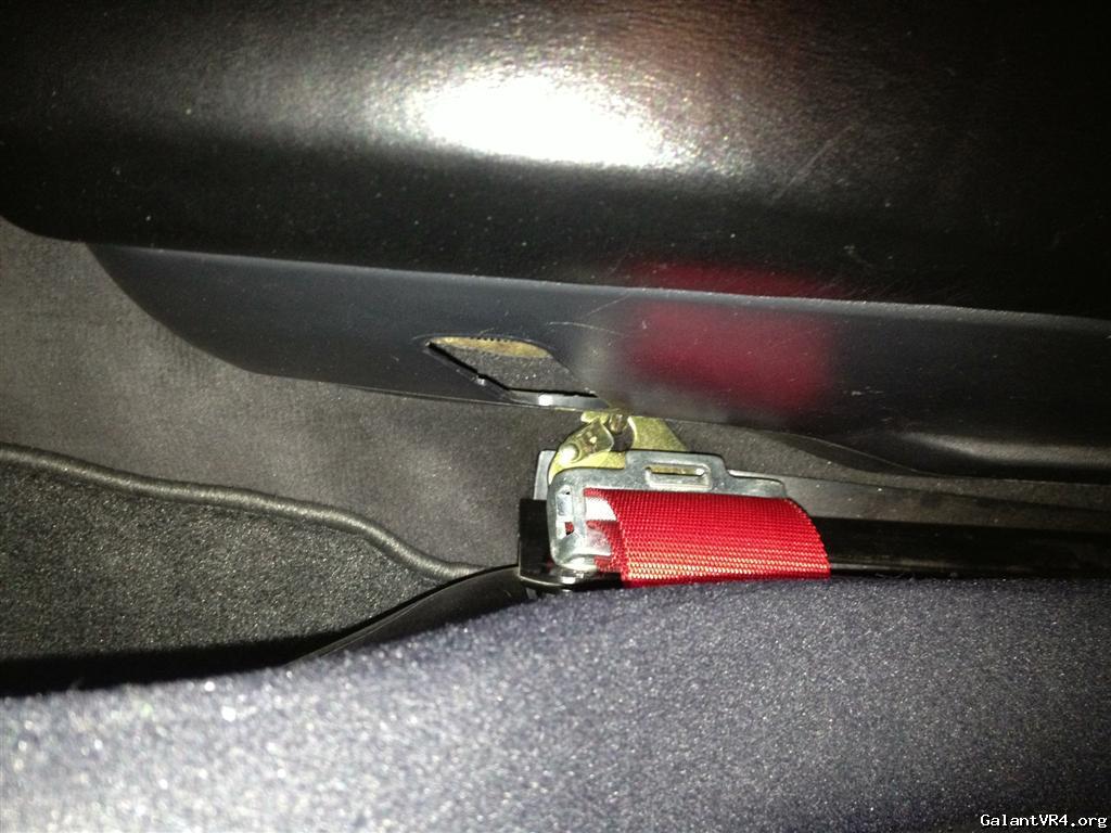

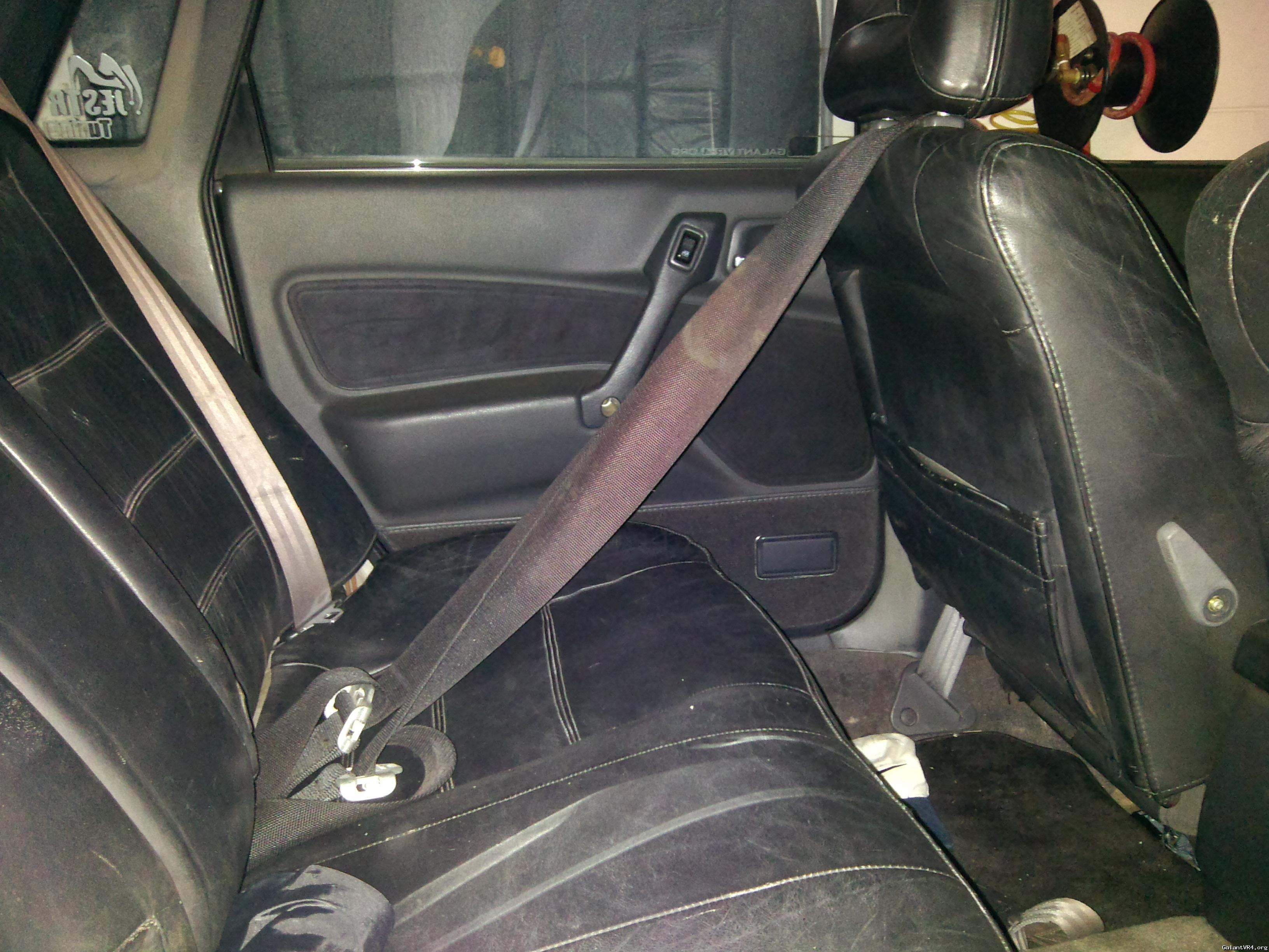

These pics show how I mounted to the harness bar. To mount shoulder harnesses and lap belts to the stock seatbelt anchors you need these.
transparentdsm
Jul 27, 2011
3,690
Cherry Hill, NJ
ok sweet, my harnesses already have the clip part so i just need to buy the eyebolts. is that the harness bar from number3? i really like it alot, how is it for passangers in the back seat though? i wont have people in there often, but from time to time there will be people back there.
11,993
It's like a roller coaster seat for people in the back. /ubbthreads/images/graemlins/rofl.gif But yeah, that's one of the bars that Harry made.

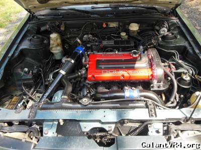

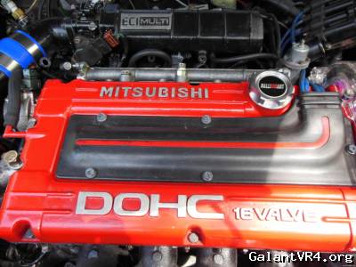

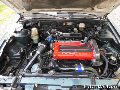

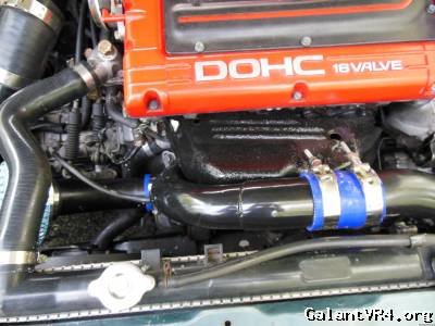

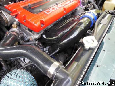

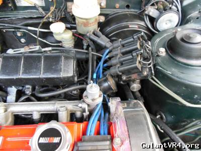

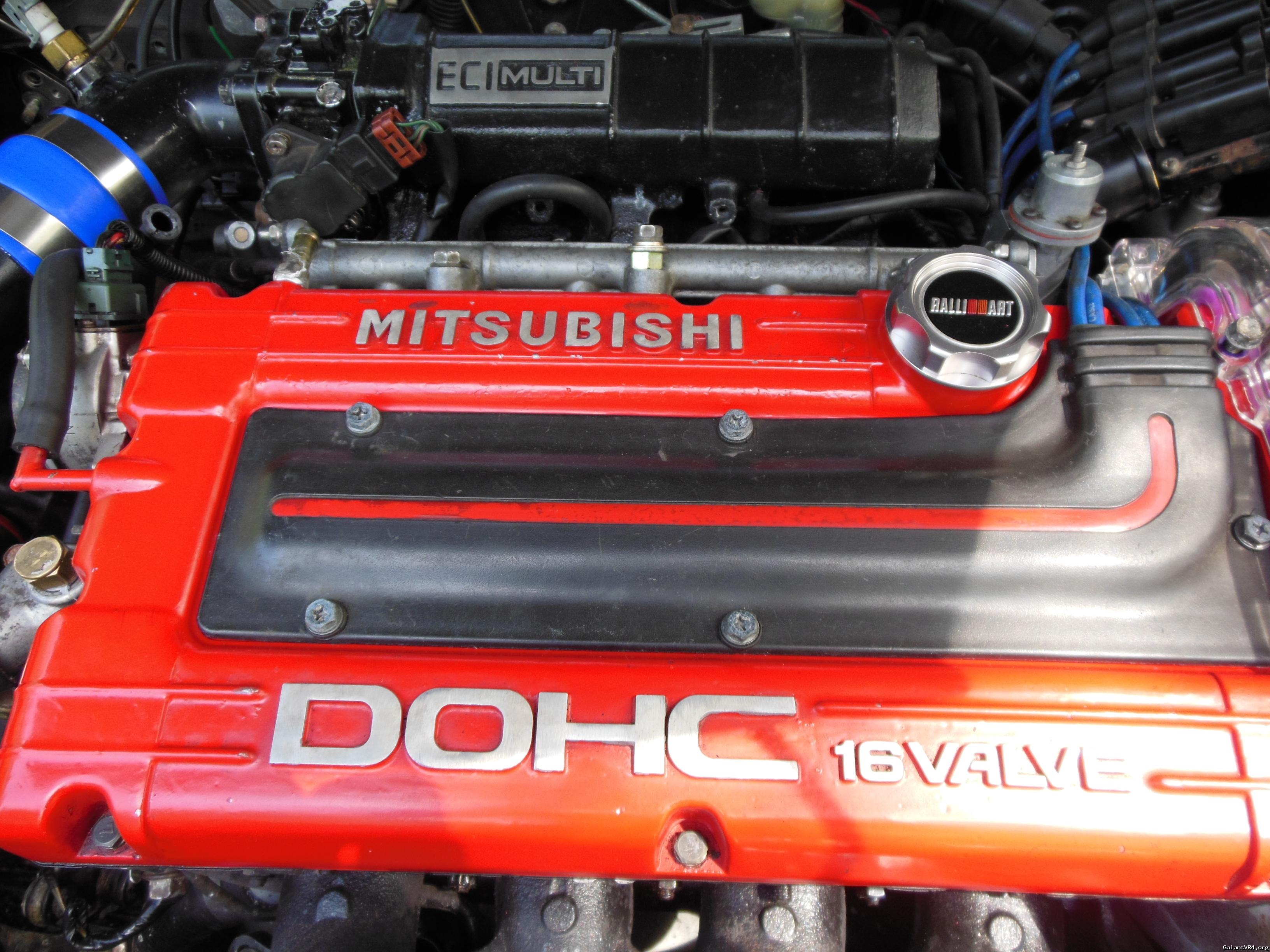

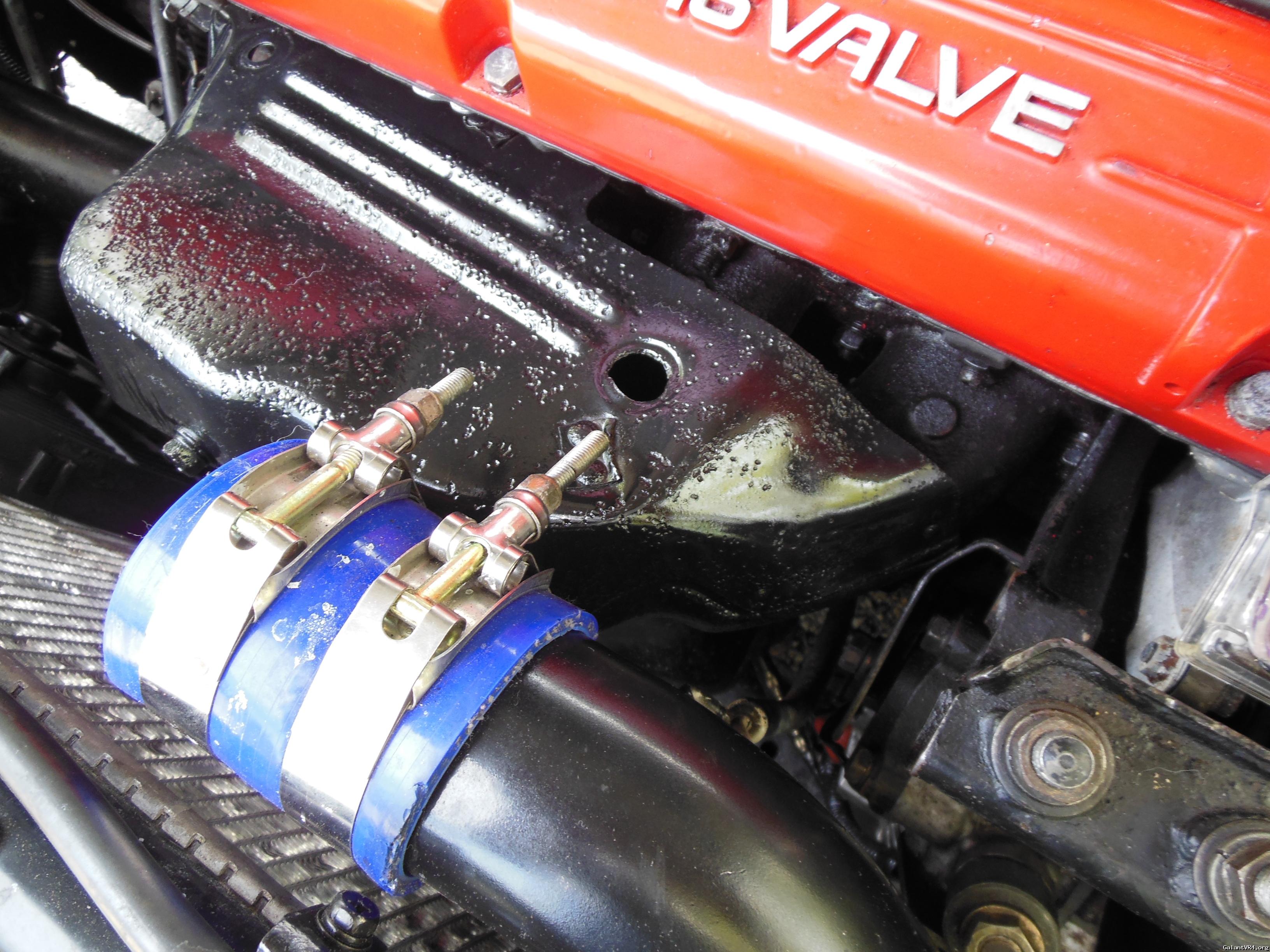

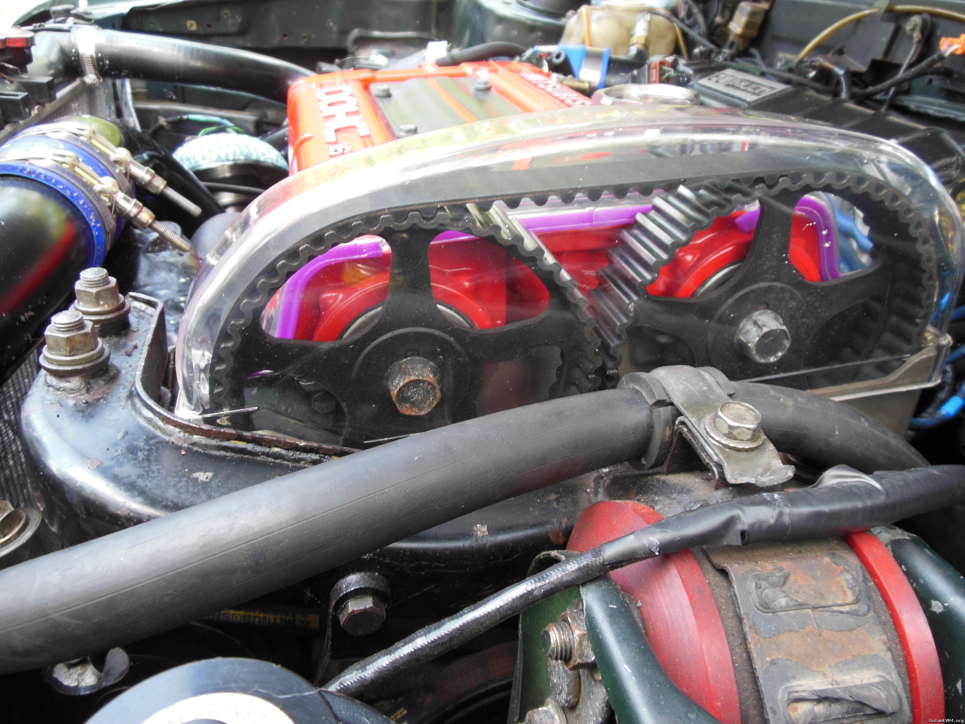

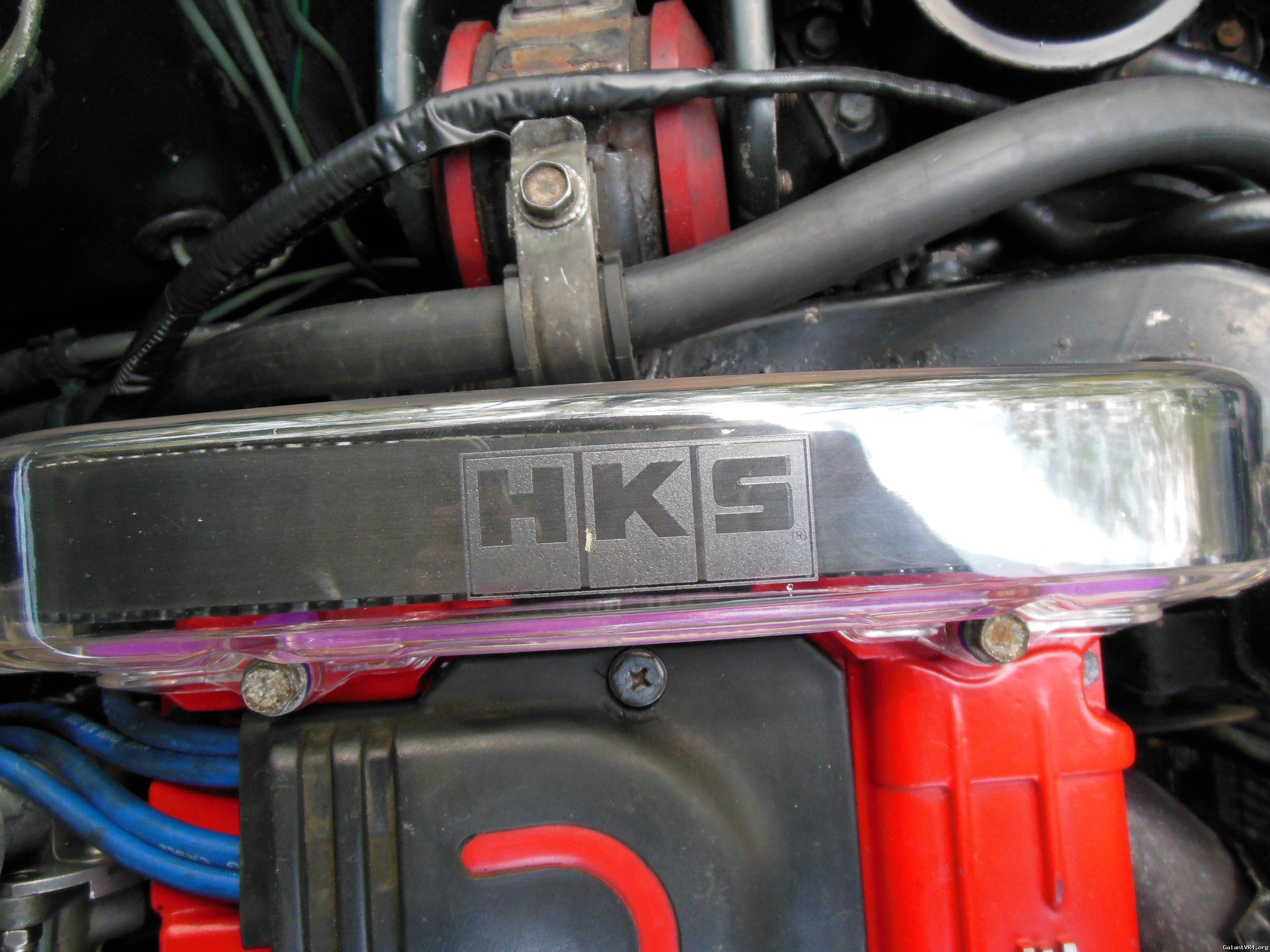

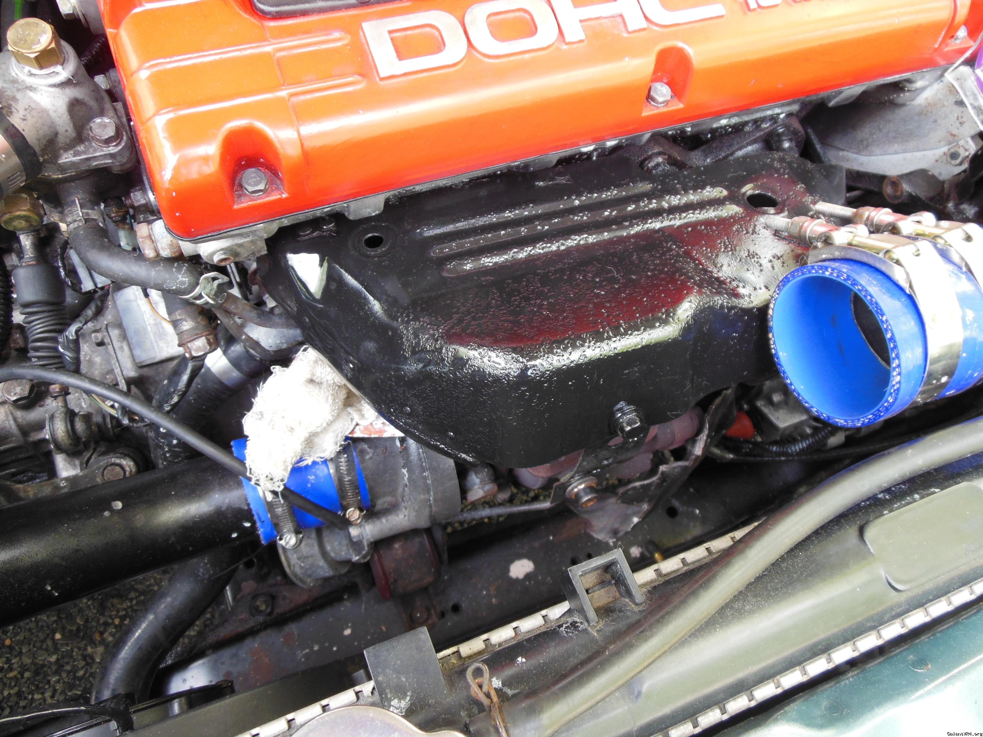

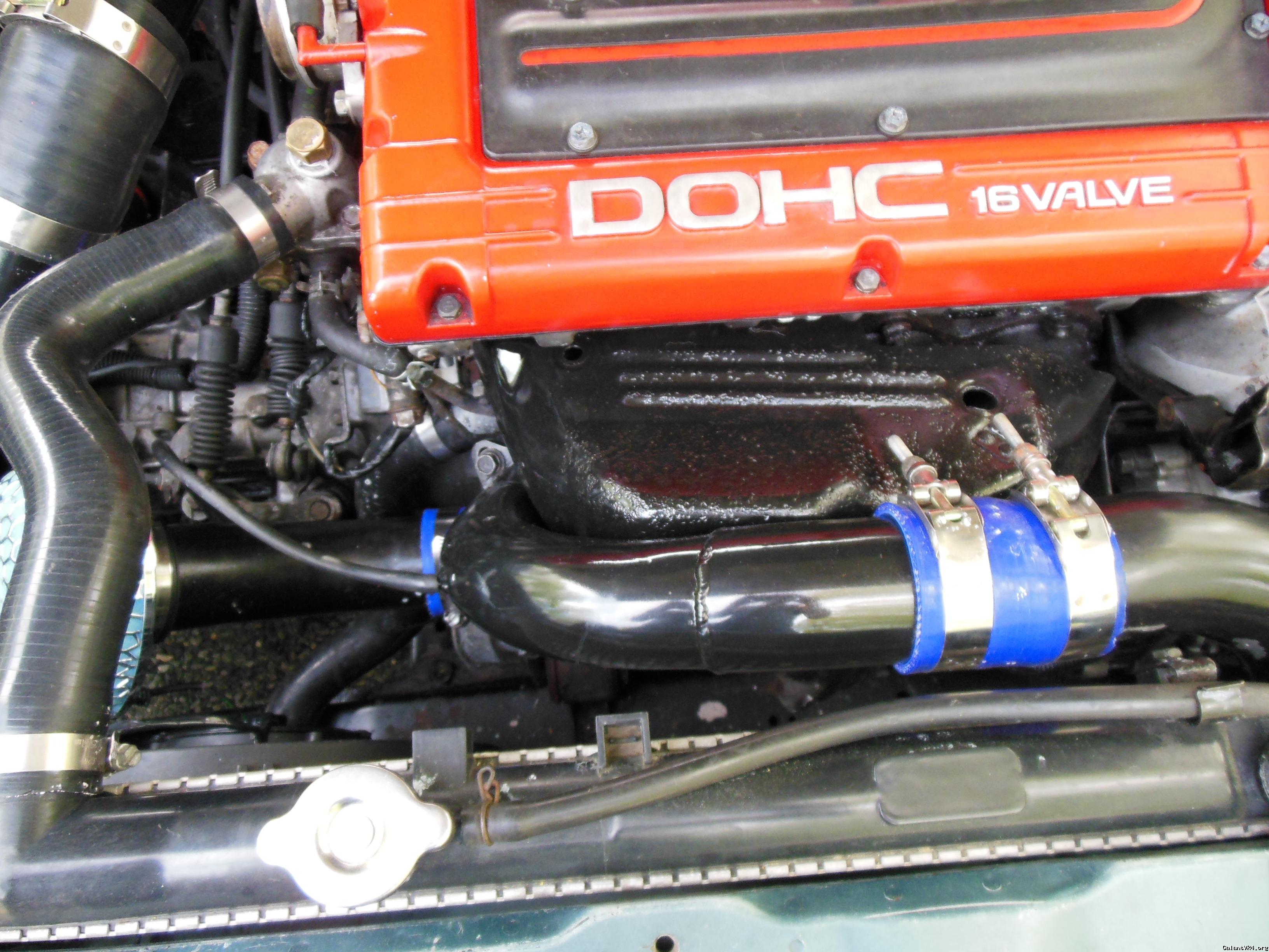

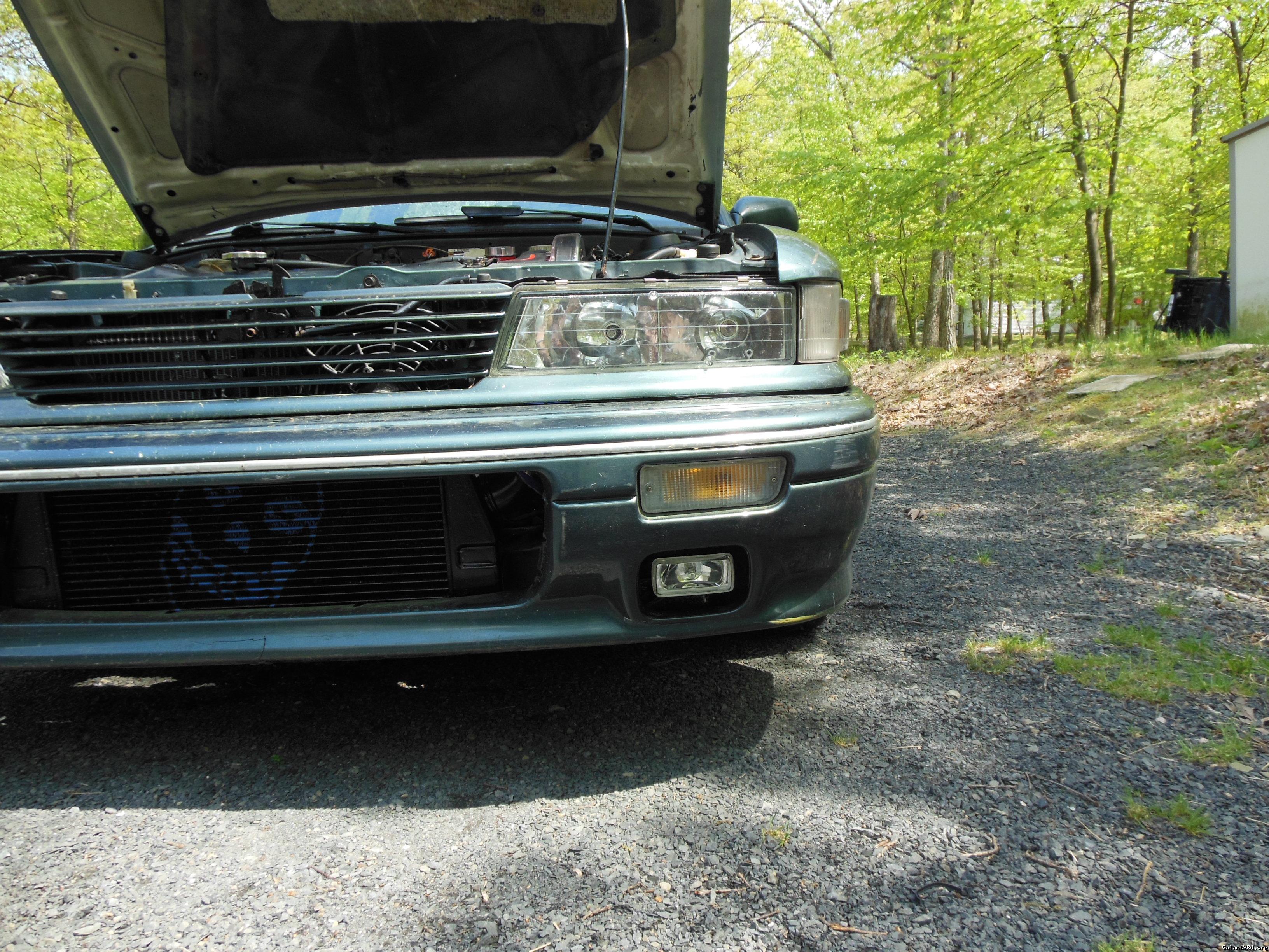

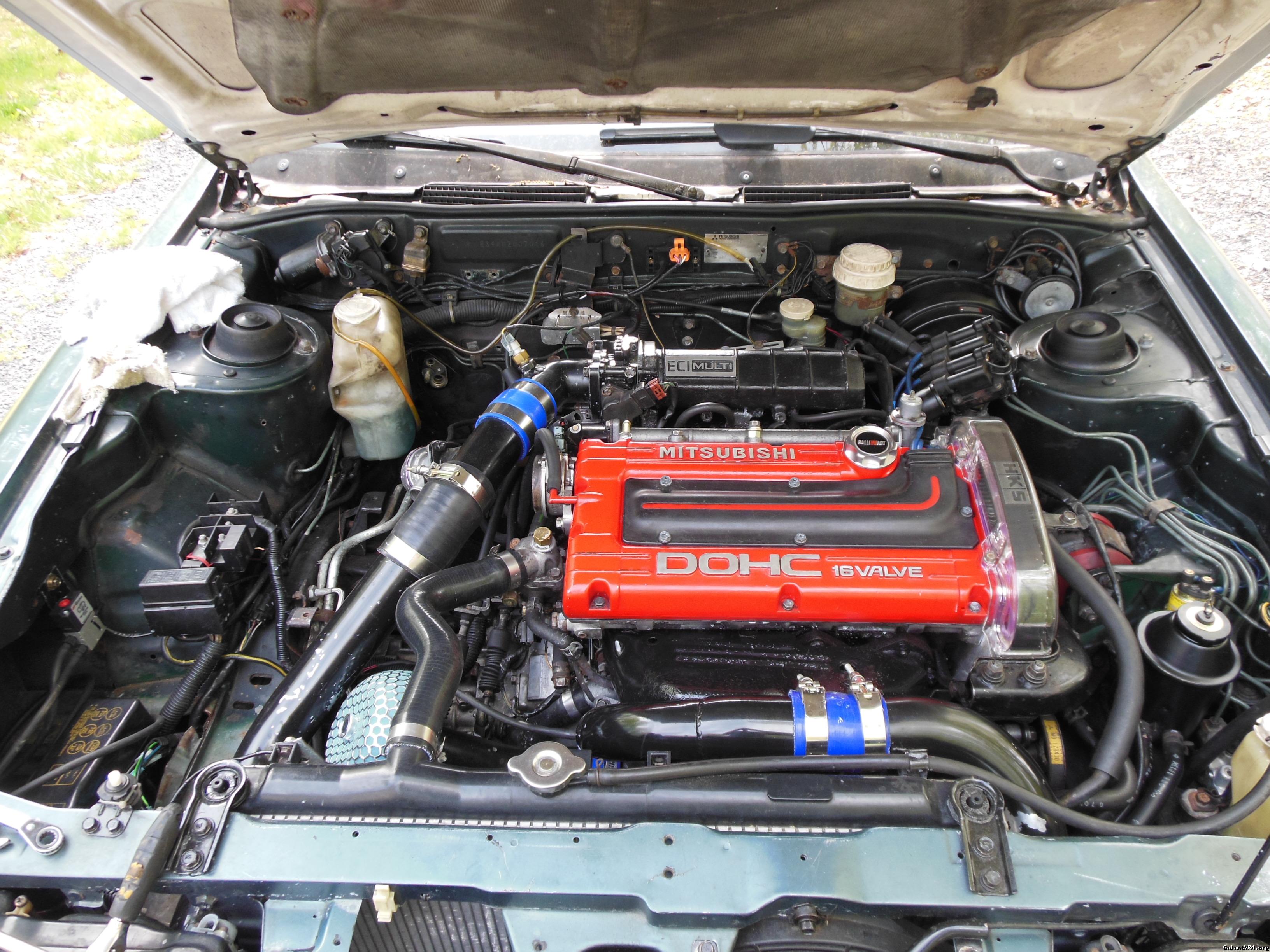

so i ordered all the parts to finish the meth kit in my car the way i want to install it. im just waiting for the package to come in the mail. today i did some cleaning up of the engine bay. installed a set of PTE 780cc injectors with all new o-rings, the front grill, spark plug cover, cut then painted the bracket and relocated the coil pack, put the clear HKS timing belt cover on and installed my fog lights. i have a heat shield that i painted black and im going to make some brackets for it to fit over the forced performance manifold. i hope to install that tomorrow. here are pictures of what i did today. i only have 1 fog light in just to see how it looks for the time being. i think they might be to small. what about you guys?

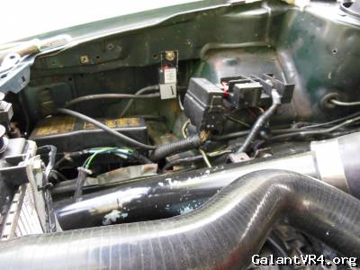

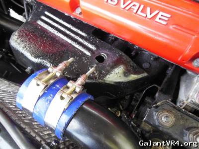

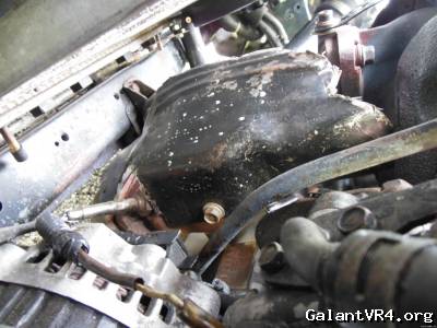

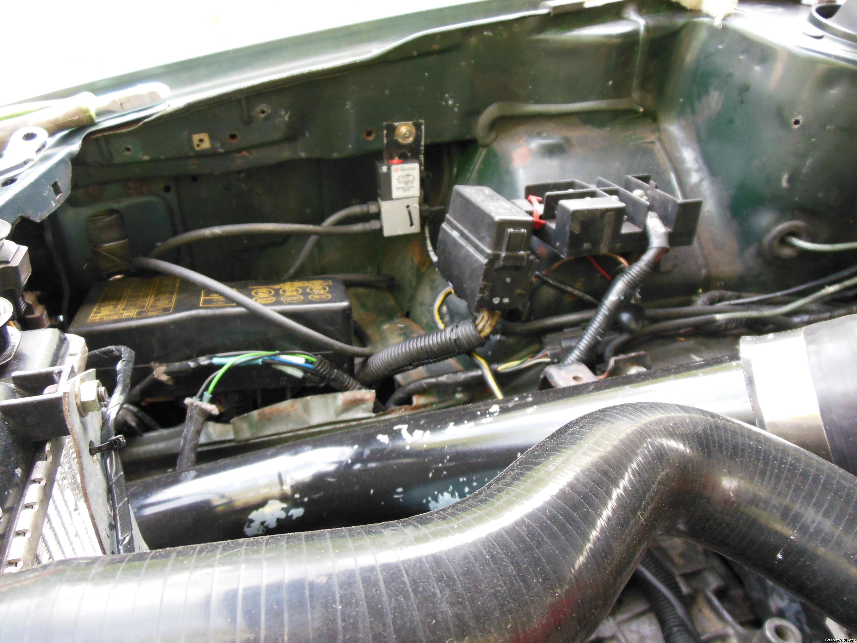

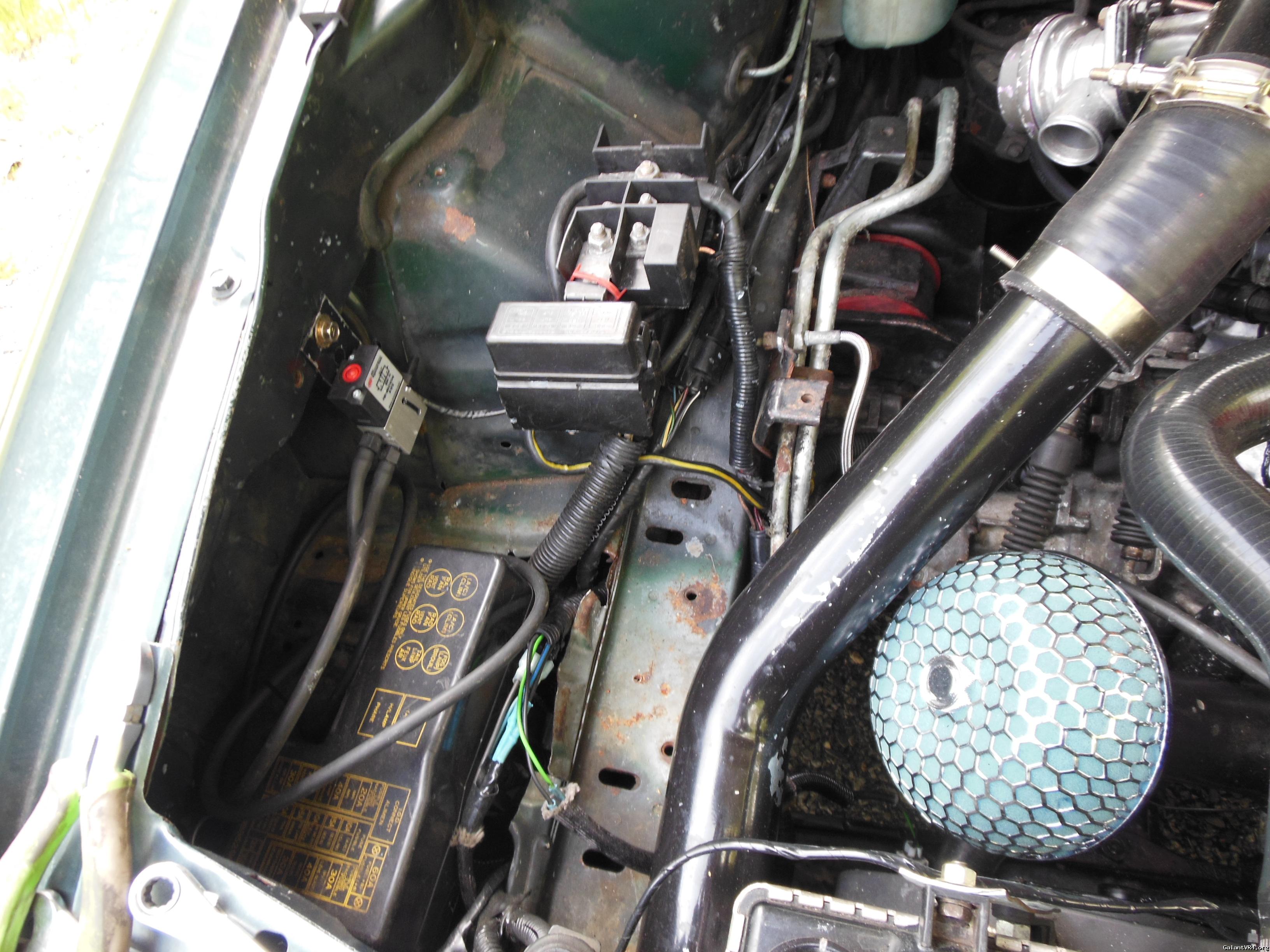

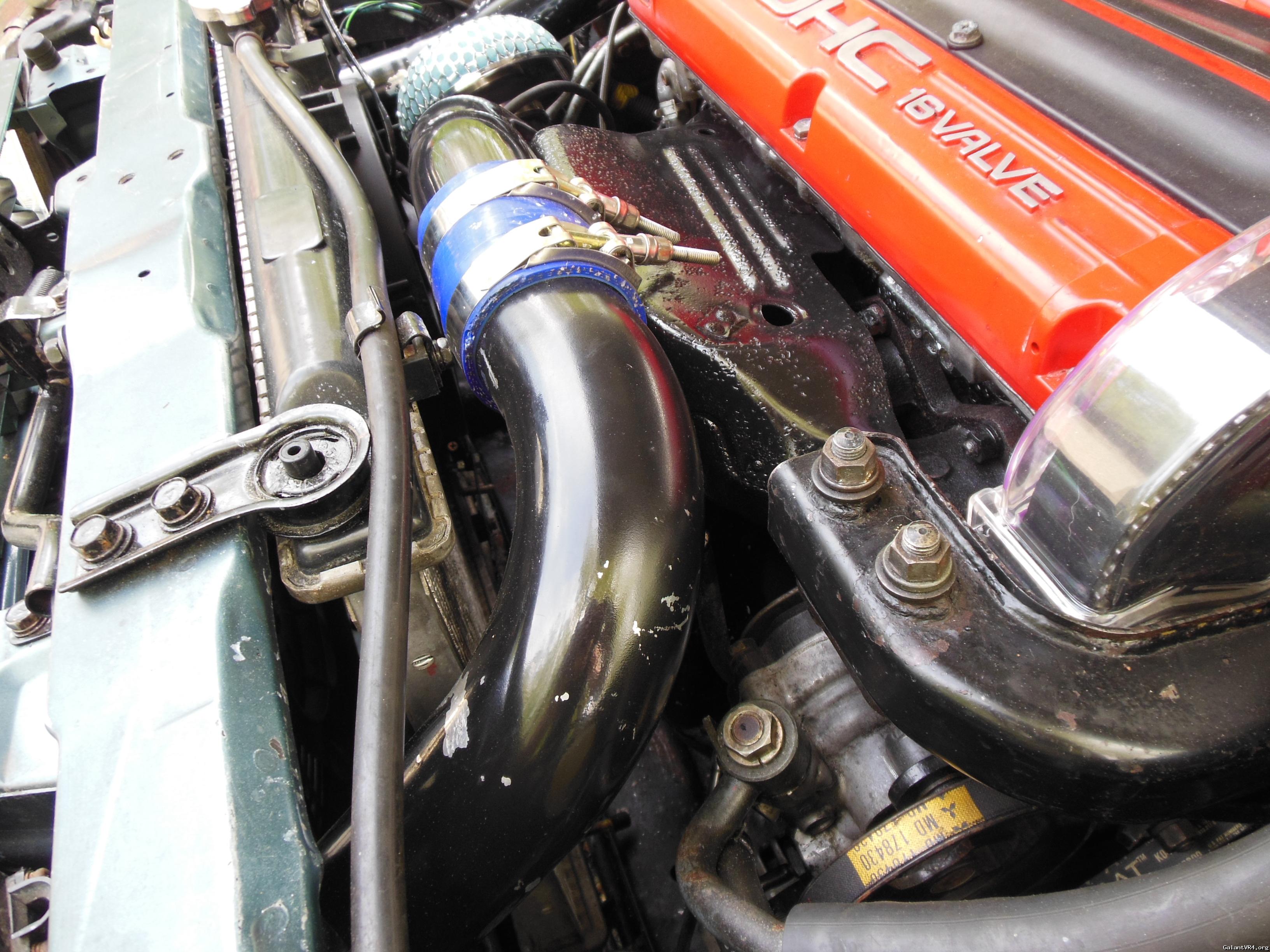

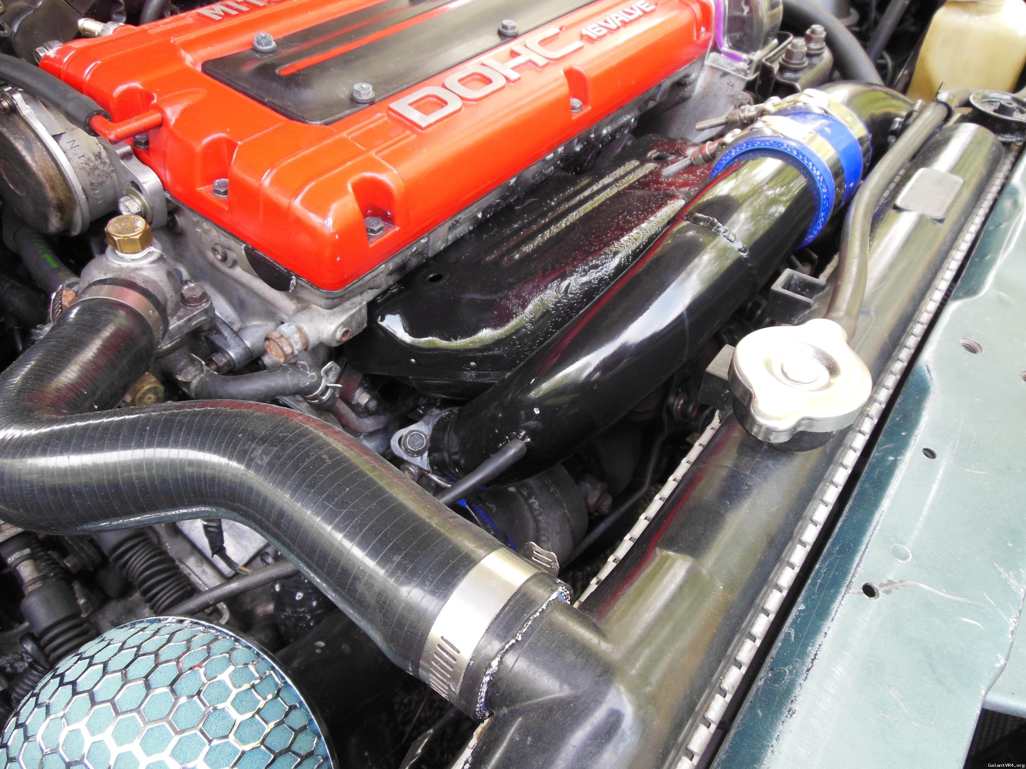

got up real early this morning and started getting things done. finished up the heat shield and bracket and installed it.

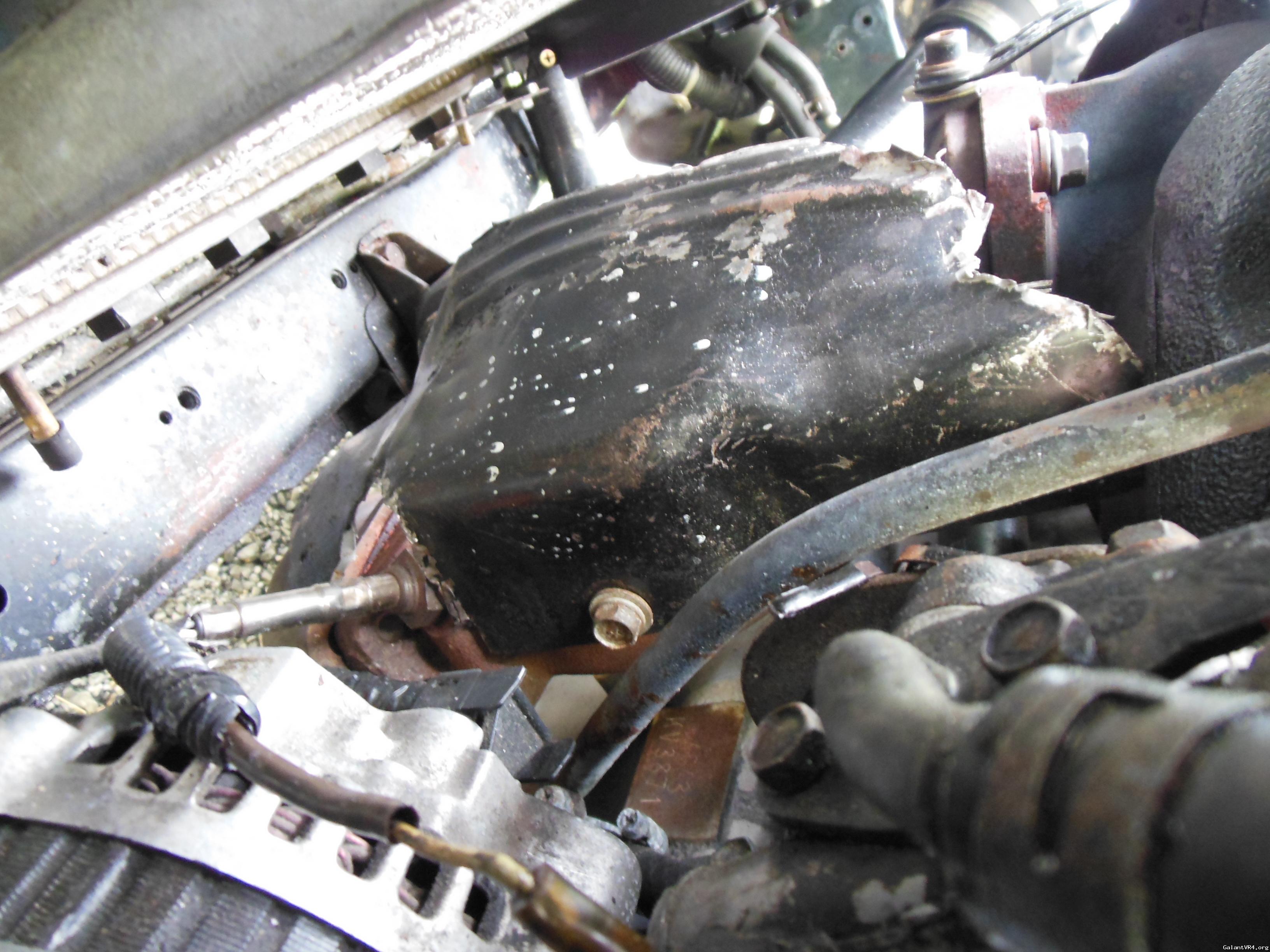

i also had a spare heat shield that was half rusted all the bolt holes were to bit for bolts so i cut it up for an o2 housing/alternator heat shield. its hidden so i dont mind it looking bad.

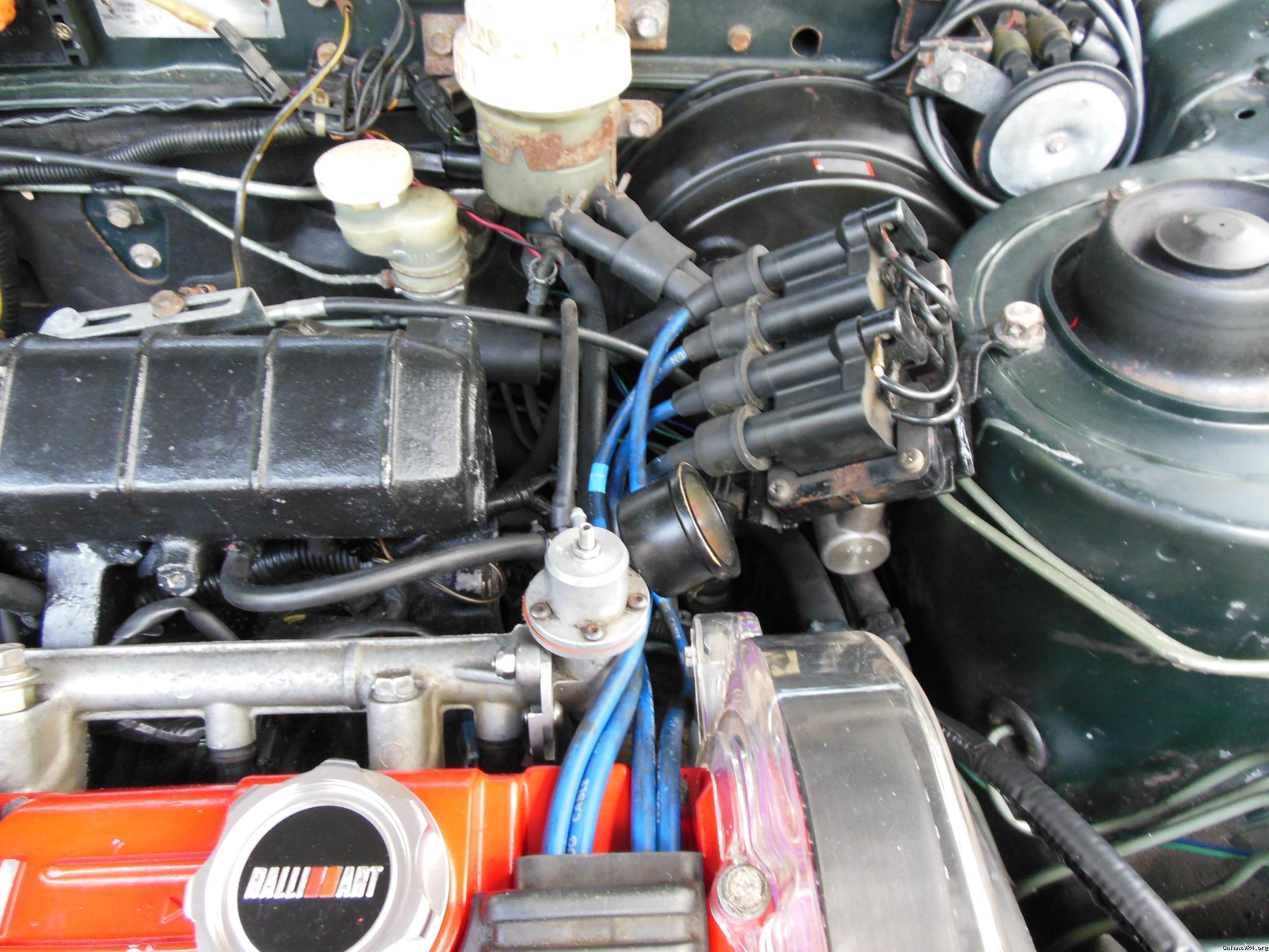

while i was at it i made a bracket for the electronic boost controller thats controlled by ECMLink.
and the final product.

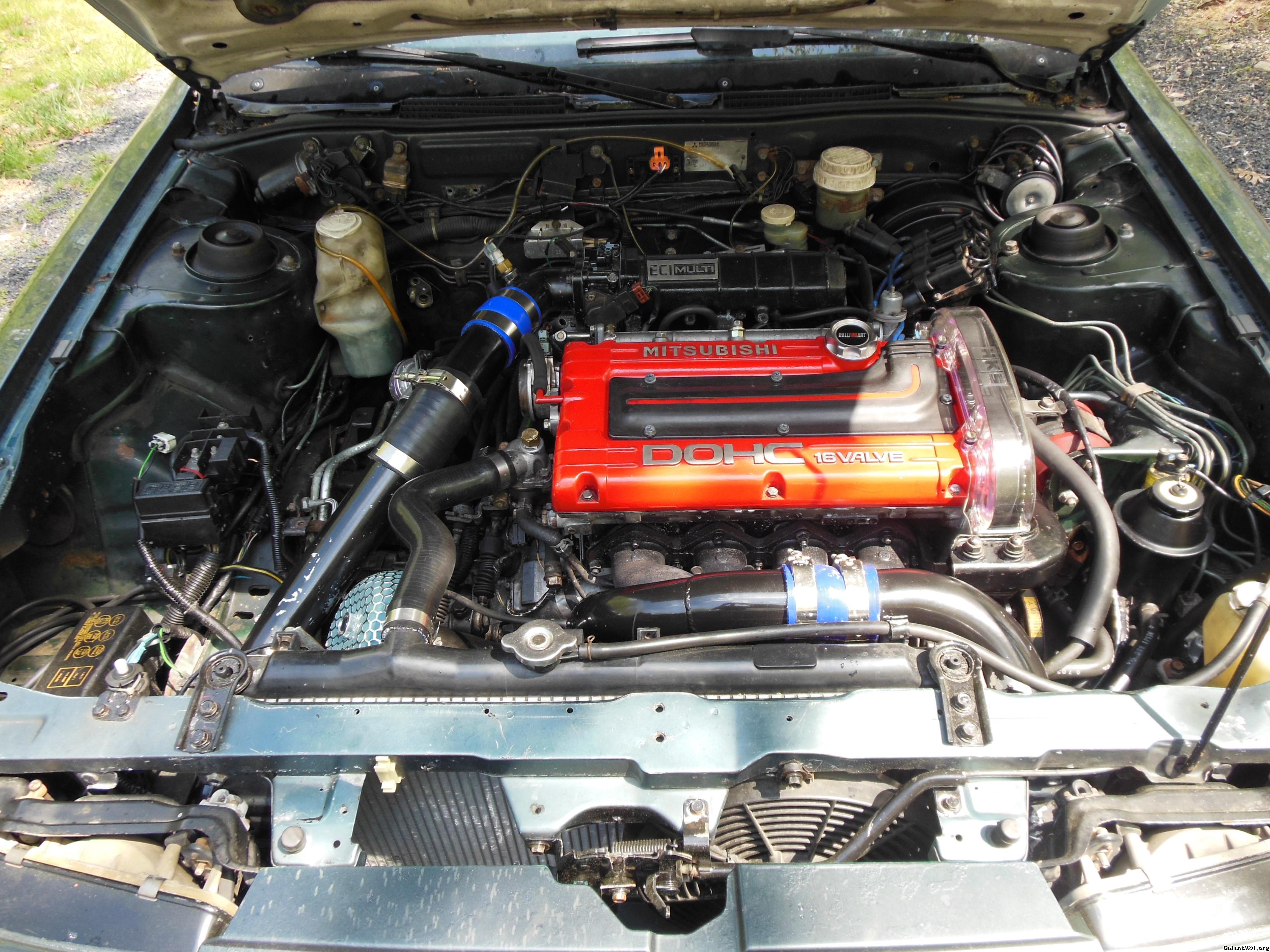

im done under the hood for a while. im really really happy with how everything came out. i have the rest of the meth kit on the way, but im probably going to hold off on using it for a while as id like to get the car tuned and running real well and enjoy it for a while before i start playing around again. now i just need to get the harness bar and put the passenger seat in and the car is done.
even though its never done and im actually moving the gauges into the glove box now and working on building a carputer to straight run link all the time and have a constant datalog going and use that as my gauges.

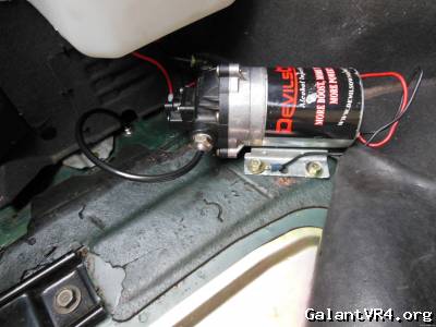

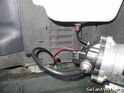

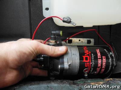

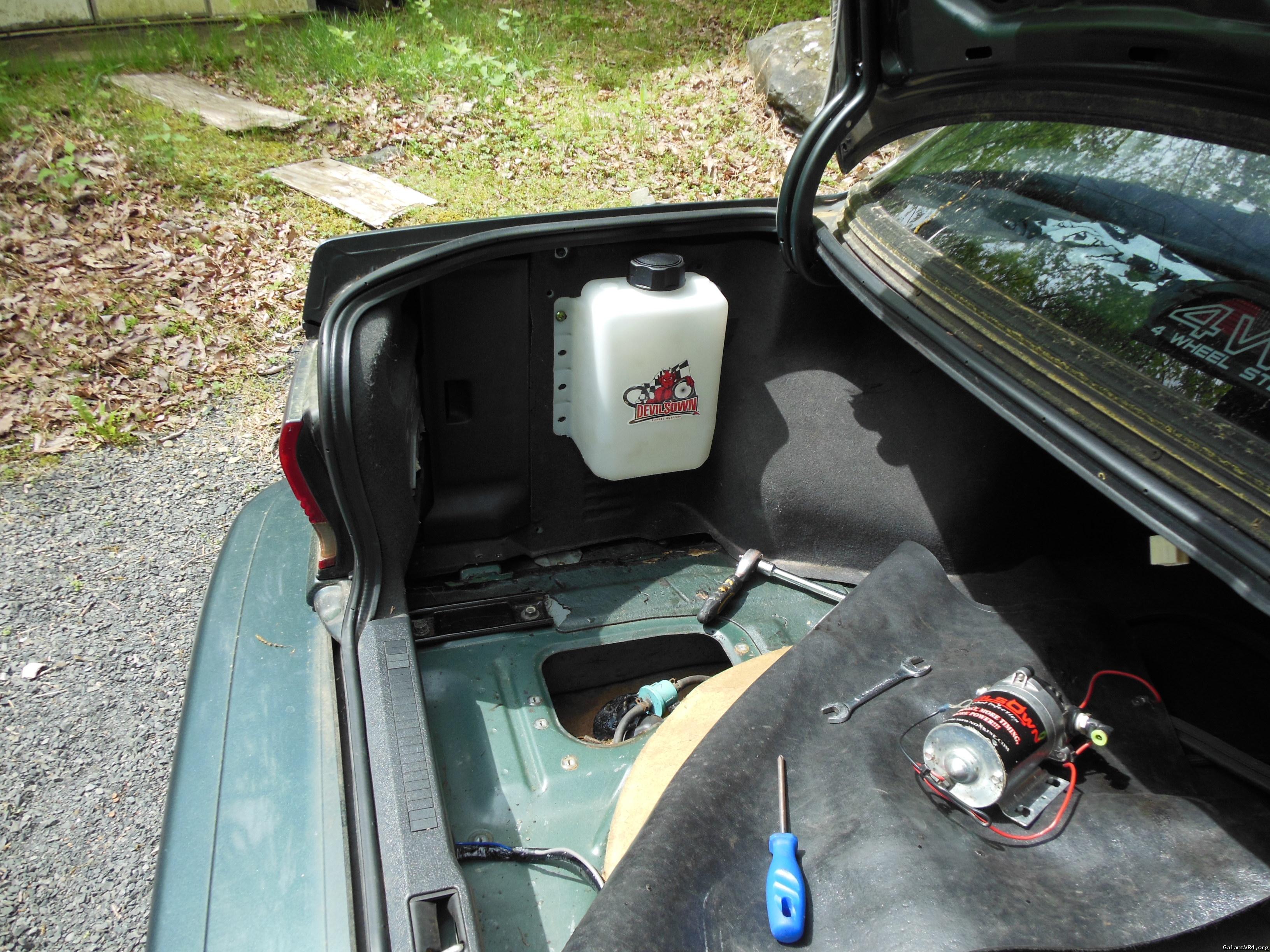

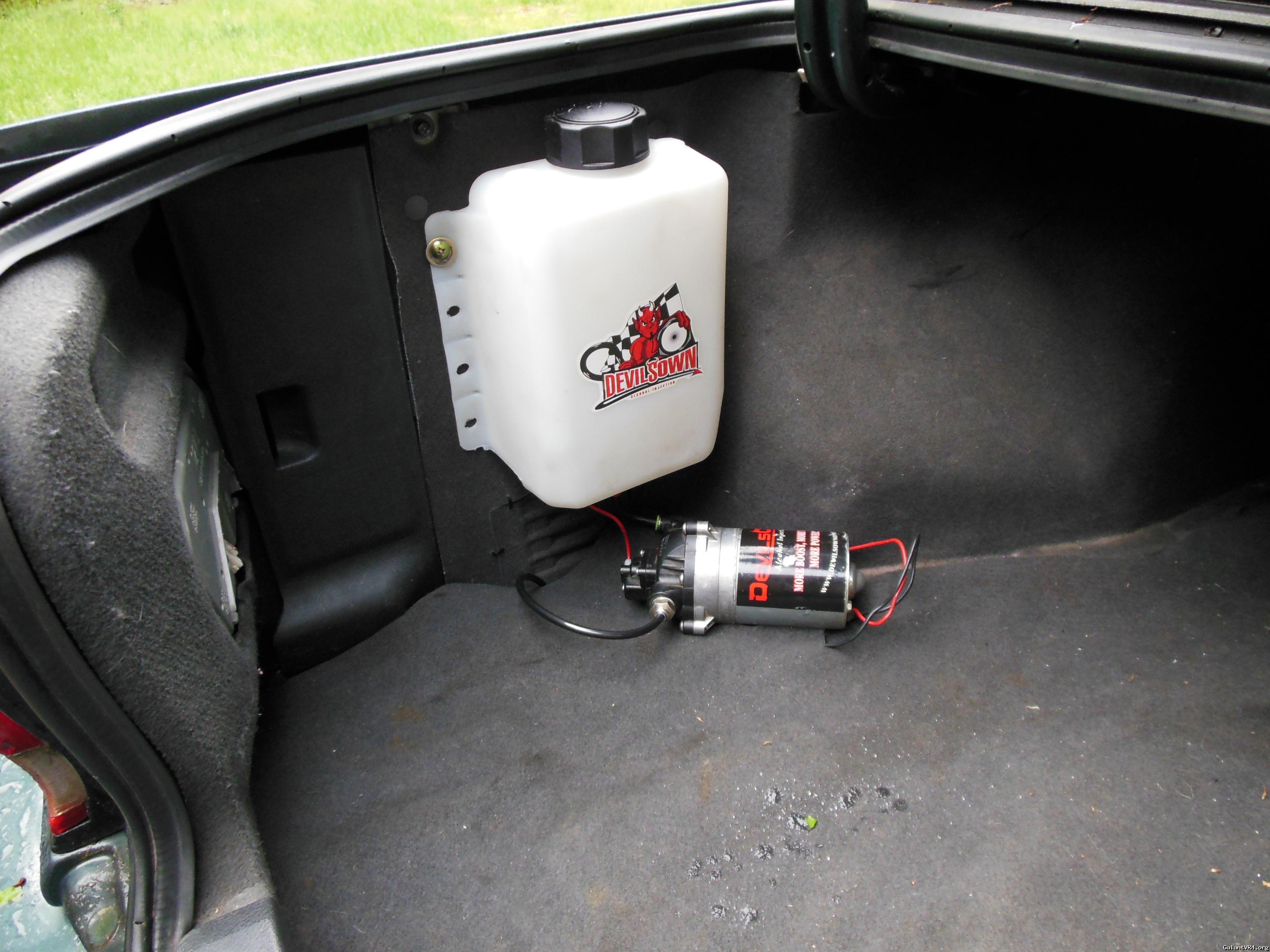

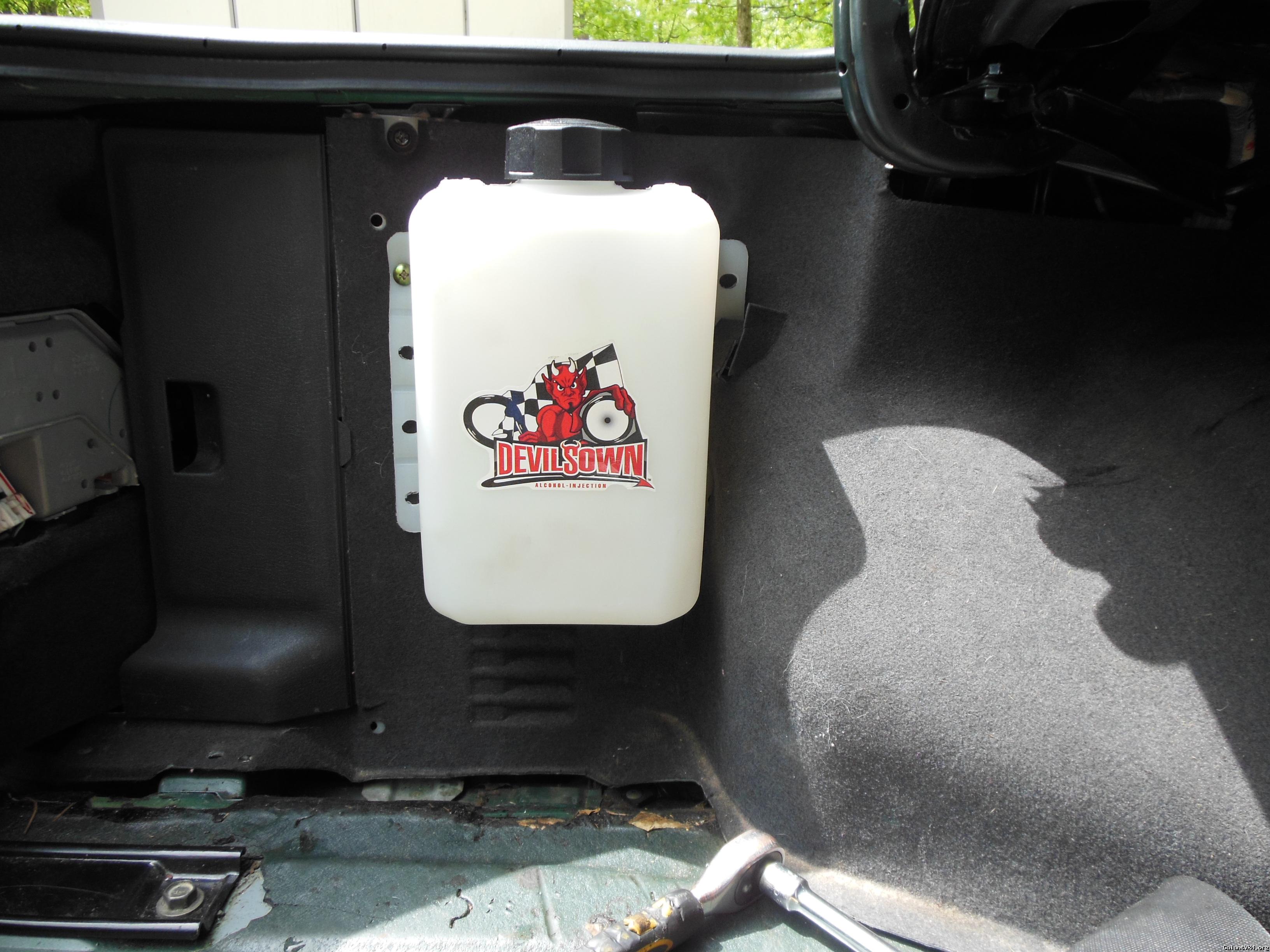

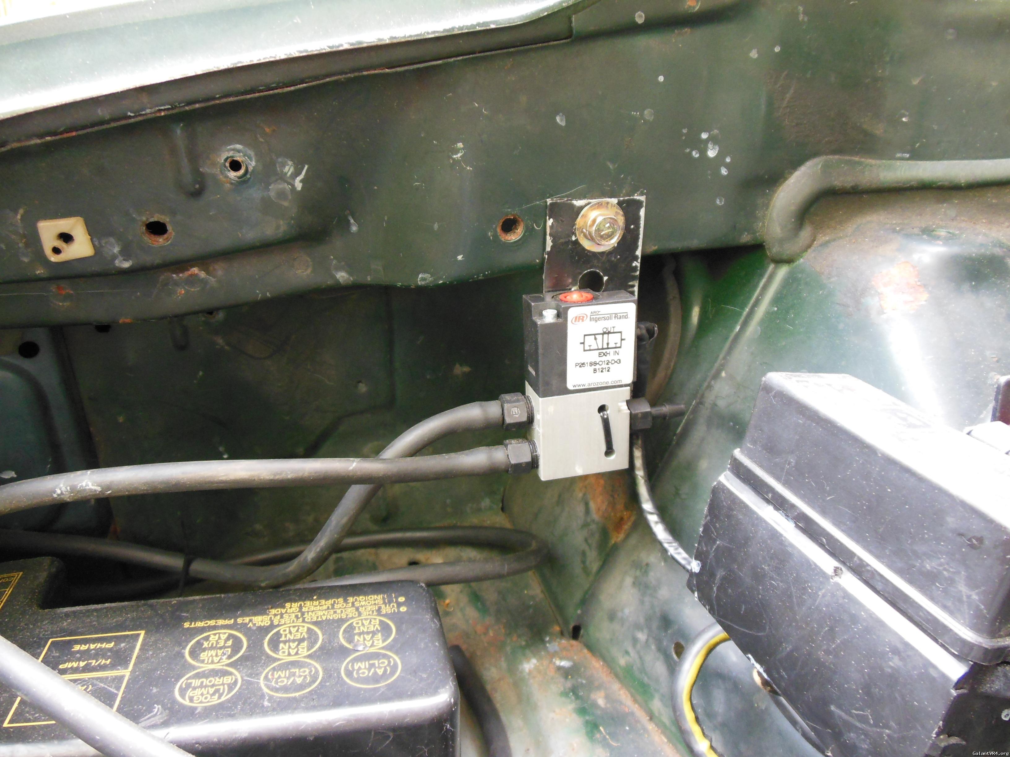

got all the meth stuff in the mail the other day and i had some free time this morning and decided where to mount the bottle. i put it here.

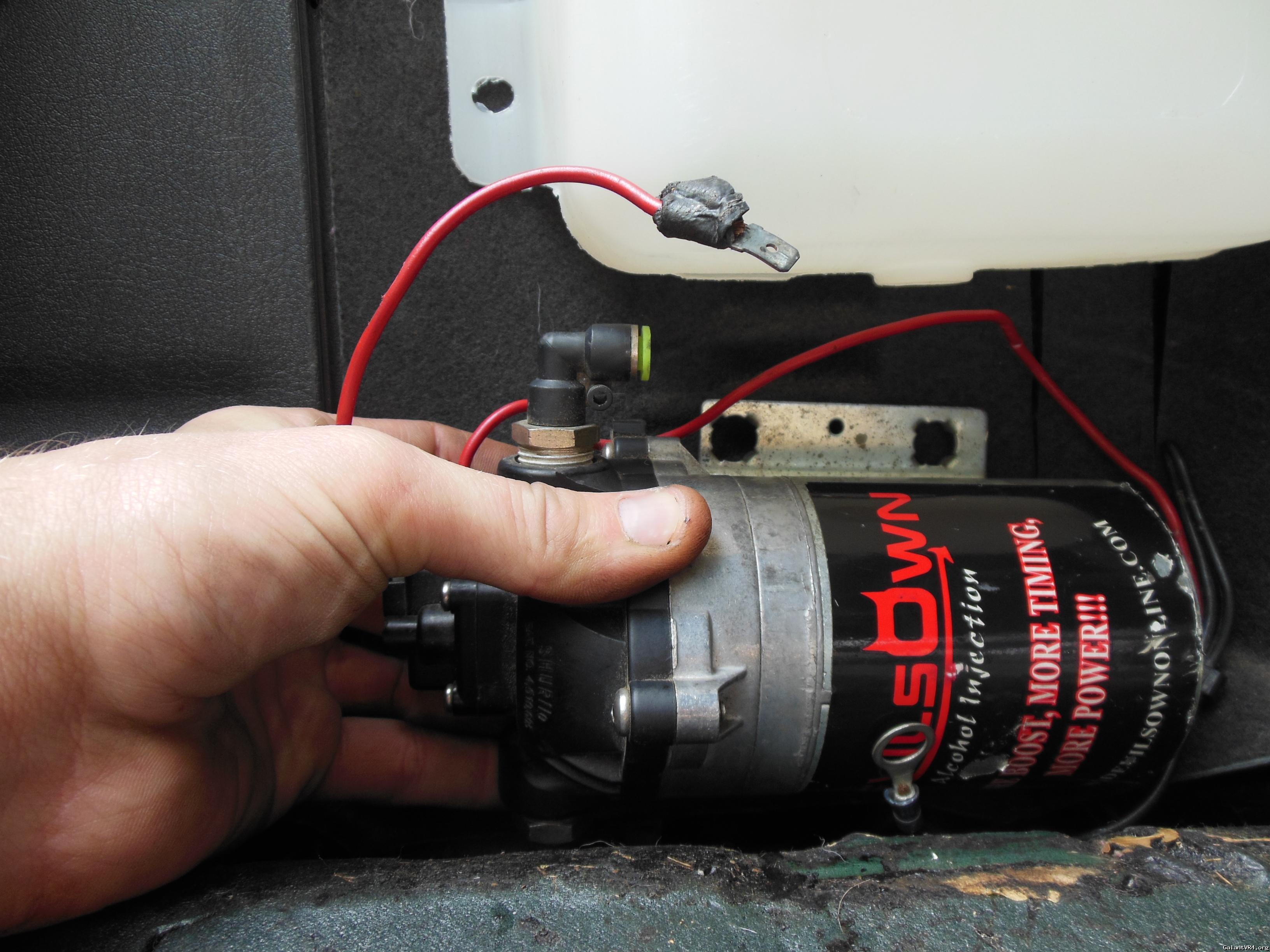

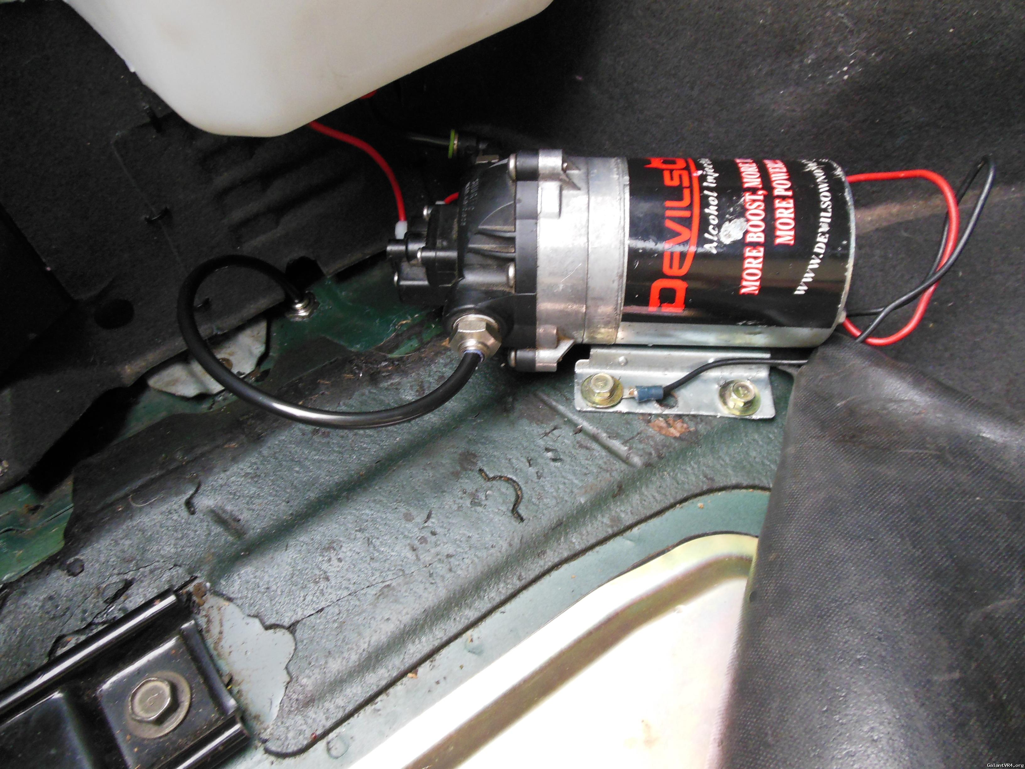

still trying to figure out where to put the pump, im thinking i might make some brackets and put it here.
if anyone has a better place or a different idea, let me know.
transparentdsm
Jul 27, 2011
3,690
Cherry Hill, NJ

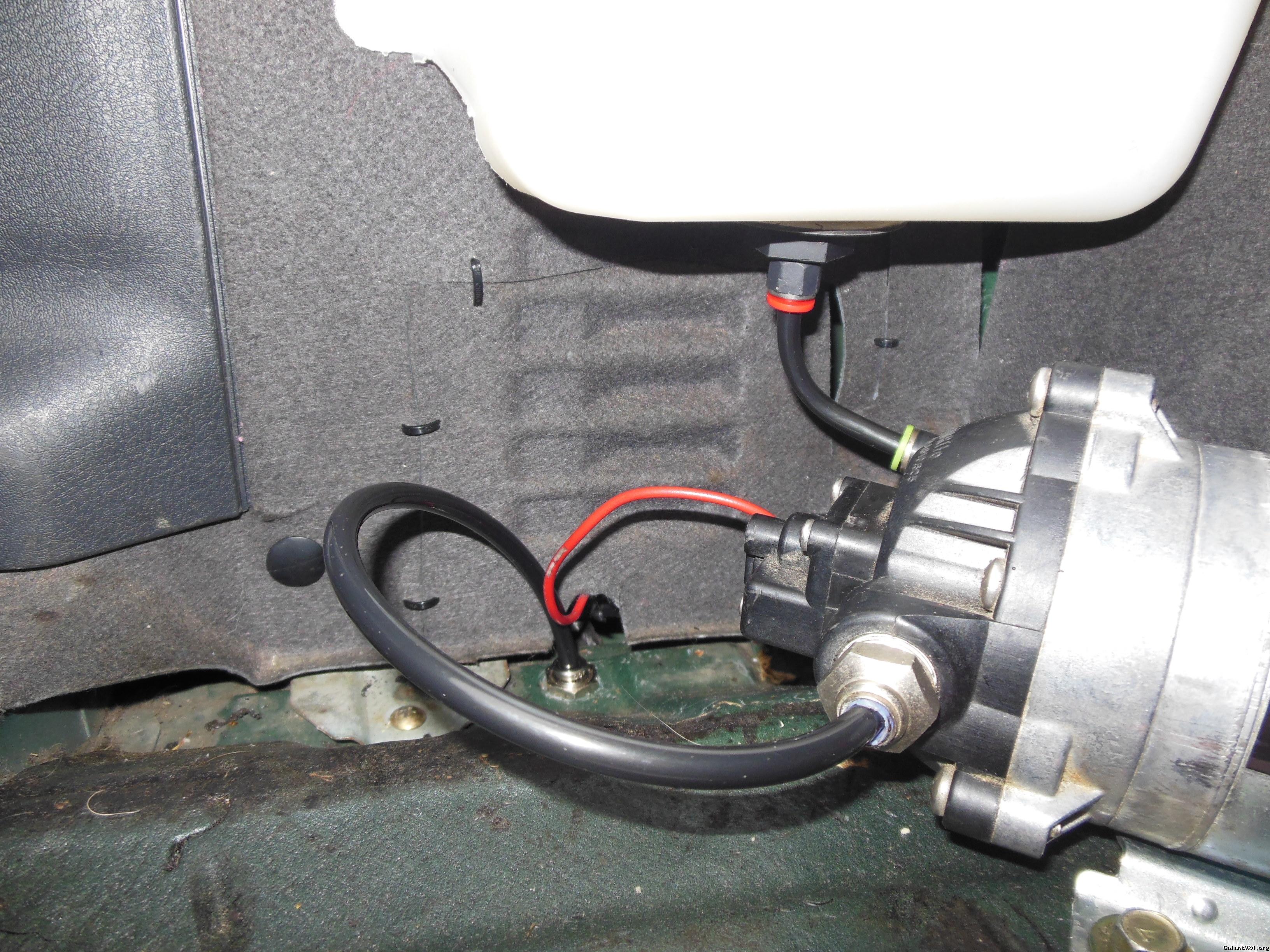

so i tried a few spots, this is what i liked the most and found easy to run the lines.
carpet tucked under and around the pump
and the routing of the hoses.
i haven't run any of the lines yet. not sure when im going to, but i really wanted to do the trunk portion.

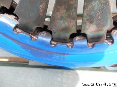

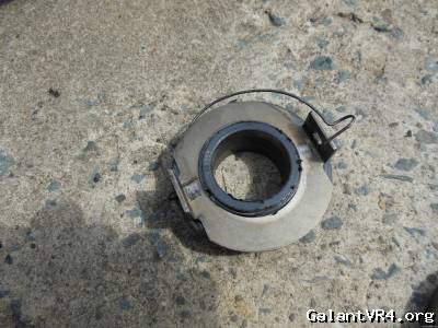

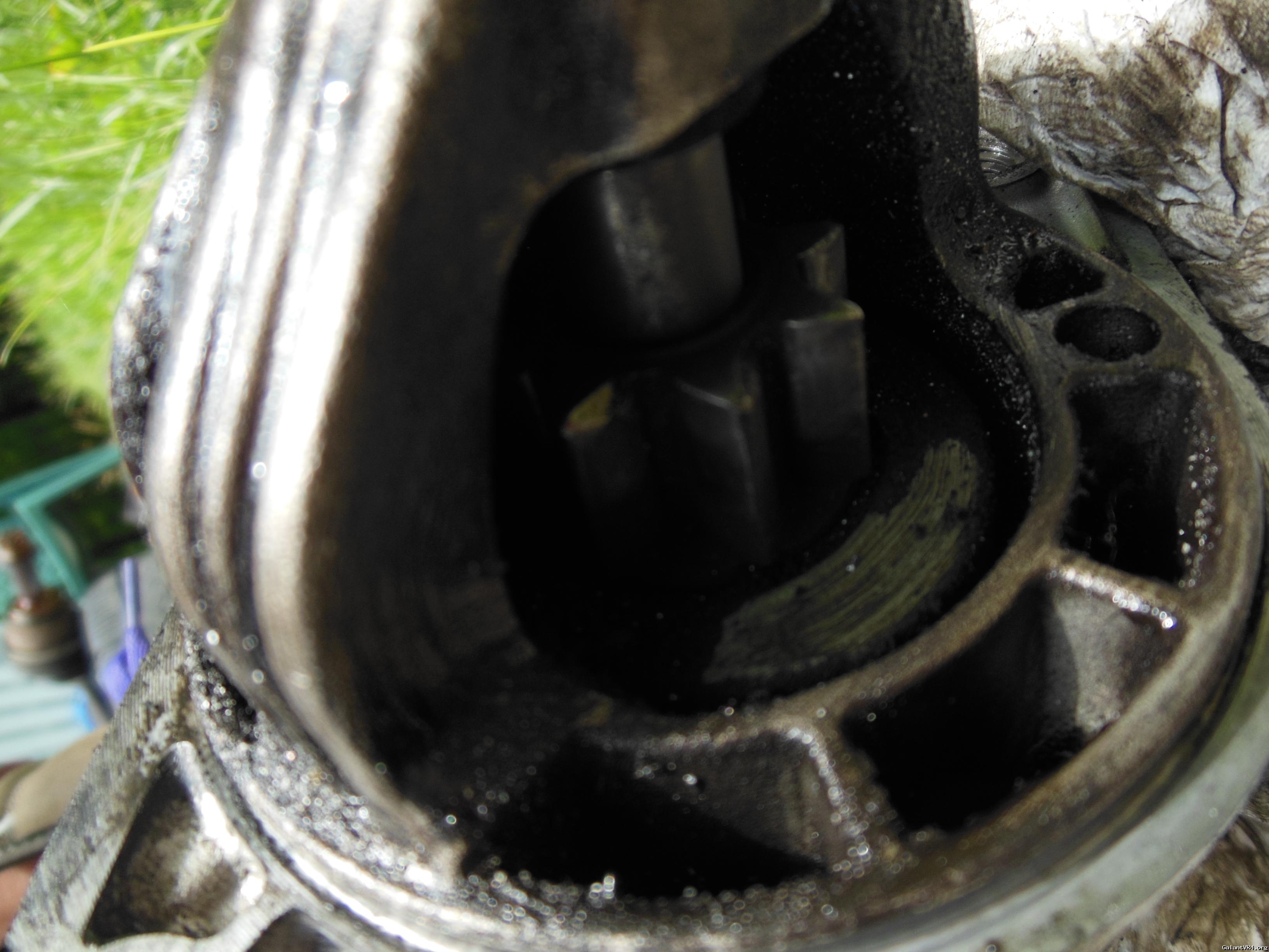

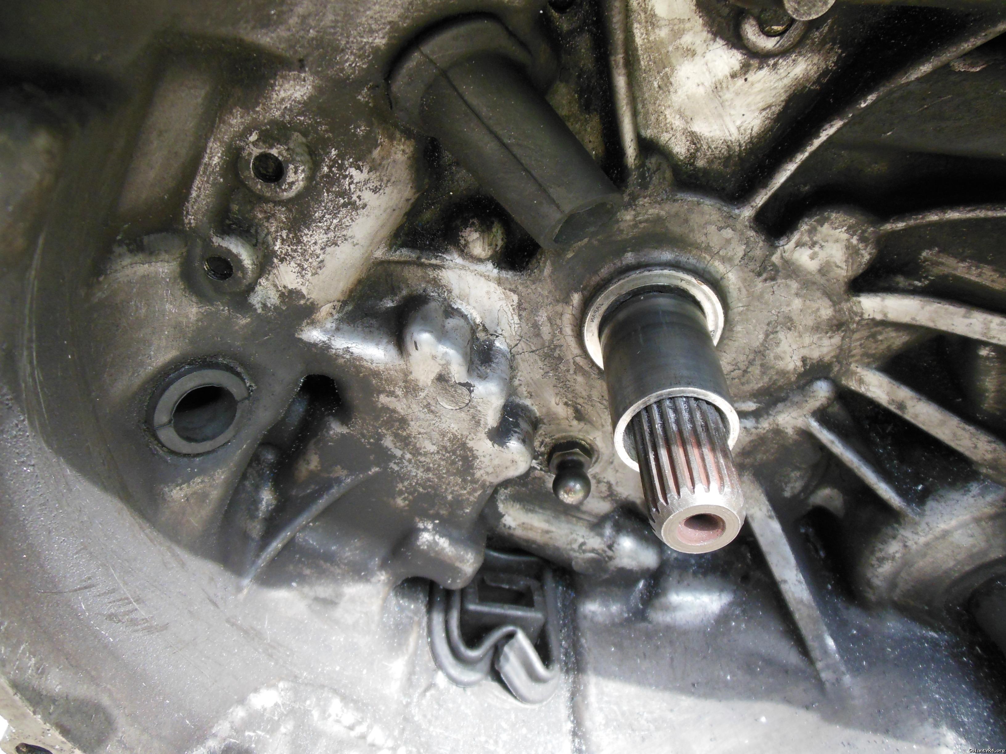

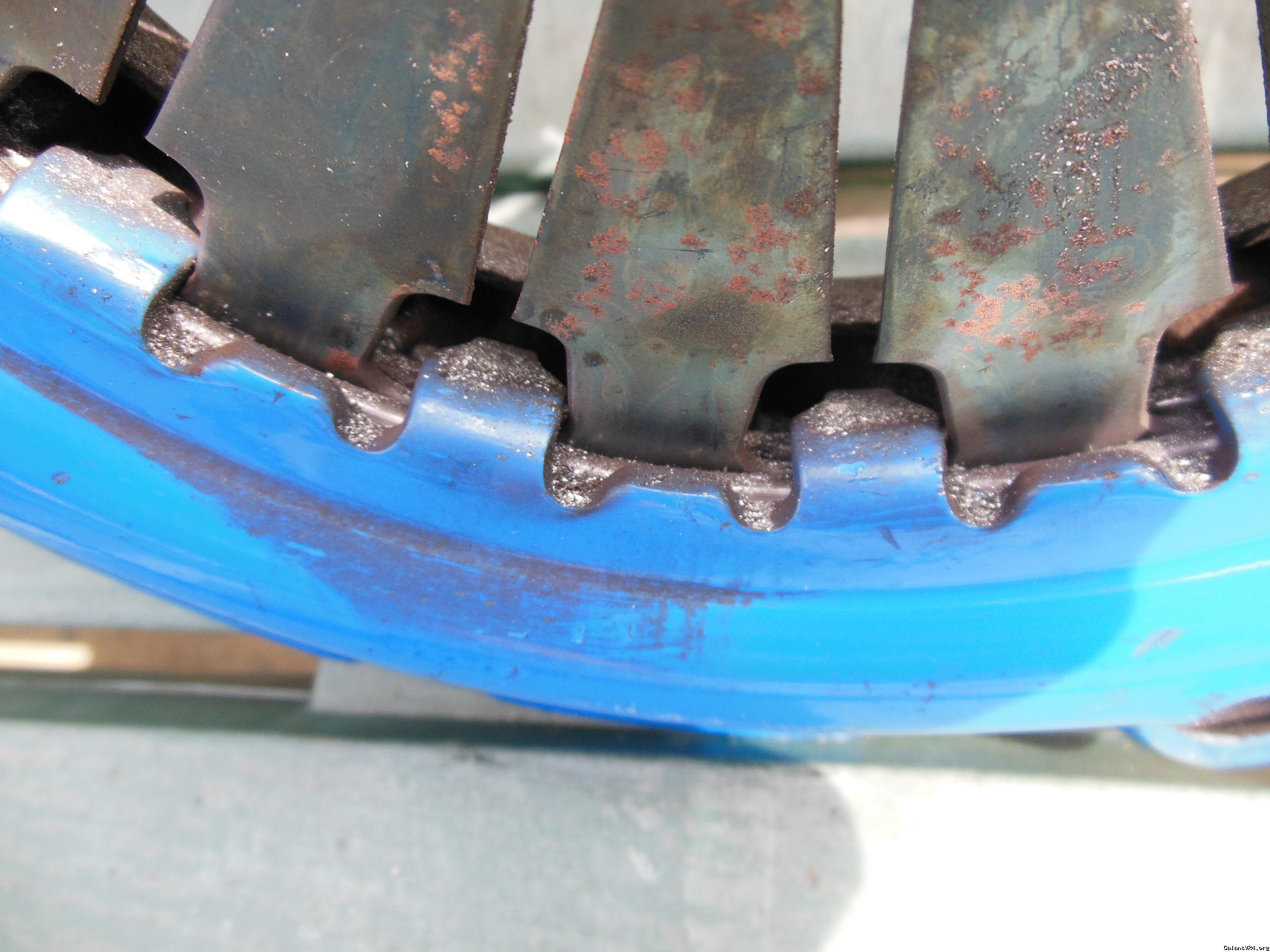

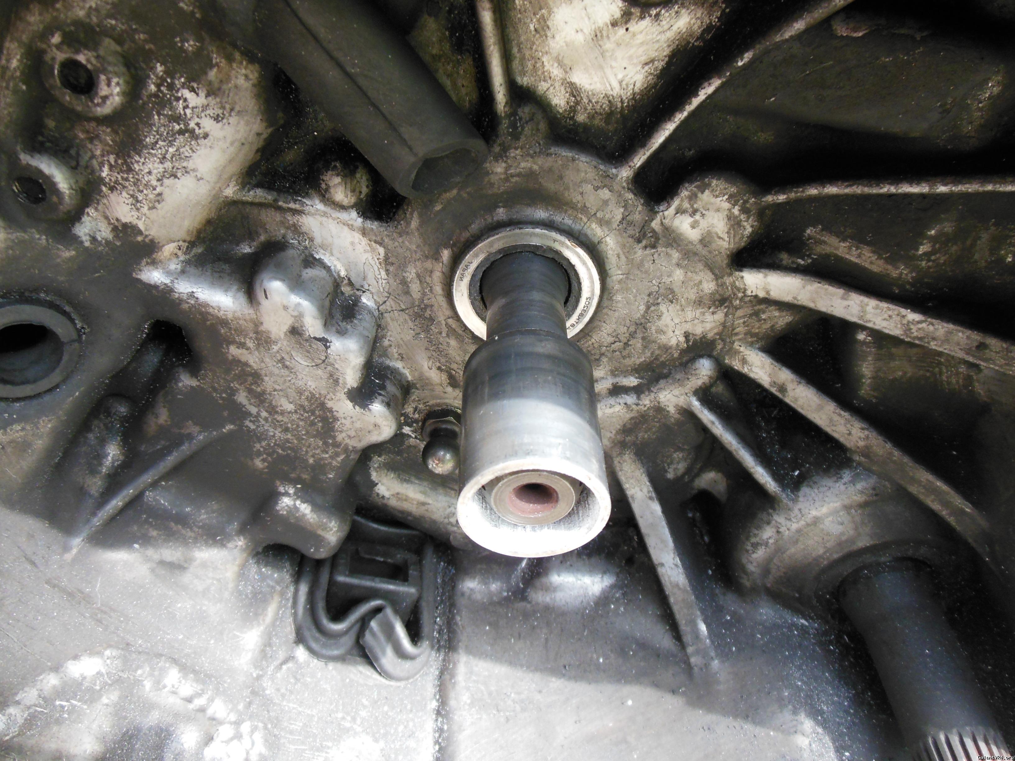

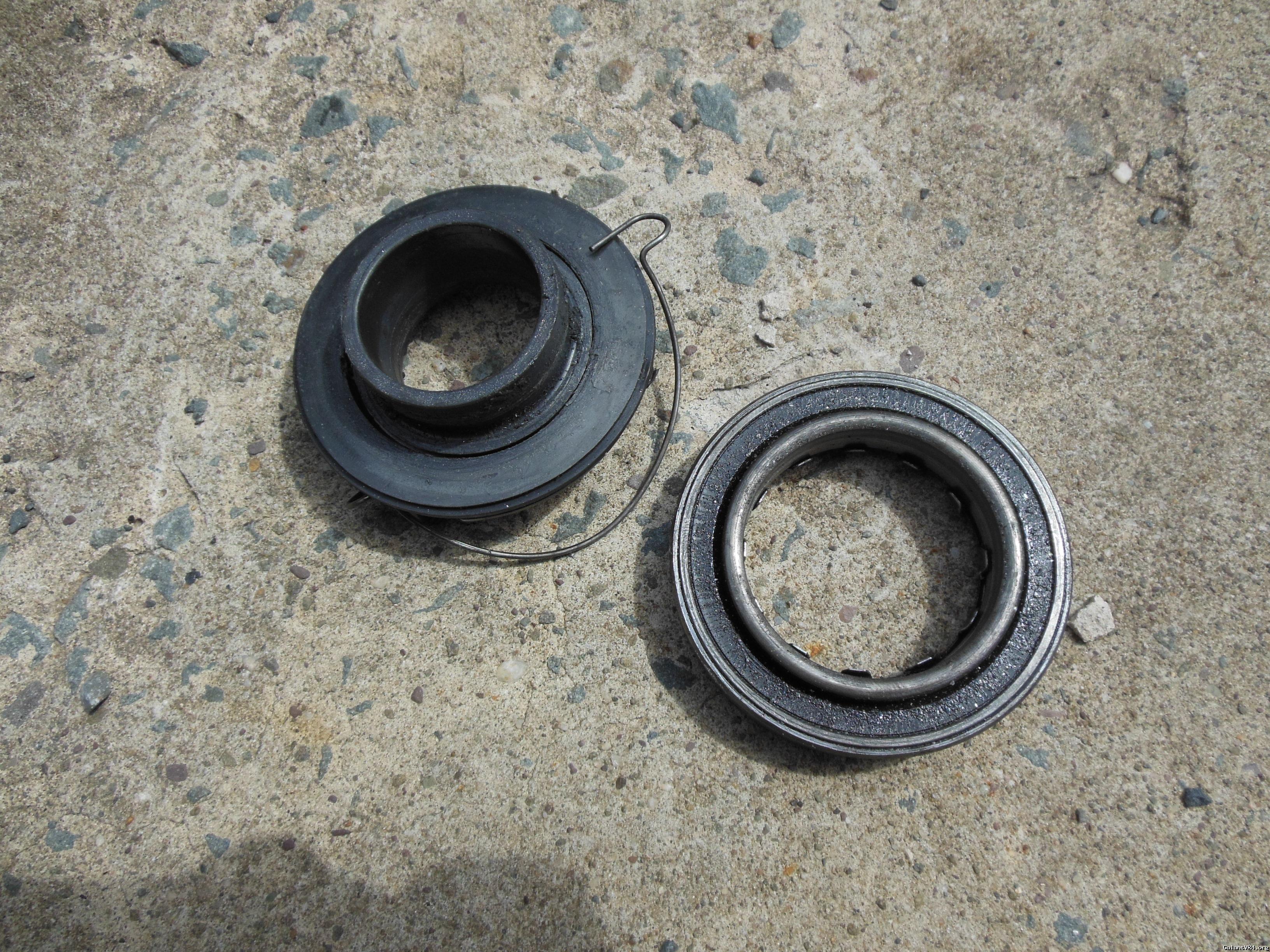

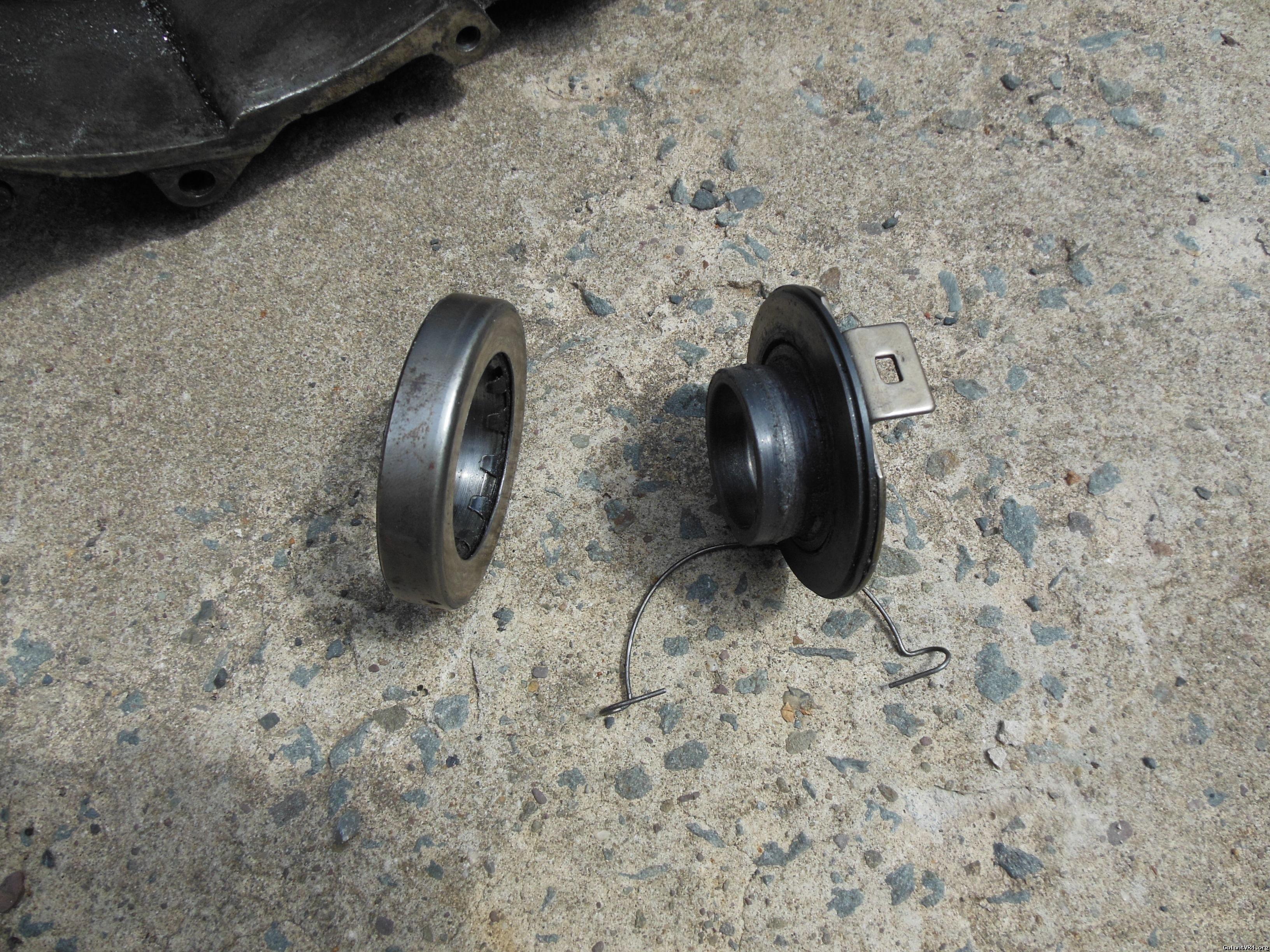

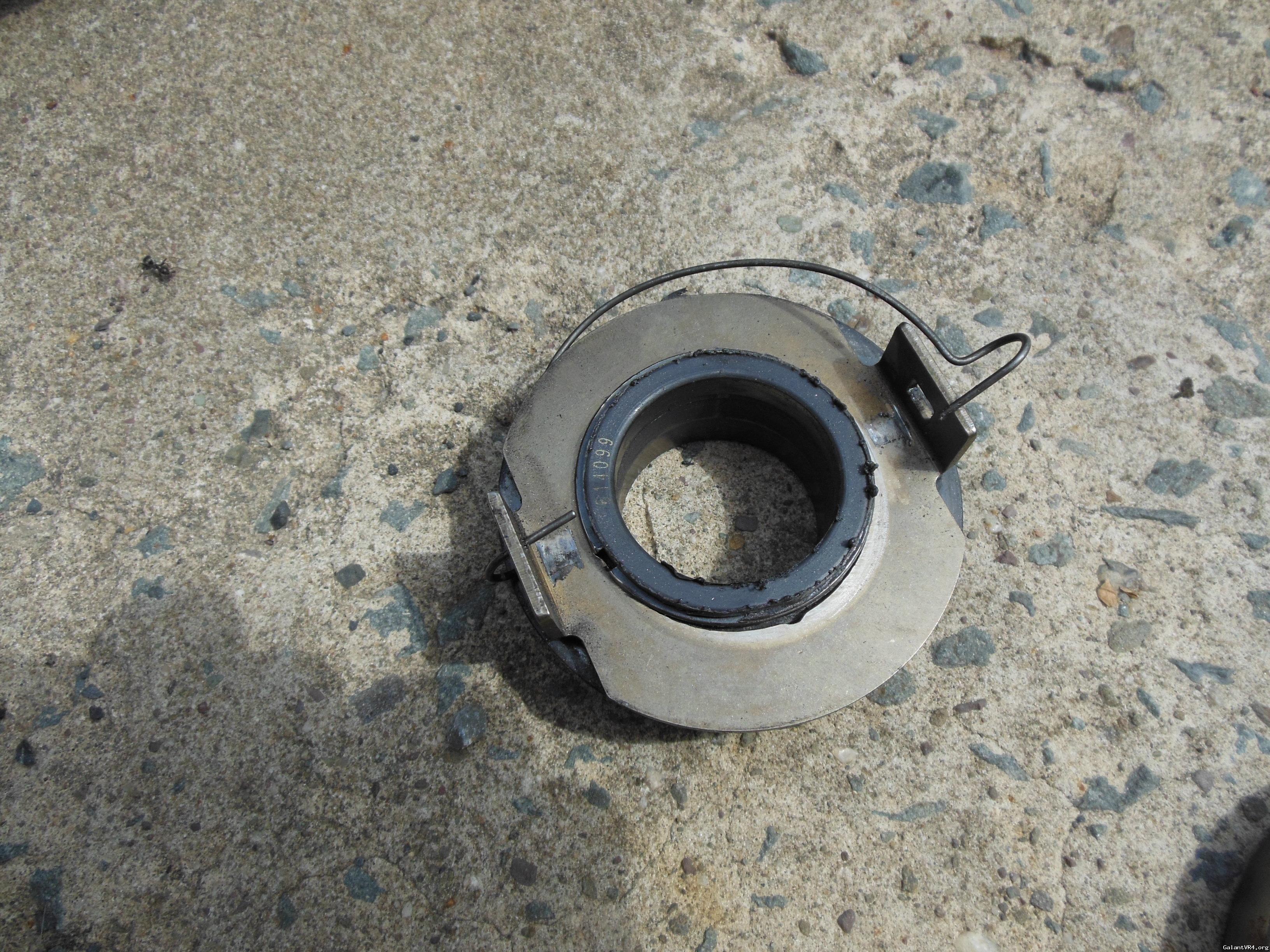

so car started to make some noise, got worse and worse, hoping it would hold out till i could get to phils(dynastylsd) place, then yesterday while pushing my clutch pedal down it felt chunky. so i woke up this morning and pulled the trans out of the car.
after an hour and 20 minutes
here is what i found.
as you can see the collar or sleeve broke off and was laying on the input shaft and just getting torn up something horrible.
while i was pulling the transmission out, the throw out bearing fell out in 2 pieces and im not sure if it can be seen, but the retainer clip is bent and won't stay in throw out bearing.
here is a little bit of the metal shavings that were left on the pressure plate and the starter.
thankfully the pressure plate and the clutch disc were still in perfect condition and the flywheel is still good. i ordered a new OEM throw out bearing and retainer clip, 3 bottles of mt-90 and 1 bottle of 75w90 redline gear oil. i was planning on bringing the transmission out to phil tonight and having him replace the bellhousing and check everything over, but my dad found a trans for 300 locally. im going to pick that up, install it in the car and hopefully be good to go. then bring the broken transmission out to phil(dynastylsd) and have him hold on to the transmission for a little bit while i save up the funds and buy a rebuild kit, new double syncro 2nd gear set, evo 3 5th gear set and a few other little odds and end for the transmission, then have him build me one beautiful transmission and then ship it out to me.
