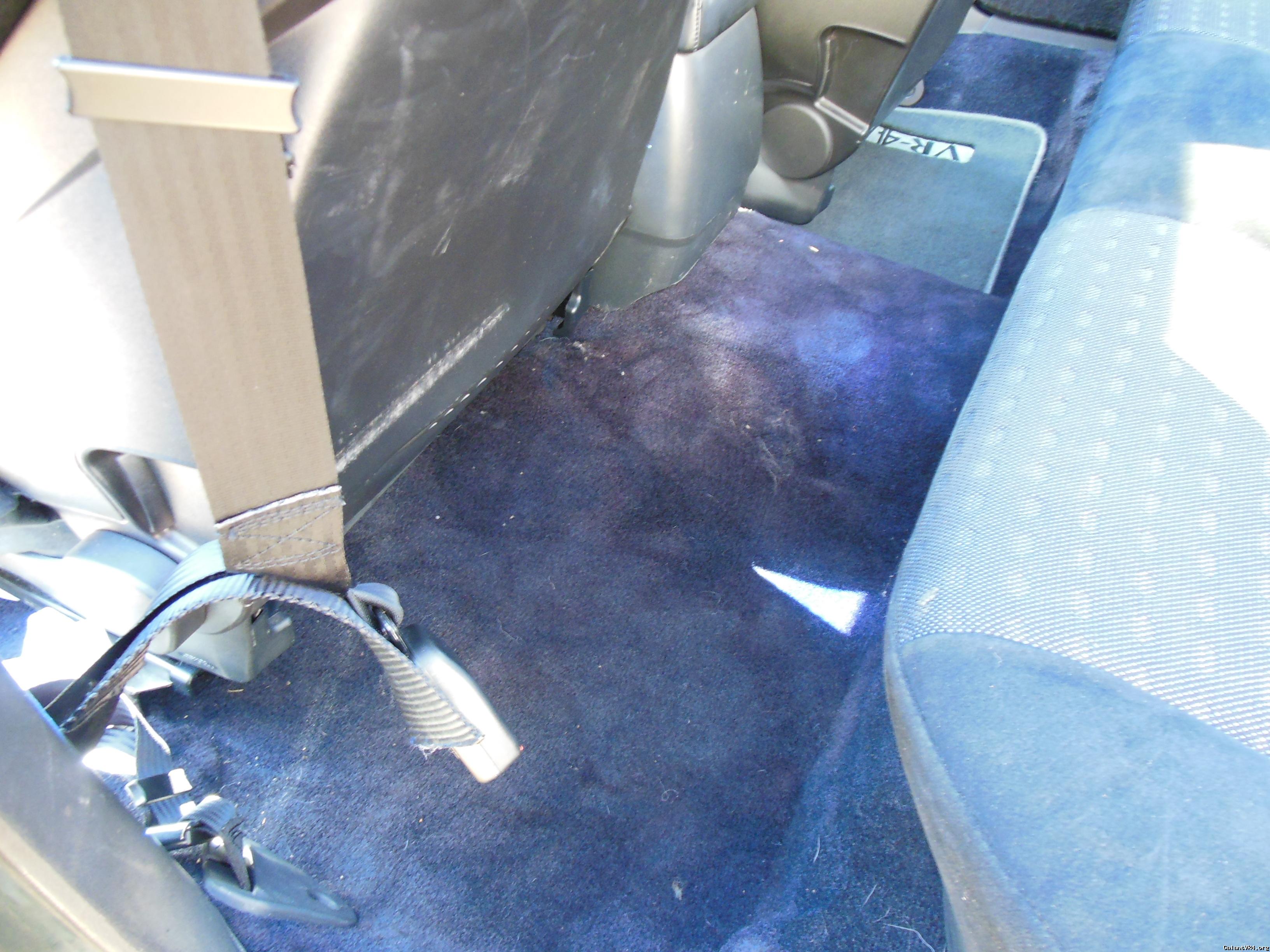

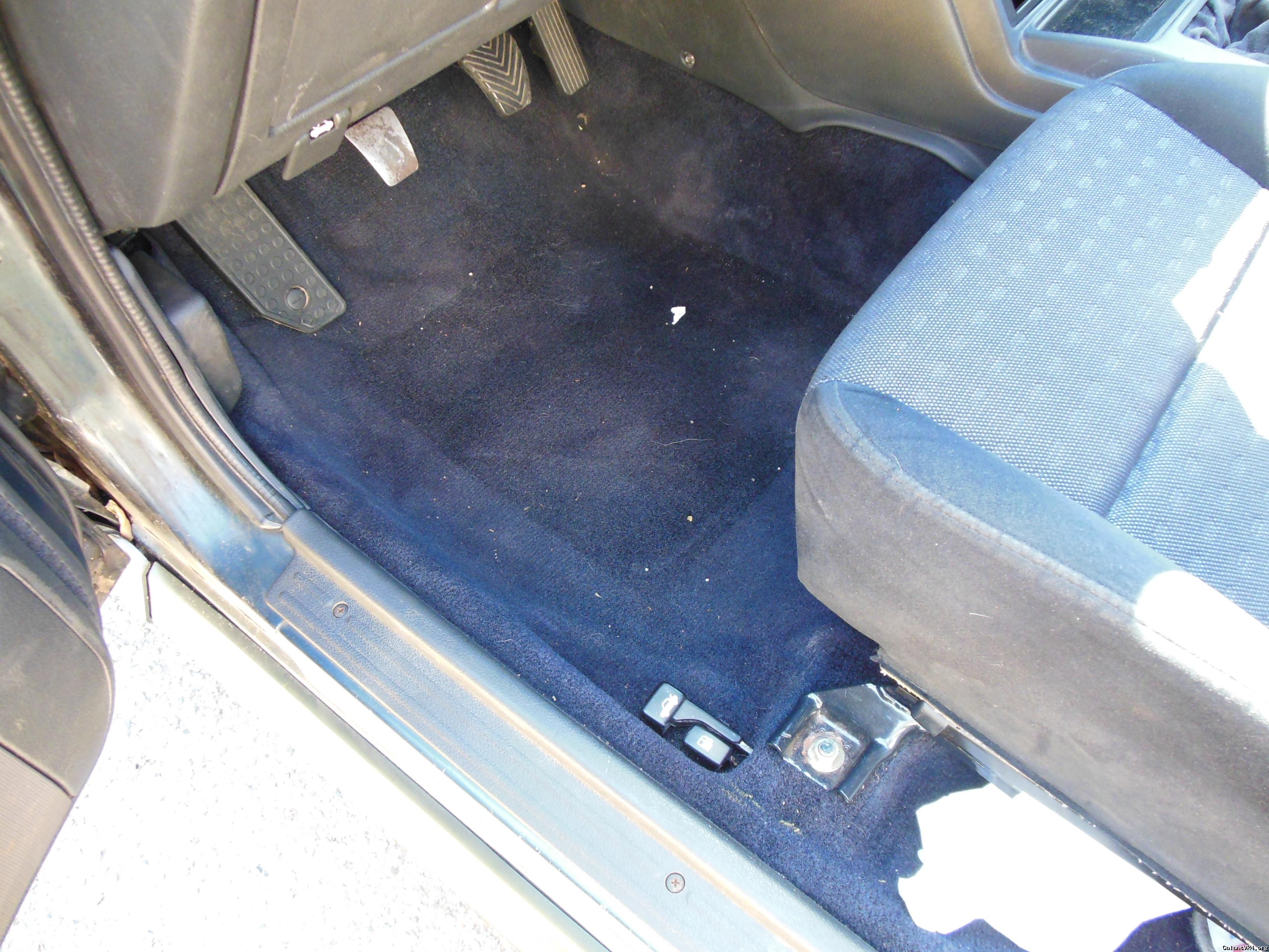

Ok so it has been 6000 miles and 2 oil changes and the VR4 is still running super strong. i love my car. its so much fun.
im starting with the pictures of the new carpet installed.
i think it came out really good.
the front is a little dirty, but at the same time i drive the car so i kinda like it to be dirty.

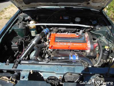

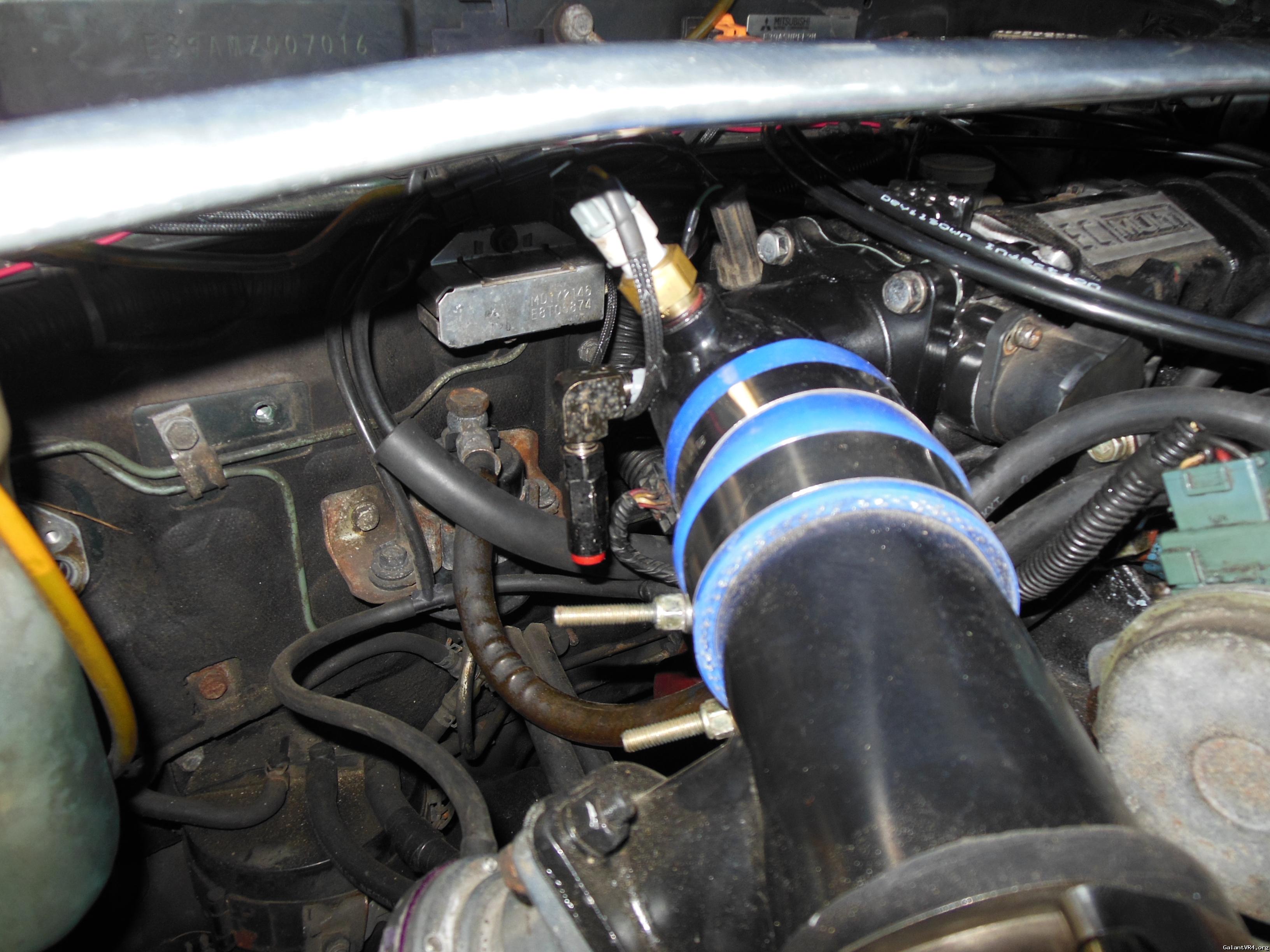

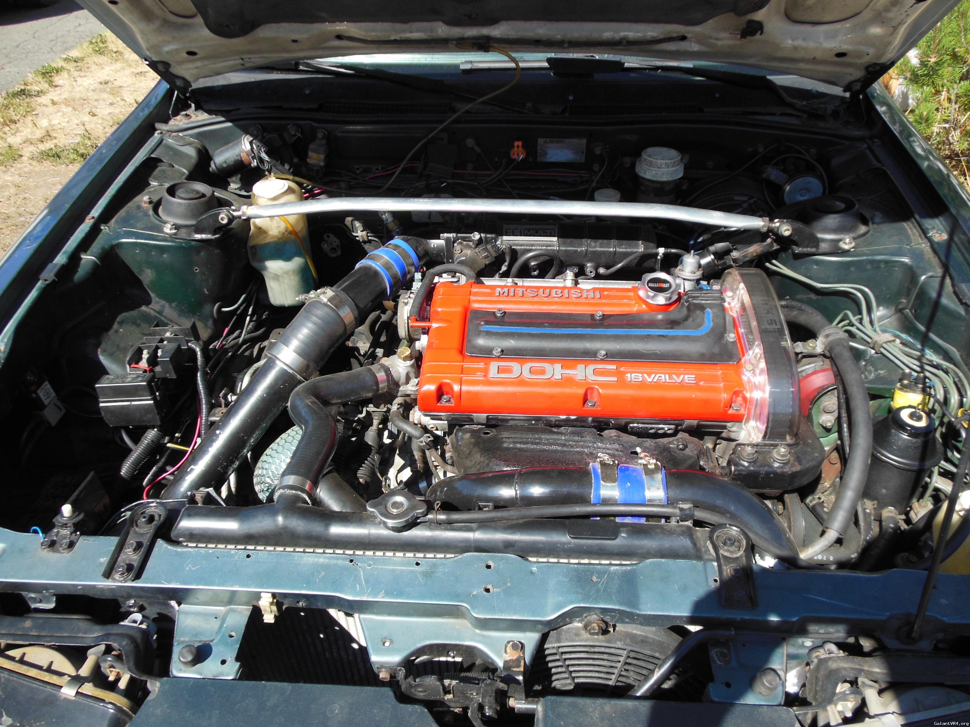

after we got to tahoe i decided to add a strut tower bar. made a bit of a difference through turns and it looks pretty good in there.

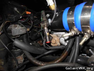

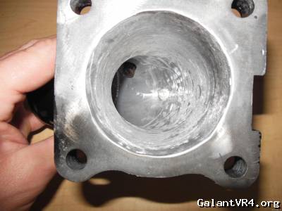

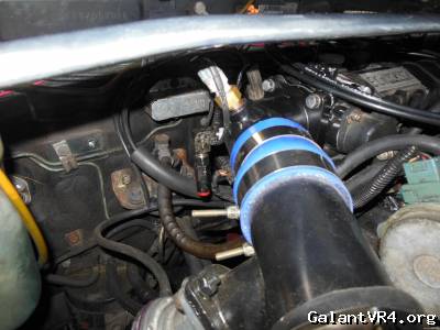

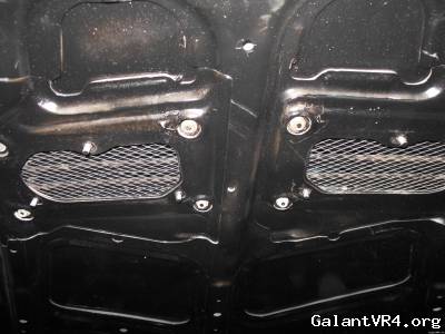

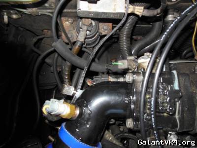

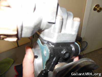

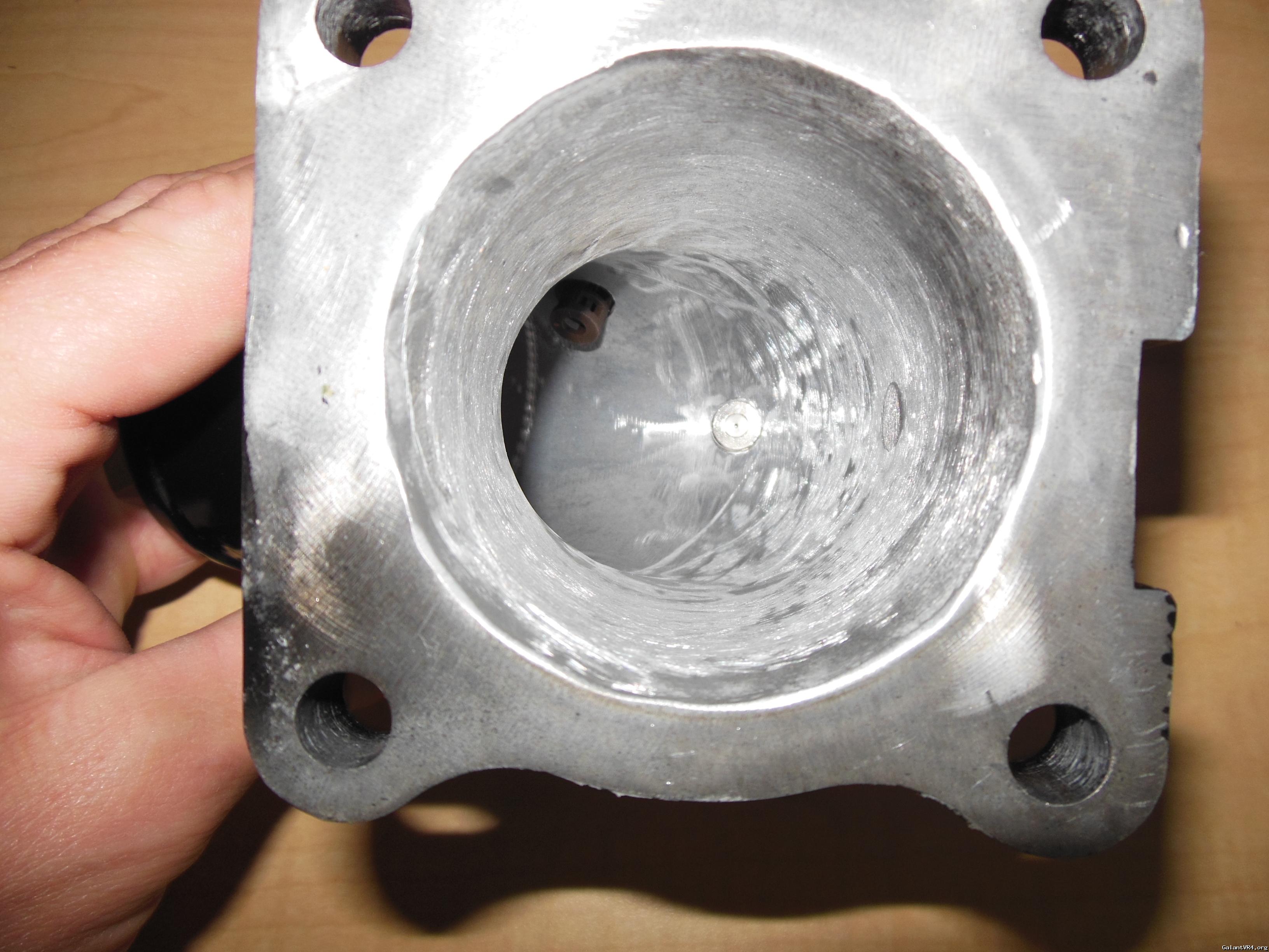

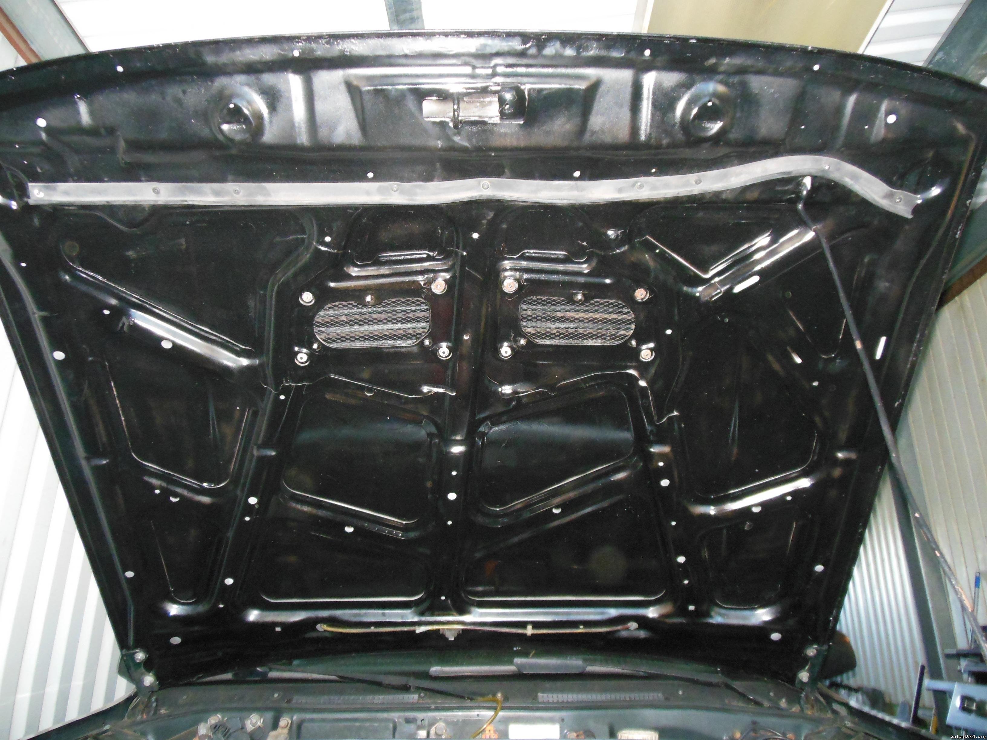

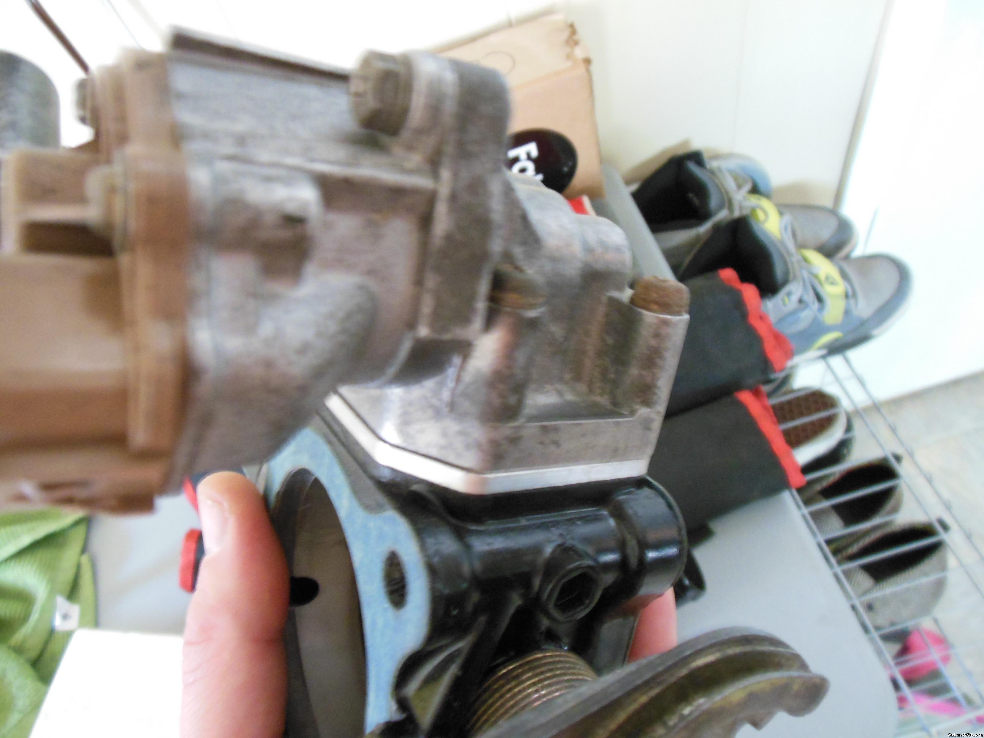

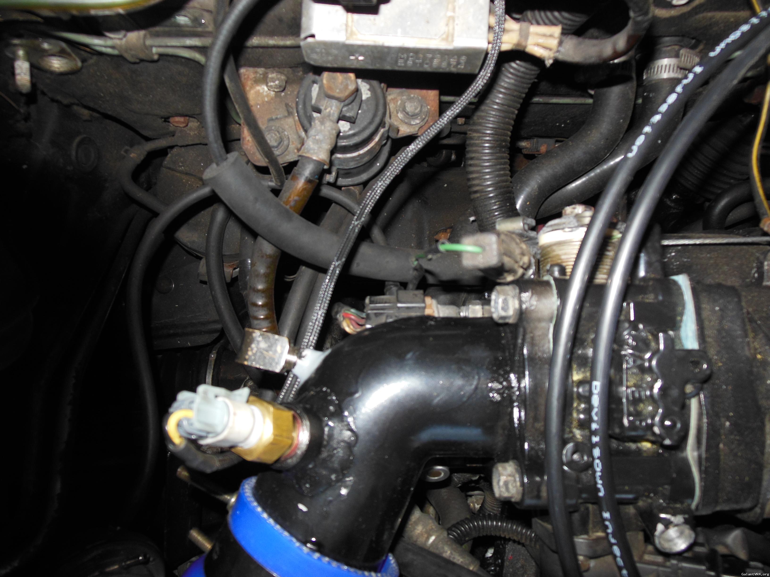

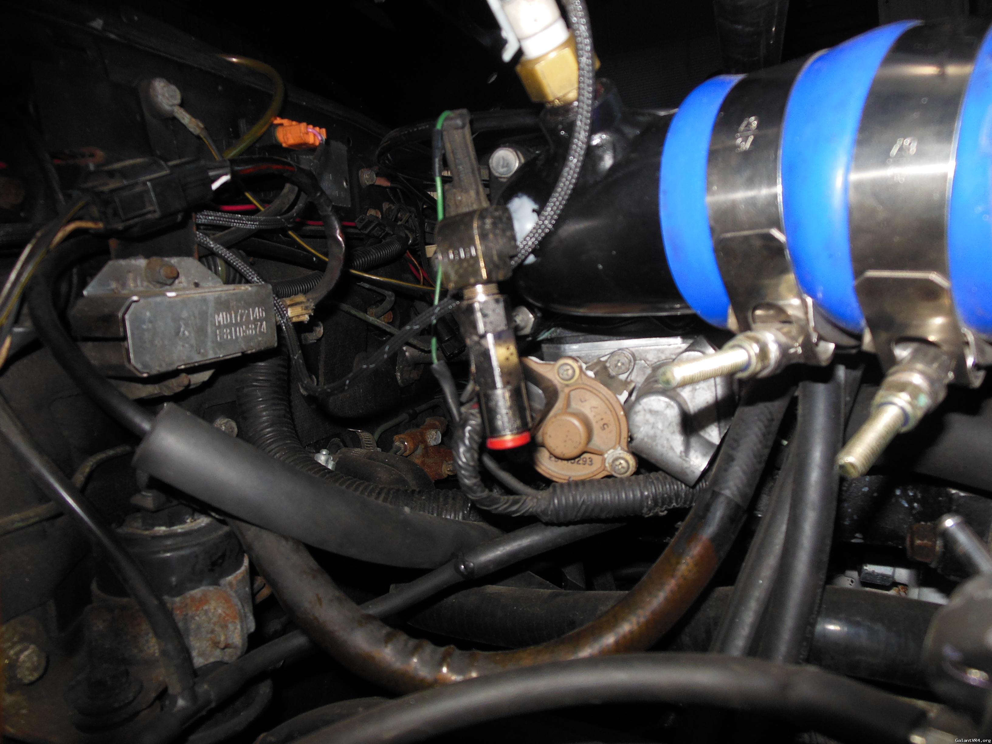

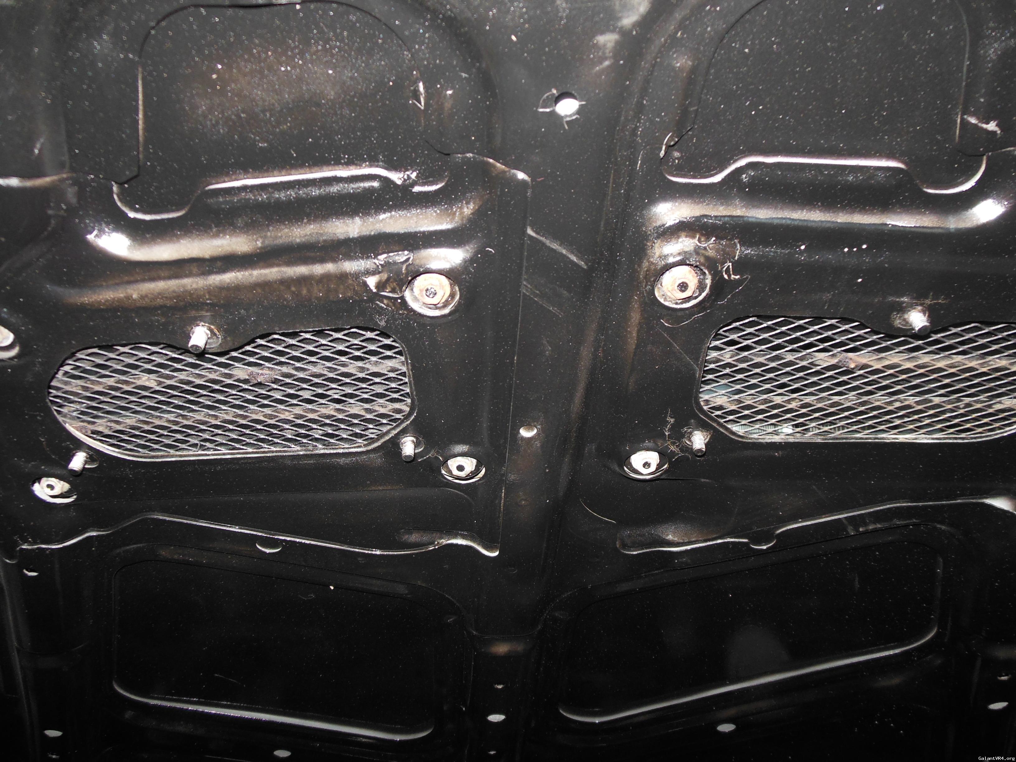

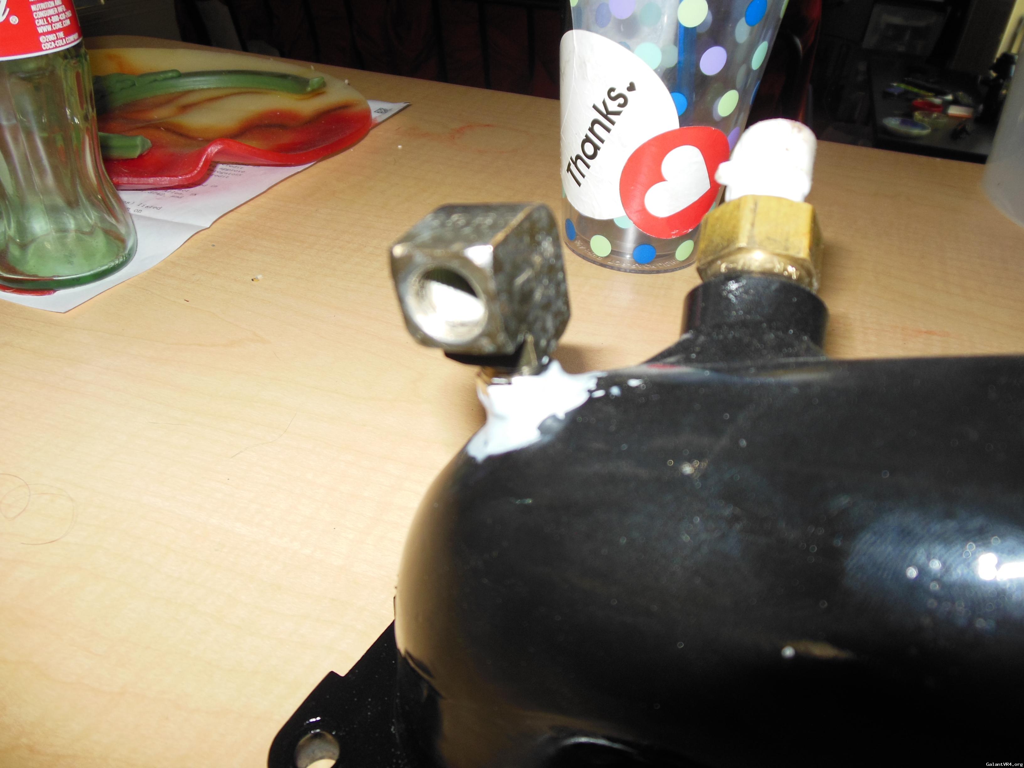

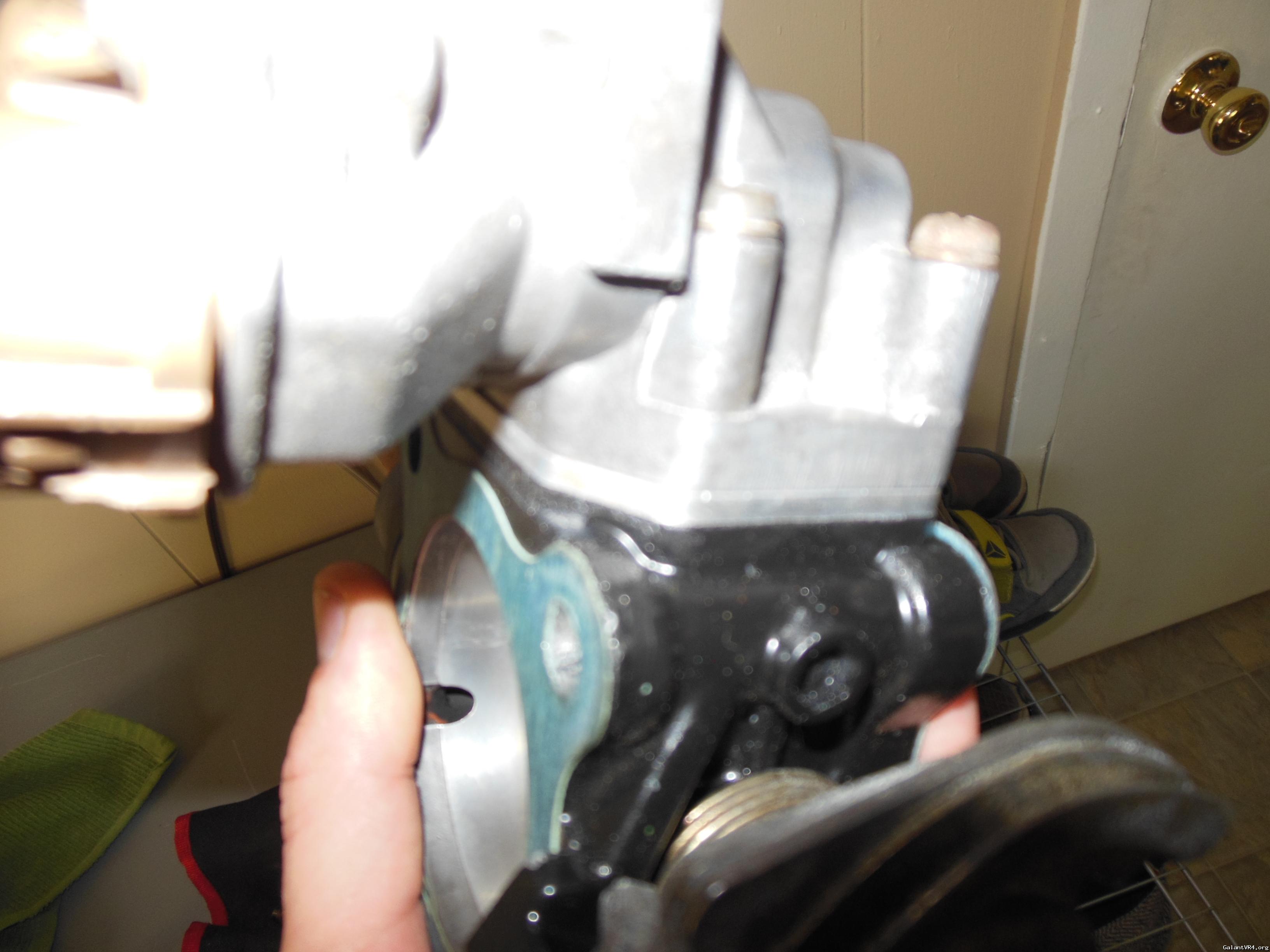

so i did a little work on 138 today. painted the underside of the hood, removed the heat sheild and opened the vents so there functional, ran the rest of the lines for the meth kit, drilled, tapped and lightly ported the throttle body elbow and then jb welded the nozzle in place, added a FIAV block off plate that i had laying around.

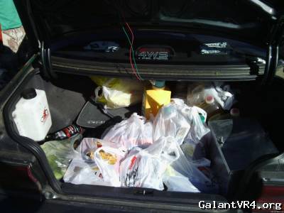

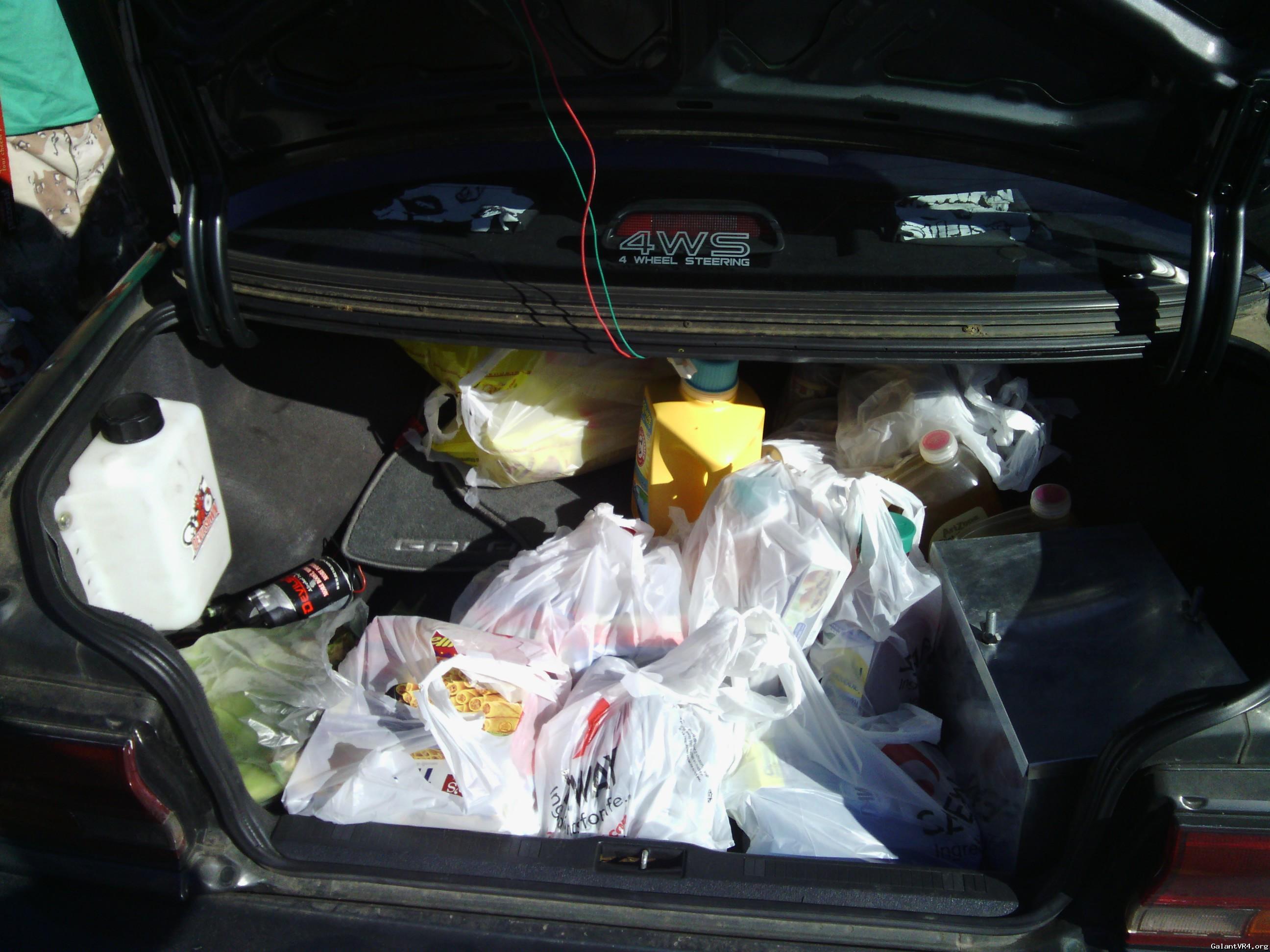

this is some grocery getting..
