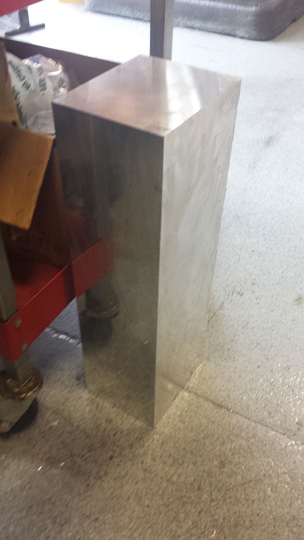

Well I think its time to make a TRUE billet intake. No welding. Bolts, Billet, and seals. Picked up a chunk of MIC 6 and going to get started on it this weekend.
jeverts
Jul 14, 2011
305
Hartford, WI
This is just for the runners. Its way more than I need. Discount steel up here has a drop section that you can dig through to get material so its a little more discounted than off the shelf. It was $250 for that but I am going to saw probably 2 inches off the length and chop it in half the long way.

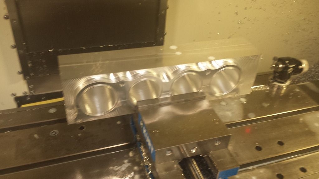

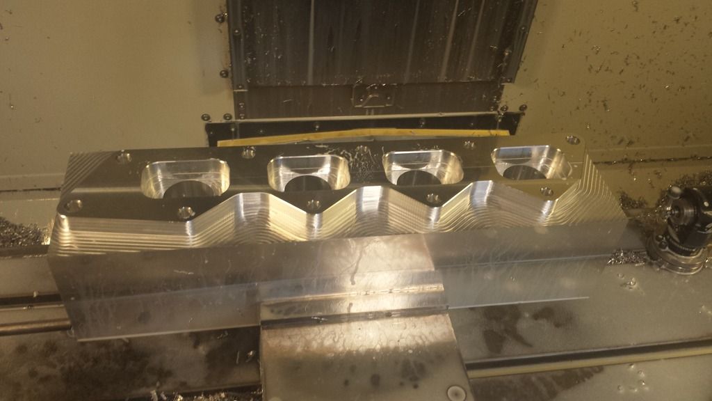

I know most people won't understand but there is a lot of satisfaction that comes from being able to create some from a raw piece of material into something that I consider to be a work of art and I am saying that for everyone that works in my field. I enjoy what I do and I will do this more as a learning experience and as a challenge. I am not selling these, and if it doesn't perform the best it won't bother me. Its more of a; "I designed that and built it". Not many people can say that.

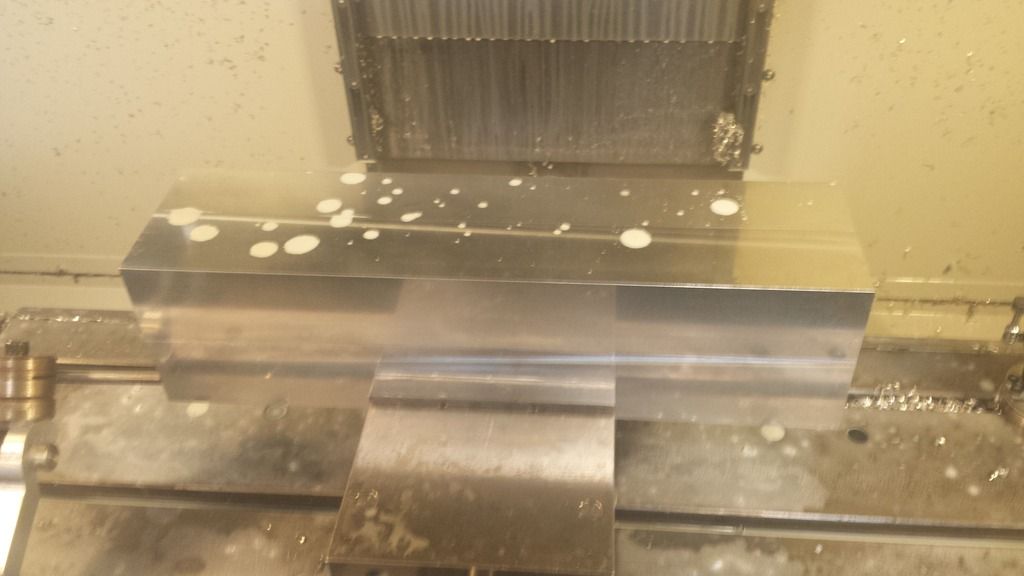

All finished up.
transparentdsm
Jul 27, 2011
3,690
Cherry Hill, NJ
looks soo good. is your camera inverting the pictures? it looks like the spot where the egr would be is on the wrong side. it could also be me.
jeverts
Jul 14, 2011
305
Hartford, WI
You freaked me out. I was at home when I read that. No, its good I think you are looking at it upside down. Most of the intake flanges that are made are not flat across the top. I did that to make it easier on myself for machining.
jeverts
Jul 14, 2011
305
Hartford, WI
Not sure if sarcasm? /ubbthreads/images/graemlins/smile.gif Sorry I was vague on that. I meant to say, the head side flange is flat across the top side.
