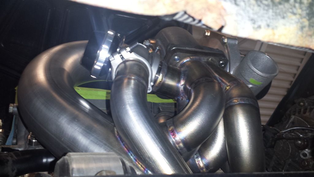

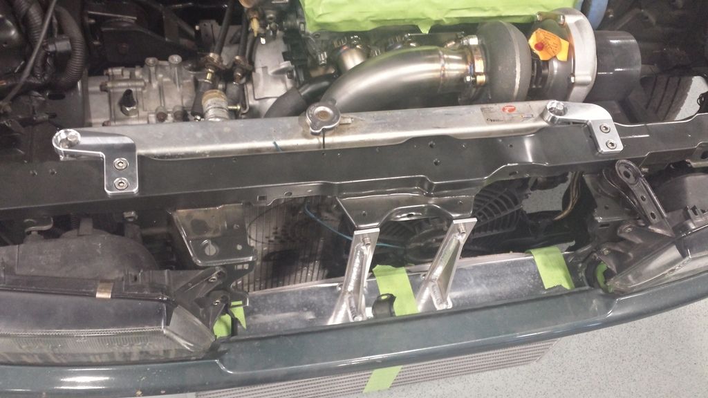

Sunday Funday. Got my radiator mounts made. My measurements are a little off but nothing that I can't cut the pegs off and re-weld them won't take care of. Also got some mounting brackets done for the intercooler.

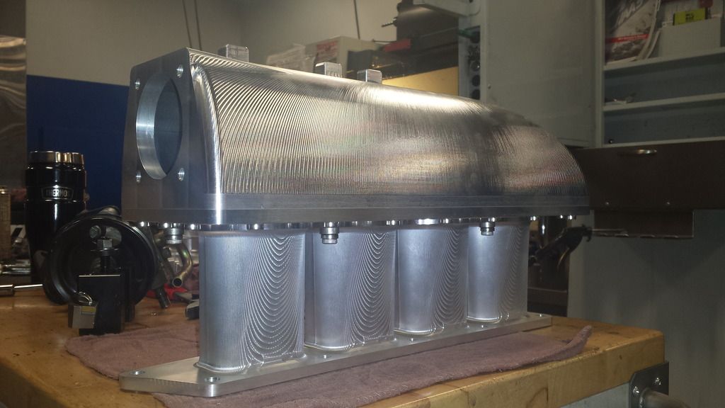

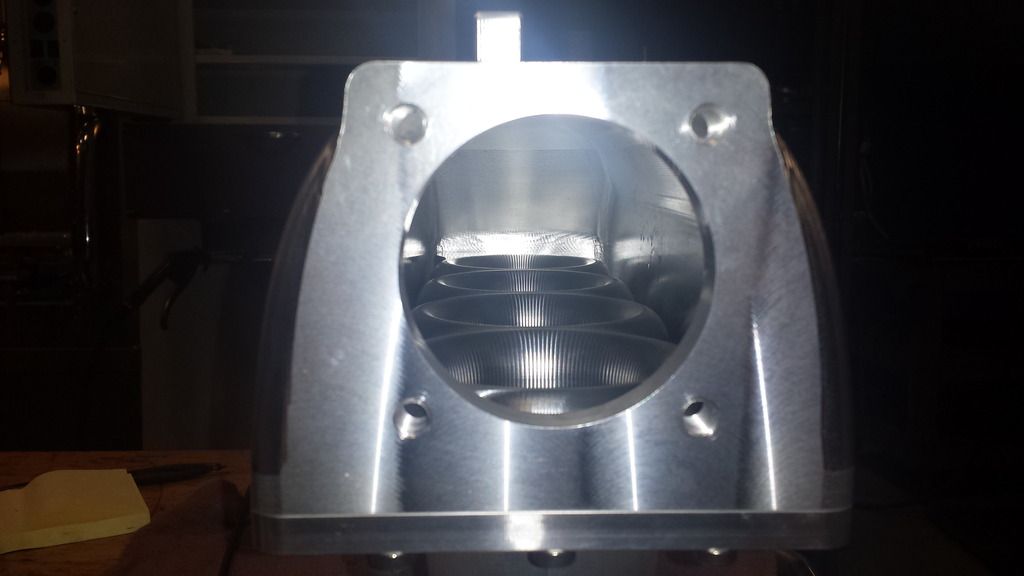

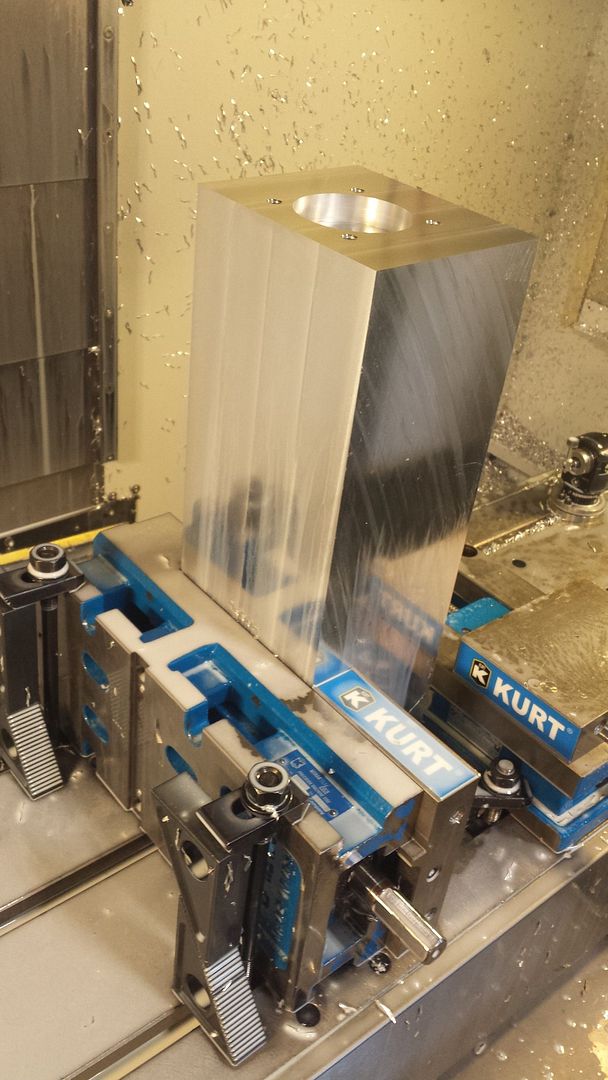

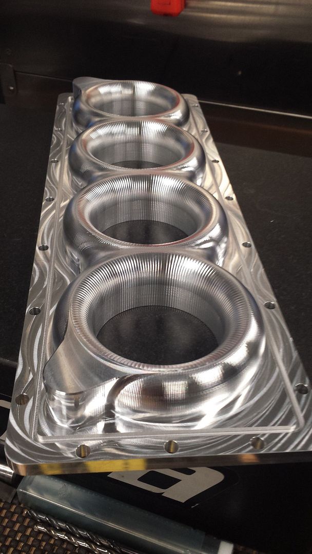

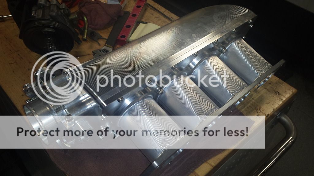

Making some more progress on 909

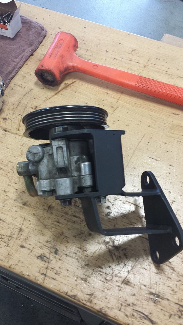

Had a guy at work fab me up a bracket to relocated the power steering.

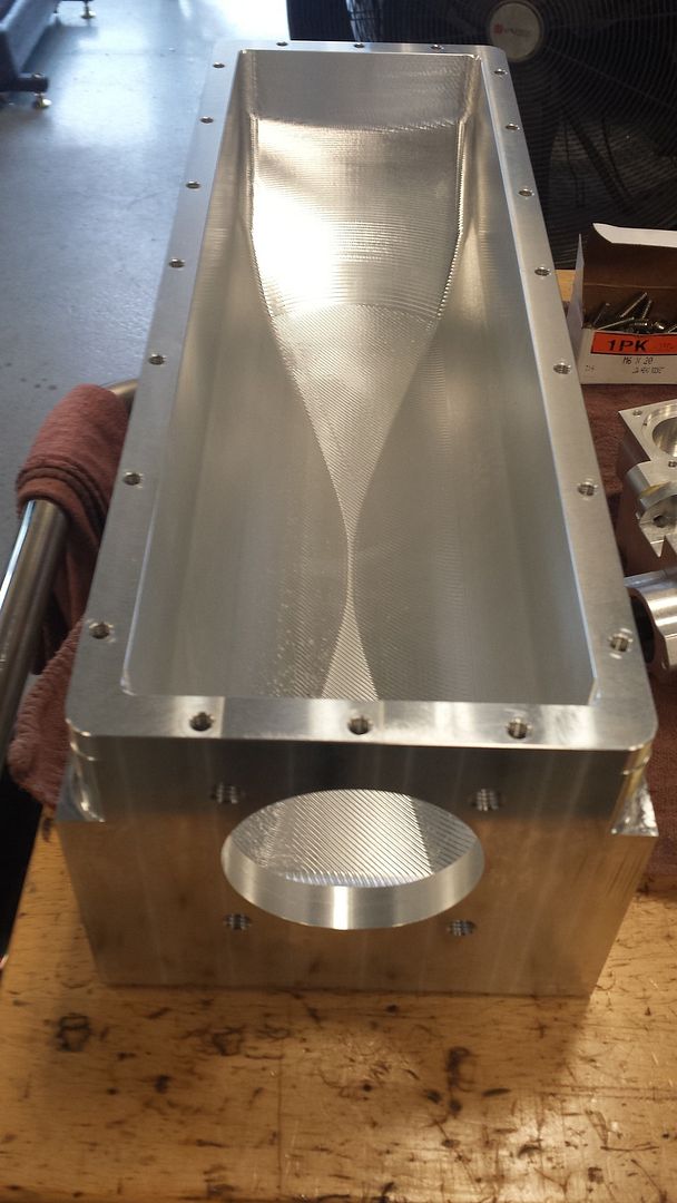

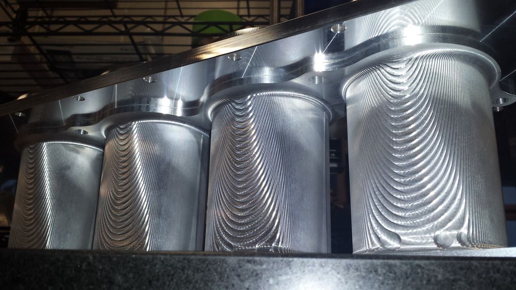

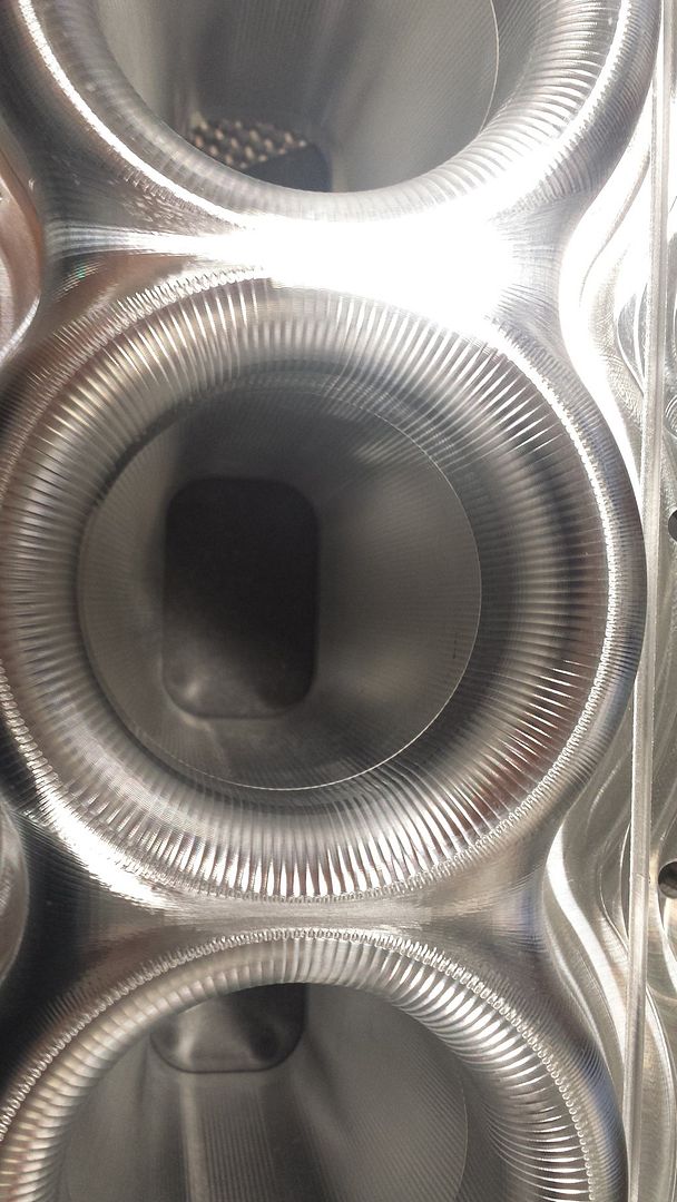

I was also able to work on finishing up the intake manifold. Still have a little bit to go. I am hoping by this weekend I can finish it up.

That's sweet, how much $ do you think you spent on materials?
jeverts
Jul 14, 2011
305
Hartford, WI
Quoting G:
About $500 in materials. Which I splurge on getting MIC 6 instead of 6061. Probably would have been in the $300 range if I used 6061.
Thanks guys.

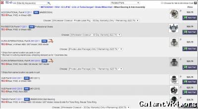

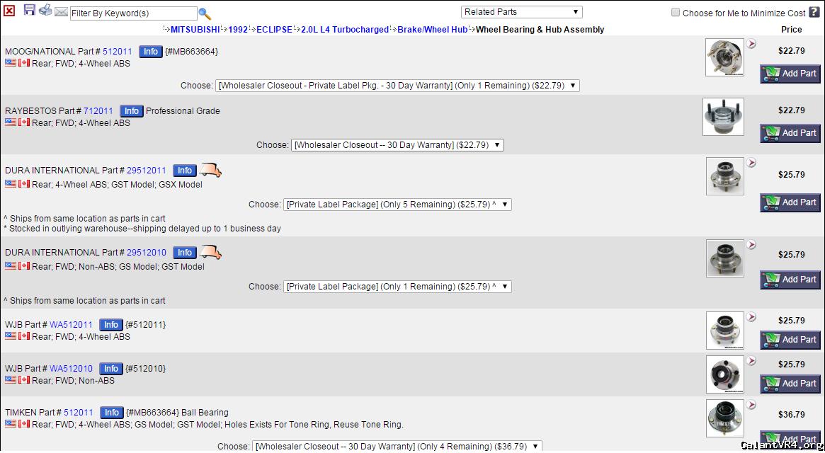

I am going to do the 5 lug conversion on my galant but not sure what hubs to get? The rock auto is a little confusing, or maybe I am looking at this wrong.
