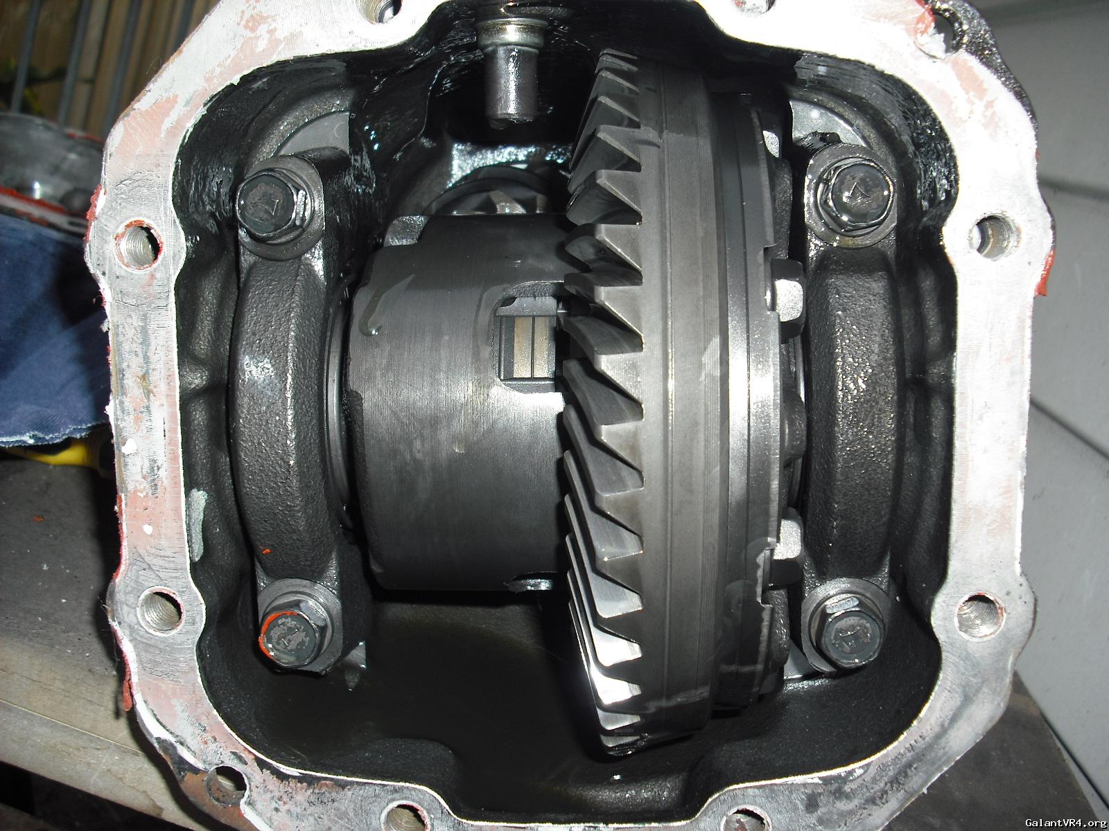

speaking of mech lsd's i got one sold as a evo 3 one for $55nzd this morning.
it has the "washer" so its a mech, just weather its a e1 rs or e2 or 3 one is yet to be confirmed.
approx $38 usd goodness

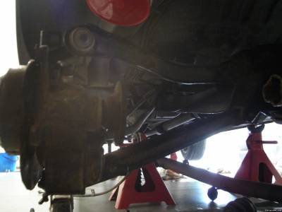

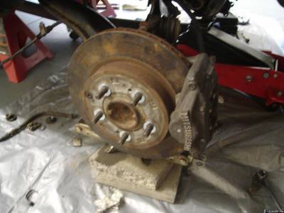

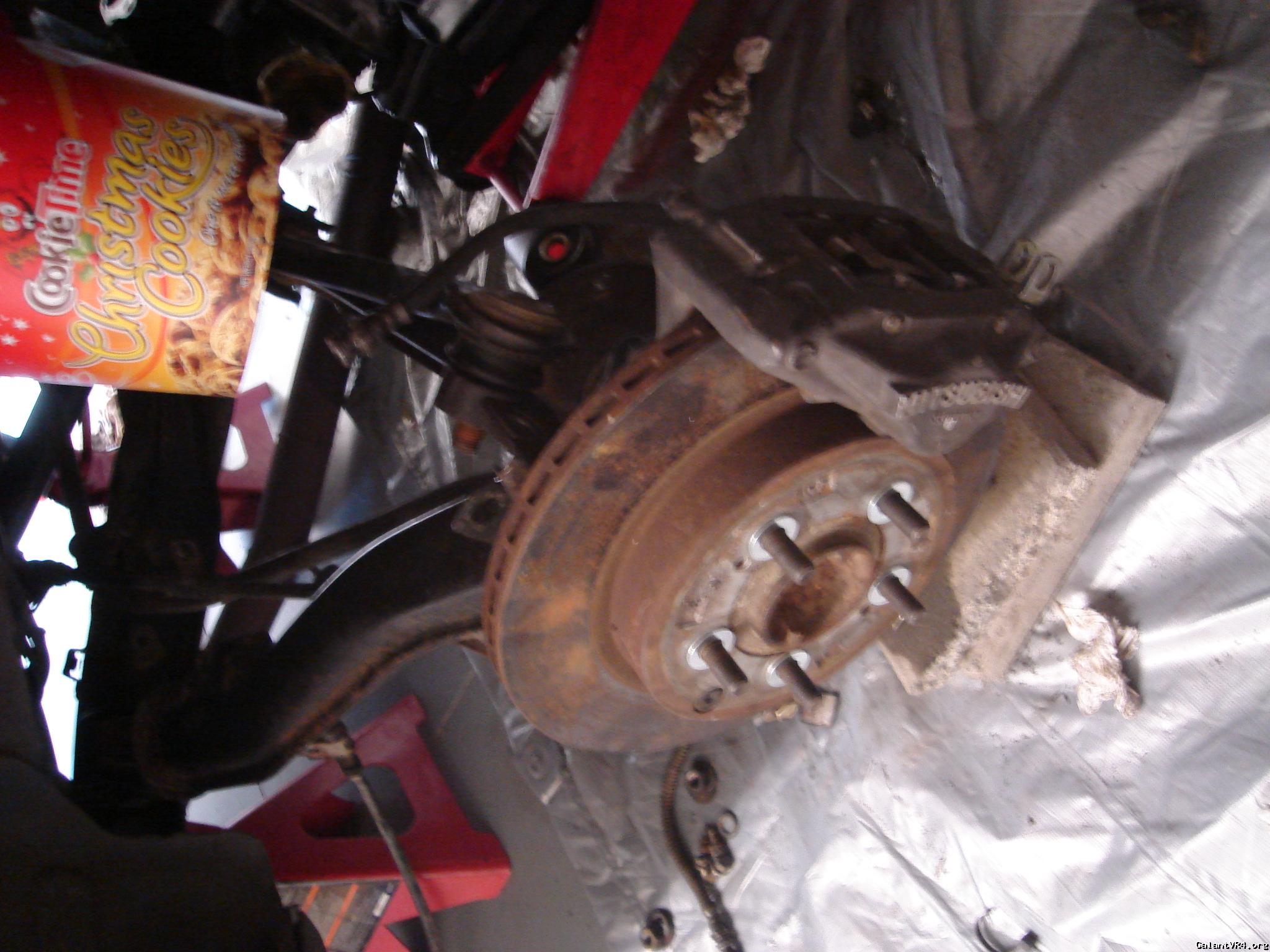

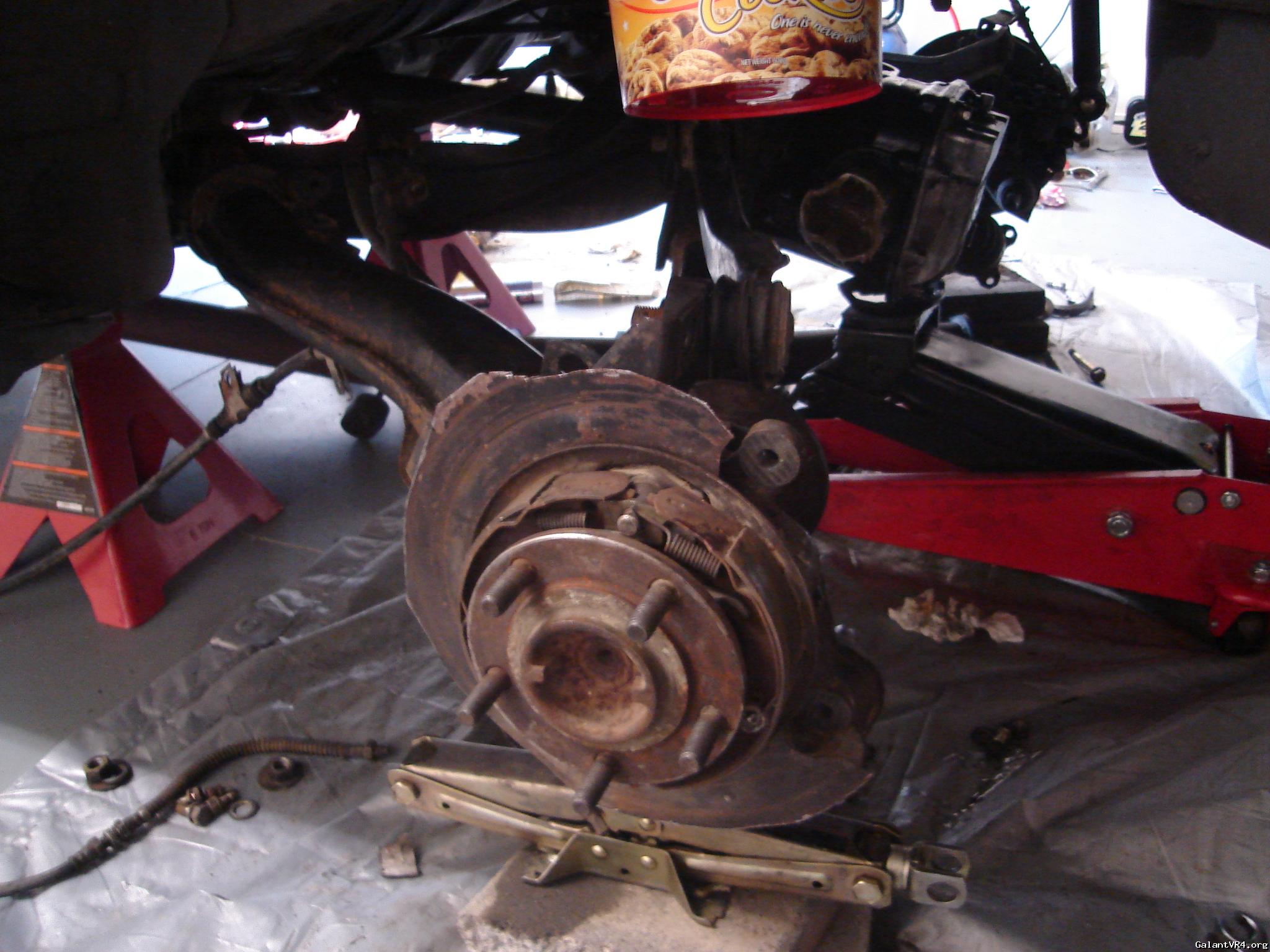

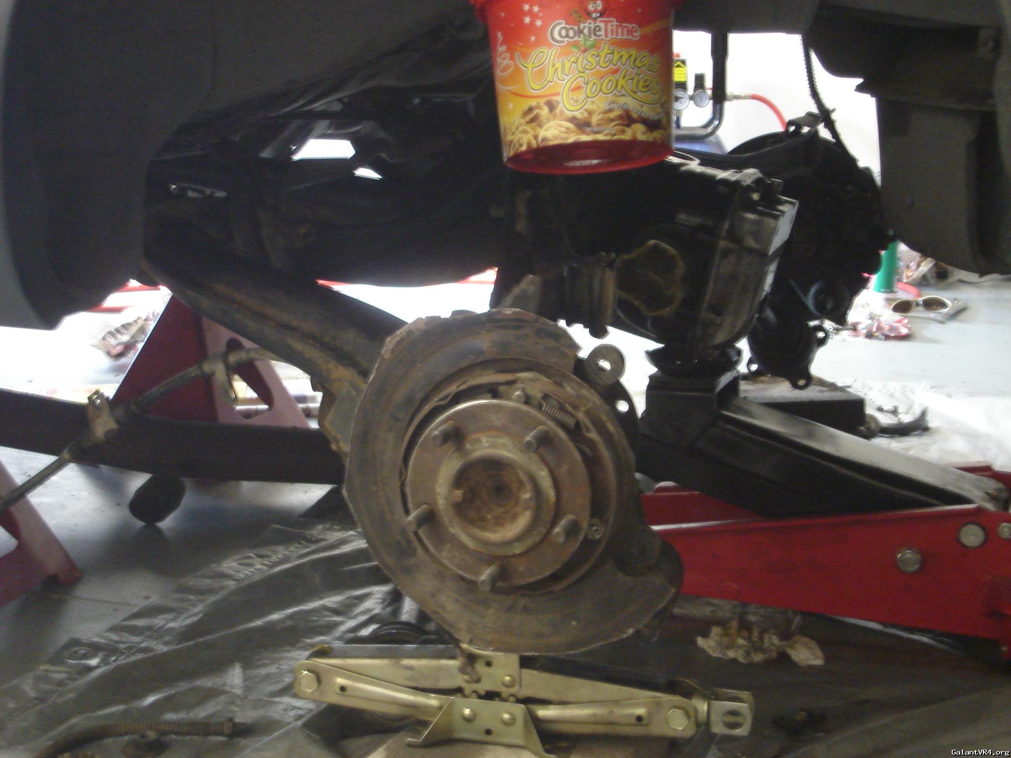

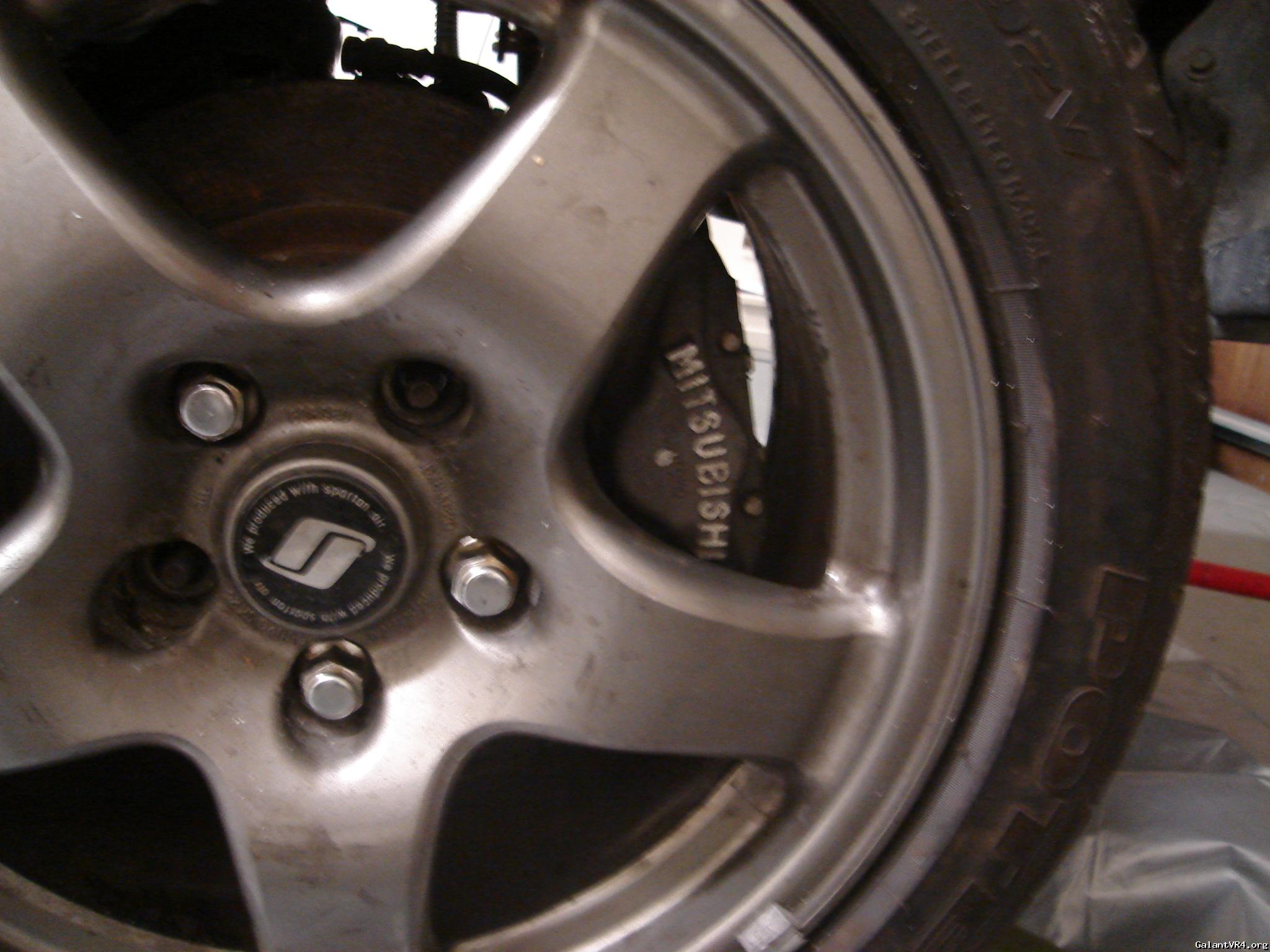

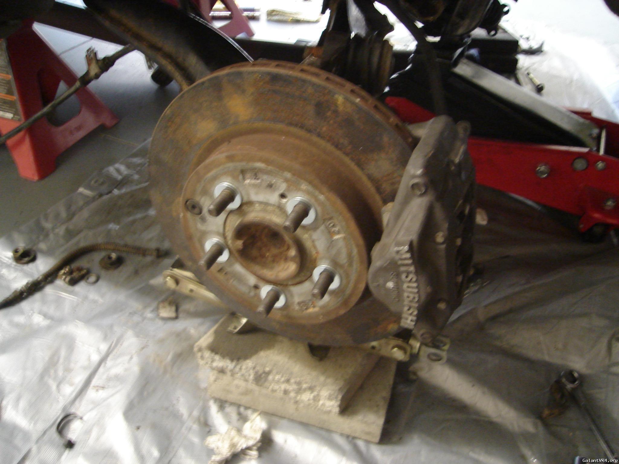

GTO/3000GT/Diamante trailing arm. I had to hit the dust shields with an angle grinder so I can run the larger 297mm discs and twin piston calipers, over the 284mm single piston calipers.
And on the car - all the arms bolt up, sway bar lines up /ubbthreads/images/graemlins/laugh.gif
It looks like the eccentric camber bolt washer actually reduces the total available camber adjustment significantly.
Also, at first fitting it appears to give a noticeable increase to toe in! Compared to the factory trailing arms it almost looks like it's bent /ubbthreads/images/graemlins/shocked.gif

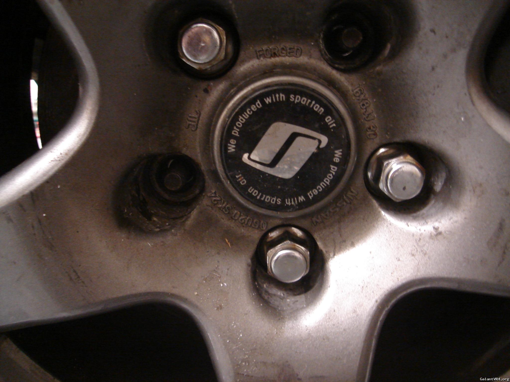

Brakes on! Notice the Rangi wheel spacers (aka washers) /ubbthreads/images/graemlins/rofl.gif These are only temporary! the center bore of the hub is about 2mm too deep for the wheels I'm going to use - for some reason the bloody wheels center bore tapers inwards! Time for more angle grinding /ubbthreads/images/graemlins/rofl.gif
Damn, I should splash on some new batteries so I can use the flash /ubbthreads/images/graemlins/rofl.gif

Interesting, do the GTO trailing arms increase the rear track much/any?
I've got a pair of n/a GTO rear axles (splines are the same as an evo/4 bolt plate lsd) and they are somewhat longer than vr4 axles.
Also if I were to go down this route I may not be able to fit my wheels under the rear guards

like the cookie time suspension, is that a new product on the market? /ubbthreads/images/graemlins/rofl.gif
RedTwo
Jul 16, 2008
1,921
New Zealand
I'm not rolling on bump stops - I'm rolling on cookie crumbs! /ubbthreads/images/graemlins/idea.gif /ubbthreads/images/graemlins/rofl.gif It's just there to catch all the brake fluid /ubbthreads/images/graemlins/laugh.gif

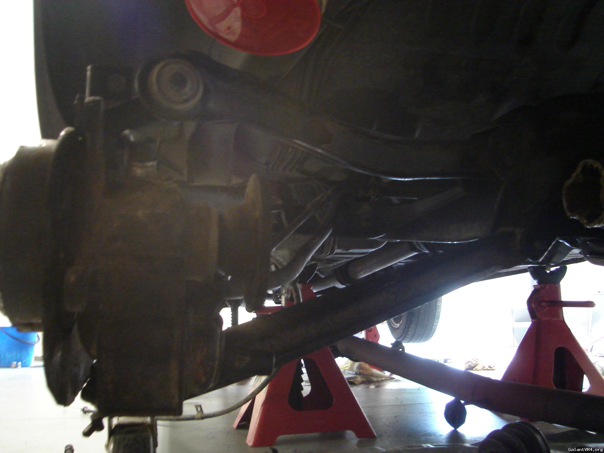

From memory the track on both vehicles is about the same, but does it change when you swap bits around? The GTO runs 8 inch wide wheels and the upper control? arm is the same length as the VR4 but the GTO axle (and therefore the subframe) is slightly longer/wider. However the drum brake causes the rotor to stick out (from the trailing arm) a little further than the VR4.
The suspension is just sitting there with the bolts in to stop it falling off. I haven't played with the adjustment yet and I don't know for sure if it's actually increased the toe or it's just a visual thing. I will play with it and see what I come up with.
A little extra 'toe in' on the rear isn't *that* bad /ubbthreads/images/graemlins/idea.gif improves straight line stability at the cost of tire wear and cornering response - it's not like we launch these cars around corners /ubbthreads/images/graemlins/rofl.gif /ubbthreads/images/graemlins/grin.gif

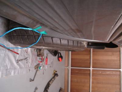

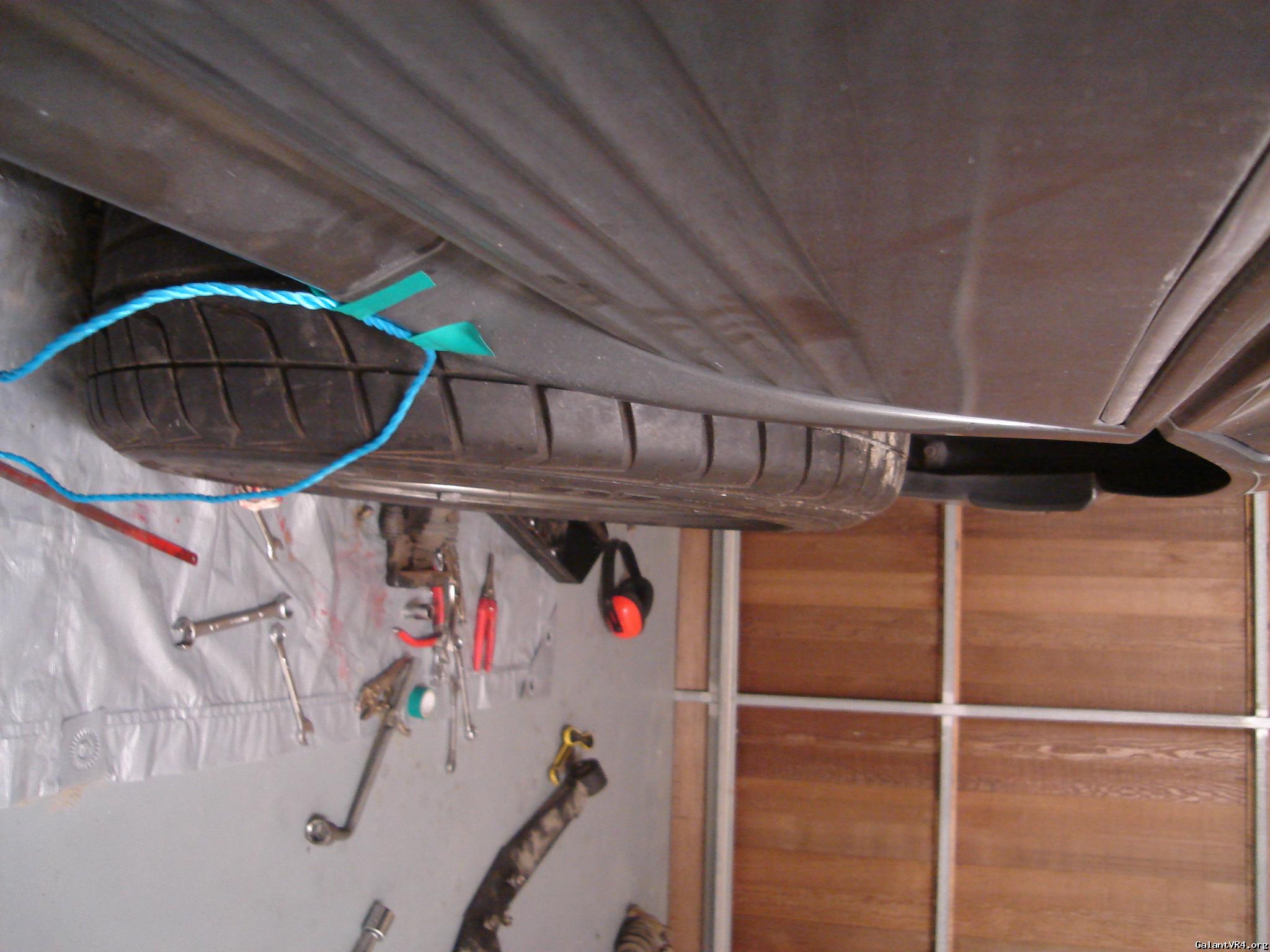

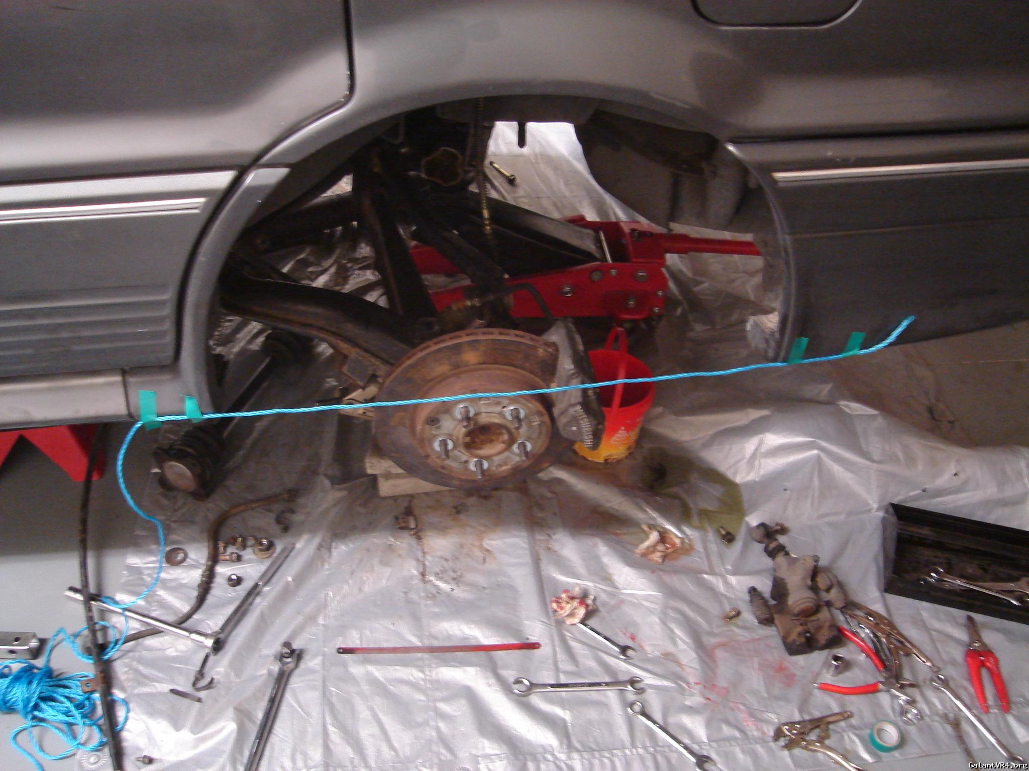

I got high tech /ubbthreads/images/graemlins/rofl.gif and measured this new trailing arm set up versus the stock one.
String line FTW!
First discovery: GTO trailing arms increase the track/offset by about 10mm, so about a +20mm increase overall!
With all the eccentric washers removed and the nuts removed I did some brute force measurements through the toe and camber range. There is a whole heap of inaccuracy? in my method so take all of this with a grain of salt! So I based on the assumption that the side skirts are parallel to the direction of travel and I can't guarantee the accuracy of the camber calculation.
GTO:
Toe +0.03* to +0.85* (or 1'48" to 51') (61.5mm to 65.2mm)
Camber -7.01* (or 7*0'34") (63.4mm to 78.4mm)
VR4
Toe +1.58* to +1.92* (79.5mm to 82.0mm)
Camber -8.07* (75.5mm to 91.0mm)
The factory adjustment range is according to the FSM:
Toe 3 +/- 3mm
Camber -1*00' +/- 30'
So in conclusion - I have no f***ing idea if it improves things or not /ubbthreads/images/graemlins/grin.gif /ubbthreads/images/graemlins/rofl.gif

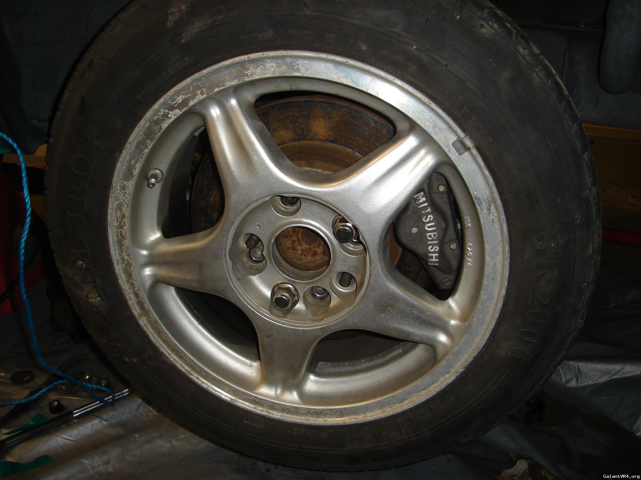

Somehow the old 15" wheels fit on over the ~300mm rotors! Would need to grind off the Mitsubishi letters or run another spacer (washer) for it to work
16x8 +30 also clears these brakes /ubbthreads/images/graemlins/rofl.gif
This Is SPARTA!
I think it's sticking out just a tad too much /ubbthreads/images/graemlins/rofl.gif I think this means the fronts will be worse. Maybe it's time to fab up those box fenders I've been day dreaming about!

You won't need box fenders, the camber gained as the suspension compresses will tuck it in I suspect. Put a jack under the wheel and try it.
For example, I have 18x9 +30's on the front (no brake disc fitted in the left hand side pics either).
RedTwo
Jul 16, 2008
1,921
New Zealand
18x9? Dang! I will have to play with it then.

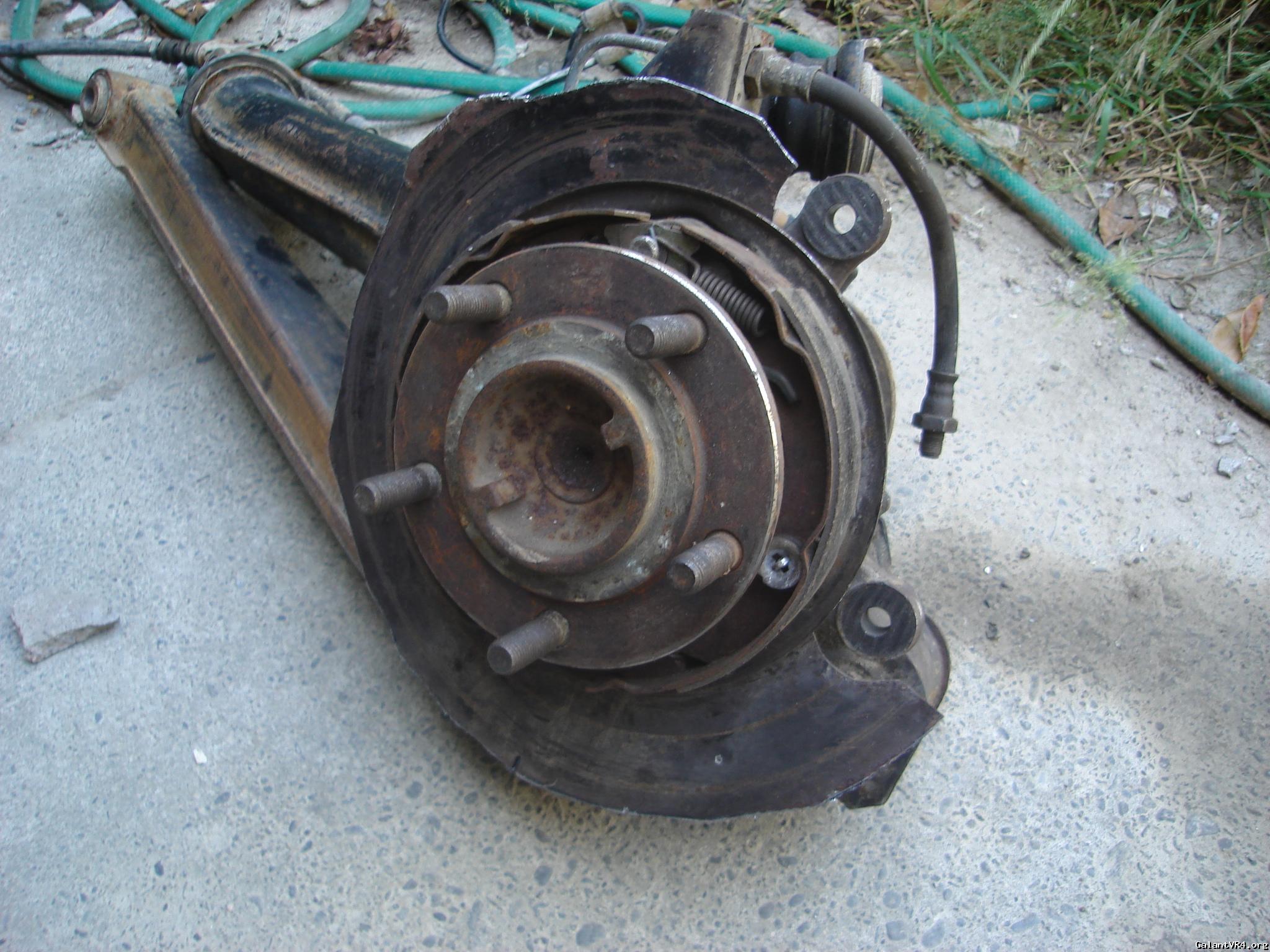

Slight hitch with the handbrake - the GTO cable extends about 150mm further than the VR4 cable, which is about 25-50mm too short to fit into the drum. Conundrums, but purhaps I can play with the stock adjustment on the handbrake

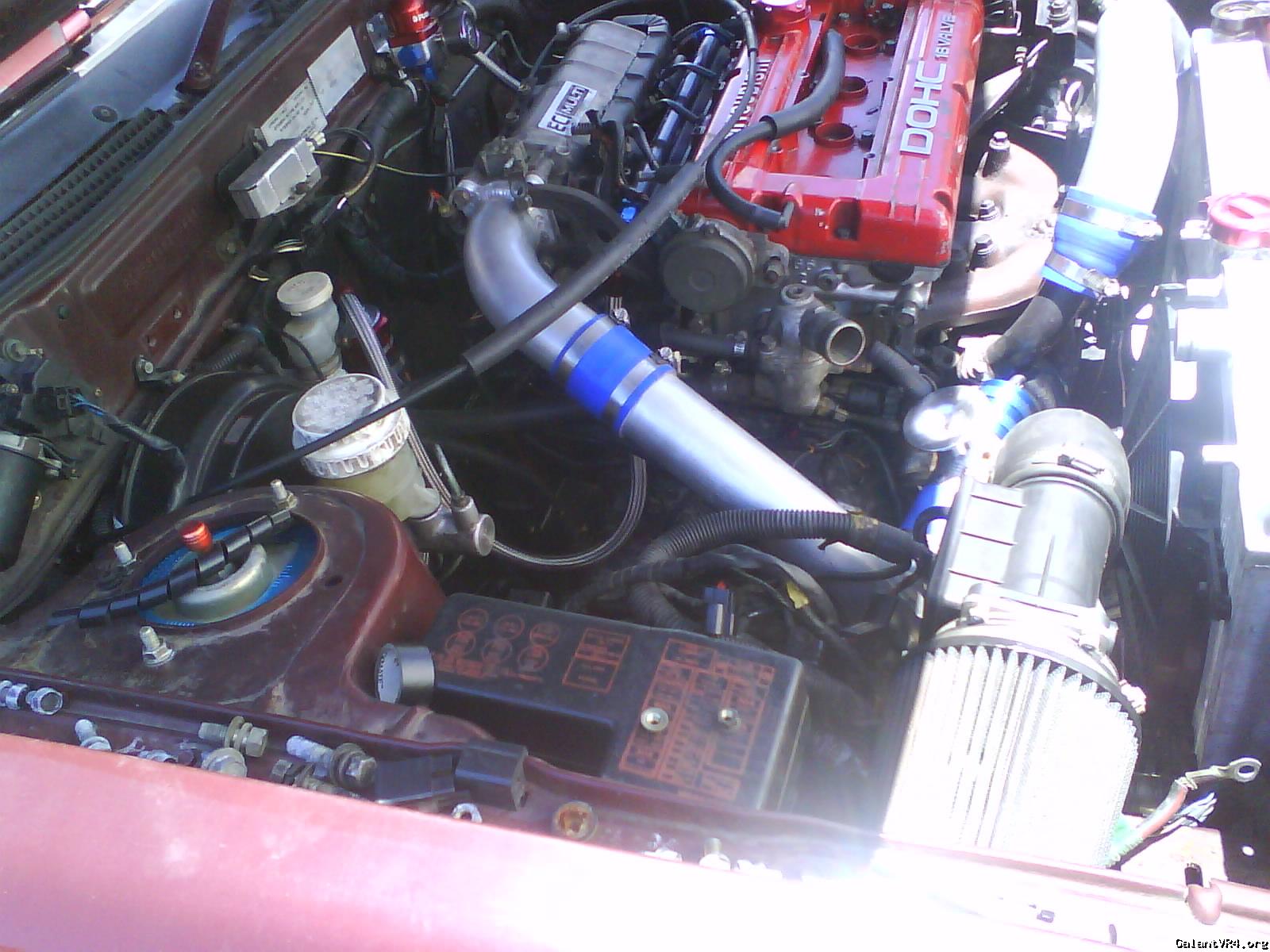

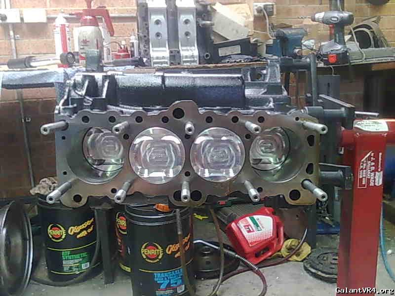

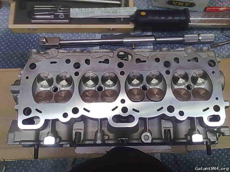

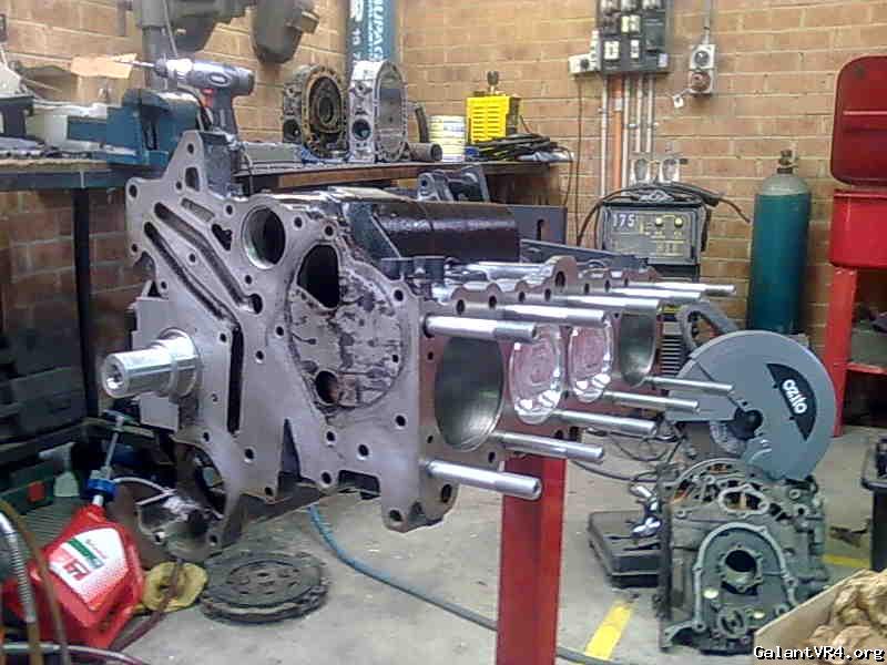

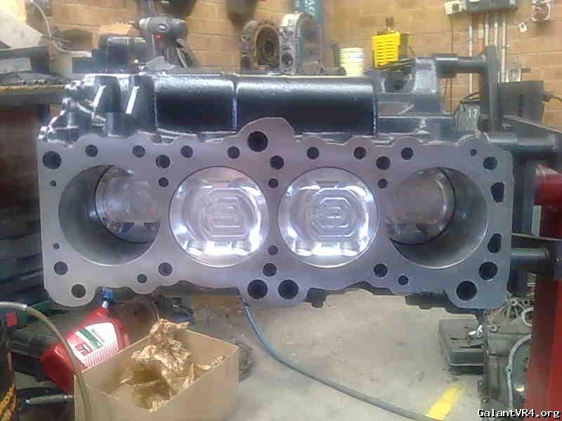

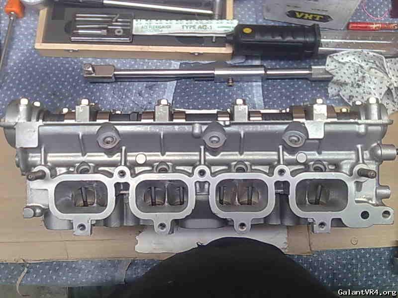

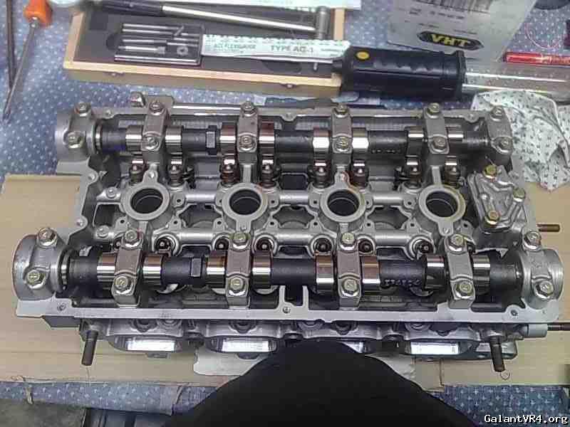

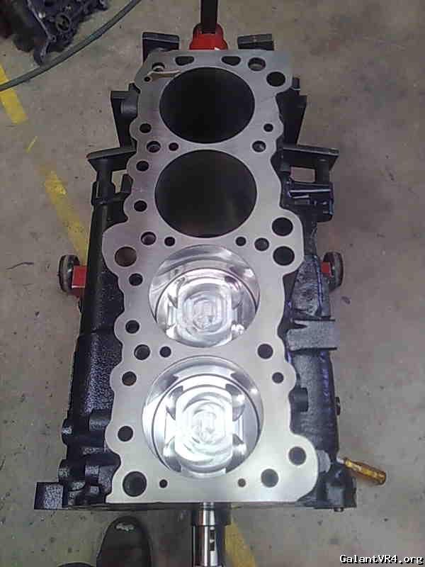

Update
MAGNUS headstuds
1mm oversize stailess steel valves
Ported head with Crower spring and retainer kit
Crower cams

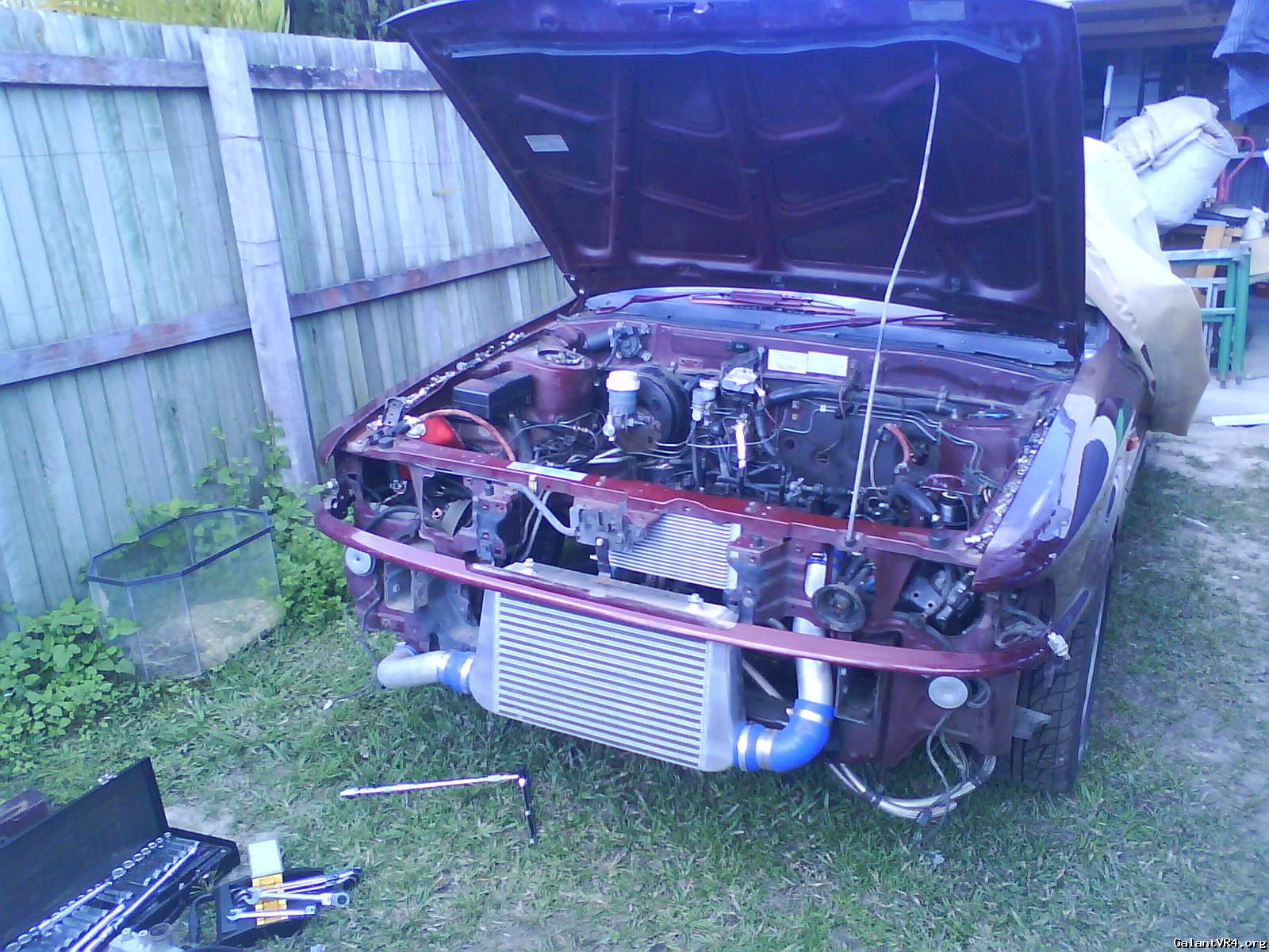

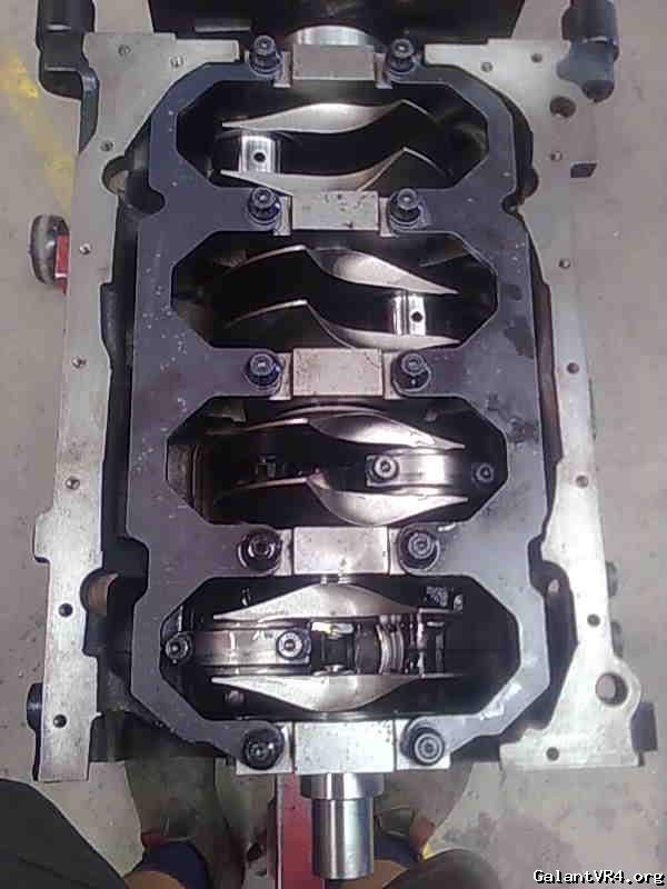

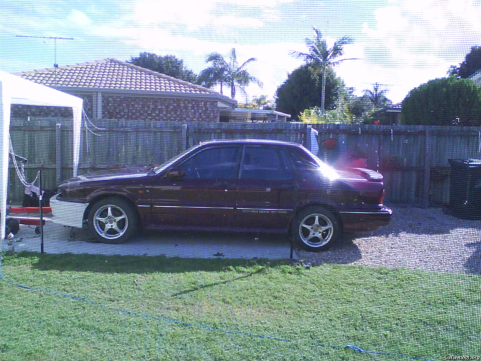

can't let this one get away without adding some pictures of mine.
mine is a backyard build that has been a long time coming.

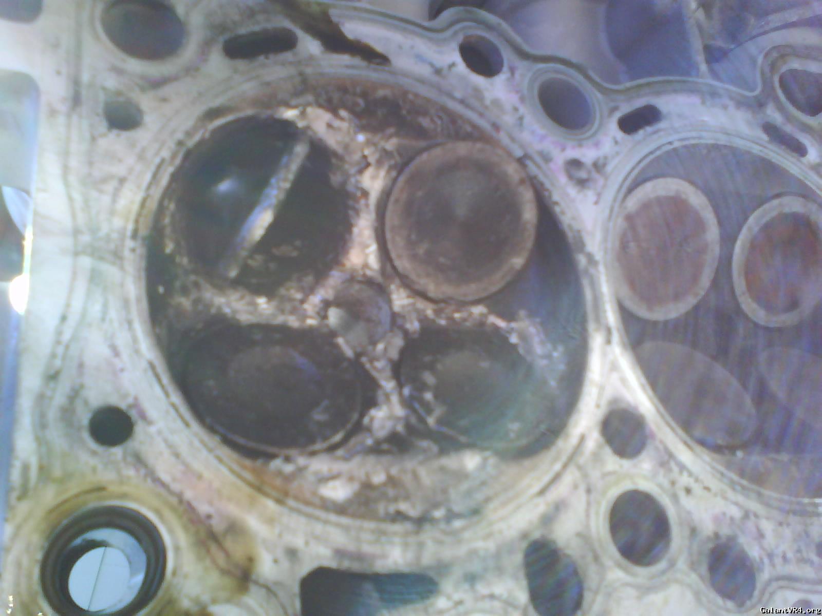

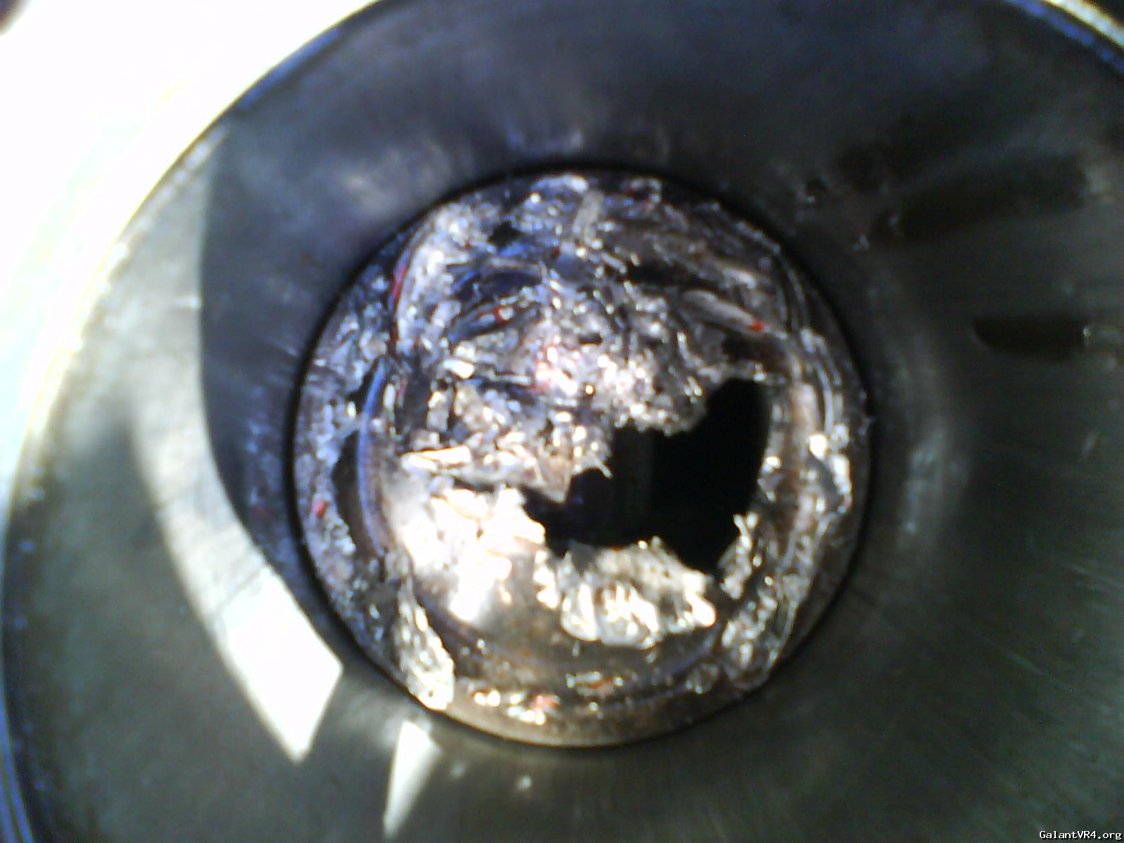

and this is why it went off the road....3months after an engine rebuild /ubbthreads/images/graemlins/banghead.gif
