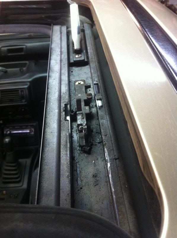

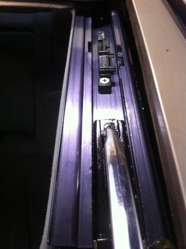

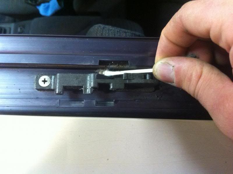

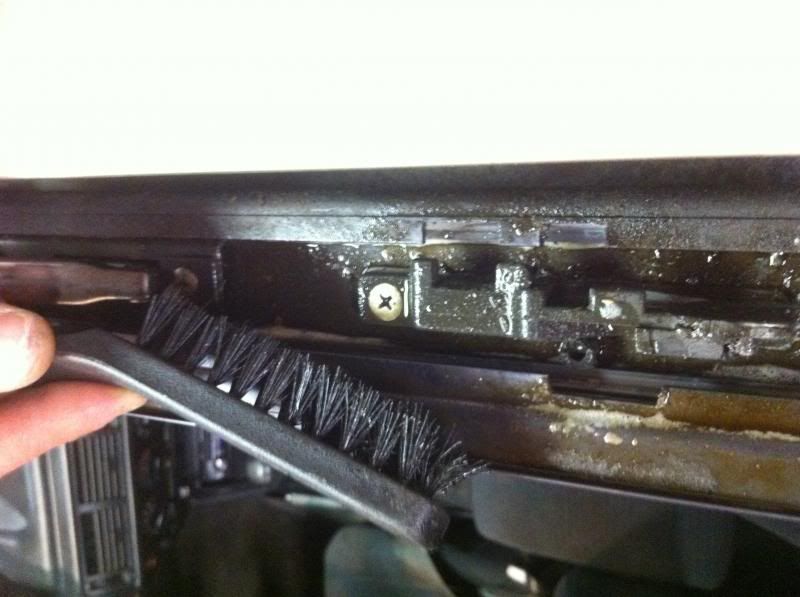

Just a friendly public service enouncement, don't forget about the often over looked places during spring cleaning. Slow closing sunroof... not anymore! Cleaned and lubed.

Yea, cleaning will help a lot, but the sand and junk in there wear the crap out of the guides.

I wasn't entirely sure what to use, so I used silicone spray. I didn't want to use anything petroleum based around rubber and plastic parts.
