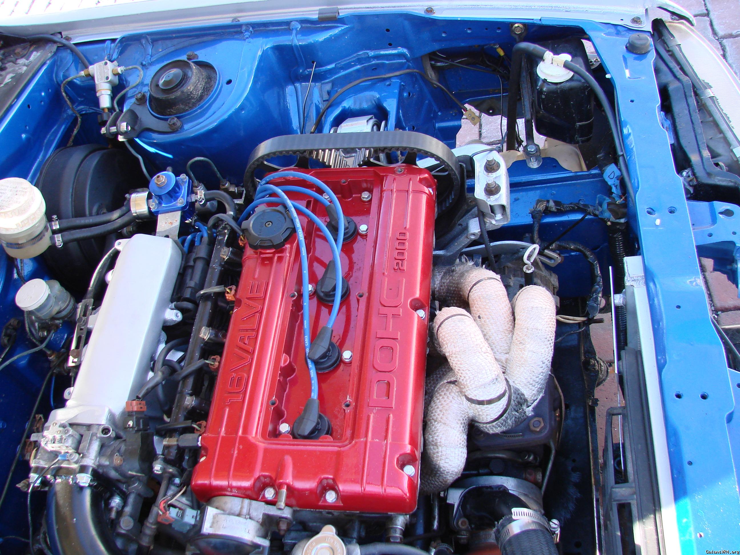

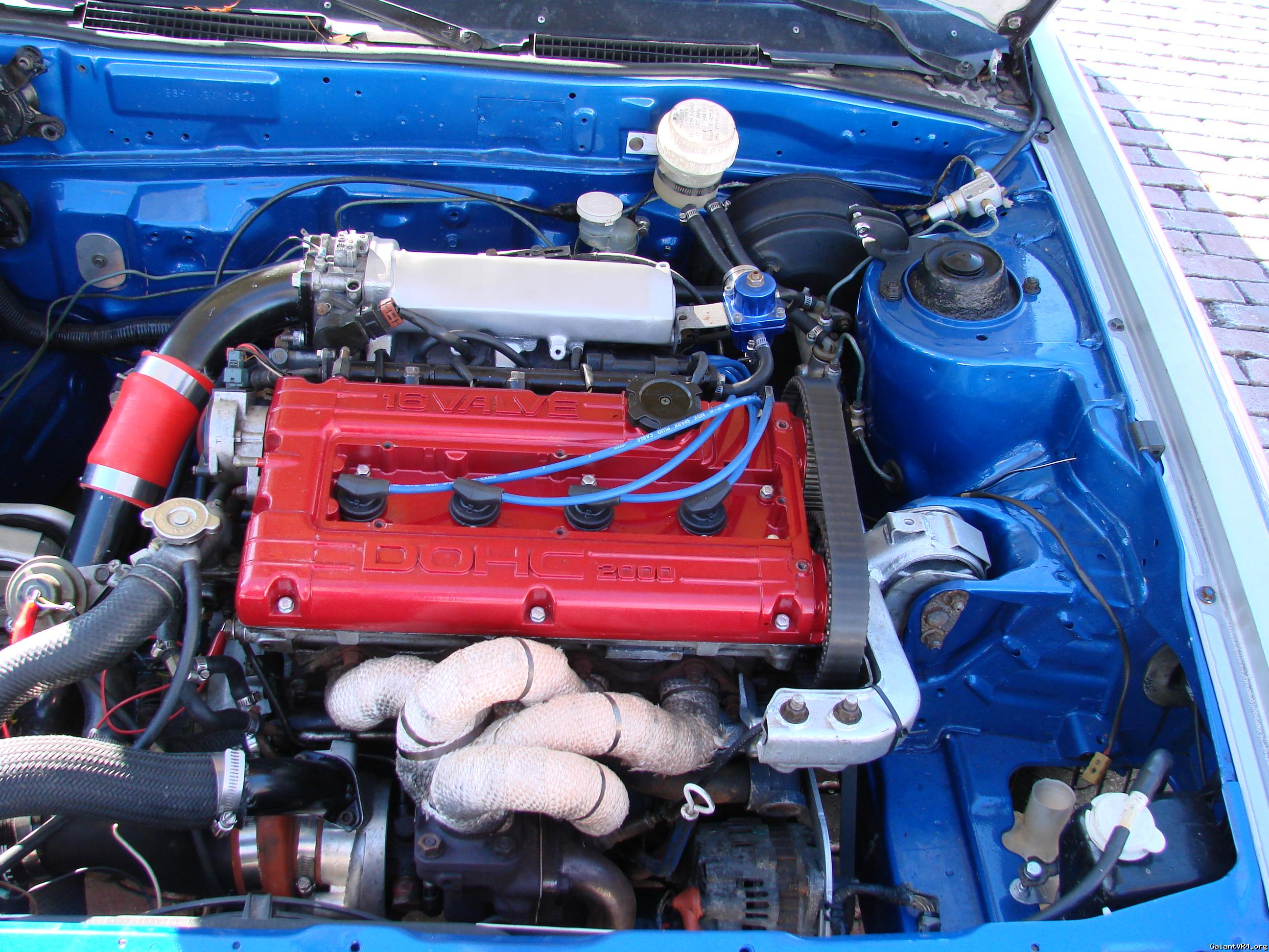

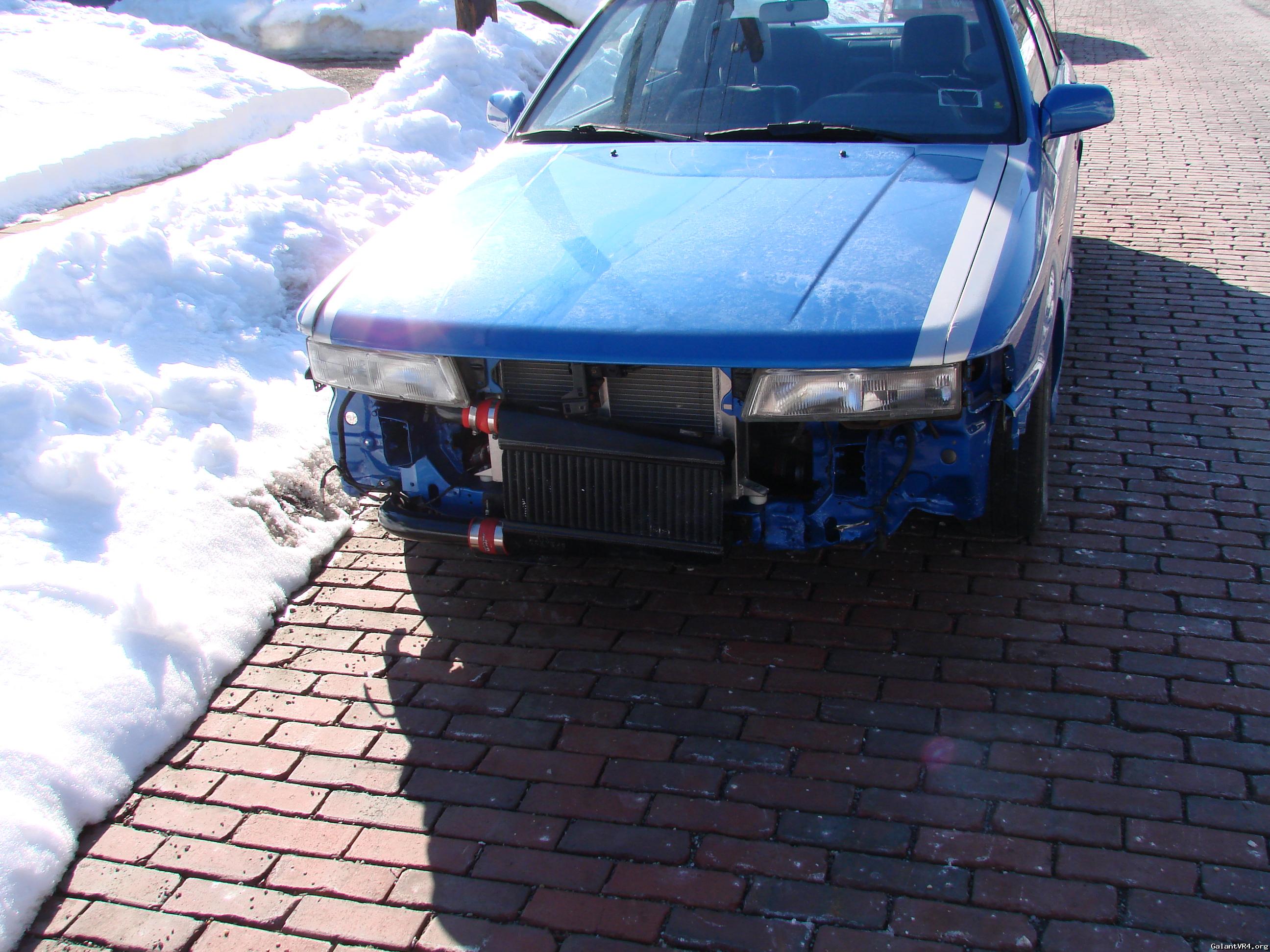

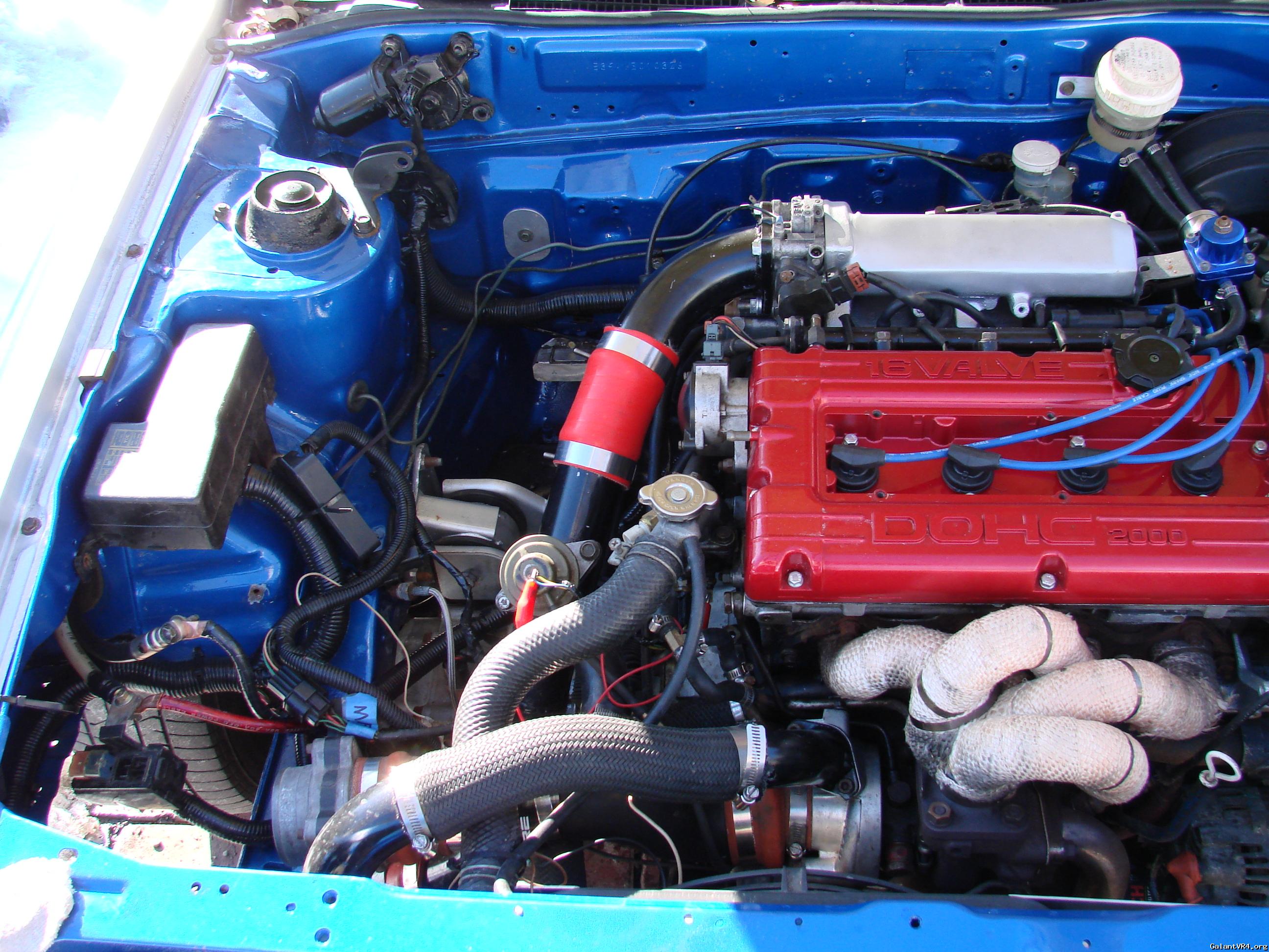

So... I relized that I never posted finished pics from once everything went in. Its still not running right all the time (start issues). Made a couple changes; GM MAF w/ MAF-T, swapped valve covers (kept scratching the flat black paint), FAL fan controller, and a few other odds and ends. Strut bar isn't in because it just gets in the way while troubleshooting, and the random wire hanging over the engine mount is for EGT which hasn't been installed yet. Going to swap GM MAF for a 2G unit once I make up a wiring adapter. Alternator bearings are going too, so might just do a double and make a relocation bracket for a Saturn/Subaru alternator in the AC location. Going to get rid of the front battery terminal wires and relocate to d-blocks mounted on firewall/behind shock tower.
