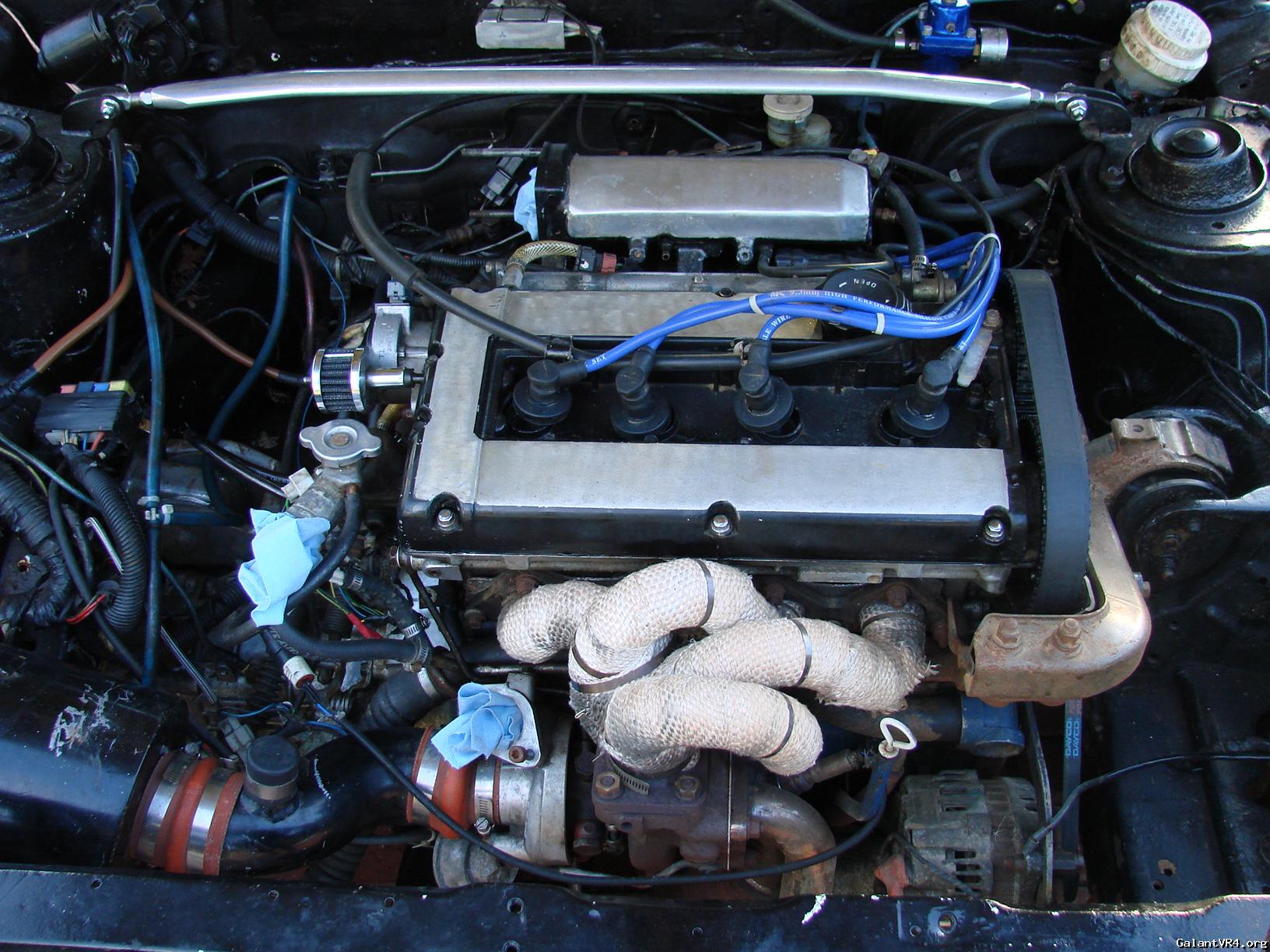

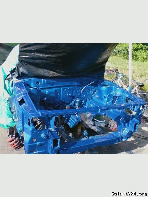

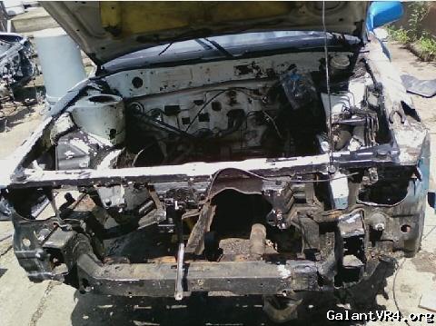

For those who read my initial introduction post on 642/2000, you know what a mess the engine bay and trunk were. Rausch saw it when it was in Dan's hands and can attest to the state of hack it was in. Initially set out just to fix up the loose ends to get it running and then drive it, but once I started digging into it relized that I may as well pull everything, fix it right, and throw it all back together so that I know its done right.
So here's the before pics:

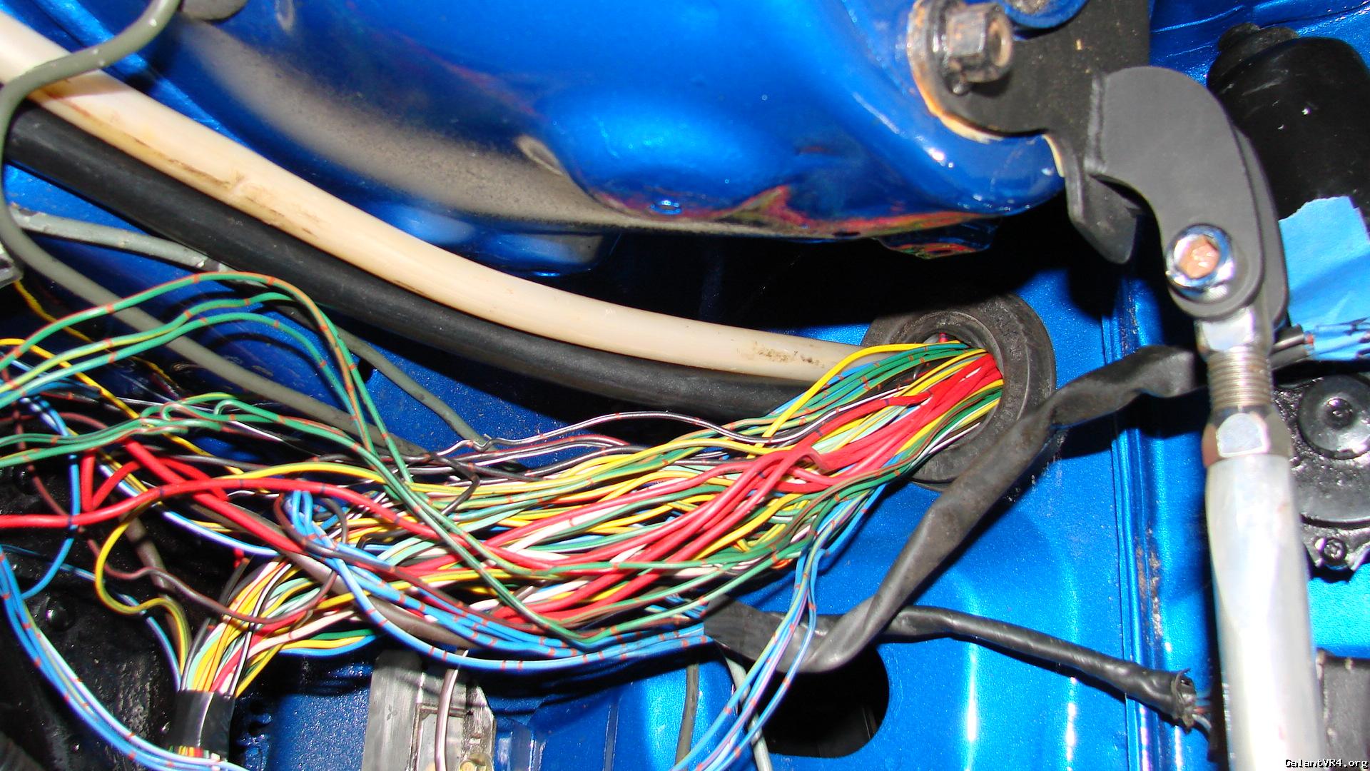

The major kill factor of it was the way he spliced into the wiring harness, the poor hose routing, the fact that it was spray painted over the oil/dirt leaving a tackie feel to it, oh and the fact that it looked like S*@#!!!

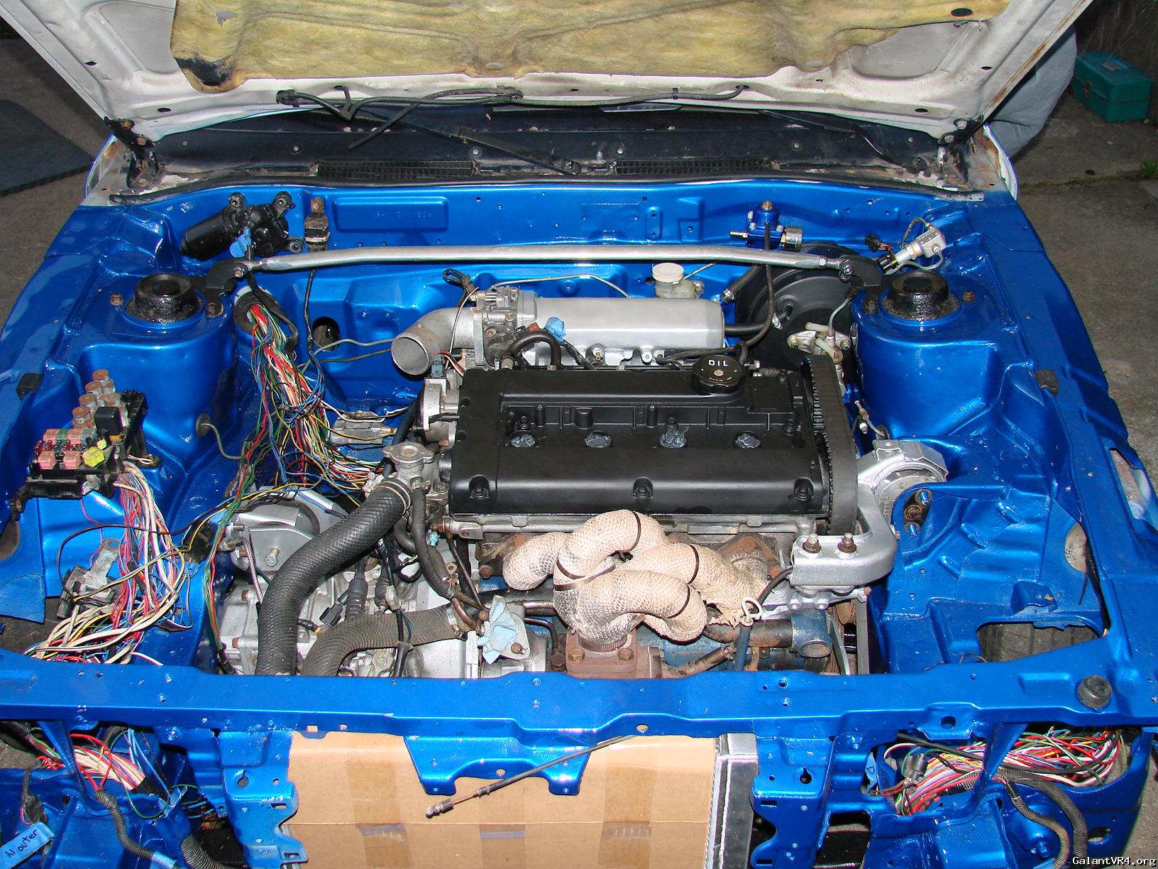

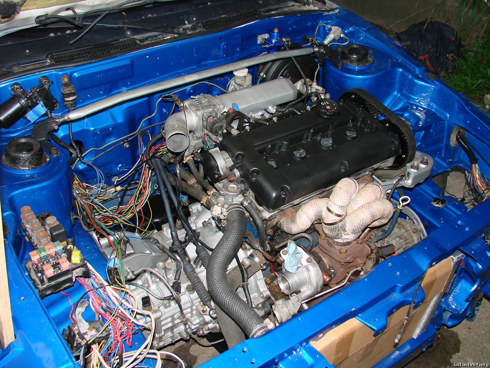

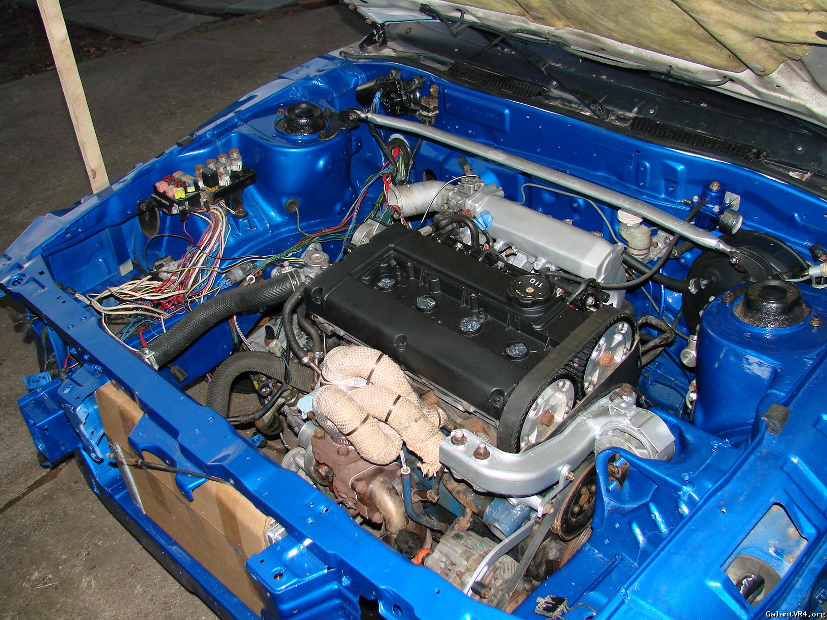

Here's her part way cleaned after everything was pulled:
And after paint:
While everything was out, I stripped all the engine brackets off and repainted them, as well as the valve cover, and intake. I was amazed at all the shady work I found, like a zip tied CV boot /ubbthreads/images/graemlins/uhh.gif. Also took this time to get familiar with the wiring harness and the service manual. Strip all AC, PS, ABS, and the unneeded emissions (no checks around here /ubbthreads/images/graemlins/grin.gif).
Then I started reinstalling everything, with the new goodies.
I still have quite a bit to do in the engine bay, but I figured I'd post some progress and get some feedback. I haven't even touched anything else yet. Going to be fixing the sending unit flange on the gas tank and reduing all the wiring for the battery in the trunk this week, as well as buttoning up a lot of the loose ends in the engine bay.

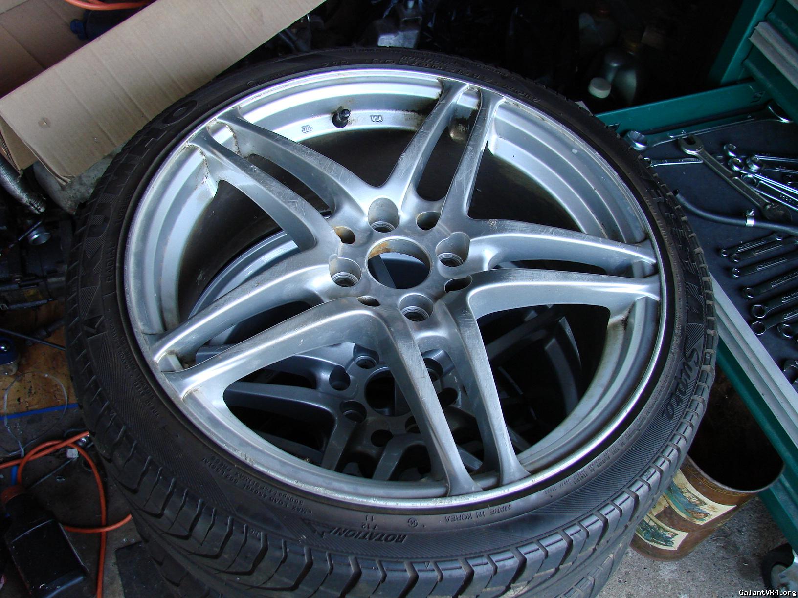

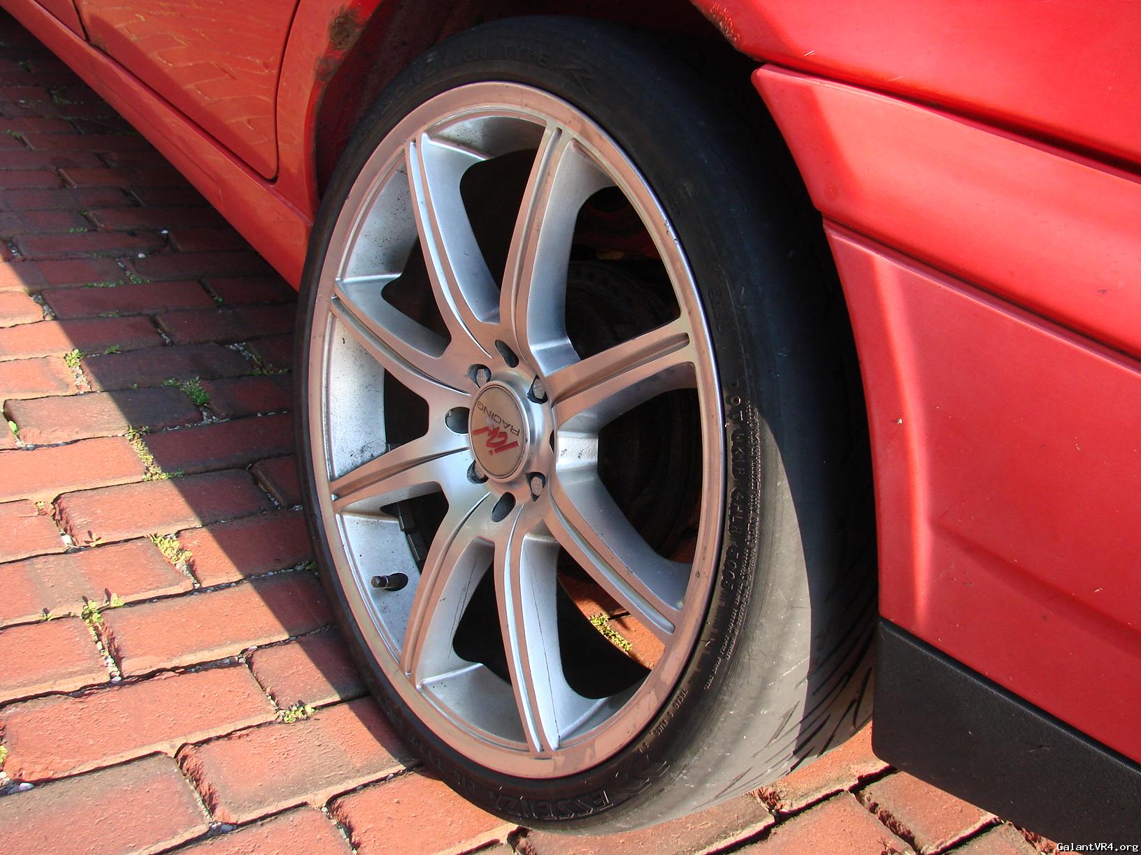

Also grabbed some pics of the new shoes, plus a free pair (ie they came with my golf which was free) that I'm considering.
17x7 +40 offset exel ennios w/ kumho ecsta supra 225/40s
and the debateable:
18x7.5 +42 ICW DV8s which need new tires.
Will get pics of both on the car to see how they look. Keepin the stockers for winter.
those first ones kind of look like momo sports. I love those wheels
Not to fond of those momo's personally. Always wanted a set of momo evo 3s though.

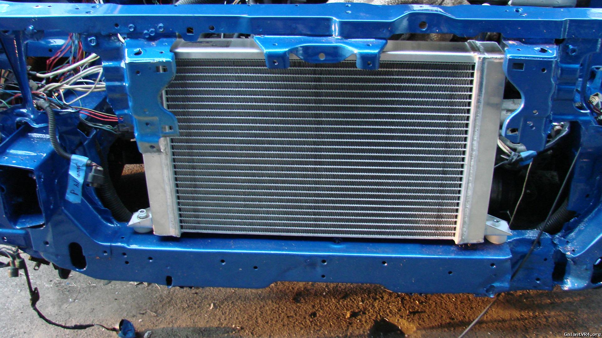

Finished up the spacers for under the radiator and got it in its final mounting position (not fully bolt though bc its coming back out to get fan mounted).

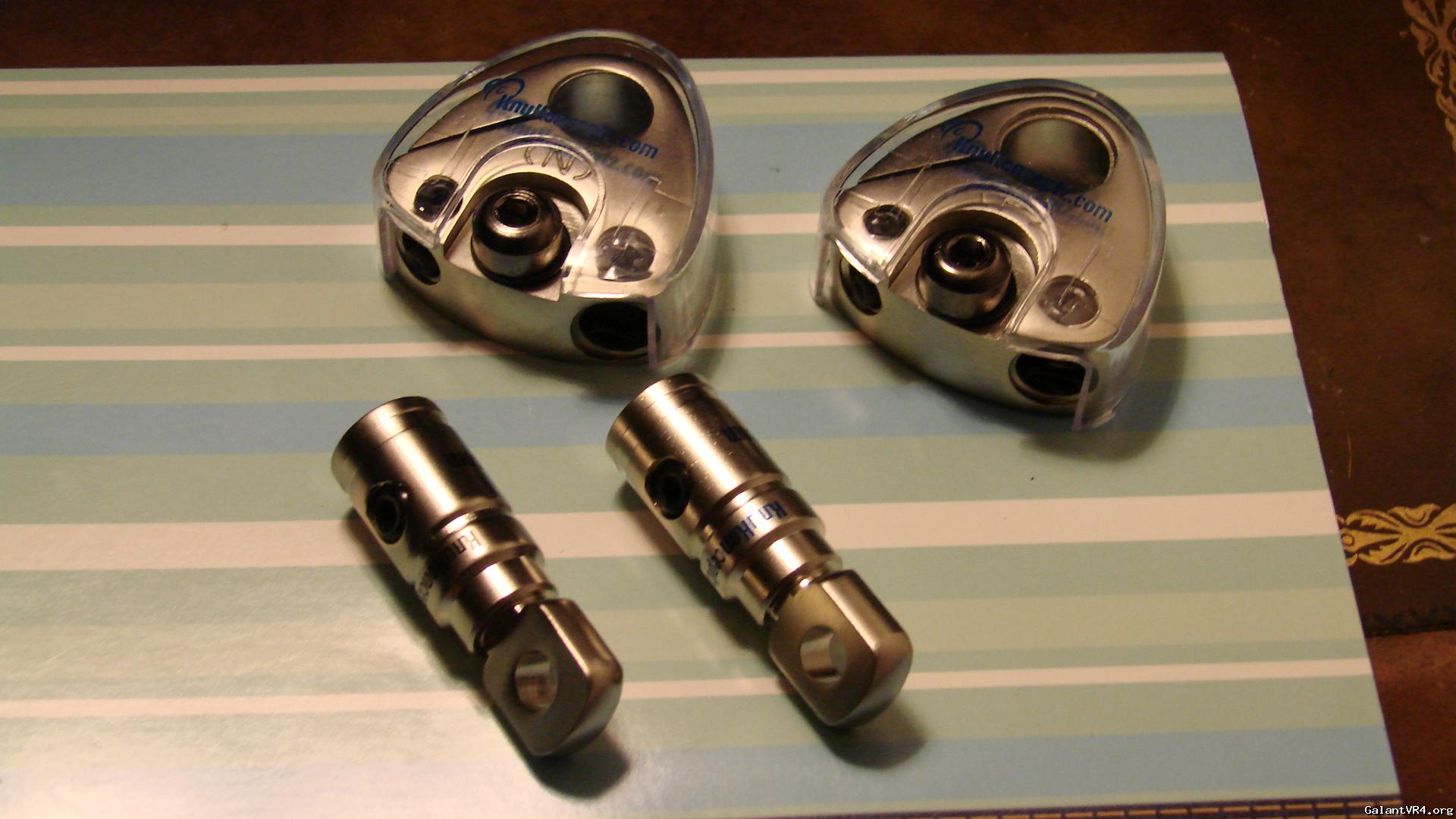

Also got the rest of my goodies in for hooking up my battery.
Ran 0 ga for power and ground up to engine bay. Going to get terminals and everything else on tonight.

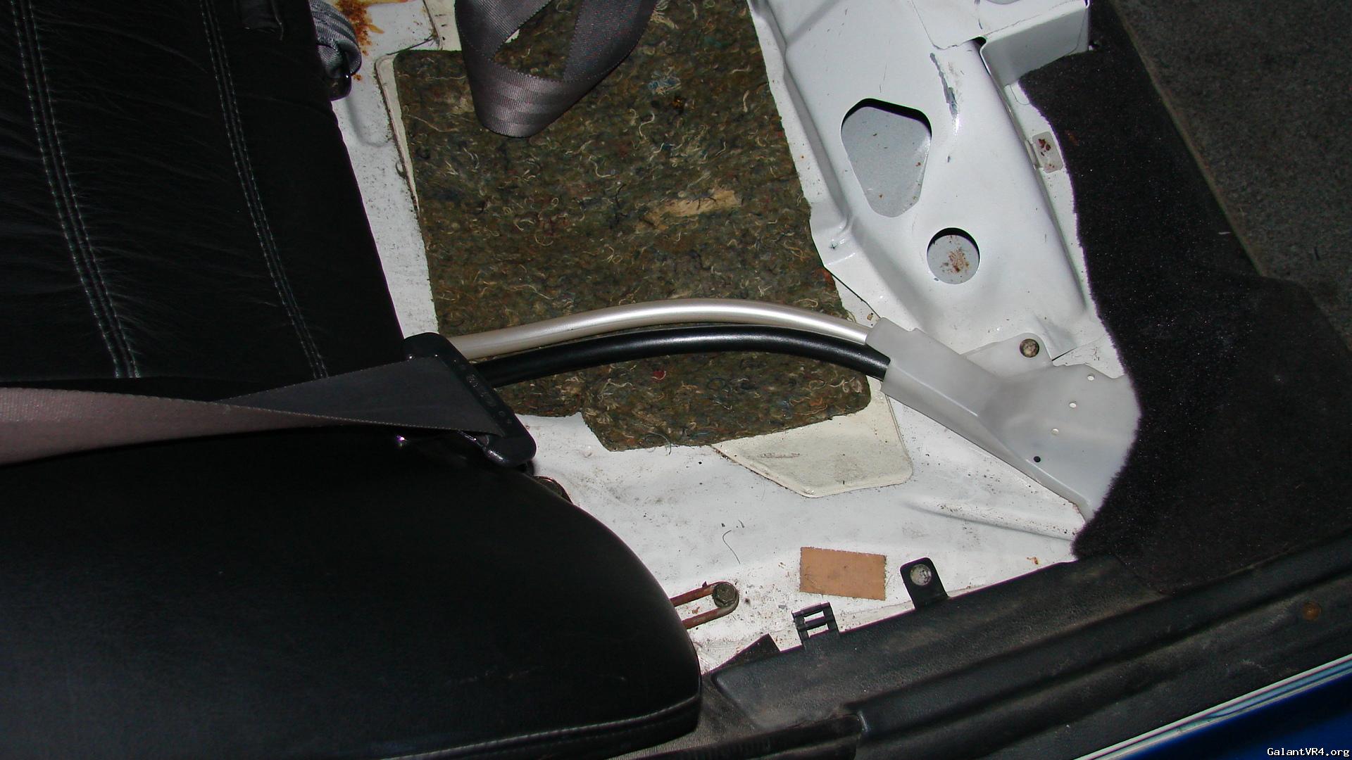

Been swamped at home/work and haven't gotten a lot worth posting done. Found that the driver seat mounts were pretty rusted right where they bolted down, so I cleaned them up and put two coats of POR-15 on them. Made up a set of delrin shifter bushings and solid mounts and got it all put back together. Finished installing battery in trunk, ran wire for EGT, and finished wrapping the front engine bay harness. Still have to wrap the engine harness, but once thats done, the FMIC and piping will be all thats left under the hood. /ubbthreads/images/graemlins/ooo.gif

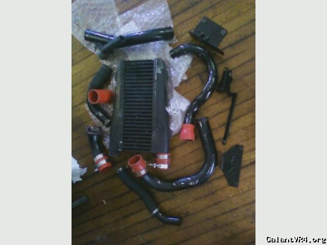

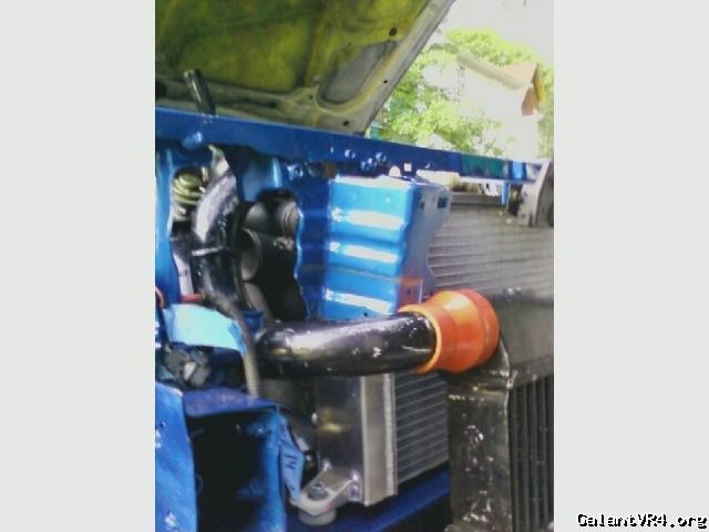

So there was a big 42# box waiting for me when I got home on friday. Finally got my intercooler setup!!! Got it test fit and did some shorter rerouting, then stripped all the pipes down and repainted them, as well as polishing and painting the end tanks. My gaskets won't be in till tuesday, so no pics of the setup till then. /ubbthreads/images/graemlins/bawling.gif
I'll be making some mounts for my radiator fan today, as well as some other misc items like EGR blockoff,caps for AC holes in firewall, and ring for sending unit in tank.
Teaser cell phone pics
