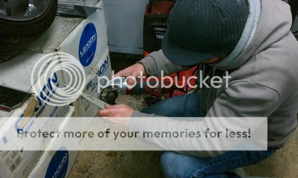

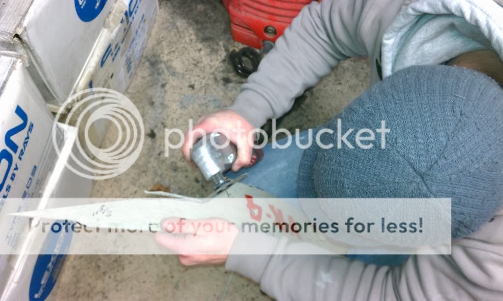

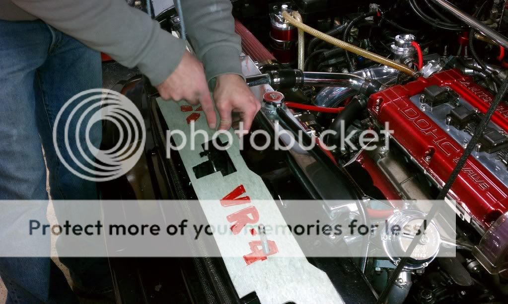

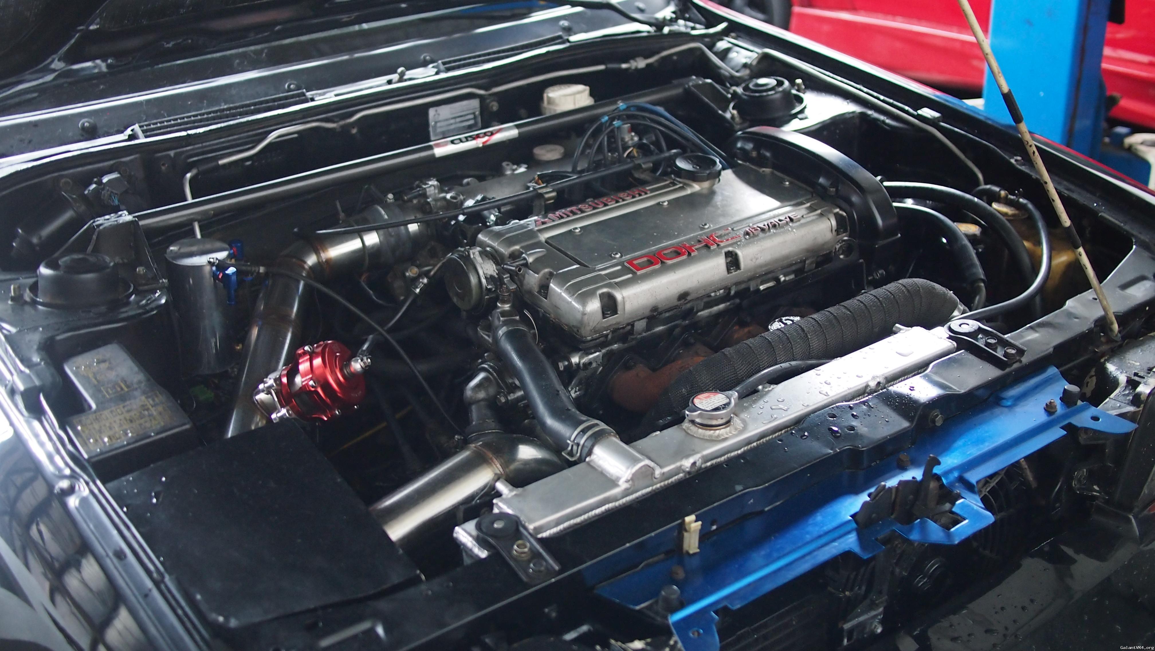

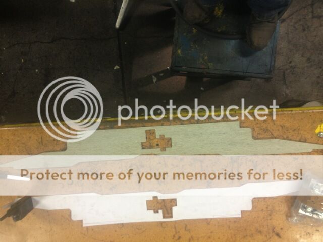

A few pics of the piece 'Detailer' Mike made for me. He makes custom diverters for G35's & decided to try one for the galant.
boostin4door
Oct 7, 2006
150
Chicago, Il.

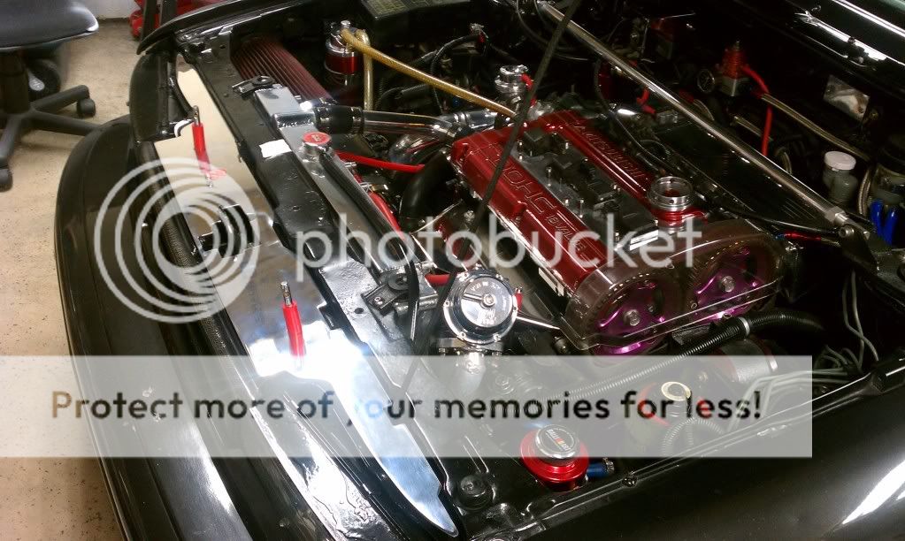

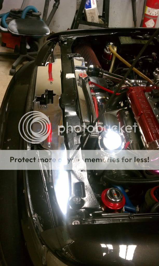

After a alot of polishing.... a few modifications , adjustments & trimming it fits great. /ubbthreads/images/graemlins/grin.gif
Its fitted for the car ie: not perfectly even on both sides but perfect for my car. Its secured by the hood pin sleeves.

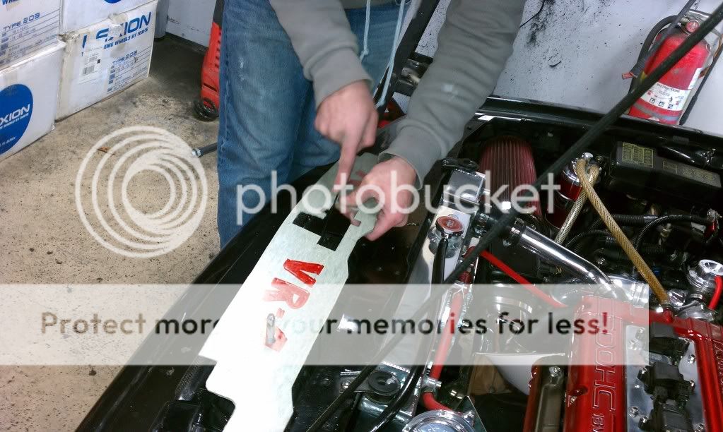

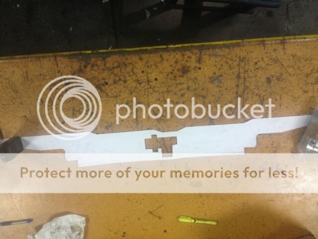

A couple of templates...

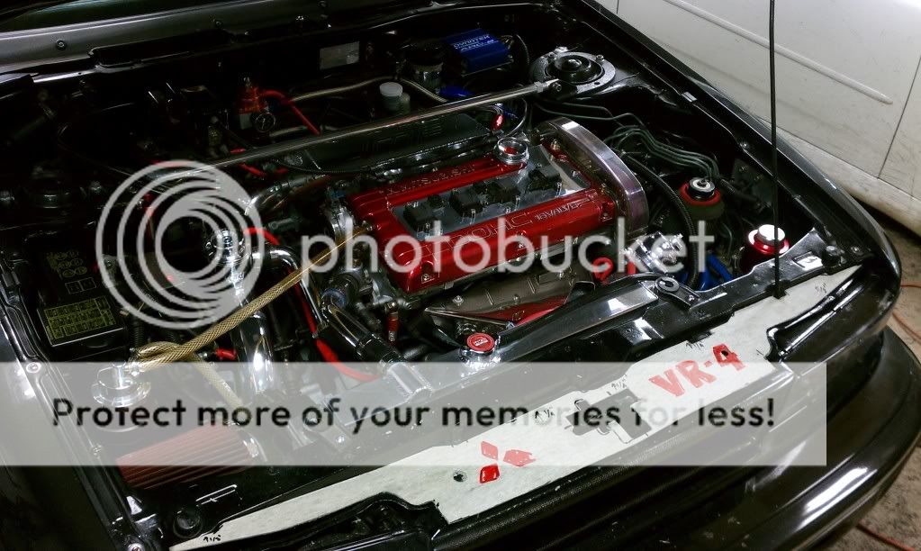

Finished product...

yeah its kinda functional I guess, although how much? /ubbthreads/images/graemlins/dunno.gif , not sure. My car doesn't have cooling issues, it was something I thought about years ago & no one made one for our old cars. A few years back I read a 'fact or fiction' article in IMPORT Tuner where they tested one on a car. [cant remember what type of car] And their results showed the diverter did reduce temps somewhat on the dyno w/fans. I'm sure on the road at speed they work pretty good.
They are made for a lot of cars and some buddies who road race have them on their EVO's.
It was basically free [paid for the alum.] and it fills a void in the bay. And also looks pretty good LOL.

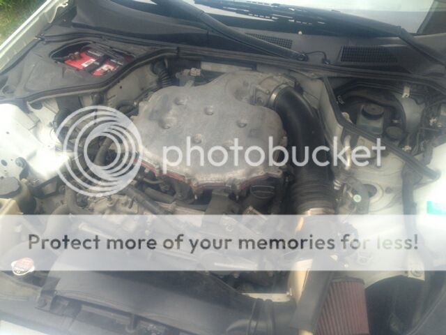

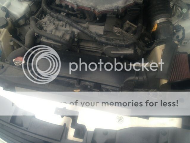

I had one of these on my G35, It something I wanted to make for my GVR4, however I never did since I wouldn't be able to remove the grill since the clips would be covered up.

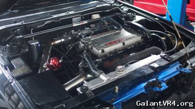

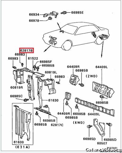

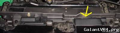

Mitsubishi used to have one for the diesel Galants (E34A).
MB545557 [62817B], PANEL, AIR GUIDE, for approx $15.
on the car...
