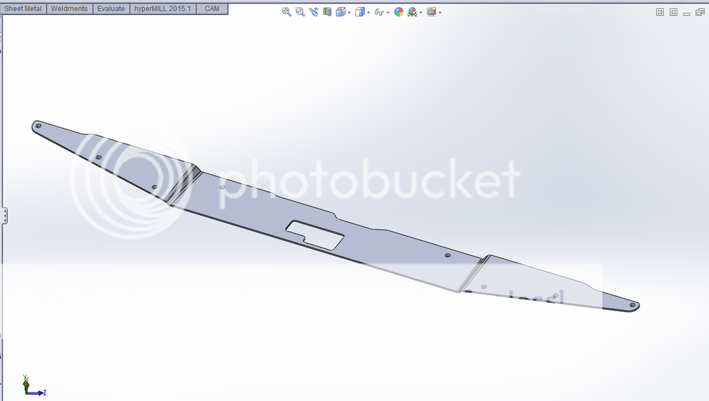

Would you guys prefer one that goes all the way across over the headlights or a smaller one that would just go up to the head lights?

I vote just the middle section, cost would be less as shipping will be cheaper.
I do have to ask about possibly doing both. Would that be too hard? I think you'll get votes for both.

The only thing is that you if you get to the head lights there is really no place to bolt it down. I would hate for these to rattle. I will see what I can do.

Quoting jeverts:
This is what I was wondering earlier in the post. There's no real mounts for this, so what kind of brackets are we thinking of using?

Would it be possible to bend the steel at the ends and bolt it to the headlight bracket where its bolted to the fender? Im not in front of my car atm so I cant visualize it.

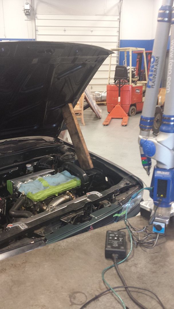

I am going to try and work on this weekend. Proving grounds is going on and the shop will be nice and quiet so I can actually get something done.

What do you guys think? If you see anything that will cause a problem. I have in mounting to the top of the head lights and then there are 2 holes that will mount to the front support. I have it using M4 flat heads that will be flush with the top of the part or we can go with button heads that will give it a clean look.
