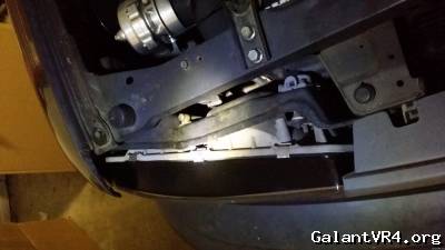

I guess that won't work for me /ubbthreads/images/graemlins/dunno.gif I also still have the bump stops that are next to the grille.

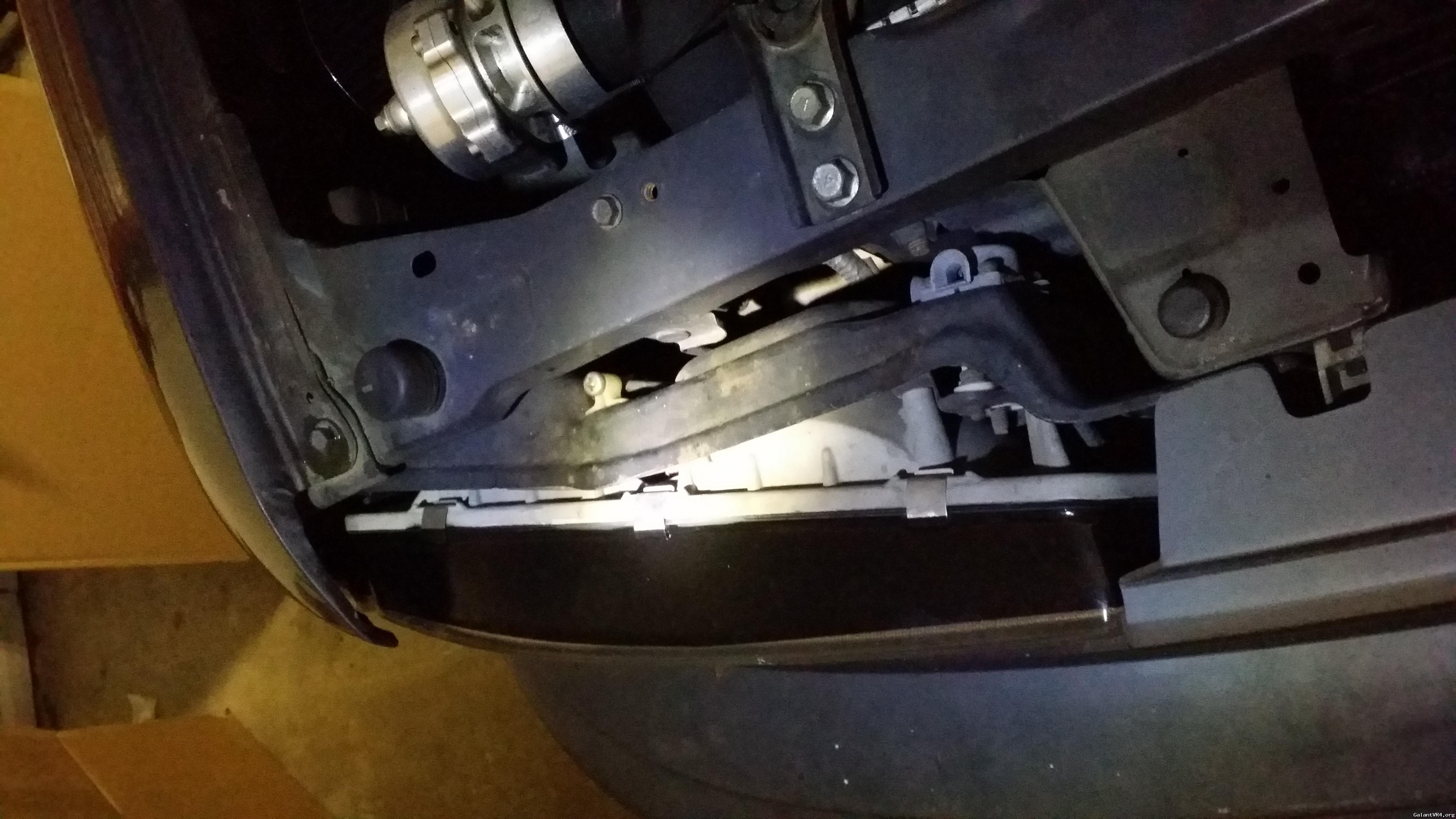

Bump stops are not a problem I can add holes for that. But the head lights hmmm. How many people don't have the headlight mounts? I suppose I could make a tab that comes up and mounts to that first fender bolt? There really isn't any place to bolt this down.

I'd be totally fine with having it bolt down to the existing holes on the bump stop brackets and just having the diverted over bent so it applies tension on the ends once bolted down. Then use a piece of self adhesive foam under the ends so it doesn't rattle.
3,479
Unless the material is flimsy sheet metal, you won't even need a mounting point over the headlight. If the piece is decently thick and rigid, rattling won't be an issue. The design looks good as is IMO. There's no need for mounting points over the headlights.

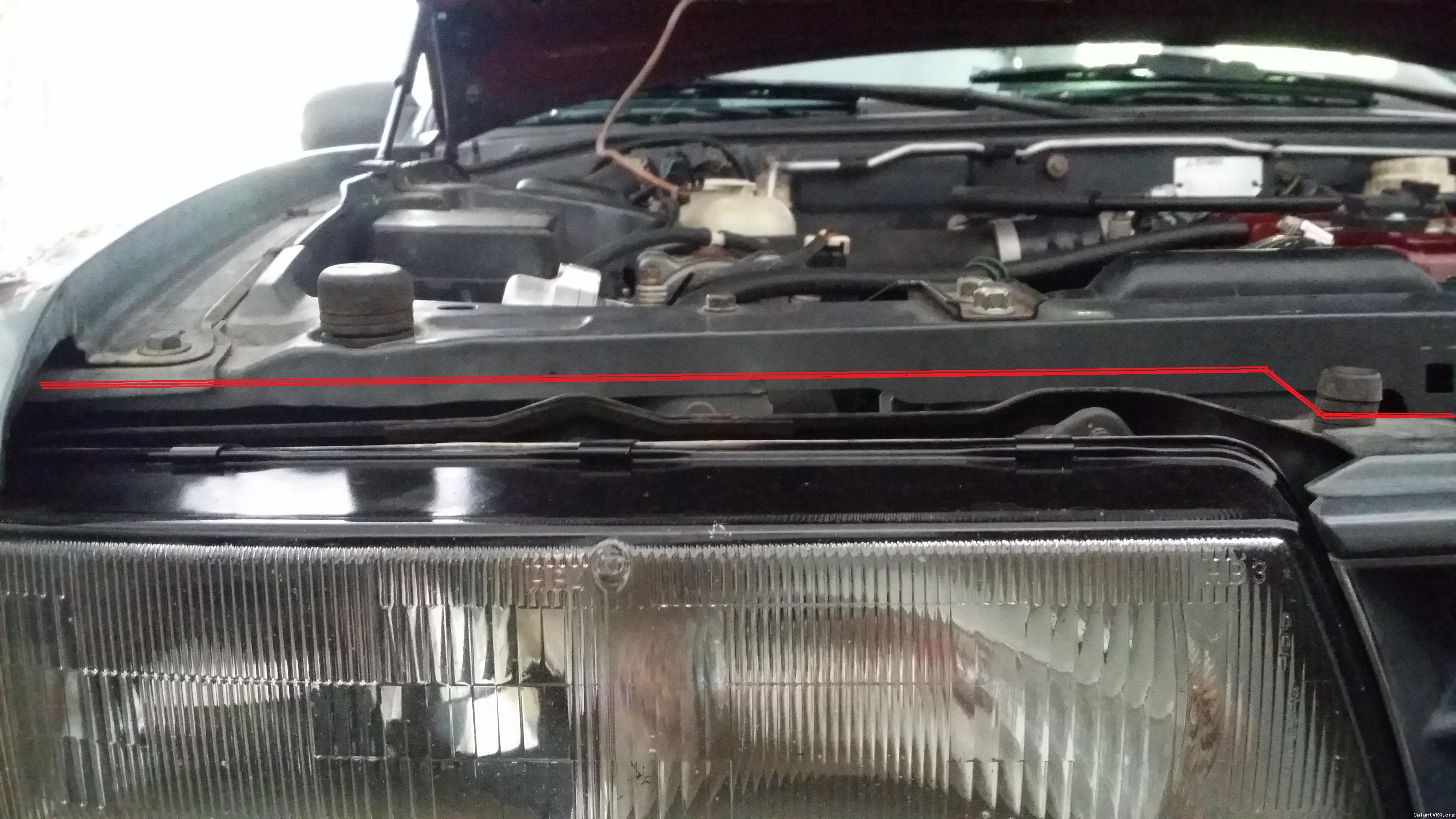

My 91 has headlights just like Jeverts'. My 92 has headlights like Marvin's. However, both light designs sit well below the core support. If the diverter was designed in a way to bolt down in the center near the hood latch, and then the wings sloped up and followed a line just below the top edge of the core support, it would work fine for both cars.
An air diverter that doesn't span the length of the core support isn't really functional as air diverter, IMO. It's just for looks at that point. That's why I personally would only be interested in this if it was a full length panel. Either way, I appreciate the effort Jason is putting into this, and am looking forward to seeing what happens with the design.
Like so:
