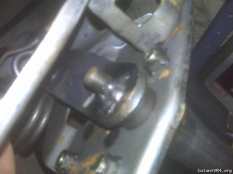

Check for play both ways, pushing and pulling on the pedal and arm. The problem is the 'arm' on the clutch master side has a hole cut in it-and this hole gets egged out. But, the end of the arm (where it actually attaches to the clutch master rod) is a long ways from where it bolts to the cross piece. What happens is that little wear at the pivot transmits to a huge amount at the end that moves the clutch master rod. I have some pics of the worn pieces on my other computer. When I get over to where it is, I will post them.

I had one break in 2 places. The typical nut end of shaft location. I welded it put it back in and it still wasn't right and got progressively worse till I pulled it again and found it was cracked in the middle of the cross shaft. I dislike pedal assemblies that do not cooperate.

I had this problem when I took my car apart and will probably have it when i put it all back together, but im tired of messing with it and making a custom adjuster for the pedal assembly, it will just work enough if im on the last half thread of the adjuster but it still isnt to my liking, and ive already wasted an entire night pulling the tranny out and replacing the old stuff with a brand new clutch fork, new pivot ball, and spaced with a new slave and master cylinder and STILLLL had the exact problem...was i ever mad. if its not just from the pedal assy. not being welded thats great, but i believe the egged out of shape it the real cause, so if my adjuster works ill let some people know what i used. hope this helps a little!
The egged out shape IS the cause and the welding the 2 pieces together is the easiest way to eliminate the problem. Don't even bother with extending the master cylinder rod beyond factory length.
