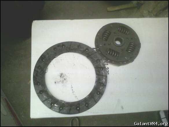

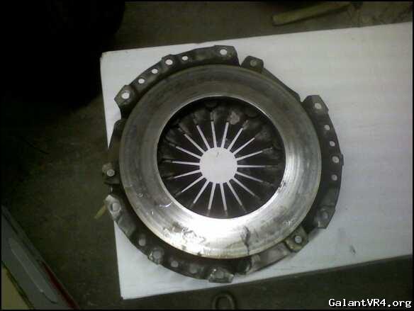

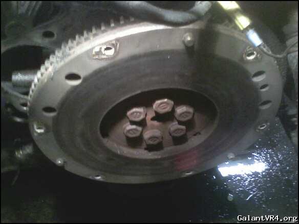

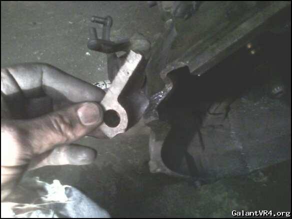

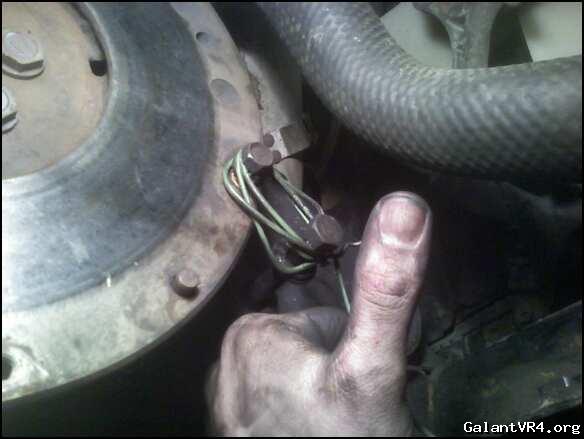

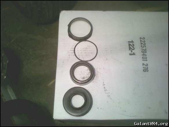

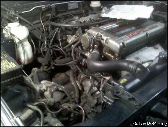

Ok. An update to this thread. I was driving the car one day, shifted gears, and the car just stopped moving completely. Engine was running perfectly, gears shifted; the car just wouldn't move. Had it towed to my uncle's garage. I pulled the transmission yesterday. The following pictures are pretty much self explanatory:
The bolt through this hole was loose. The previous owner (who had replaced the engine) must have not torqued the bolt down to spec.
Clutch totally separated; this is why the car wouldn't move. The throwout bearing was so worn out, it fell apart into four pieces.
Pressure plate and flywheel.
This is how I secured the crank in order to remove the flywheel bolts. I didn't have any access to metal working tools to make a holder. I saw a coat hanger, and decided to try it. It worked too.
