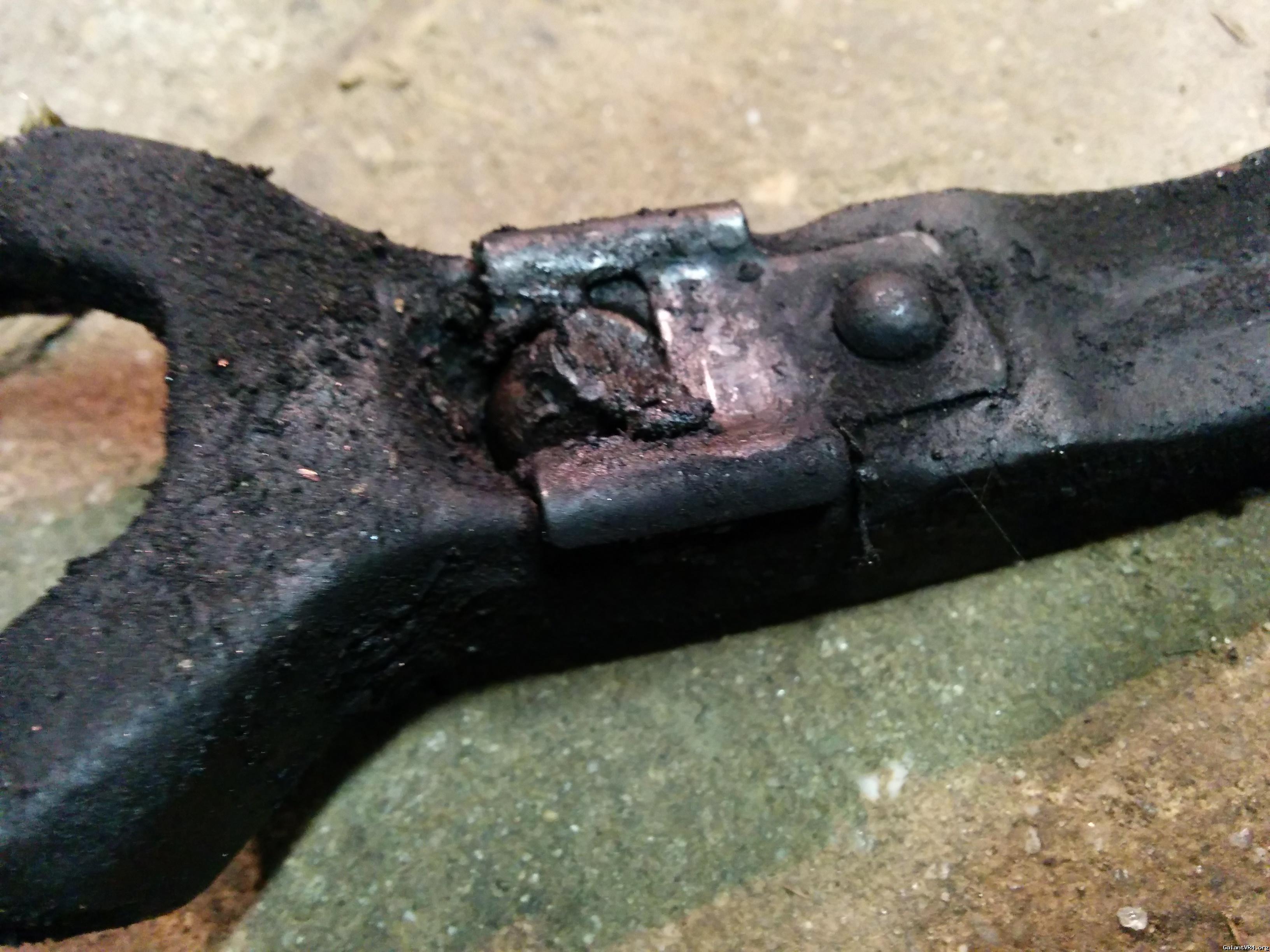

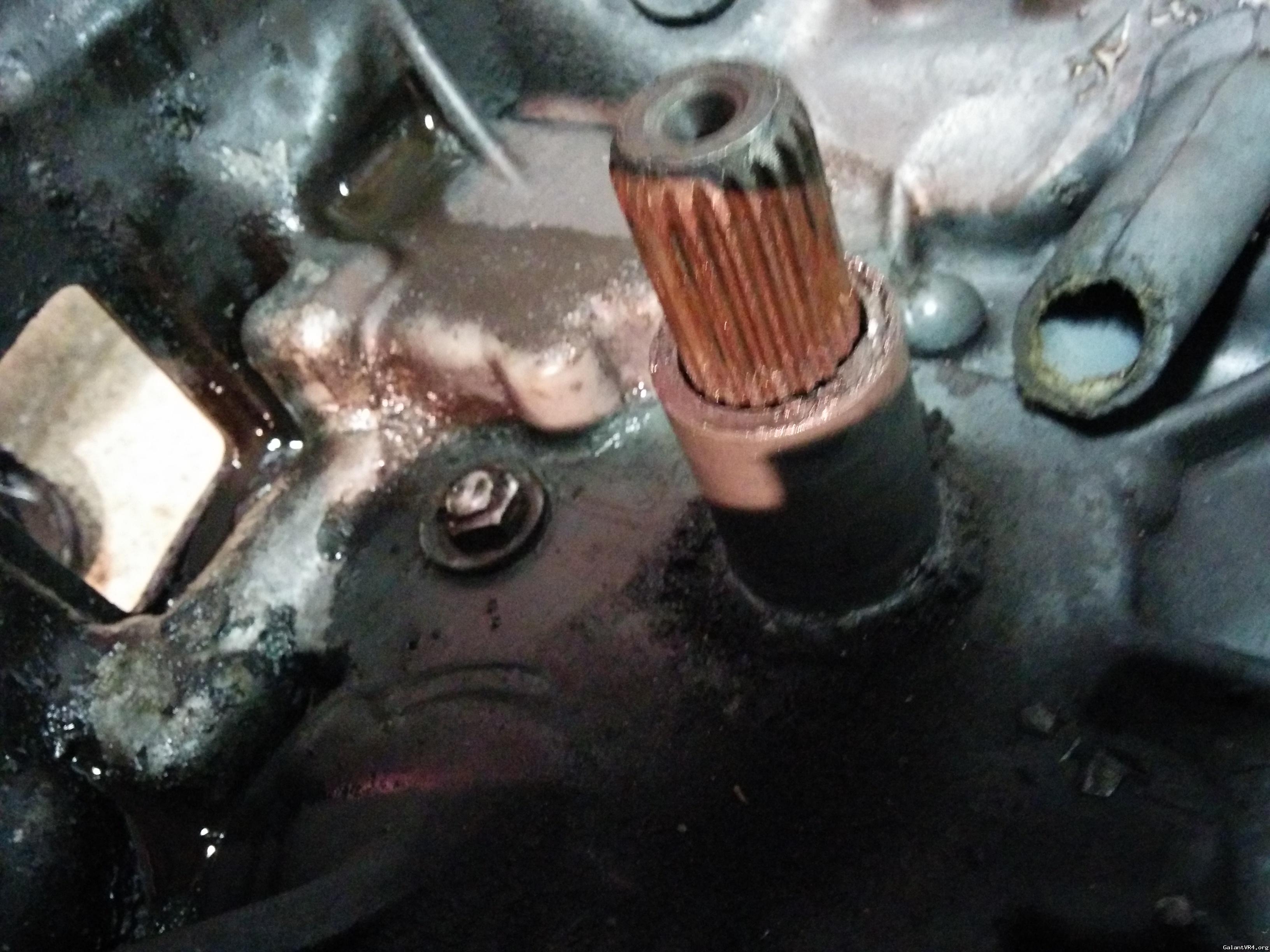

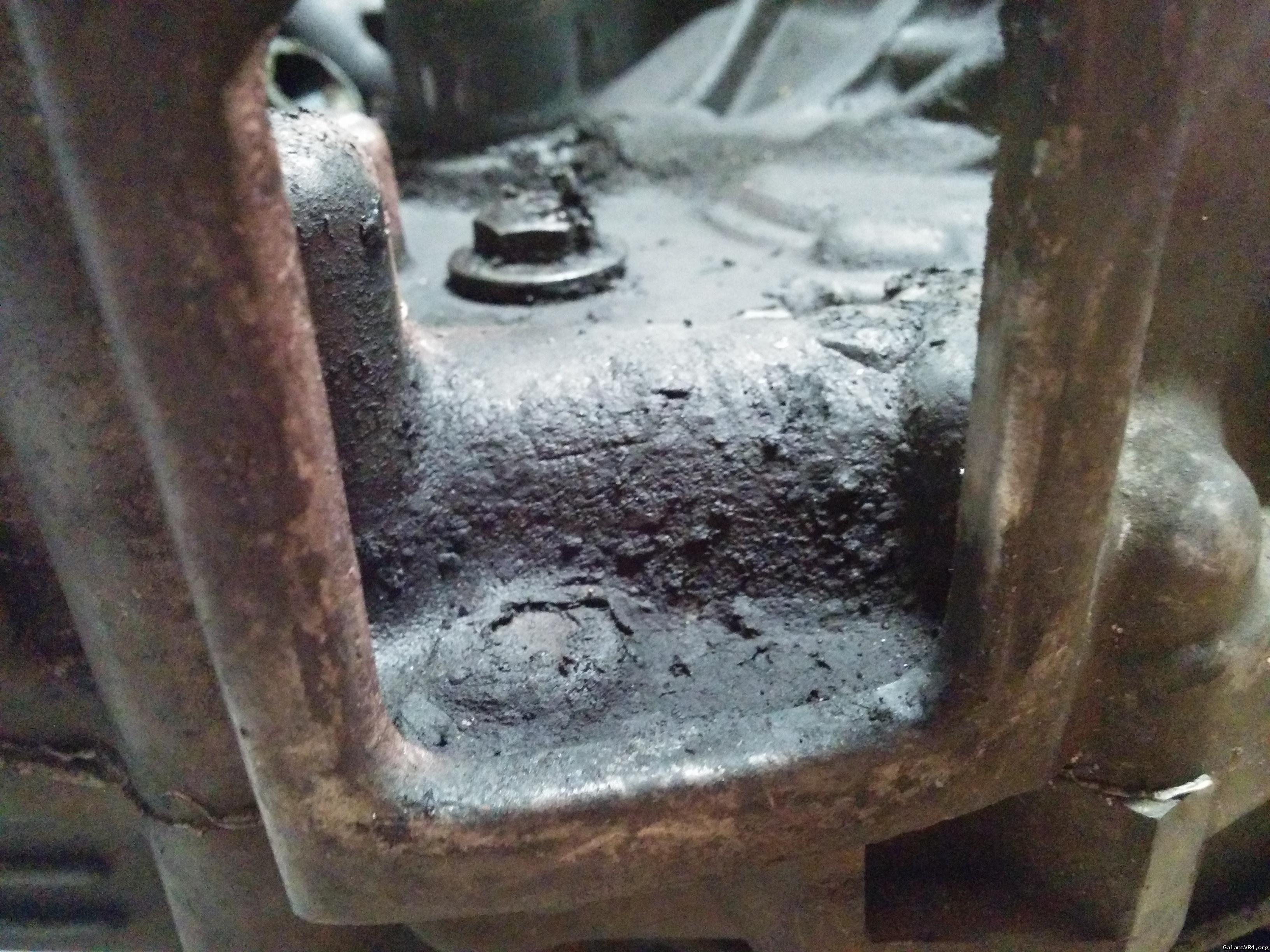

I had the wifey push the pedal while I looked at the slave and it does appear to fully extend the fork arm. So, I started to pull stuff apart to drop the trans. I pulled the dust boot cover thing protecting the fork arm so I can kind of have a little look inside to see what's going on and it looks like the there is no pivot/fulcrum point. I think it snapped off. That's why the fork arm can move up and down because it's not set in place by the fulcrum point.

So the ball broke and maybe just the clip is holding the fork in place? /ubbthreads/images/graemlins/dunno.gif

Once I removed the slave cylinder the clutch fork arm moves all around, but I still can't pull it out. I'm thinking the TOB clips are holding it in place.

Well it looks like the Pivot ball snapped off.
I'm going to throw in a spare trans I have laying around as this one had some issues.
