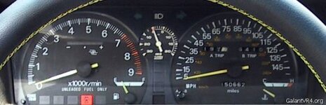

Old school HKS disassembled and mounted in instrument panel.
