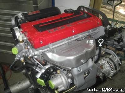

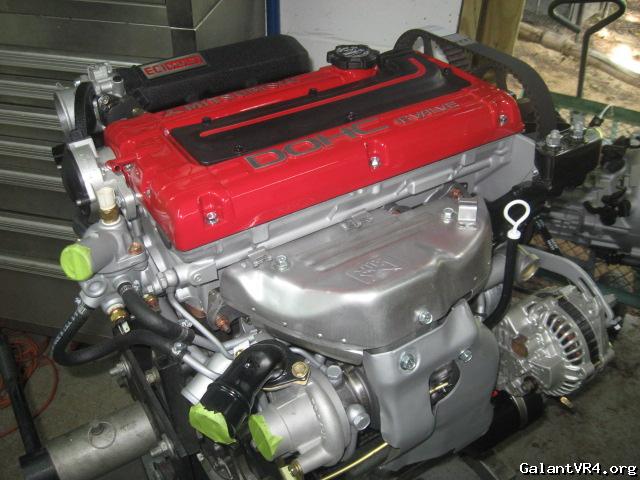

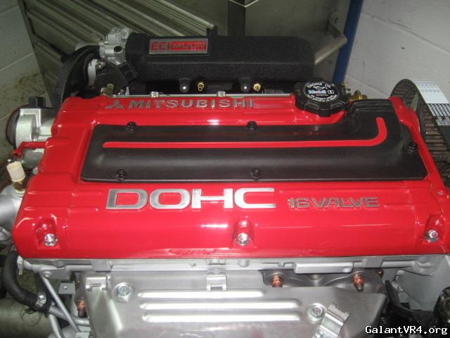

I have used the cast manifold paint from Eastwood that's made for stuff like this with great results. Only thing I recommend is to toss them in the blast cabinet first to get all of the rust off. You can see it behind the heat shield in these pics.
