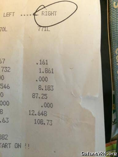

Well....not only is 1137 running and driving strong but I made 4 passes at PIR on saturday and still drove it home!
Best I managed was a 12.64, absolutely no traction in first gear, need some better tires!
