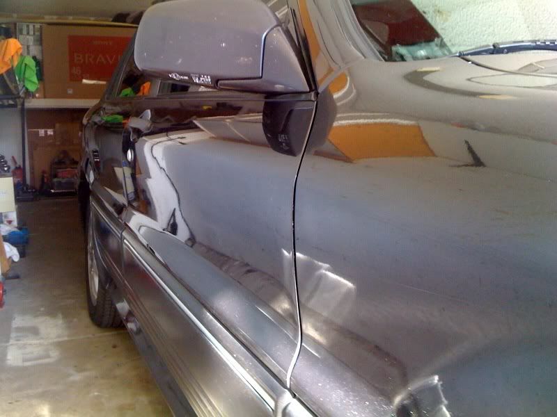

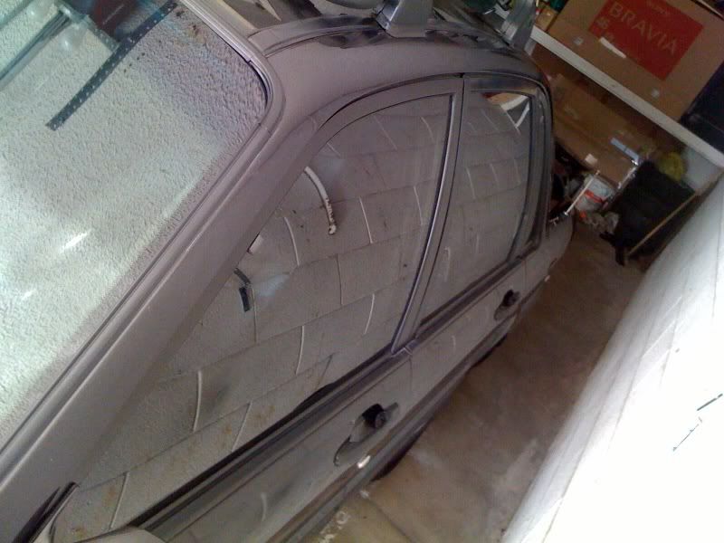

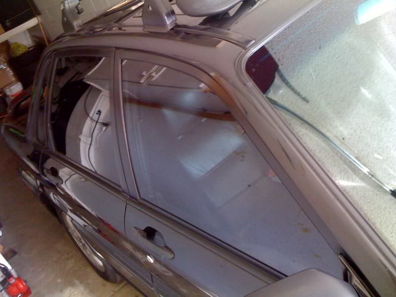

Freshly painted trim:

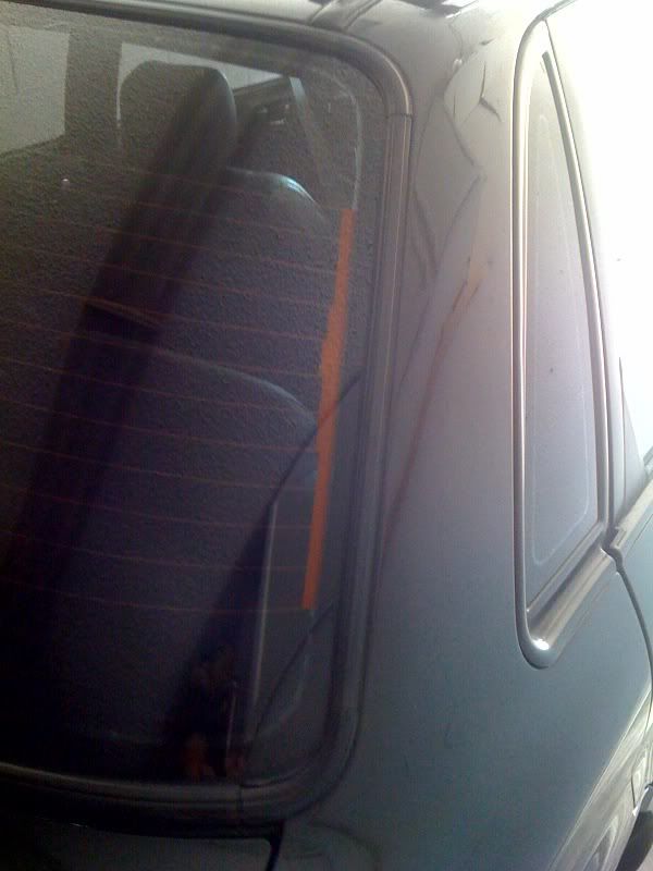

No more pinstripe!

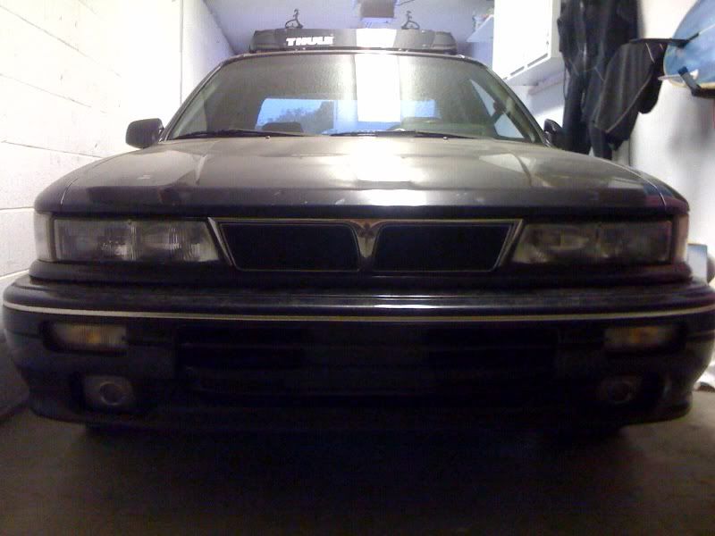

Almost straight bumper. :p
Thanks! I followed the steps in a post on here. Used 320 grit, taped it up very well and did 2-3 coats.
I noticed my mirrors are also faded but it looks like these were paint matched? If so all the paint already came off. Guess I'll get the car paint in a spray can and sand them and repaint them too.
I just got the trim paint and the local auto parts store. I believe the brand I picked up was Dupli-color.

I painted my window trim with duplicolor trim black in 2000 and it still looks good. The chrome on the rear window didn't last as well When the car goes to paint I'll soda blast them and then paint and it should stick fine. Same time I bought 3 rolls of wide black pinstripe from autozone and made a holder on the vice that I could unroll it and split it down the middle with a razor blade. Used 2 and a half rolls and blacked out the chrome around the taillights and the body mounting around the car.
