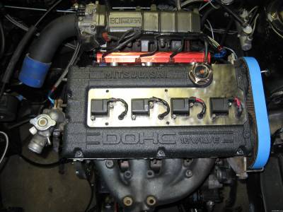

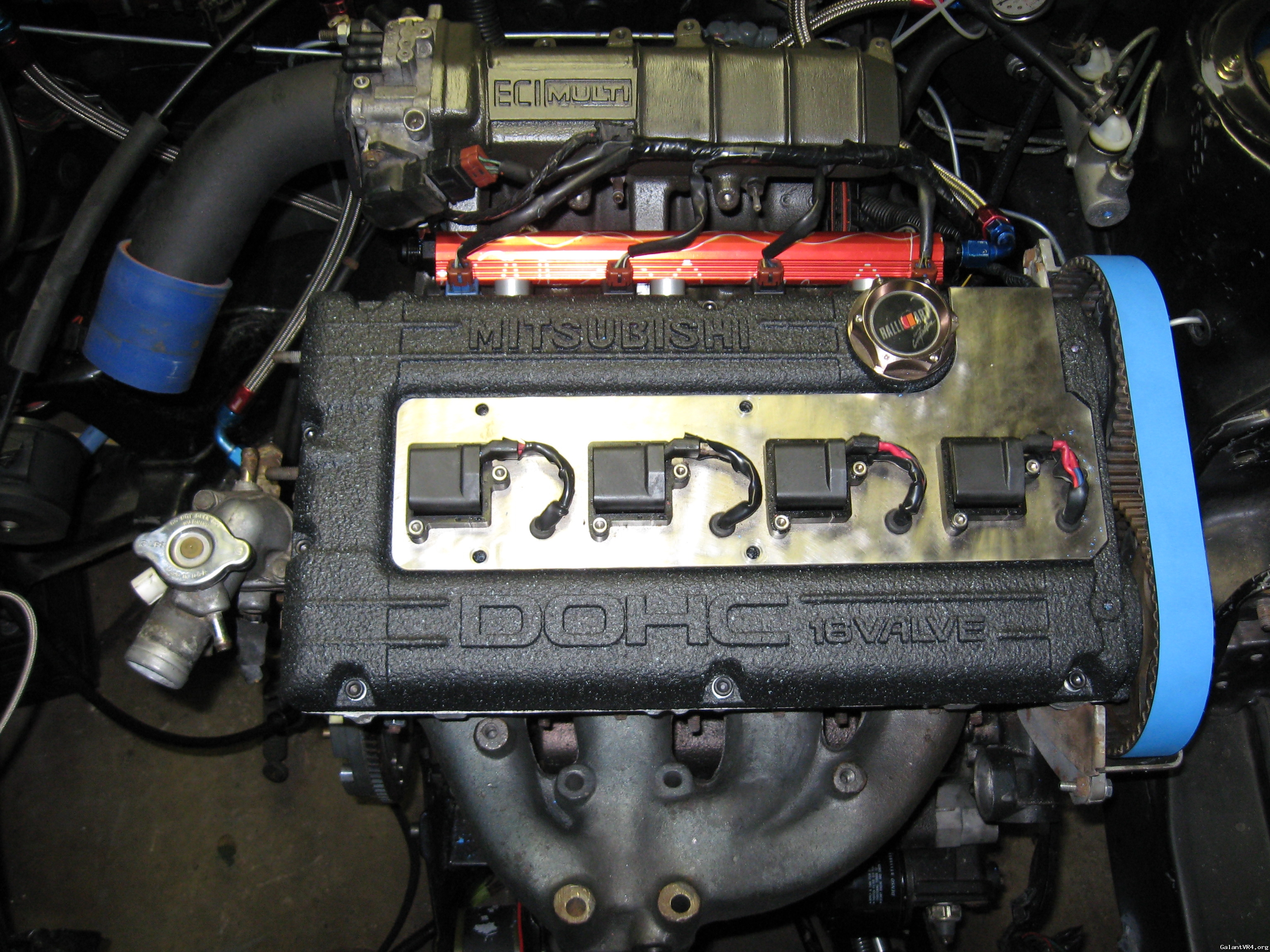

Hey, be careful with that oil cap ... I had one like that and discovered the hard way that the screw that holds the "foot" in place is inserted from the bottom: meaning that the unscrewing of the cap can also work to unscrew the foot, which can then drop into your valve cover.
I fixed mine with some loctite, but it still made me nervous and after about a year I decided to ditch the bling and go with the better-designed (screw inserts from the top), better sealing stock one.

thanks man, i was thinking of holding onto it and just getting an EVO oil cap.

Ditch that oil cap asap.
The real ones are fine.
So where might one obtain one? Are they exorbitantly expensive? I suppose I'd even settle for a knock-off as long as it's better made than the aforementioned examples. The Evo ones are nice, but I'm a RalliArt whore. /ubbthreads/images/graemlins/cool.gif

the pic of the SMIM was just a mock up.
i was going to use the cyclone initially to help spool and get better low end tq. dont fell like messing around with vacuum and setting it up on DSMLink.
staying with the stock IM. it will be extrude honed next year as well as ceramic coated and i may be installing bungs for individual meth injectors!
