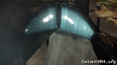

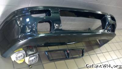

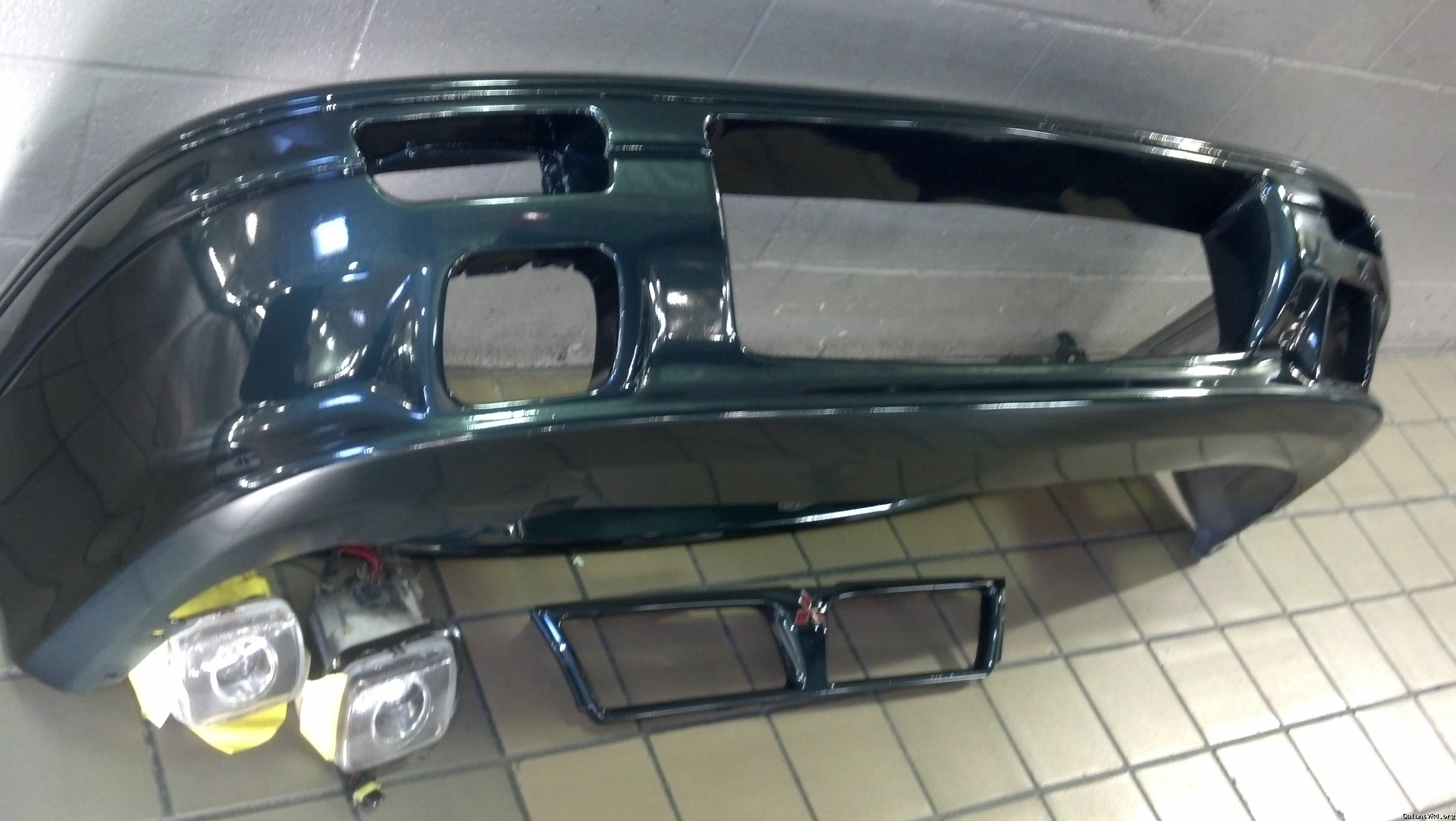

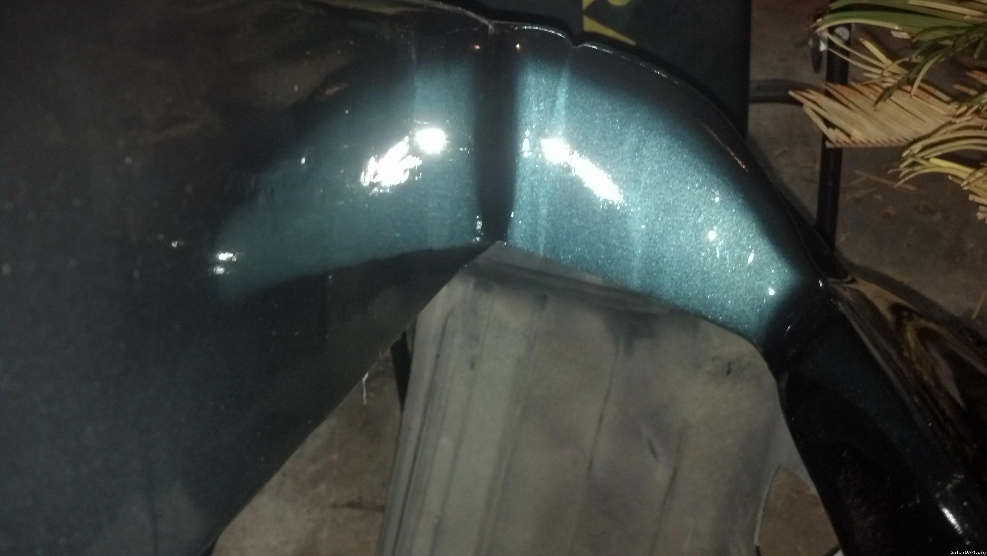

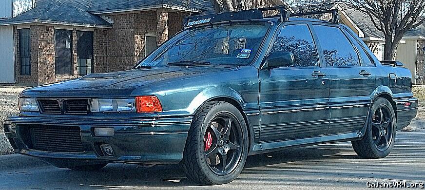

I just finished doing this to my front bumper and it turned out pretty good. I used some sort of body shop urethane epoxy(dont ask me what it is, my paint guy gave it to me), recycled fender, recycled bumper, rivets and body filler for blemished and sanding marks. The epoxy I used is very similar to the plastic the bumper is made from, so it can flex and not crack.
*edit* that flimsy piece below the mouth of the bumper has not been secured yet(obviously), I made brackets to pull it back into place.
