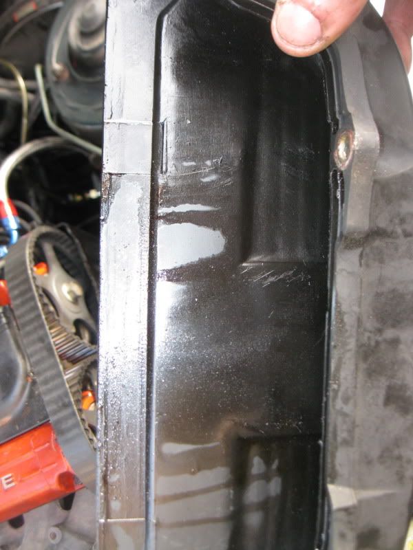

oil in cam gear cover, awesome!

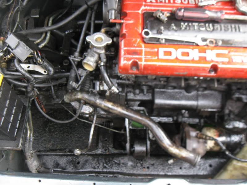

UICP and Throttle body pulled

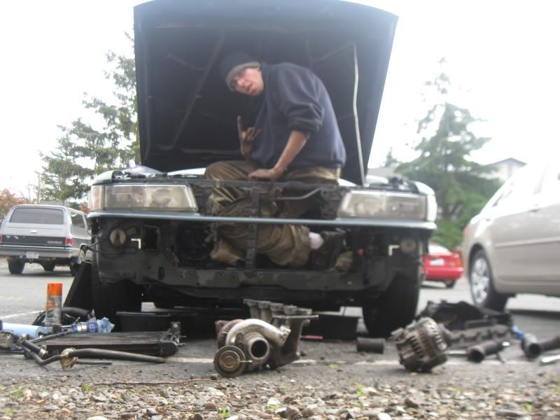

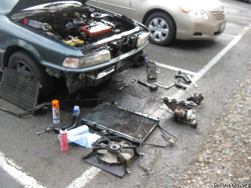

Today...pulled a bunch of crap

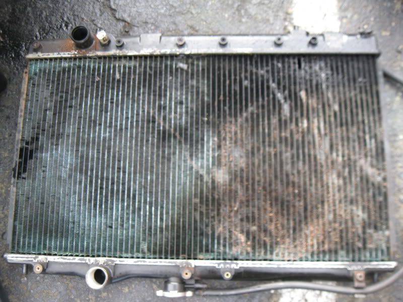

Time for a new Radiator

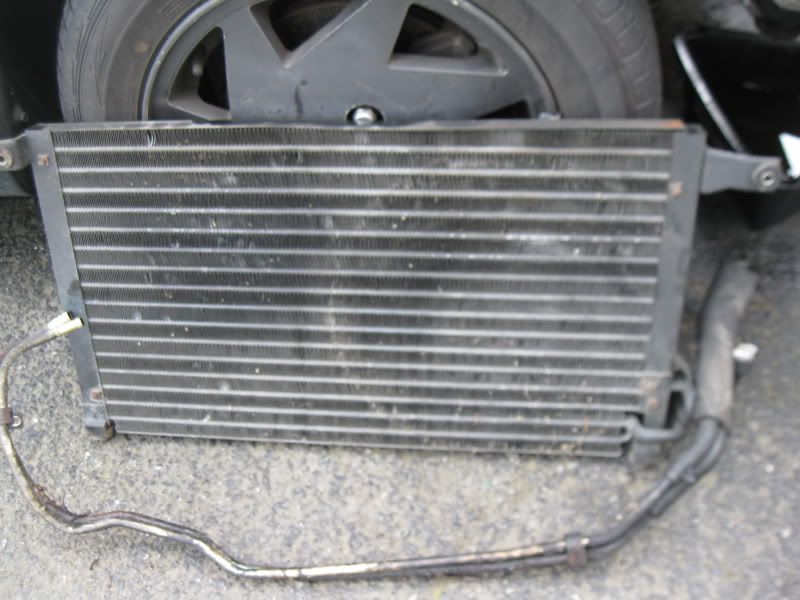

Condenser was the cleanest item in there surprisingly
I can almost fit inside between the motor and the car, probably can if I tried harder.
Oh and maf bags from the shop (they were just going to throw them out, so I snagged them) work great for covering up connectors /ubbthreads/images/graemlins/cool.gif. Suppose to rain tomorrow and Monday.
