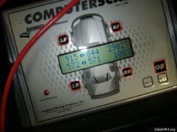

If you're only doing the first day it doesnt matter what class you've registered for. Only during the time trials would people get snooty and potential protest you. Dont worry about the classifaction right now, epecially if you're only doing the first day.

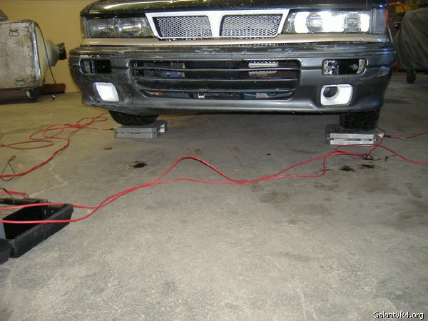

Im so pumped that the car is under 3k lbs! Its just feels so rewarding having spent so much time shaving and striping weight off of the car. Once I manage to afford and find some EVO MR bilsteins I plan on getting some ground controls and then a corner balance is in order. Id like to take some weight off of the driver's side front corner and try to even out the front a bit more.
BTW, there is a half tank of gas in the car right now too.

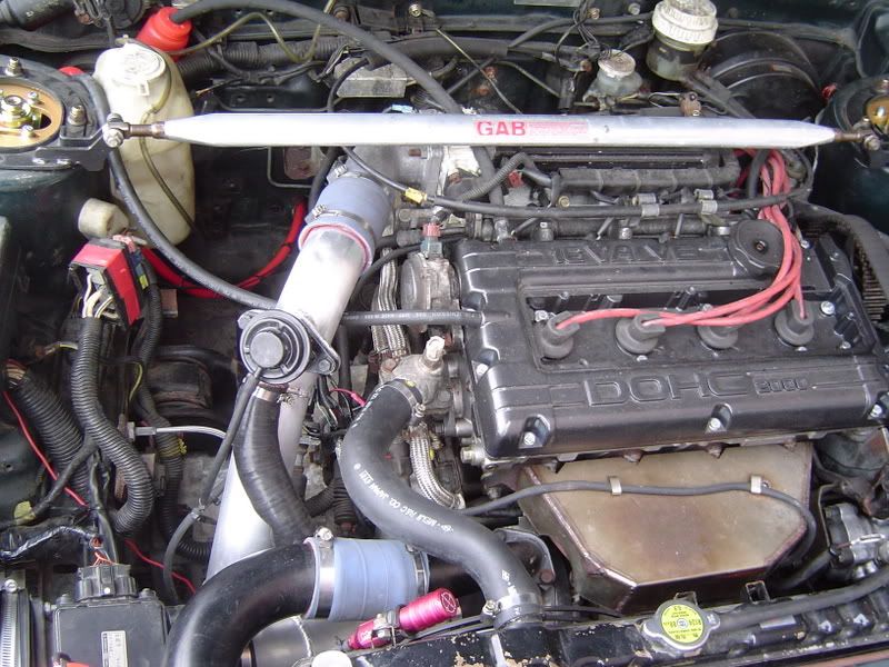

I finally brought my camera home after having left it at the shop all week. Last week Al finished the intake piping in its entirety. Really all that was left to be done was the by-pass valve tubing, and then I scotch-brited all the tubing after wards.

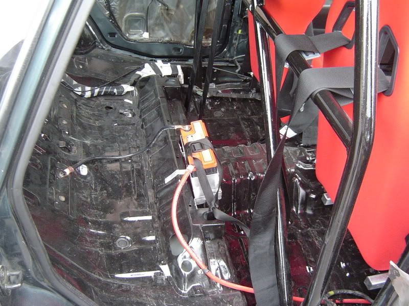

I received my Odyssey Dry Cell battery and made/mounted a battery box for it.

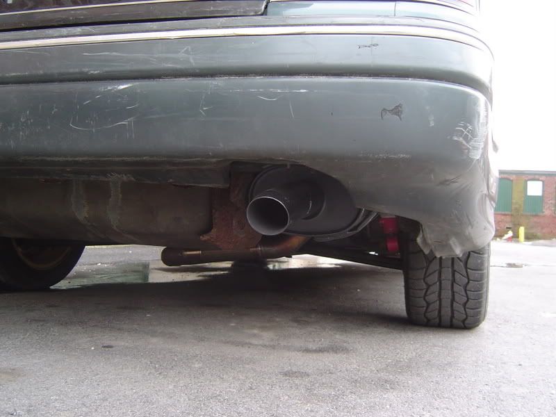

And the biggest achievement of last week has to be the exhaust system. Its pretty much all the tubing from Al's old evoII exhaust, which is a 2.5" mandrel bent and now custom fit to the Galant. I'm also using Al's old Vibrant straight through muffler. Its so quite at idle and sounds so bad ass when all spooled up. The throttle response and smooth time is incredible.

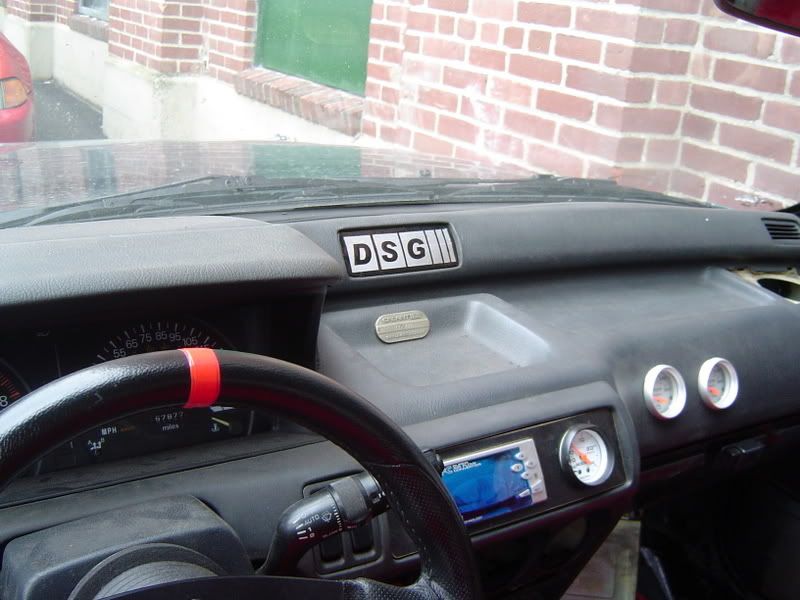

Lastly this is a little custom tid-bit I made because the clock wouldn't clip in and stay in.

How'd you get the center vents out, or was it like that when you bought the car? I've got gauges coming that I was planning to put there.

Cy, a lot of the stuff was done by our friend Sammy, who owned the car before Nick. He ripped em out with a set of pliers I think. The engine looks not so finished but it's in really good shape. We're doing a new clutch disk this weekend (or sometime before the first event)

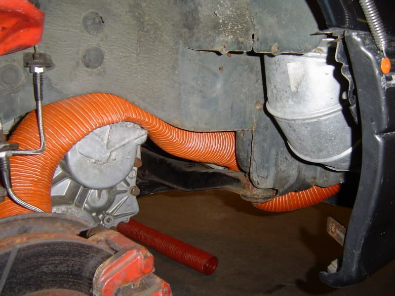

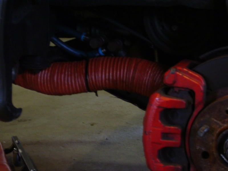

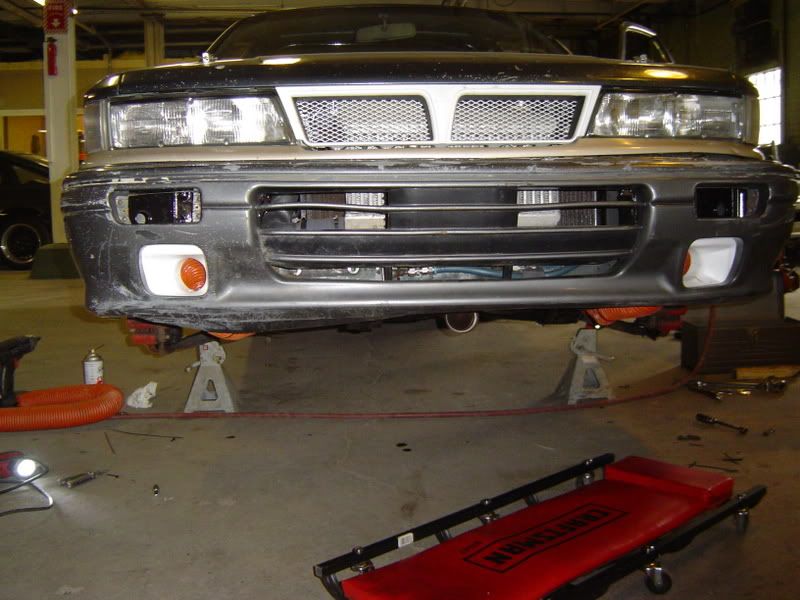

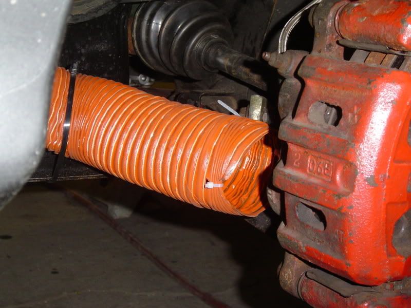

So as the local racers know, NHIS was canceled due to snow; and the up coming Watkins Glen might suffer the same fate if the weather doesn't improve. But the car was pretty much ready to go for a shake down week end. It was extremely disappointing for everyone, as we had all worked long hour prepping the cars. The Galant got a few new goodies thrown on, with a few more to add on.
I managed to get the brake ducts installed, and I really wanted to see if they made a difference or not.
I also install the Hawk HT-10 pads with a full system flush with Motul 600 fluid.

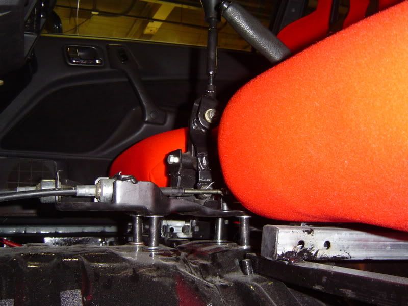

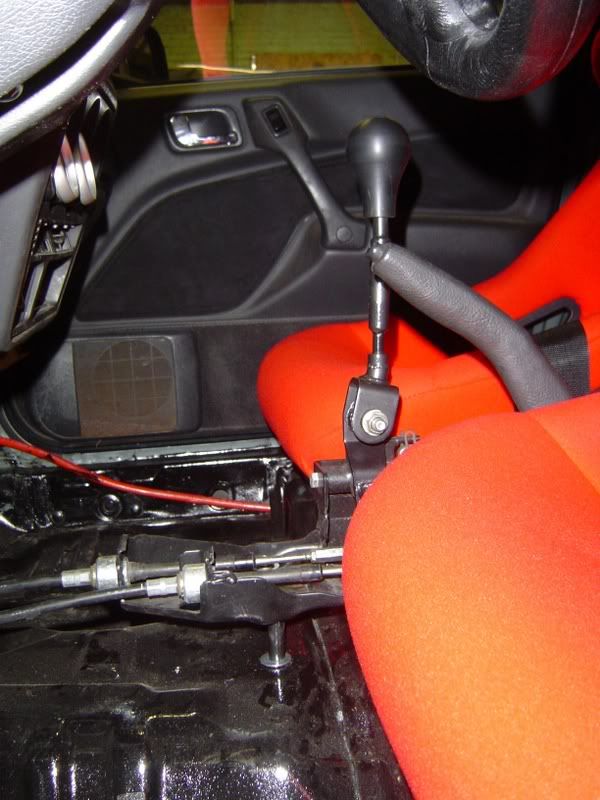

After having driven the car on the street for a couple minutes, I started to agree with Al when he said that the shifter throw was too long. I liked the height of the shifter, but the throw was comparable to a jeep wrangler. So after a brief compromise, we decided to cut the shifter rod, but raise the shifter base. Thus keeping the height, but shortening the throw. It feels 100% better.
