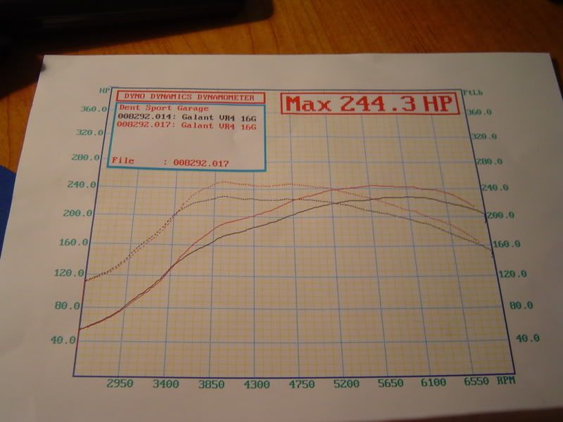

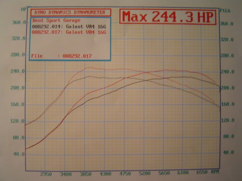

It stopped making power when we maxed out the 560 injectors. Matt was able to work with the timing a bit to harness a few more ponies for the stable. Last time it was on the dyno it only made 200whp.

Nice. What was it that a stock sti dyno'ed at on the roller? I think your brother posted it somewhere. Would be a good comparision to know.
I made about 70 more hp on a 16g on a 2.0 with 560s with 85% IDC. I dont see how you are maxing those out.
Back on topic, when is the first event for this car scheduled? Or did I overlook something?
^Huh? Precisely? Purposefully? I'm confused.
Are you saying that the dyno reads low because stock evos/stis make around 230/240? That makes sense then.
