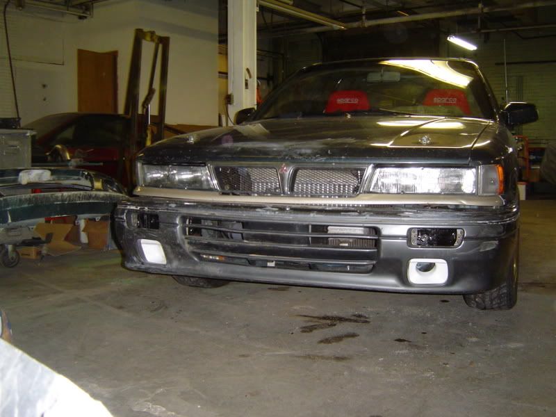

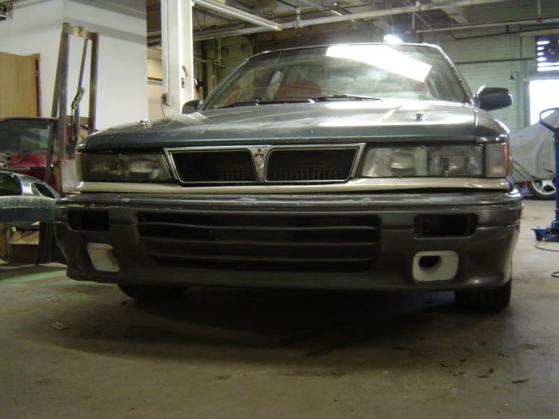

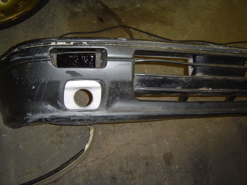

Today I mounted the brake duct inlets to the "new" bumper that I picked up from Besso. And then I mounted the bumper back up to the car. Doing body work on a 15 year old car sucks. The passenger side of the bumper sticks out about 4 inches, and when you bend it back in, it crimps and folds in a couple of points. But its on.
It has a bit of a snarl on the the drivers side do to the slightly mangles center bumper portion.

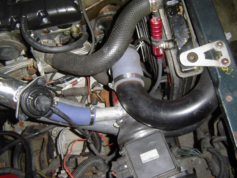

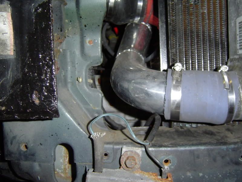

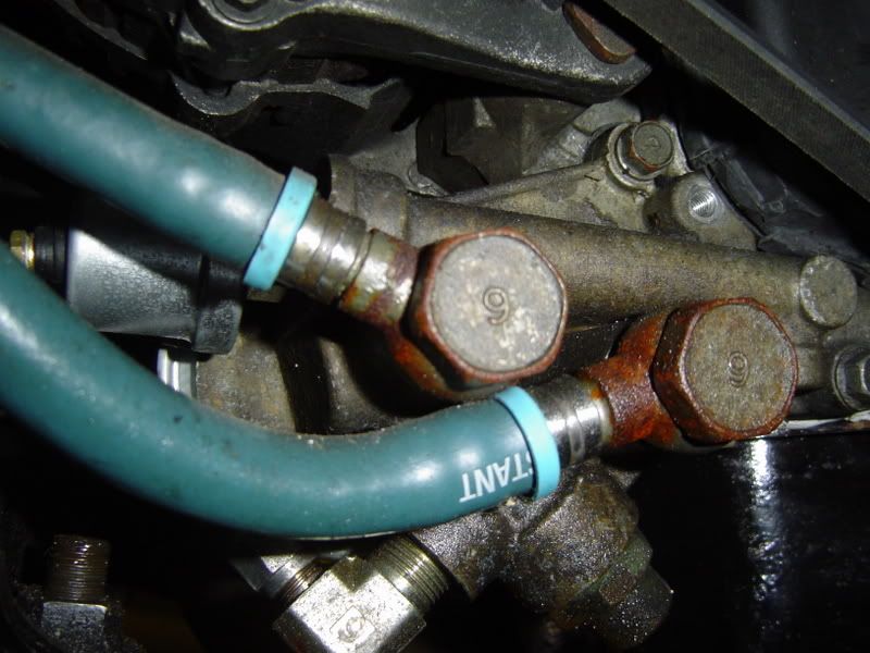

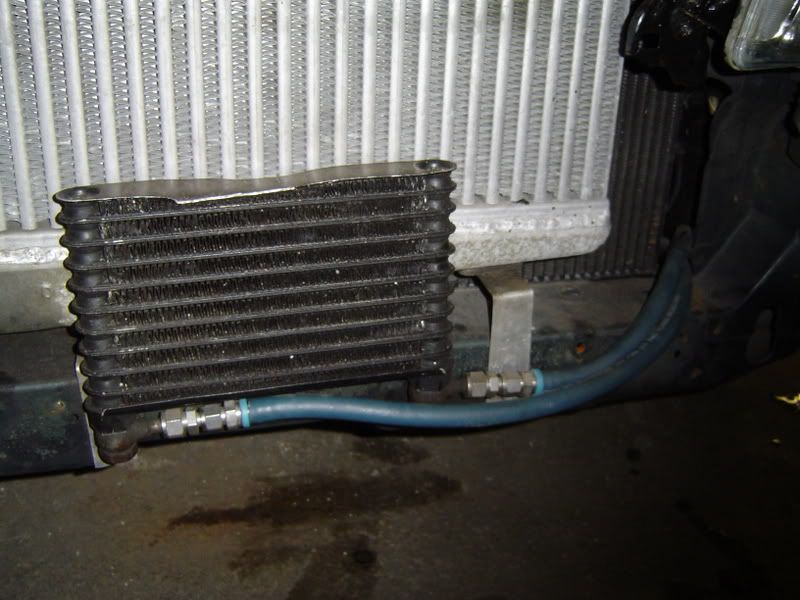

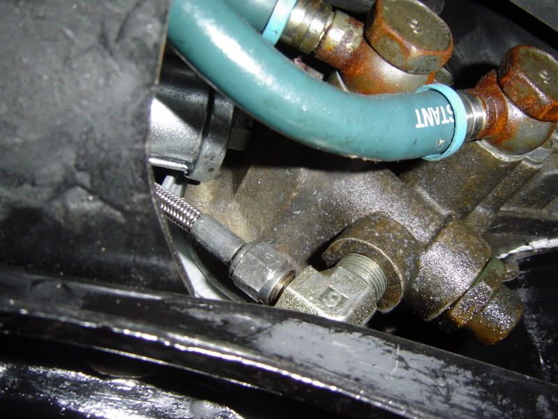

And I snapped of couple pics of the inter cooler piping (on the car for now) and the oil cooler, as per requests.
I apologize for the crappy pics, the car was still on the ground so I was just putting the camera in there and snapping pics.

These maybe?
[/url]
$15 bucks each at Racer Parts Wholesale... I've been meaning the measure the fog light opening backside to see if these would fit.

thanks very much. the pics are perfect. i'm stealing your oil cooler mounting idea.
No sweat. Im glad those pics worked out for you. I wasnt exactly sure what you wanted to see.
Where'd you get those foglight inserts?
I may need to repostion the passenger side one once the bumper is fastened, it looks a little kook-eyed. I got these off of ebay actually. But they have a site listed as www.nimac.biz if anyone is interested. I guess that have a lot of american engine exhaust flanges there too.
I need to find two more actually, but they need to be longer and thinner. I plan on makeing the upper blinker/city light openings into a ram air intake on the passenger side, and an alternator cooler on the drivers side. Its hard to find ducting thats about 7.5-8" long while only being about 3" high. I may have to make those out of aluminum.
Just to be difficult...

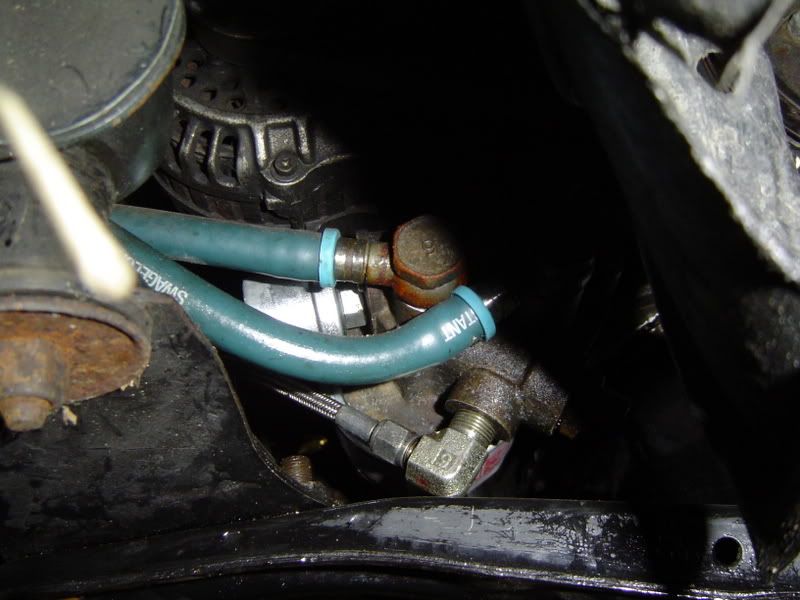

Isn't the oil cooler supposed to be mounted "lines up" so it can't drain out and create an airlock when the car is turned off?
Cya, Ted
Bimmubishi
Jul 15, 2003
5,704
Boston, Massachusetts
Ted, I don't know much about that. Mitsu seems to think that lines down is kosher.. note the factory mounting of mine..
(pic taken last year) Note: badass corded street tires!

We're going to be normalizing the finish on the IC pipes and then anodizing them. The turbo intake pipe is going to be remade pending aluminum shipment... The previous owner is responsible for the mounting of the coolers and IC pipe groundwork. I think it's really awesome, to be honest. It's as short as possible on a Galant. It's probably 3-4 feet shorter. Someone calculate the volumetric difference for (-)4 feet of 2.5" tube- 235 cubic inches!

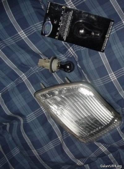

More ideas are brewing man. When you remove the passenger side turn signal, it basically becomes a straight air duct for your intake / engine bay.
(like so)
I also just happen to have a JDM drivers side (JP Passenger side /ubbthreads/images/graemlins/crazy.gif) clear corner if you want it.

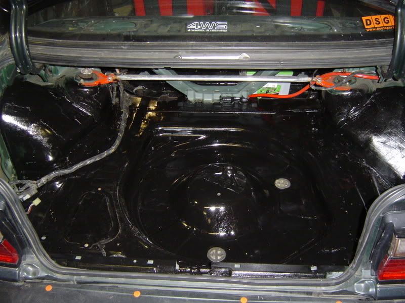

I first started to work on the trunk area, because that is the only section of the interior that I hadnt really touched. So yesterday I spend the morning stripping out most of the sound deadening and sanding the entire trunk.

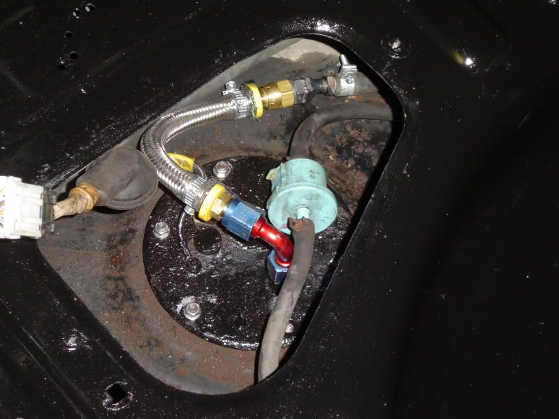

This involved removing the fuel pump cover to reveal a very rusty fuel pump and fuel fitting. It was so brittle that it cracking in multiple places as soon as we attempted to remove the fuel line. Eventually the top of the pump broke right off. This, for most people would be a big deal. But luckily I was at the shop and Alex already had a fix setup in his mind.
(I was removing it to see what pump was in there. As it turns out, its a TT Supra pump! I love finding little bits of gold in the car!) Notice the POR15 on the pump too. /ubbthreads/images/graemlins/wink.gif

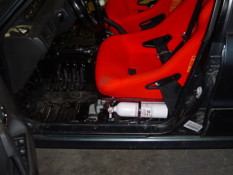

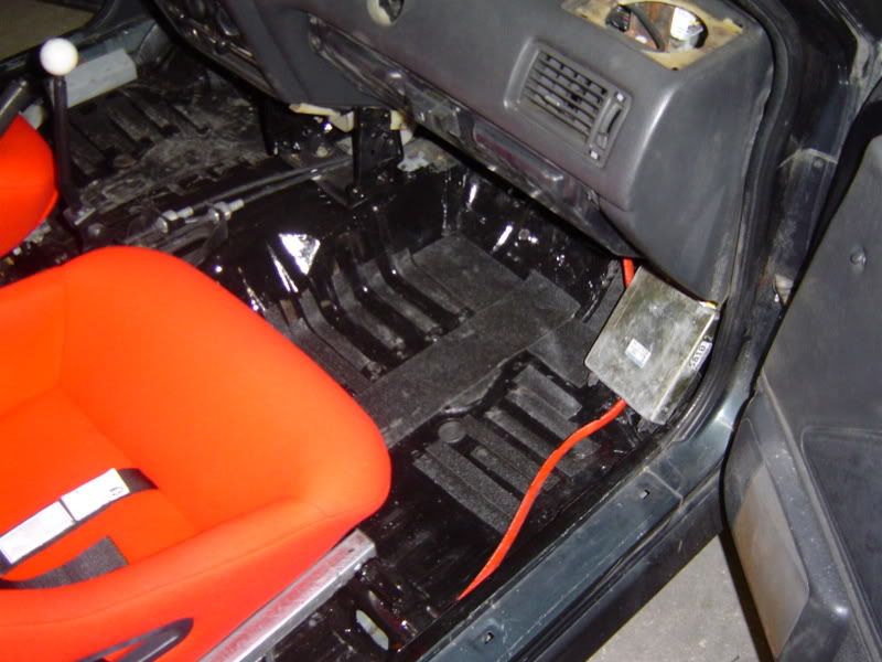

Today I mounted up fire extinguisher to the drivers side area. Im rather pleased with the way that turned out. Its extremely accessible from virtually all angles, even with the door closed.
And I finished putting in all the grip tape to the floor boards. None of this is very technical, but it all needs to get done, and now it has.
