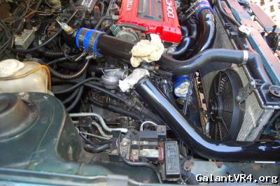

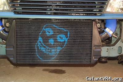

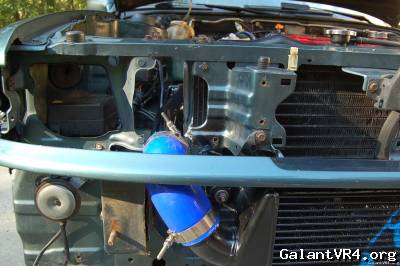

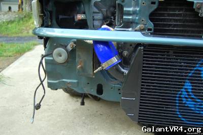

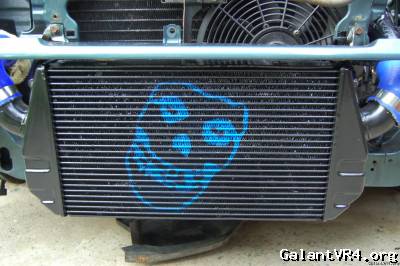

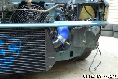

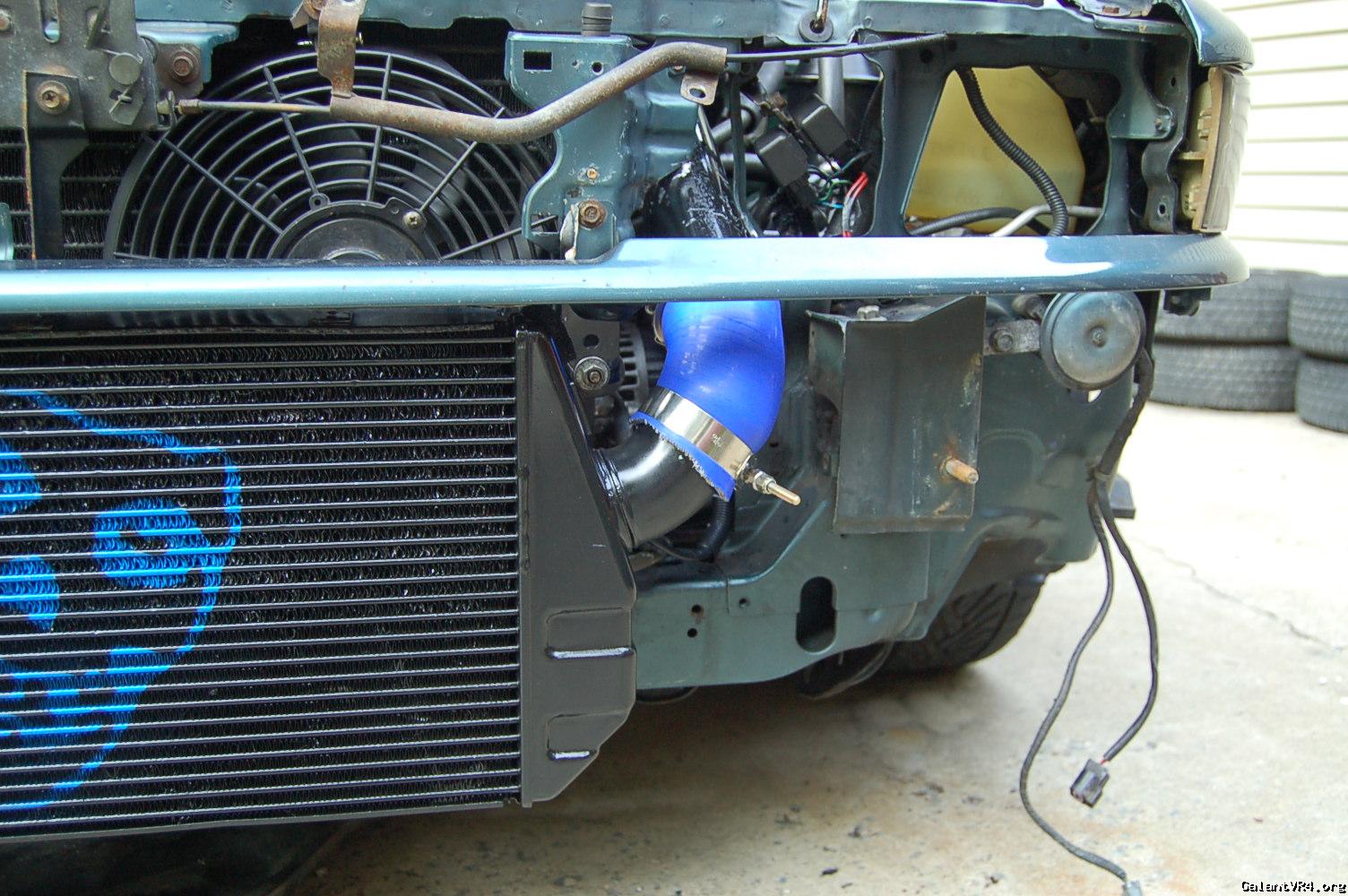

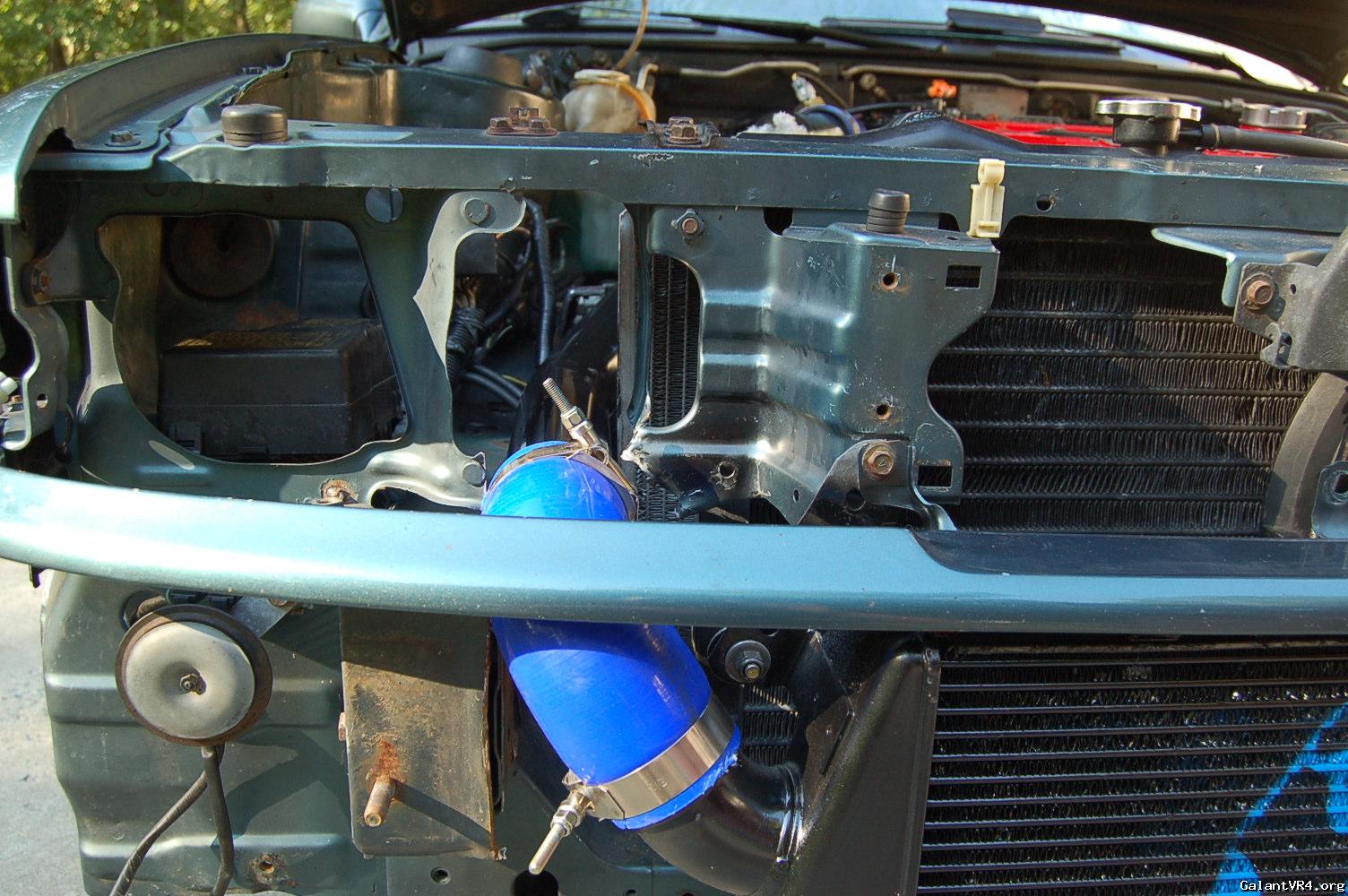

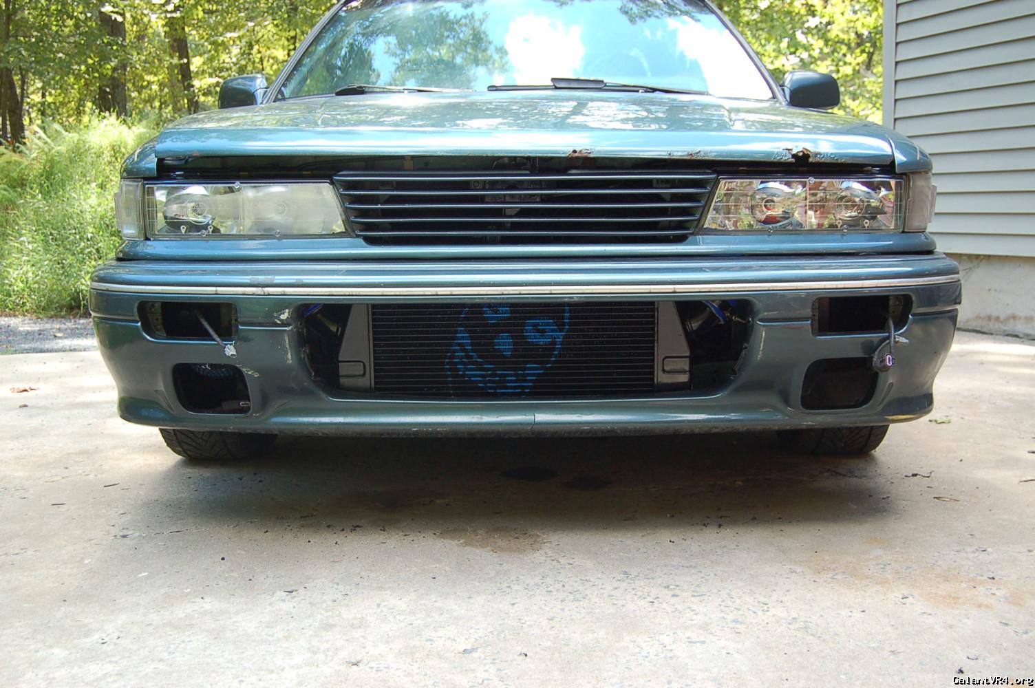

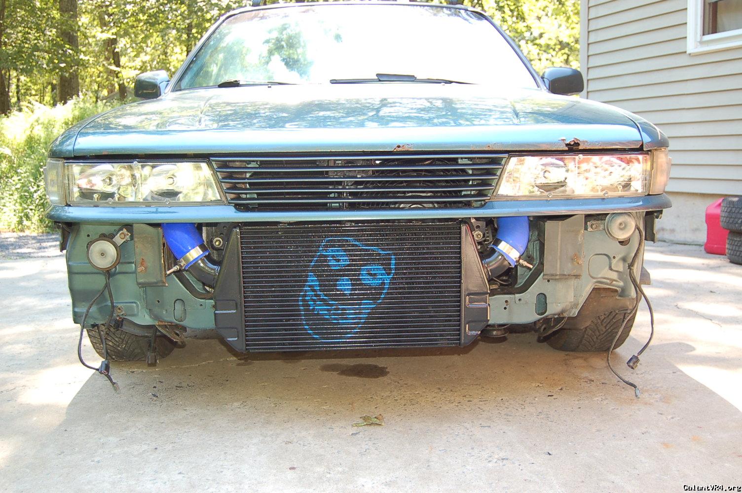

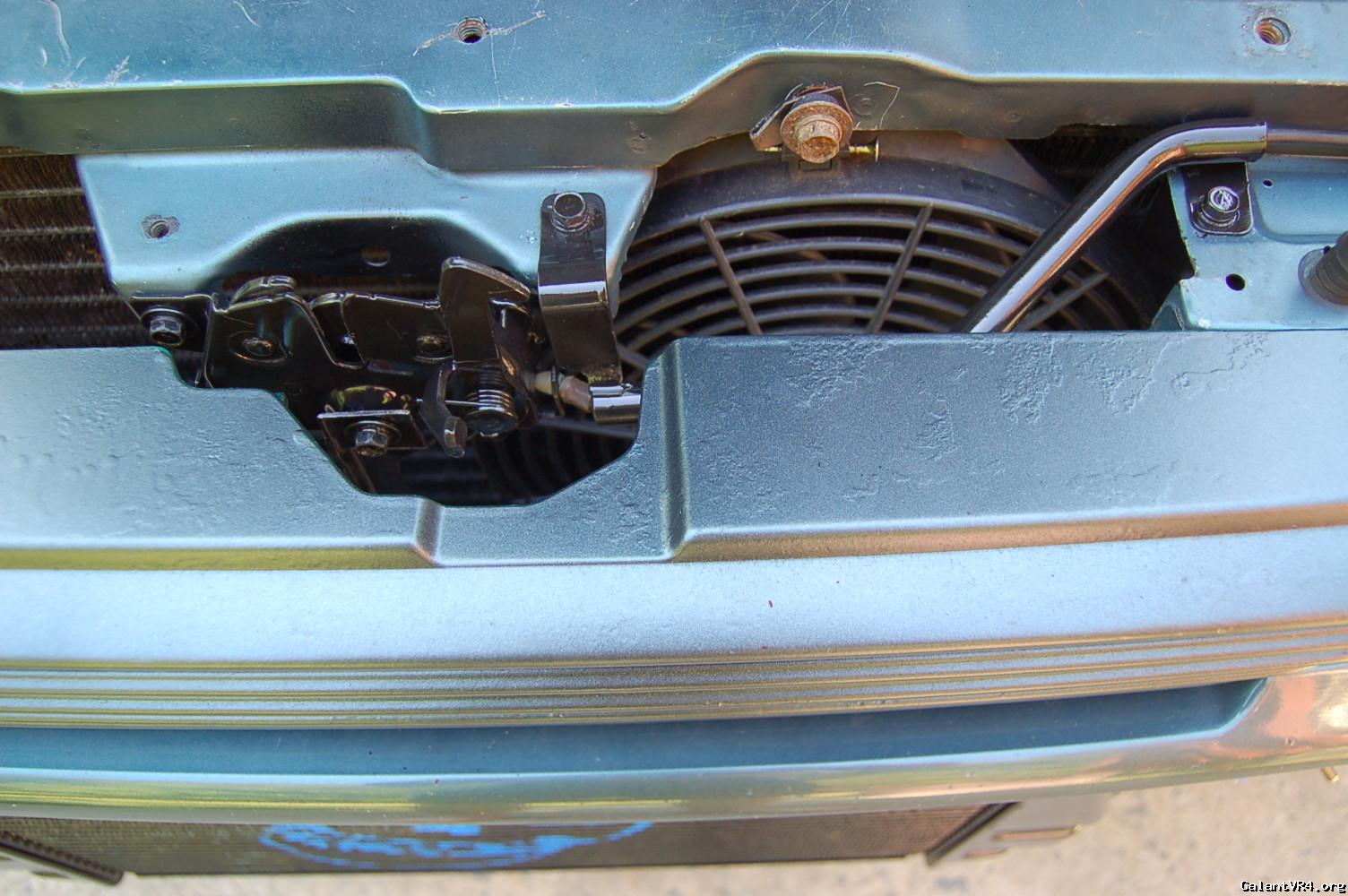

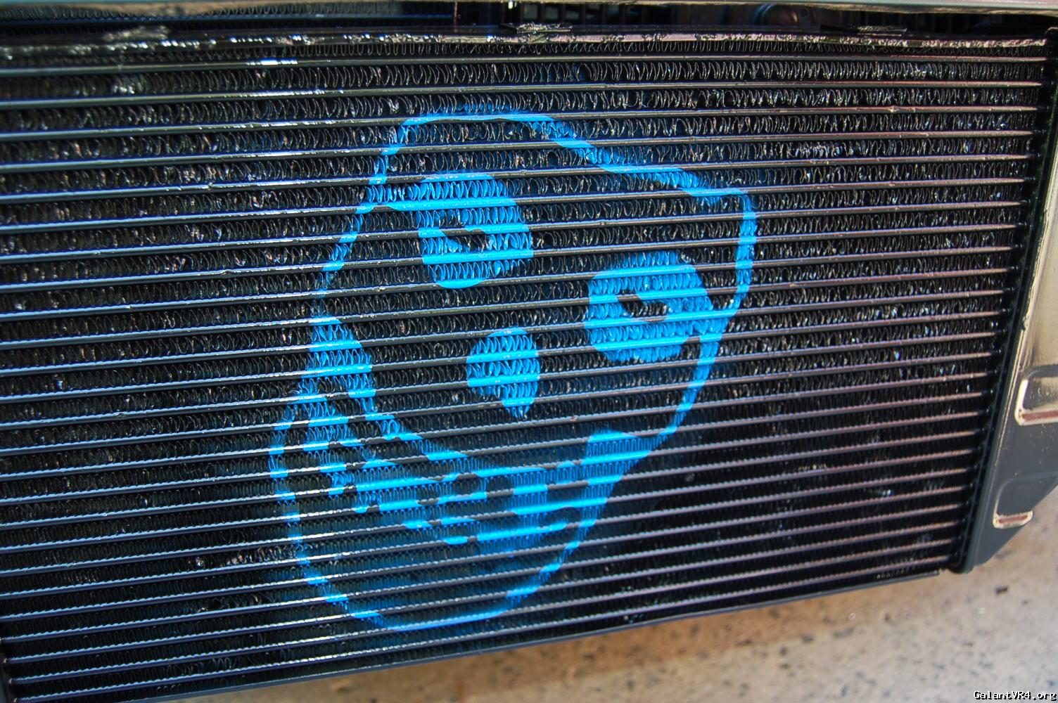

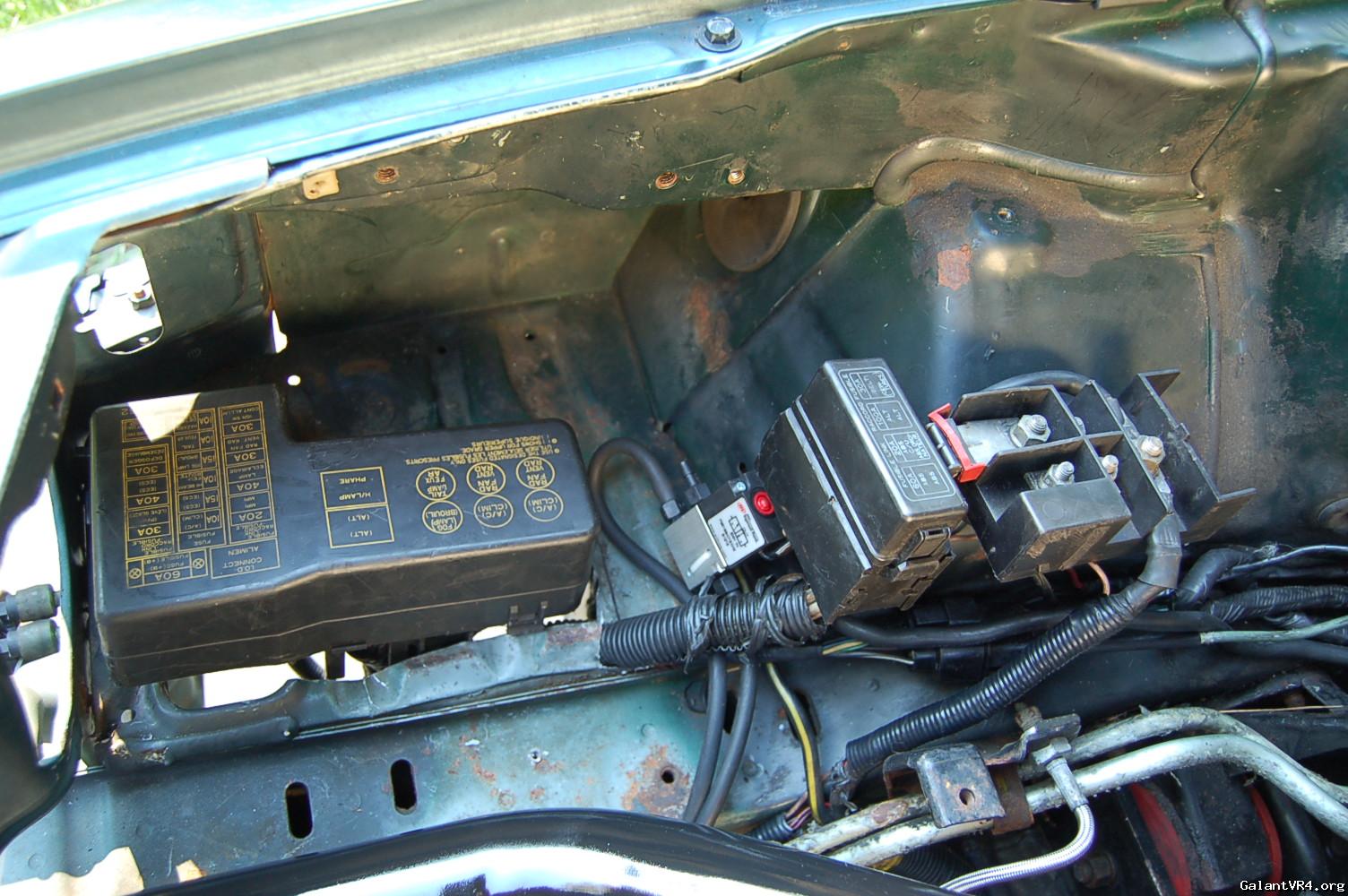

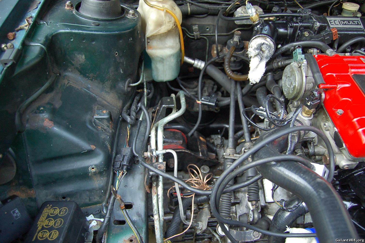

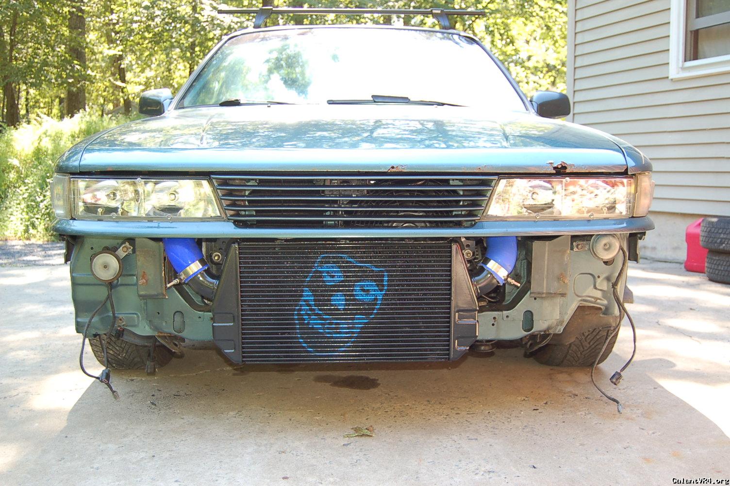

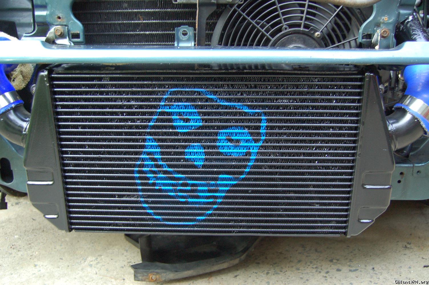

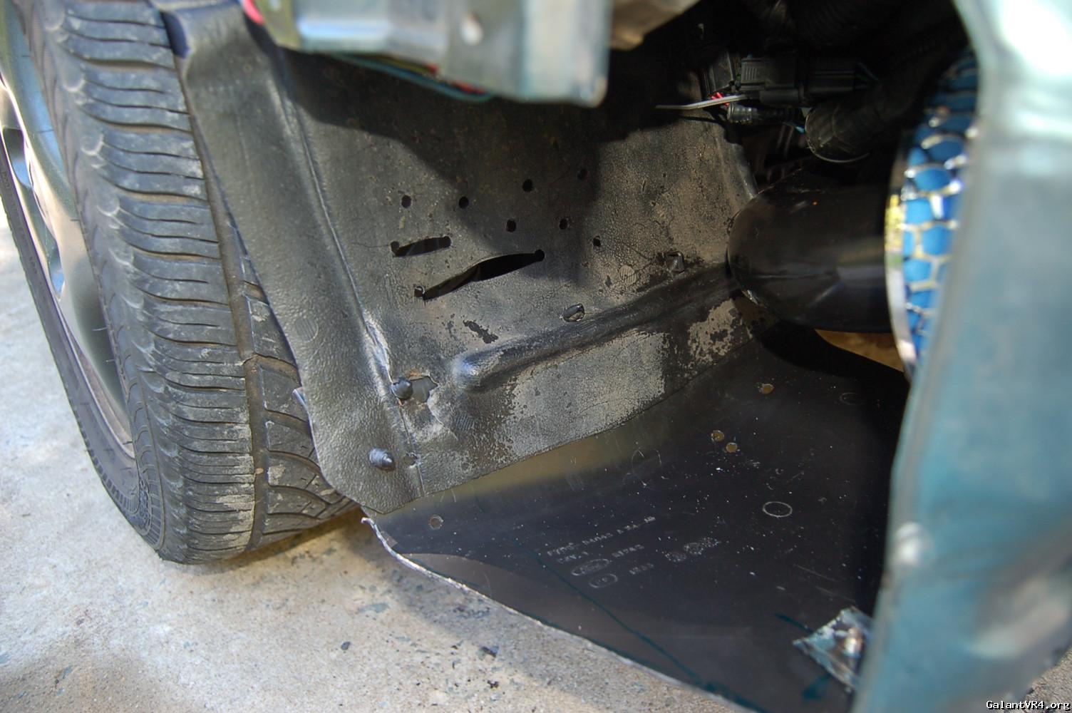

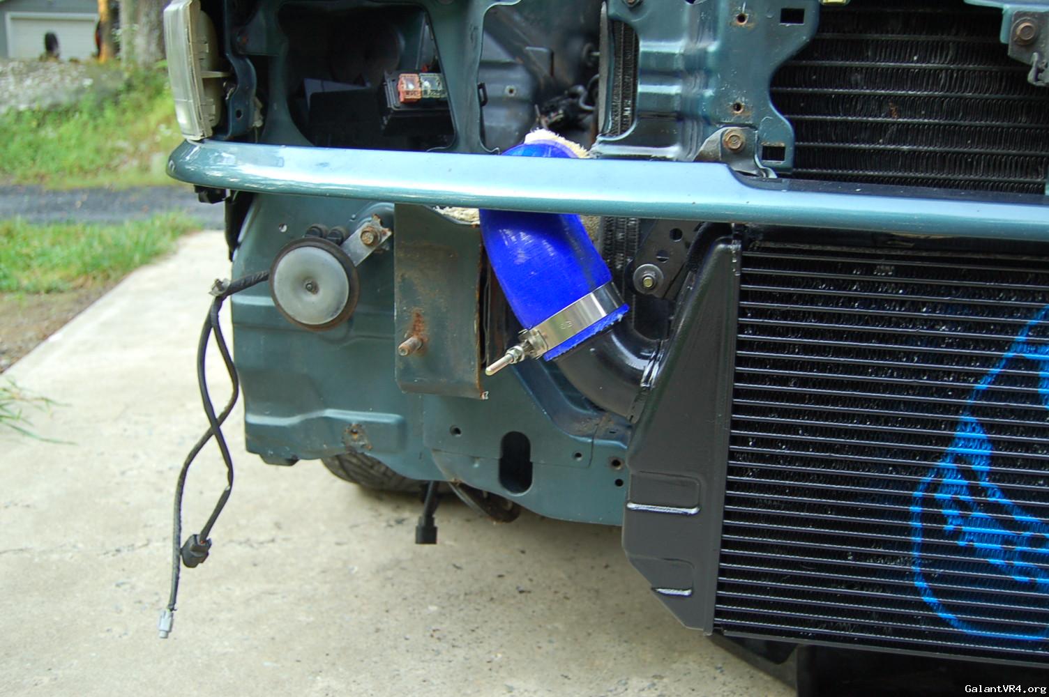

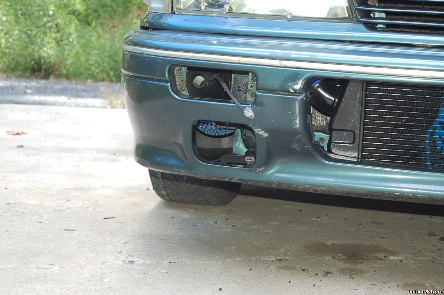

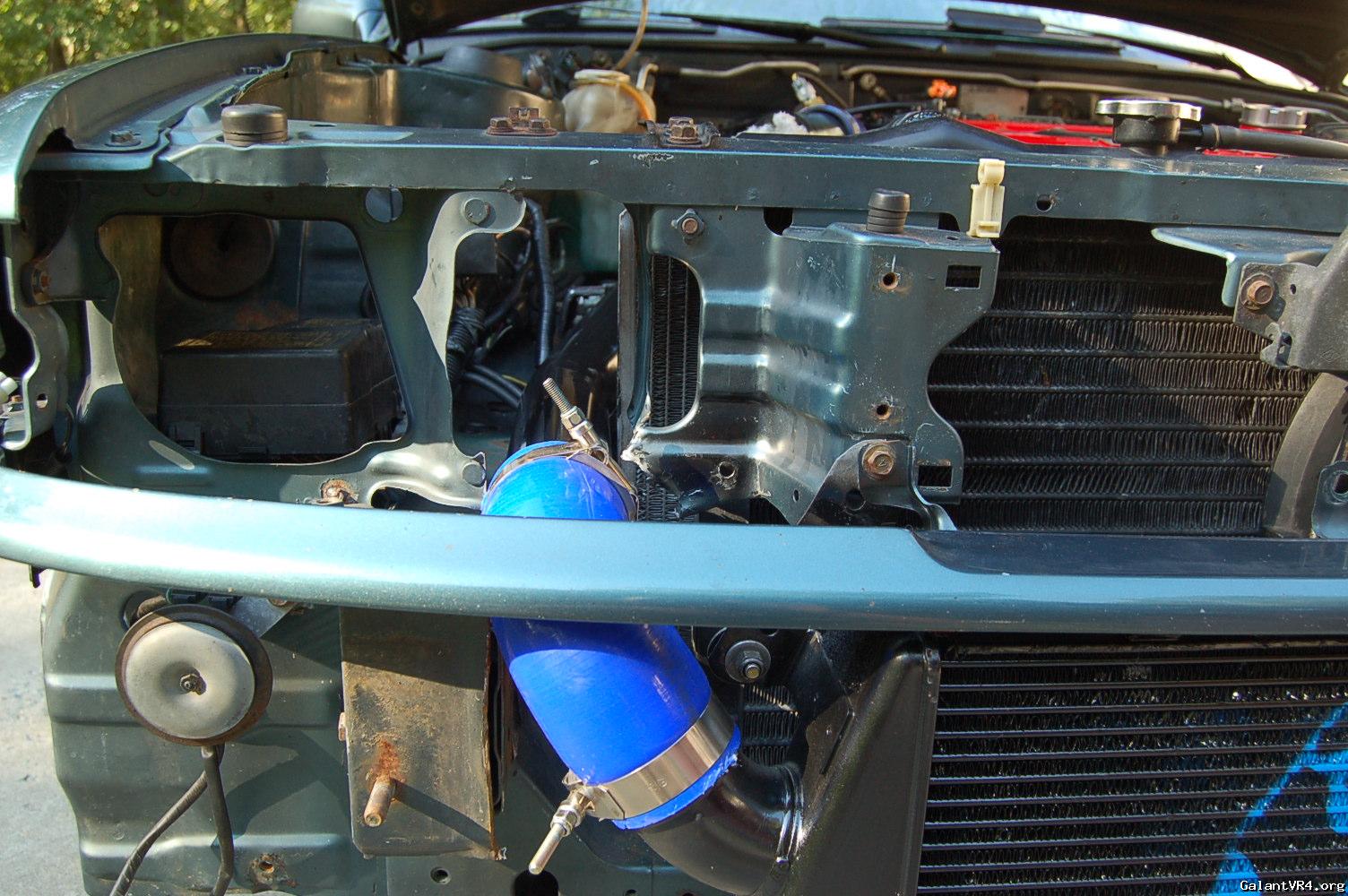

So i decided to find this vacuum leak. I hooked a boost leak tester up and it was coming from the BOV area. i decided that since have to fix that, that i would take all of the intercooler piping off, rescuer the intercooler core to the car, swapped the a/c fan for a slim fan, cut out the front bumper and support so you can see the intercooler and the misfits skull that i spray painted on there, do a bit of a wire tuck on the pass side, spray all the intercooler piping black, cruise control delete cable, swap some things on the 93 clear headlights and clean some other things in the engine bay. i will be taking pictures as i start to put it back together. really excited because it looks a lot cleaner already and will make things under the hood a bit more discrete.

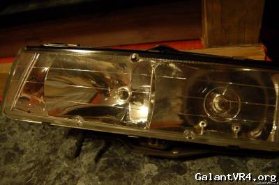

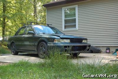

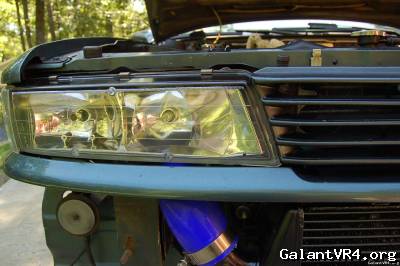

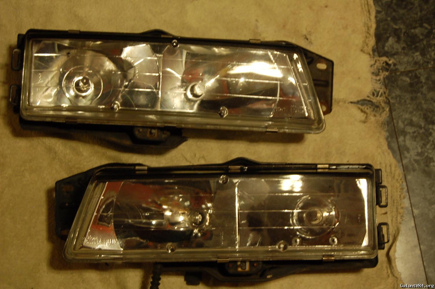

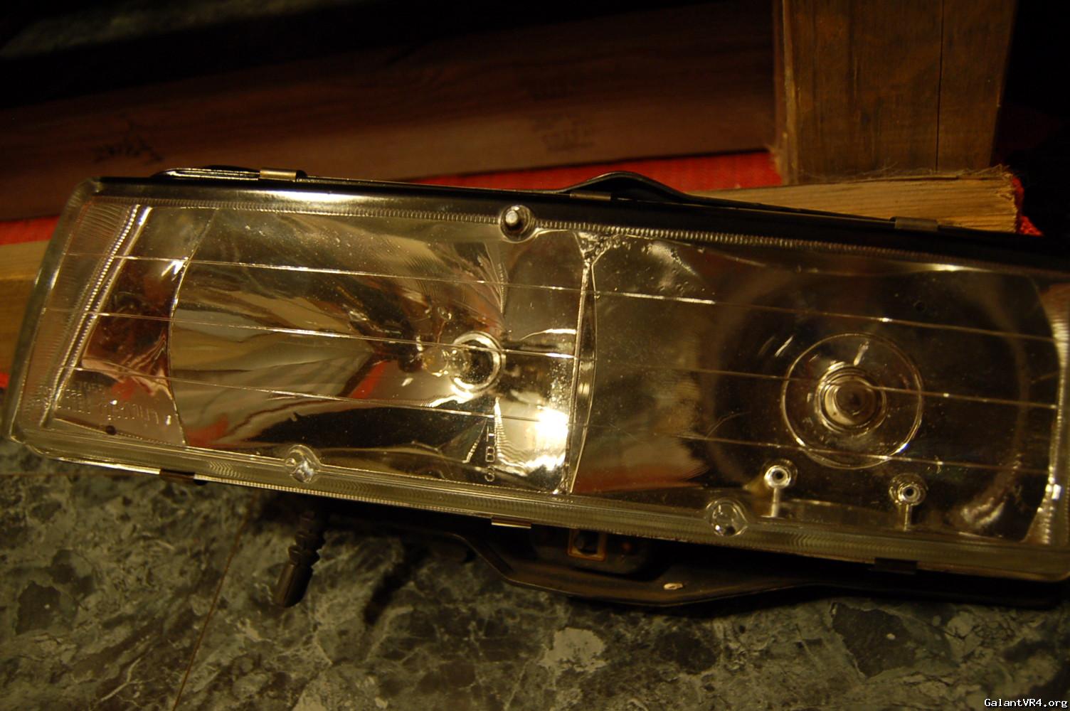

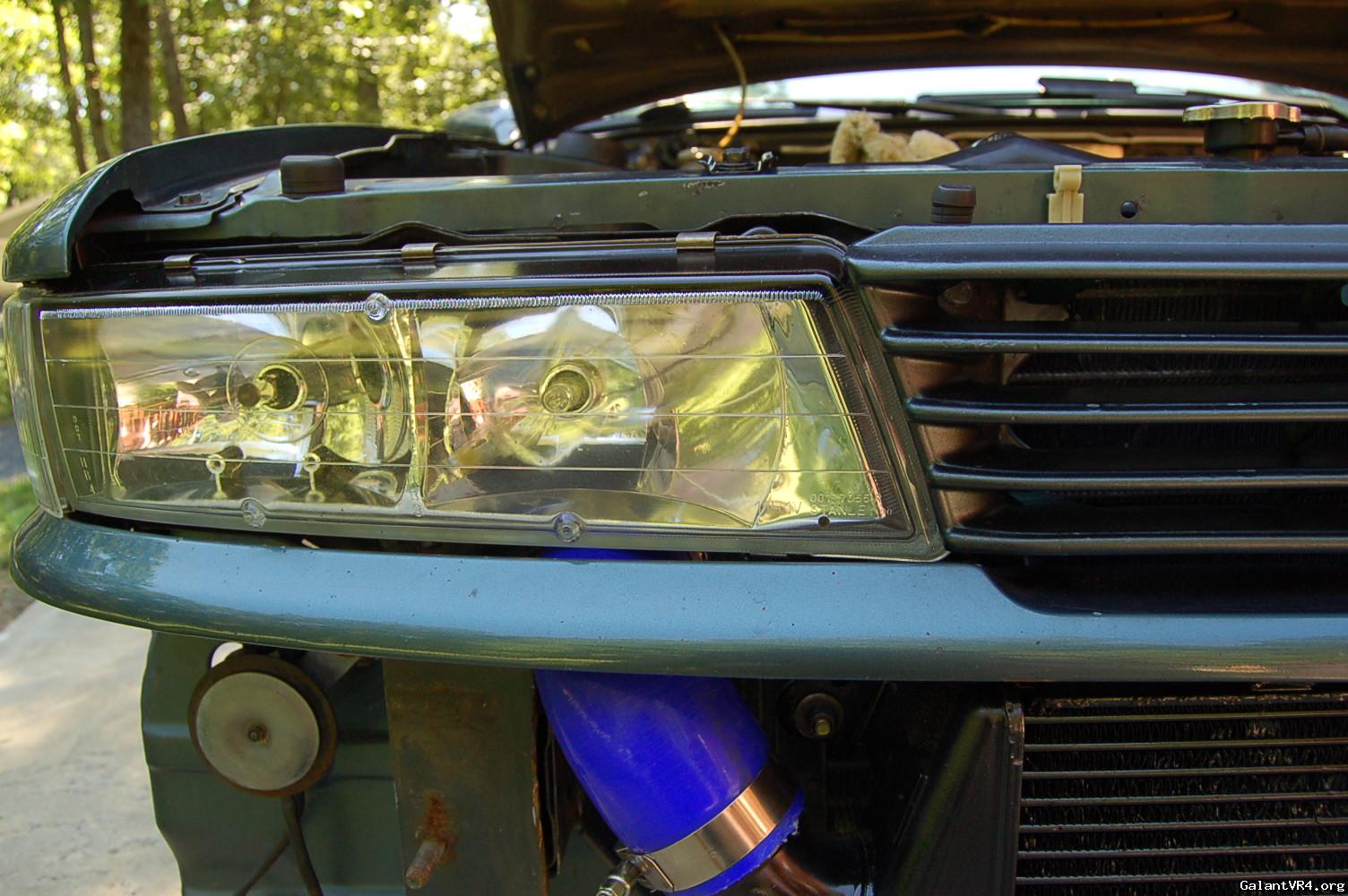

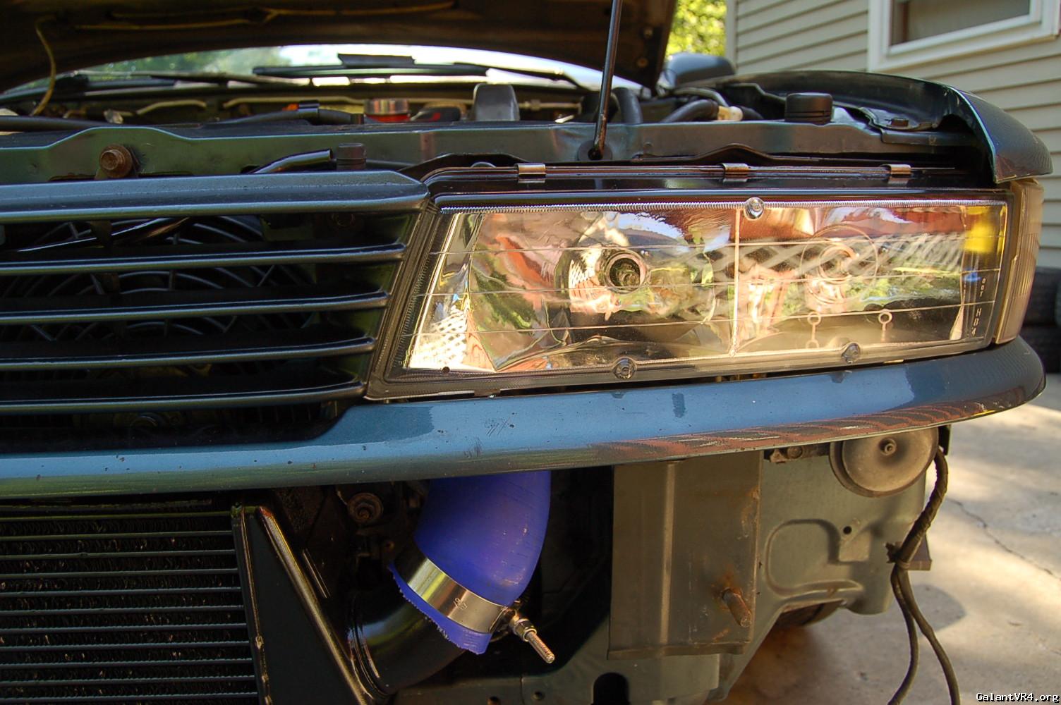

here is what i did to the headlights.
i took the headlights i had in the car and baked them and separated them, then did the same to my new 93 clear lenses i had. the inside chrome was peeling so bad in the 93 ones that i used the chrome from the stock ones, but i removed the deflectors from the low beam section. i really like the way they came out. i also repainted the top of them black.

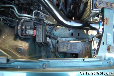

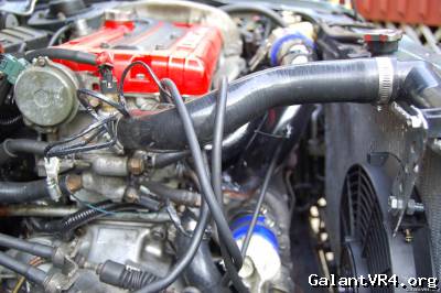

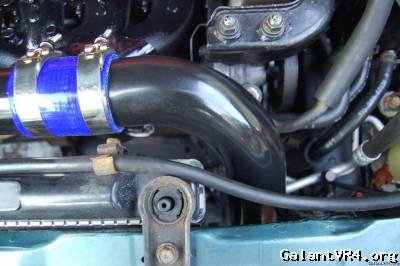

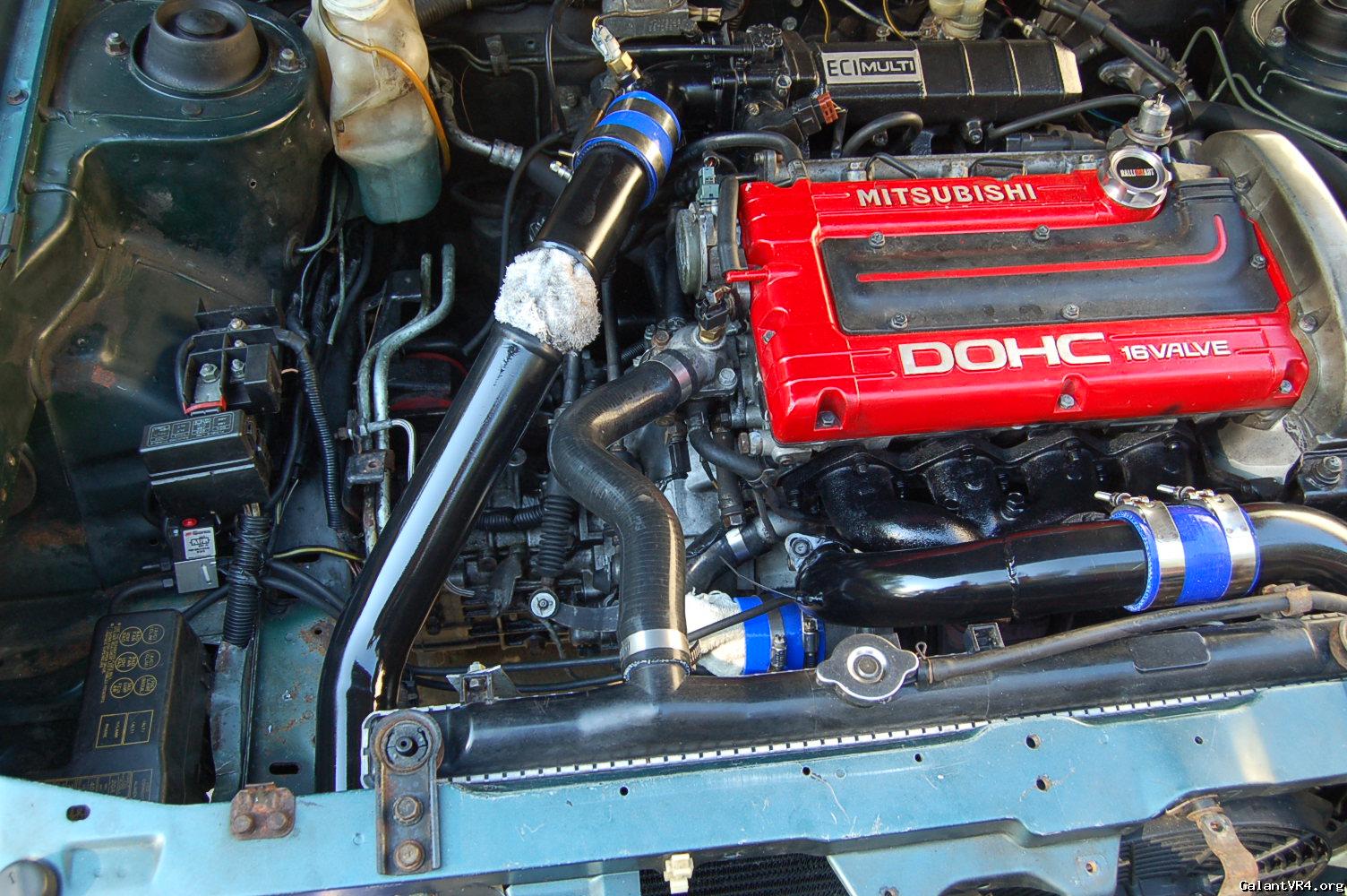

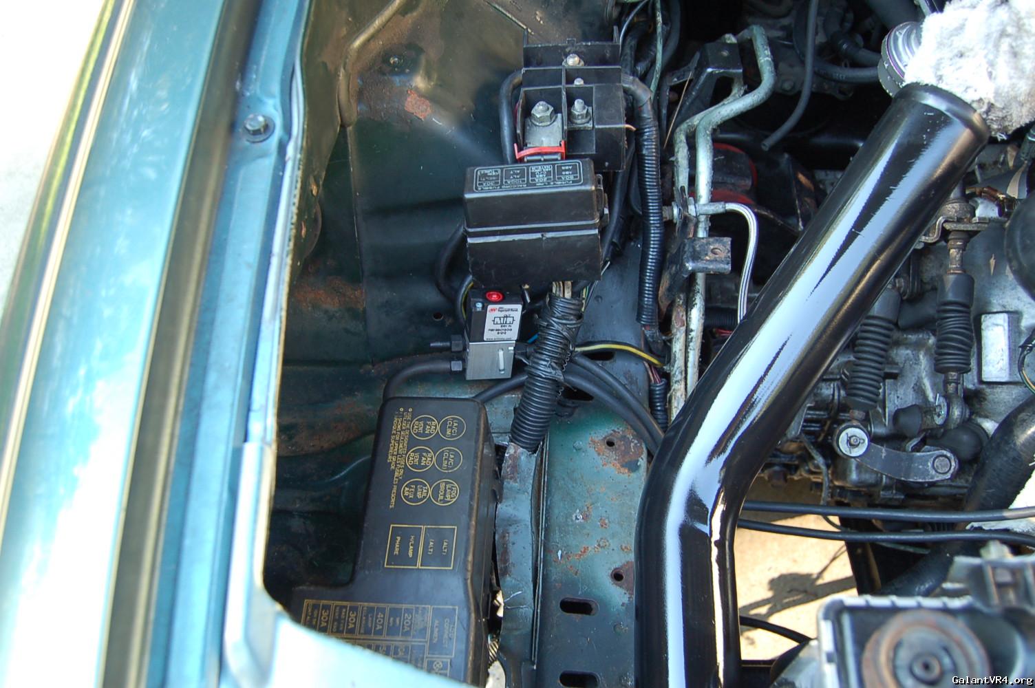

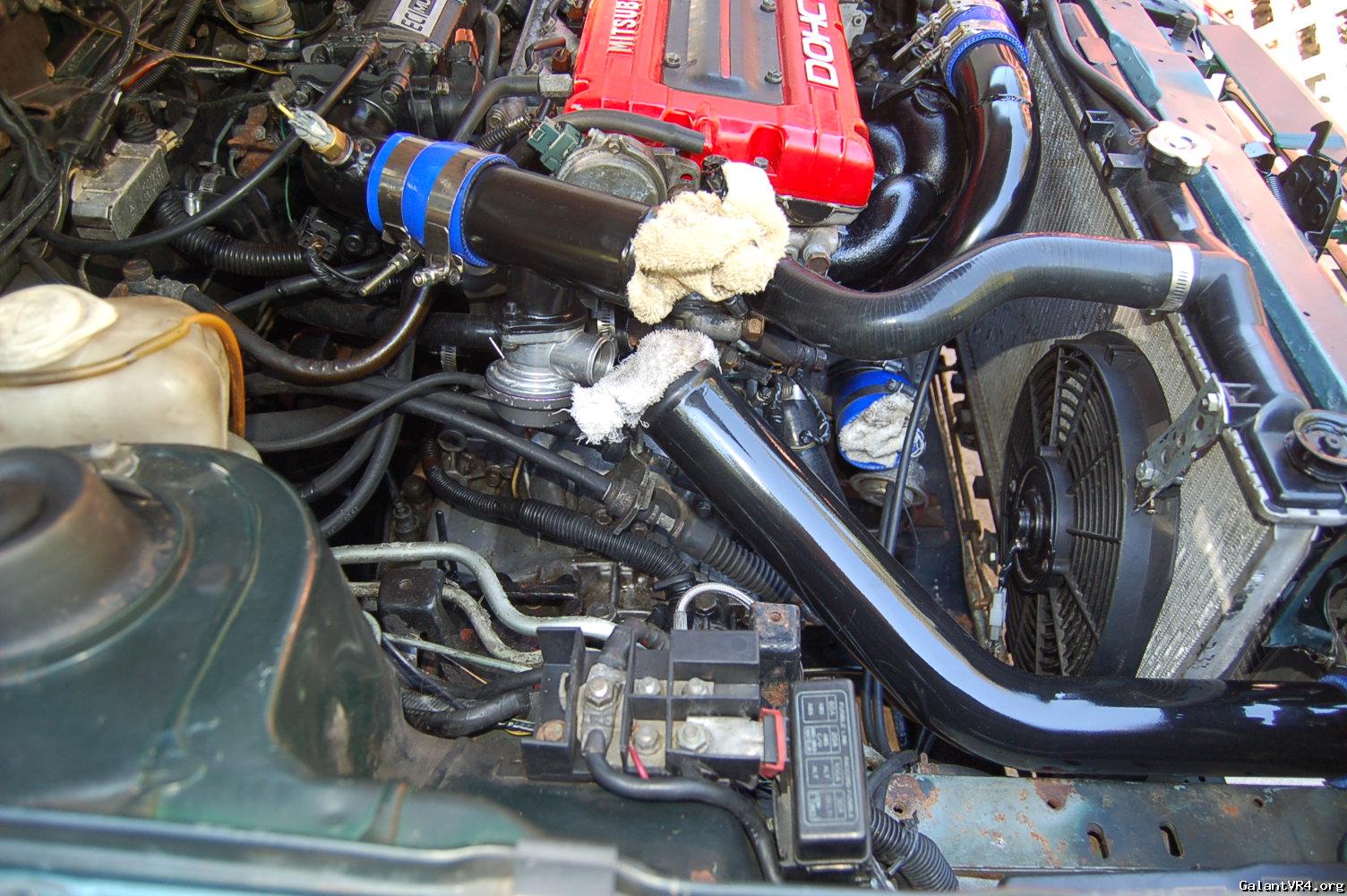

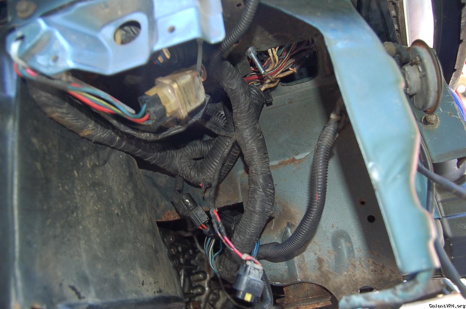

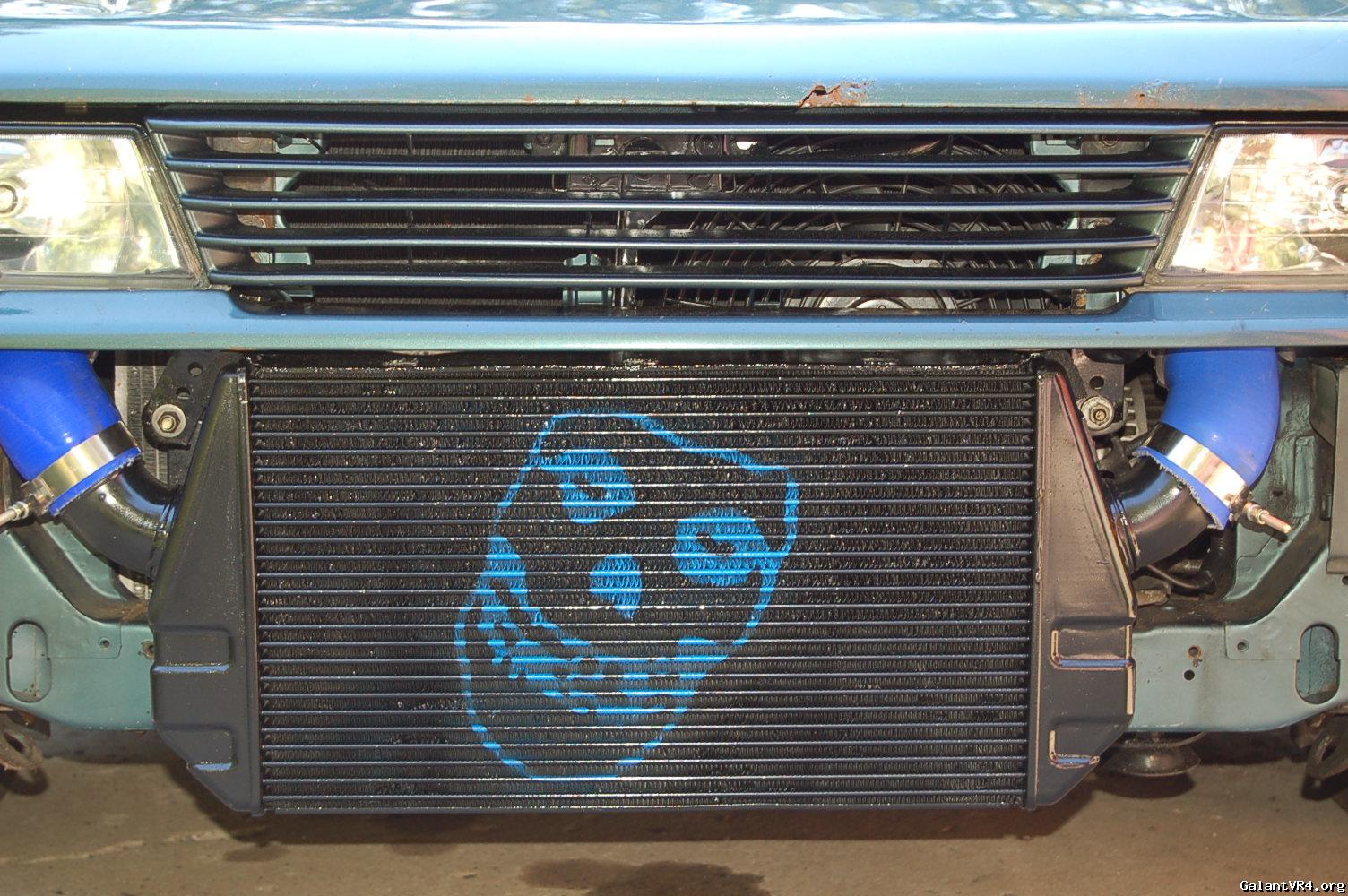

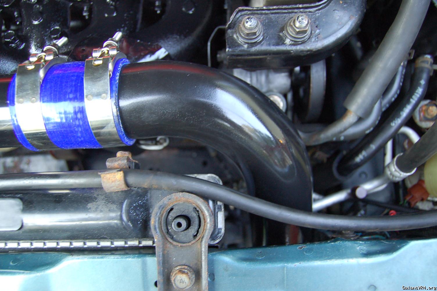

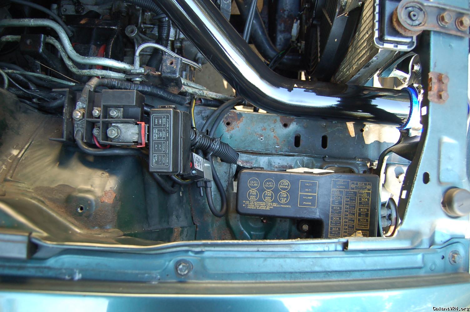

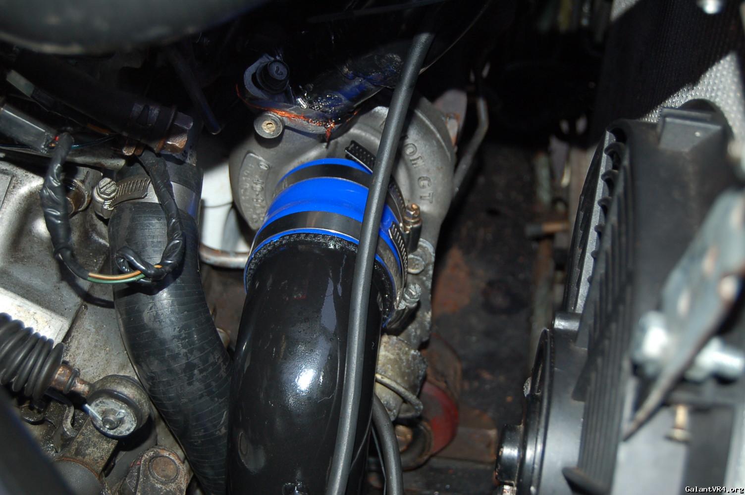

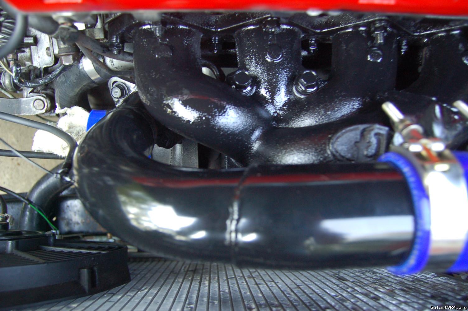

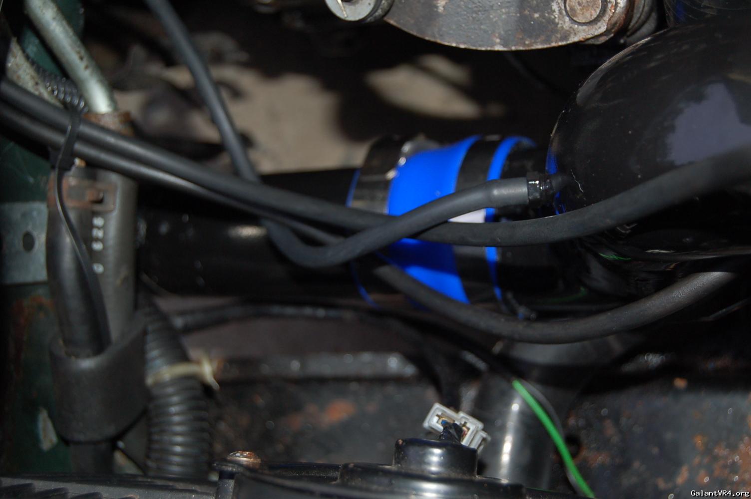

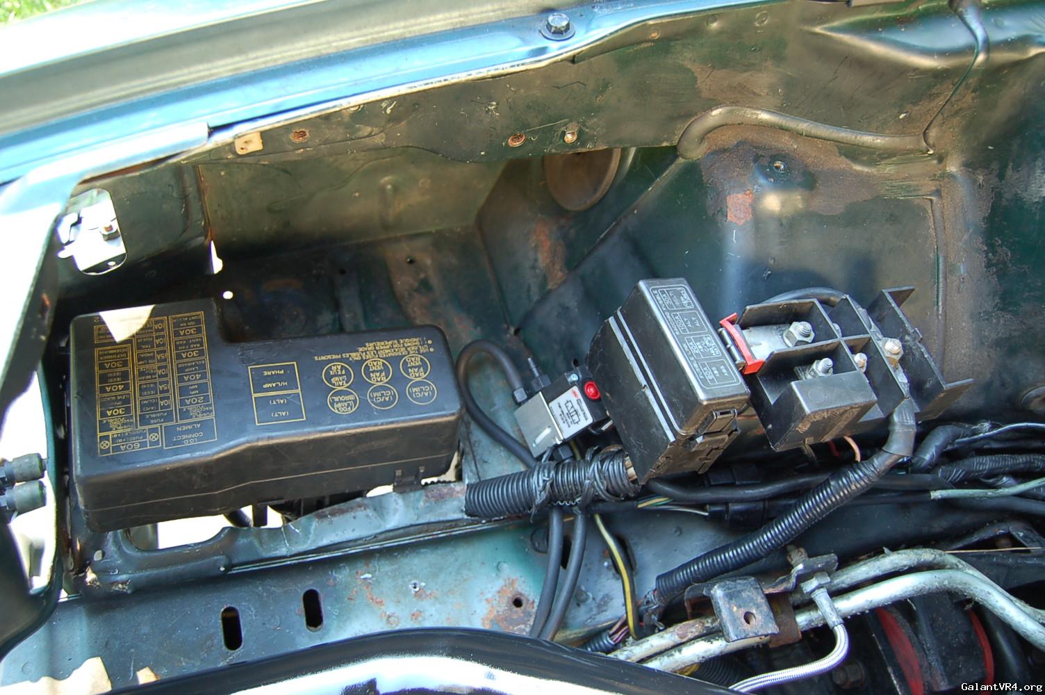

got some of the piping installed this morning and started to wrap up the wire tuck.
hope you all like it, i personally think its coming along really nice, im happy with it.
just finished the wire tuck and installed almost the rest of the piping aside from one 45 degree coupler.

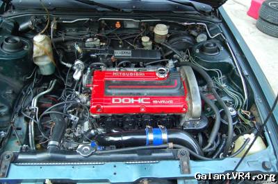

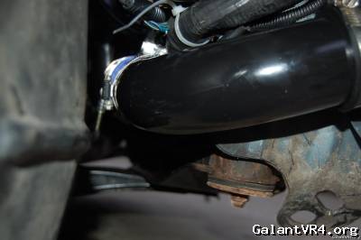

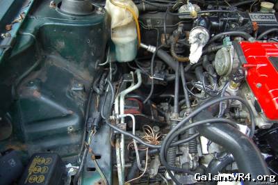

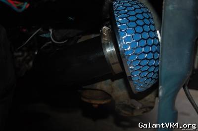

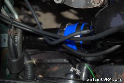

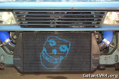

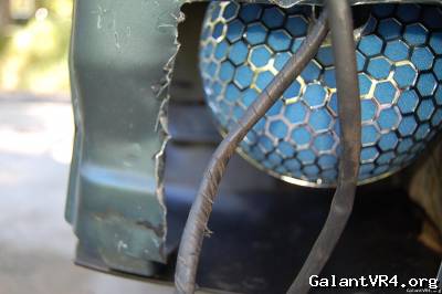

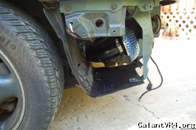

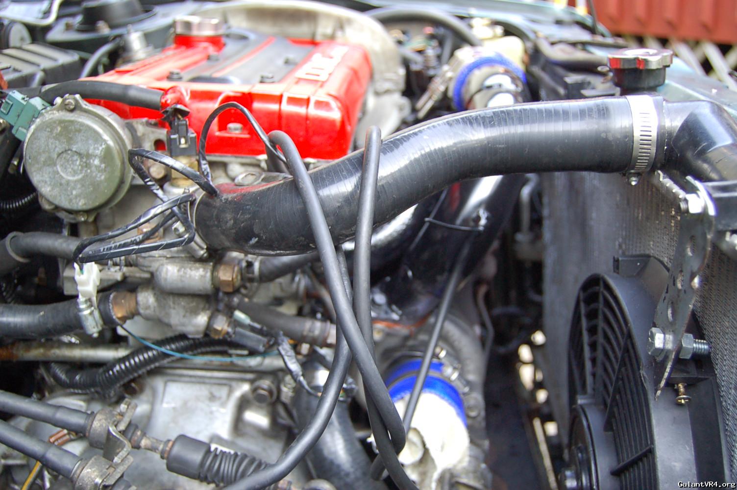

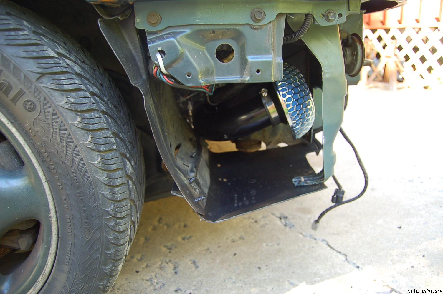

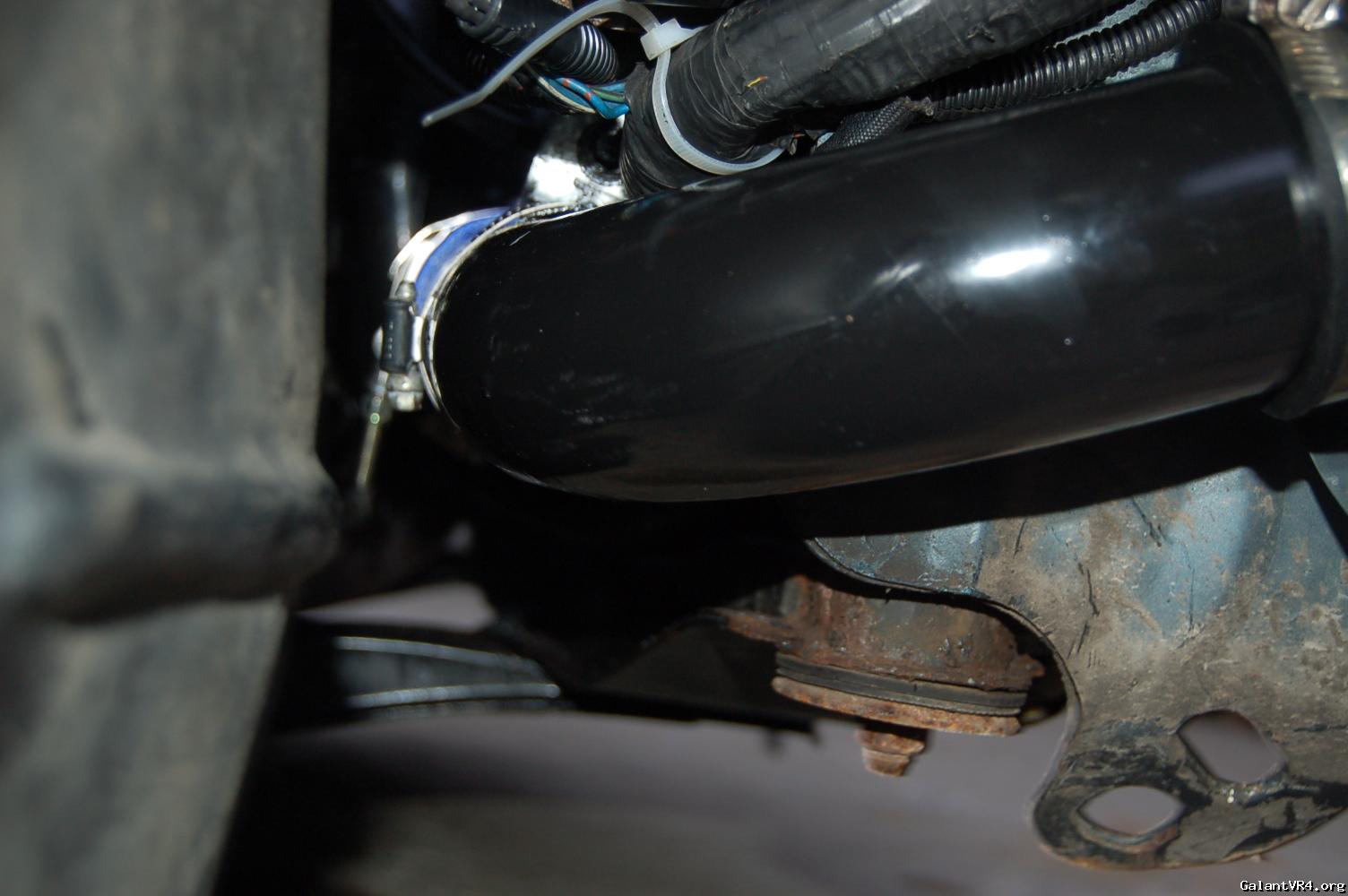

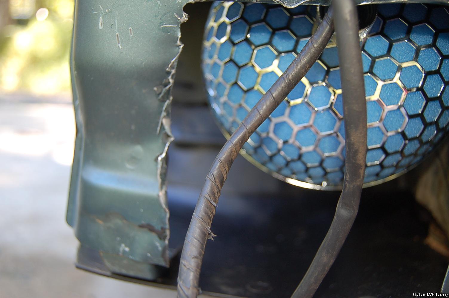

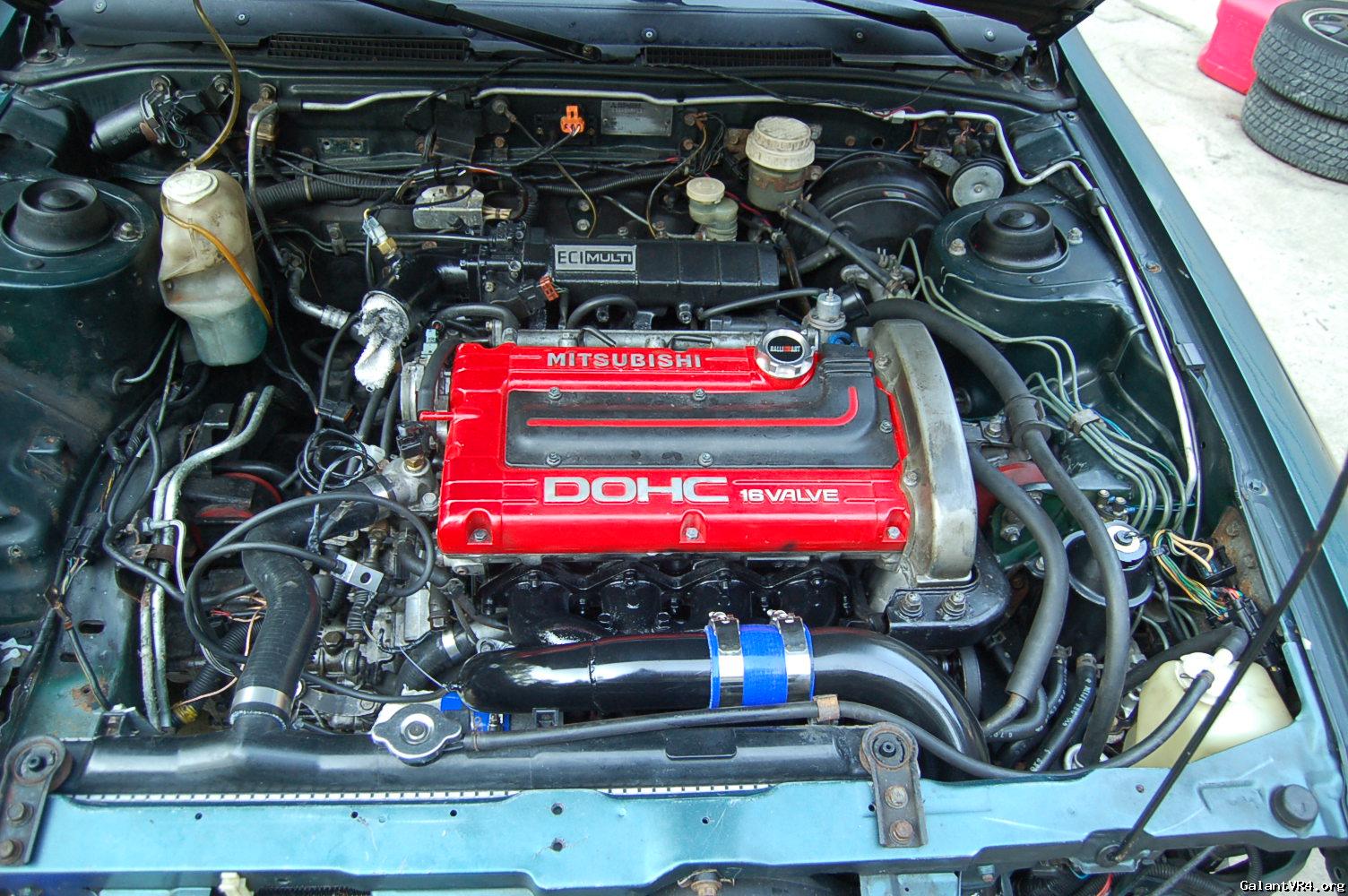

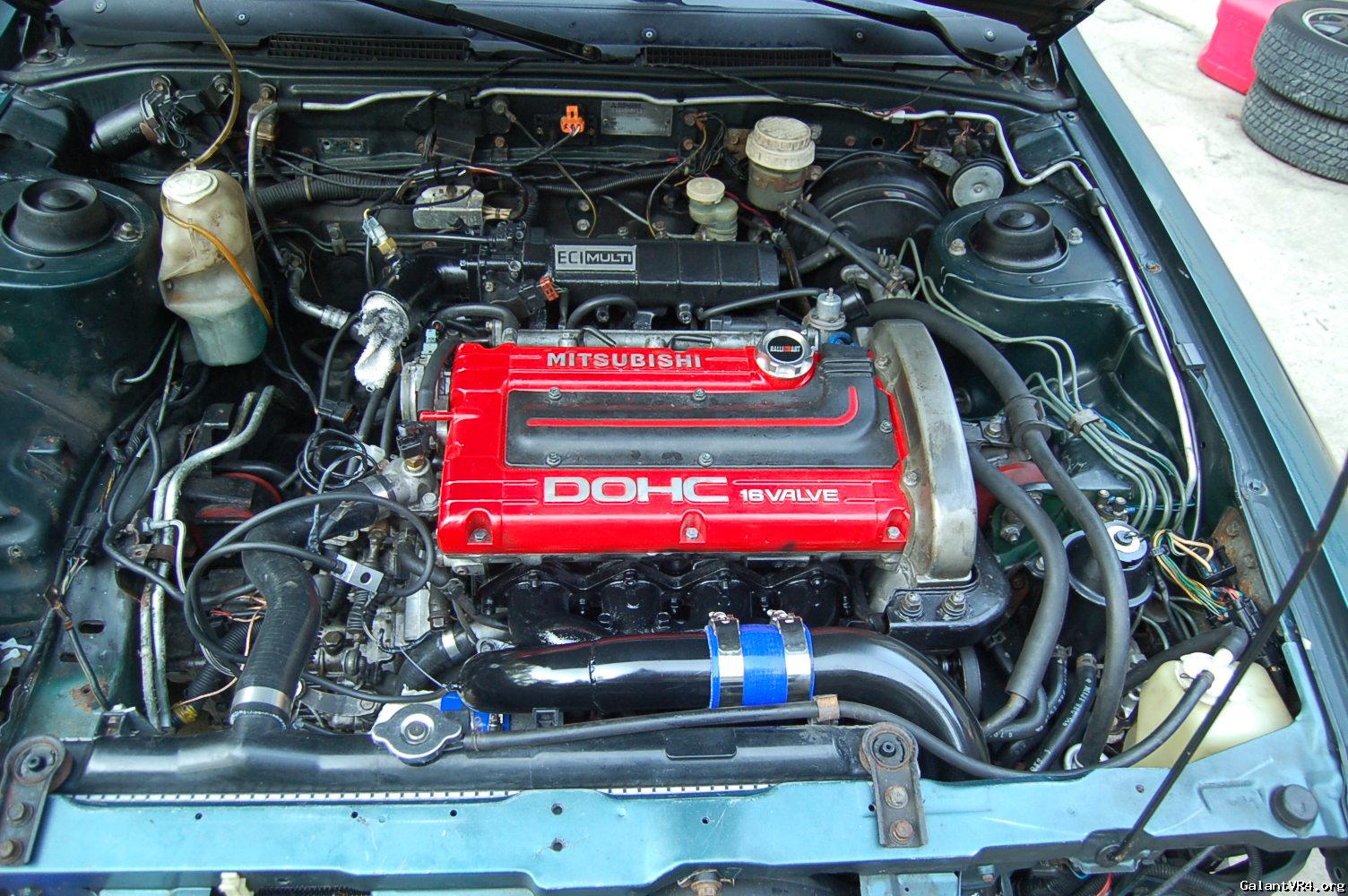

so im still waiting on a bunch of parts. i need the intake cone i ordered and the last 45 degree coupler that was shipped out to me wrong. here is how she looks now that i pulled all my intercooler piping and finished some of my under the hood stuff. almost done and very excited. i also did some what of a wire tuck and what i think is a pretty neat intake routing setup, the intake cone is going to sit in the last picture right where the side mount would be on a 1g. i need to take better pictures of that though.. hopefully this weekend after i get the parts and put it together. so i can take pictures of the finally finished and complete car.

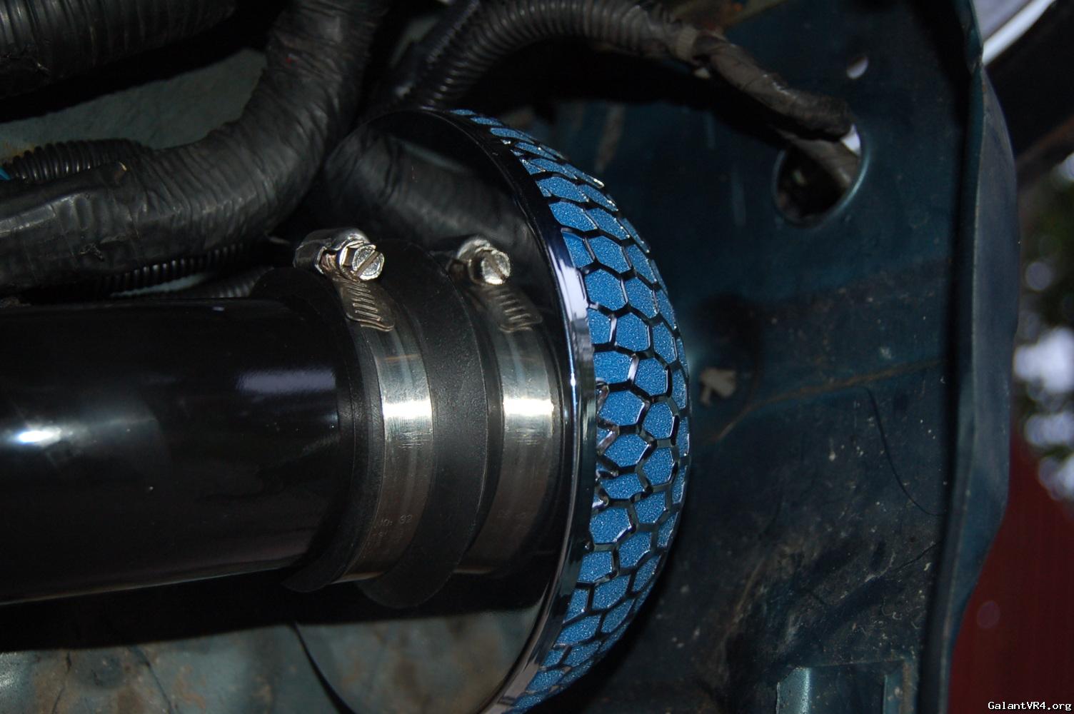

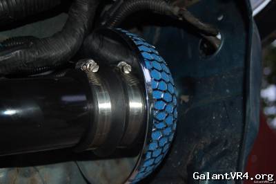

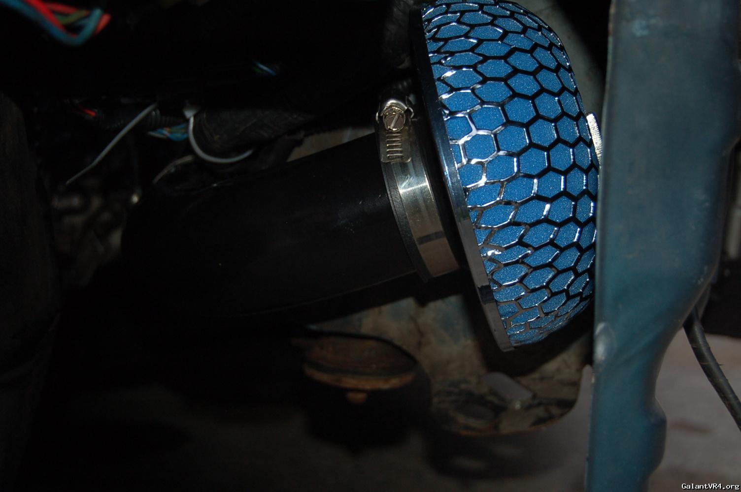

finished up the intake routing and installed the filter.
now im in the process of figuring out how to get air to flow in and out of there.
still waiting on the damn coupler.....

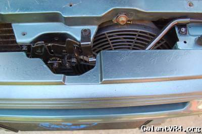

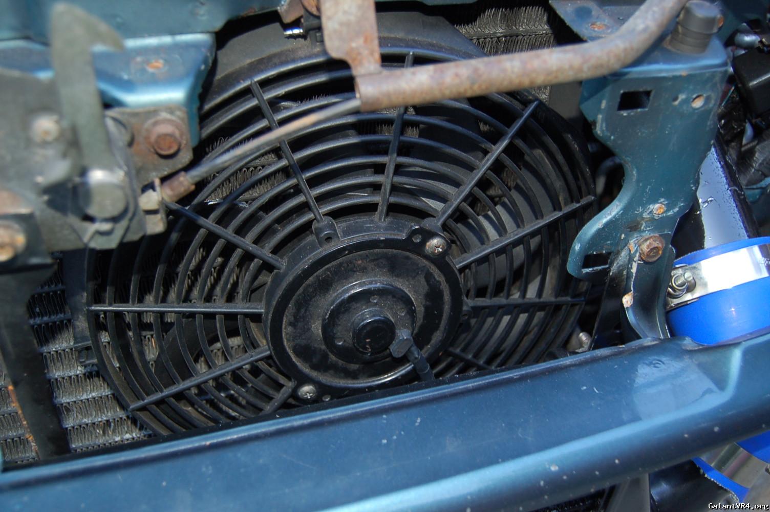

Progress is looking good. I love the way black intercooler piping looks, I always have. You can tell you take pride in your work.
If I could make one small suggestion, there are zip ties that are specifically made to mount slim line fans. They are cheap and would look much better than the bracket you have.
transparentdsm
Jul 27, 2011
3,690
Cherry Hill, NJ
the last time i used those fan zip ties it ripped the fins off my radiator, thats why i made these brackets. now that there mocked up im going to take them off and clean and paint them.

That's good to know I guess. I always use the zip ties for my fans, I would be pissed it is messed up my radiator. I've only ever slightly bent a few fins, but I will keep my eye on them.

DynastyLCD
May 12, 2006
761
Harwinton, CT

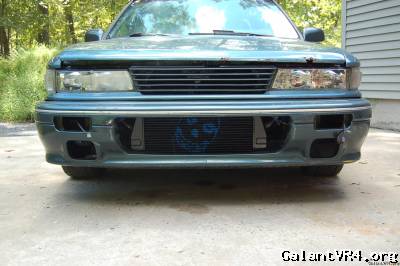

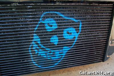

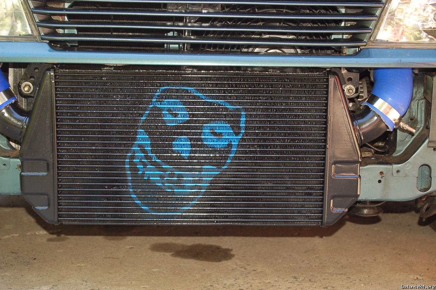

looks great, Shane! i like the black piping and intercooler!
normally i HATE when people write/paint on the FMIC.... but i love the Misfits logo on the black Evo FMIC! must be the punk-ass teenager in me /ubbthreads/images/graemlins/devil.gif

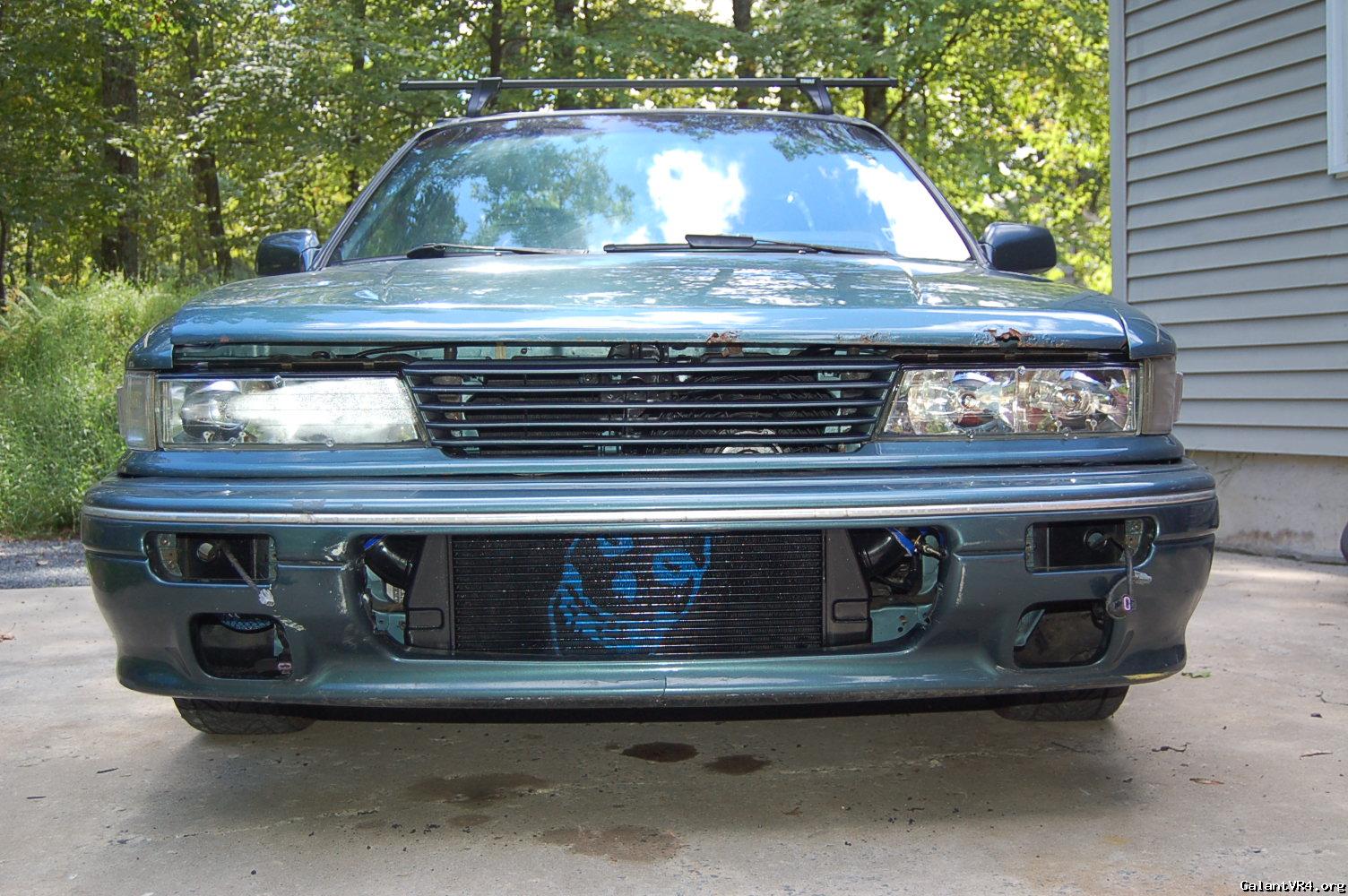

transparentdsm
Jul 27, 2011
3,690
Cherry Hill, NJ

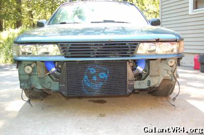

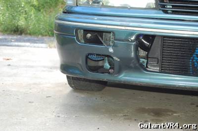

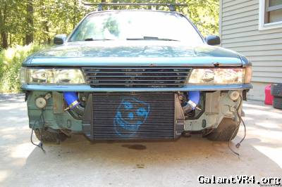

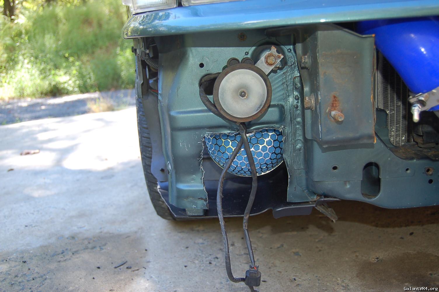

it was kid in me that made me do it, plus i thought it was gonna look awesome. now for the intake airflow solution. here it is along with the front bumper put back on. i think it looks pretty freaking good.
now i just need that coupler and i have to take out the pass headlight and redo that because after it rained the lens is fogged. you all can see it... grrr..
