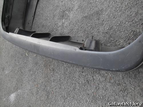

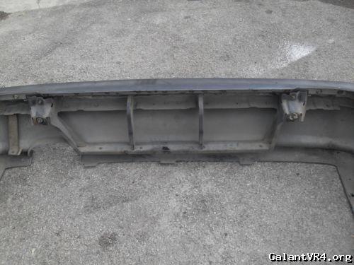

i used the JDM bumper support. it has 4 studs coming out of it. if you mock the bumper up to the car you can make 2 little marks in the rear of the body frame with the studs, take the bumper off, drill two holes to let the 12mm studs go through, put a washer and a nut on from the inside. full bumper support. maybe you used a different rear bumper support then me or maybe you didn't use one at all. i tried to do some searching to see how everyone else has done it, but i couldn't find anything, so i did my own thing.

yeah, the JDM bumper support/crash beam is crazy light and it makes for a really easy install on our cars.
here is a picture of the bumper and support from the inside. i mocked the upper studs on each side and bolted those to the body.

Looks like you got a rear bumper from a FWD Galant.
The jdm awd bumpers bolt up identically to way the stock usdm rear does. Good to see you made it work though.

well then that explains it. i just have a different bumper support or is the bumper different too? i don't know what the weight difference is, but the FWD bumper with support weighs like 15 pounds.

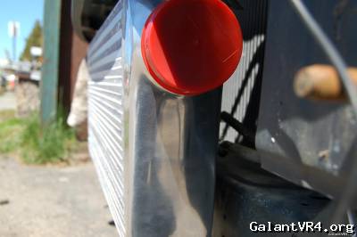

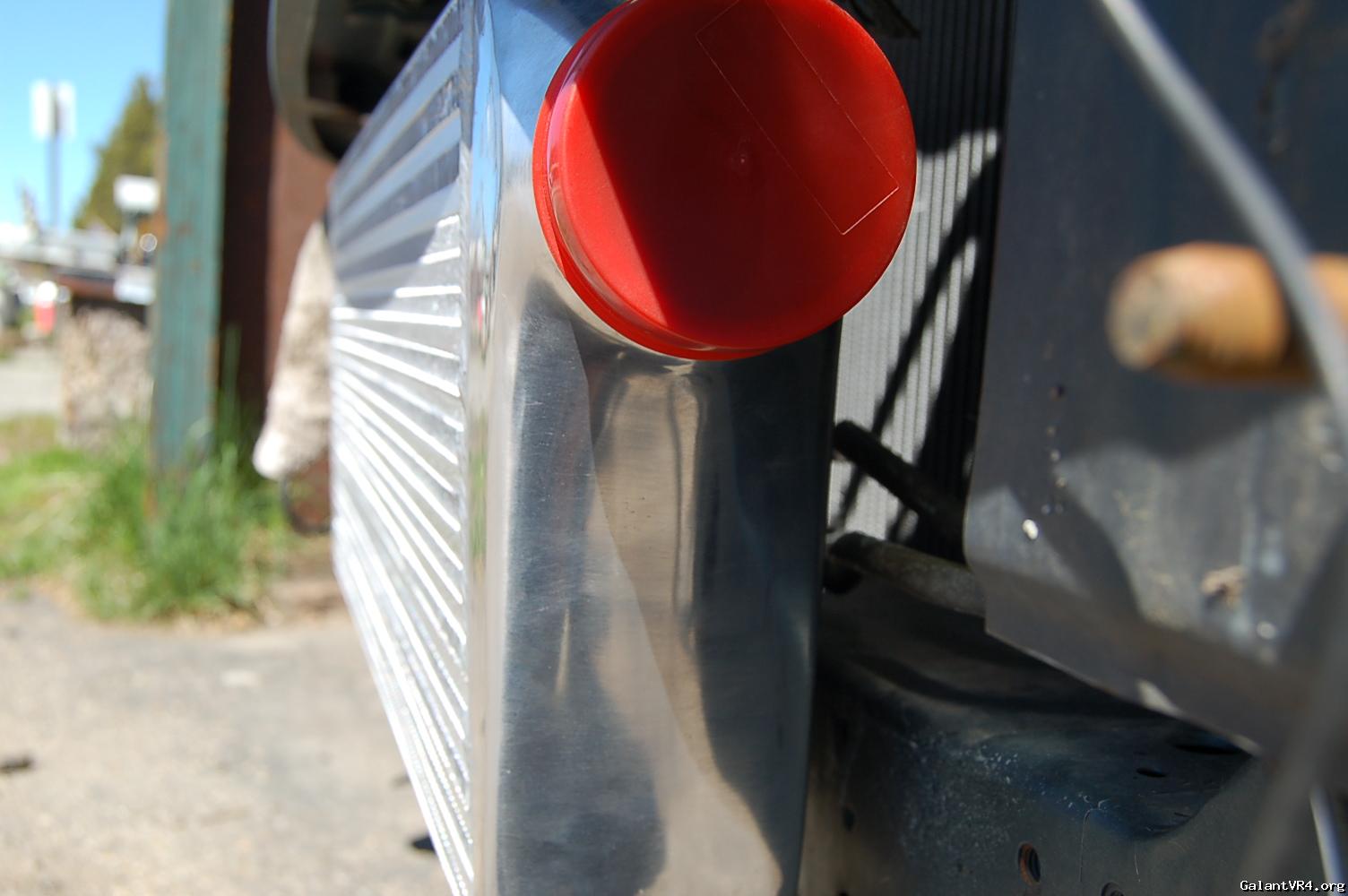

here is the core i bought click, i drive the car so much that i don't want to spend money on a nice core that is just going to get messed up.

That is nearly the same core I am probably going to get, just going to get one that is slightly narrower. If you check out my thread I got my intercooler kit installed, but it's way too big to really fit well.
I can't find it again, but there was a guy that tested high dollar name brand intercoolers against CX racing and ebay intercoolers. All of them were so similar and made negligible differences between them all that it really doesn't matter.

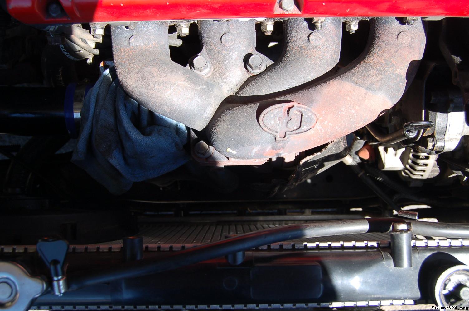

2. I'm curious to see what you do, I have a very similiar core and will probably copy what you end up doing. Stock rad, correct?

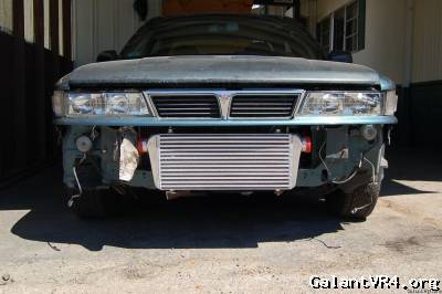

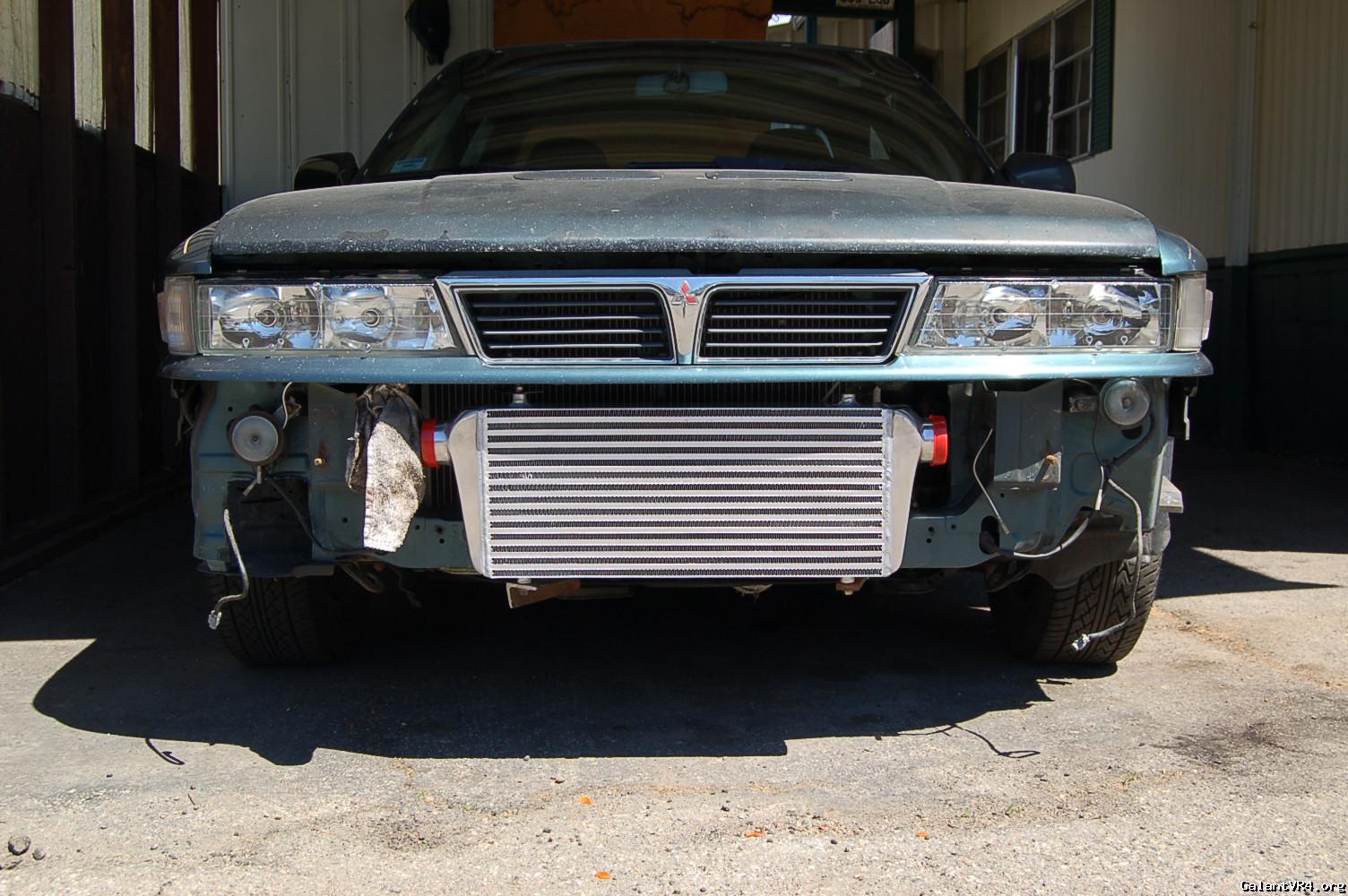

thanks Sal. yes its a stock rad and ill keep you posted on what i do for now i just removed the evo 8 core and turned the couplers so they would attach to this one, but i do not like it at all and want to put new piping in there.
Coyotes - it fits really really nice and the bumper doesn't get pushed down. i already fit the bumper back on, but for now its removed because i want to redo all my piping.
