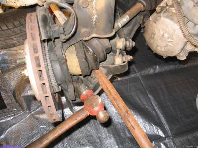

ill try this first as it will save me money. basically just stick something aboe the bolt the nut is threaded on and just undo the nut and it will push the ball joint down? sounds fairly easy...
GreenGSX
May 15, 2005
681
Rochester, New York
99% of the time the hammer works but like mentioned earlier you should have a floor jack pushing up on the bottom of the rotor. That way it pops out when its free and you don't spend 20 minutes beating the snot out of it. Just a FYI but be careful of the rotor. If you hit your fingers while gripping the hammer on the edge of the rotor you are going to be very, very sorry. Might want to take that off first.
For really stuck ones you gotta get meaner. Remove the axle nut then unbolt the strut from the spindle. Pop out the axle and move to the side. With the ball joint nut still on the ball joint but flush with the top of the threads use a air hammer and push the ball joint down and out. Leaving the nut on will protect the threads and keep the top from mushrooming. If you ever work on bigger GM stuff sometimes you'll run into ball joints that have a dimple built in for just this type of operation.
Heat and PB blaster won't hurt either. Good luck.
10,999
If the control arm is still attached to the subframe, the downward pressure as toybreaker shows is key. You need that to overcome the spring action of the front bushings, as they make the control arm want to come up naturally.
