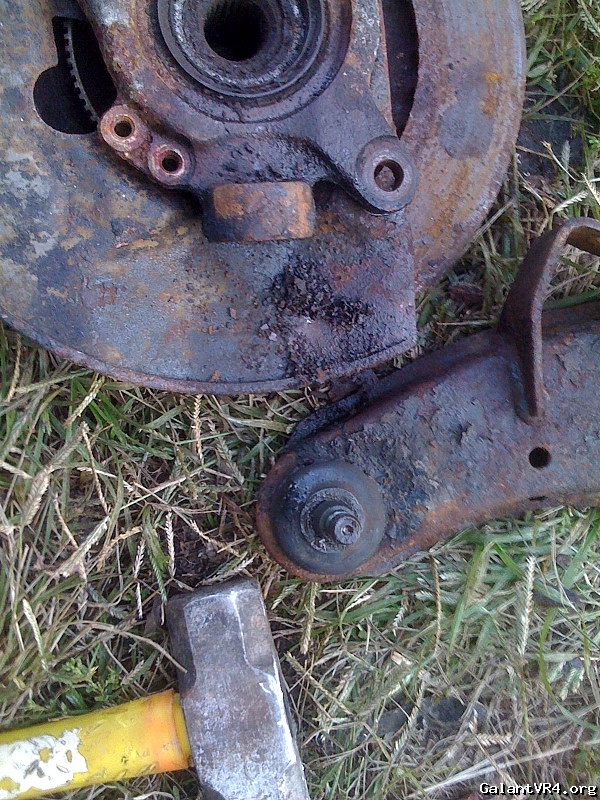

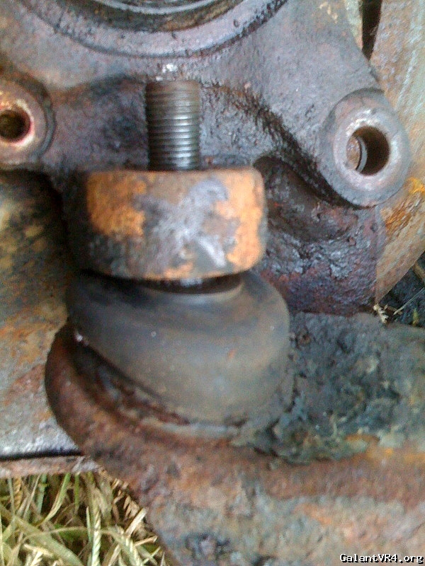

As for getting the joint loose, I can only speak for my self, but I undbolt the axle, the caliper, and the strut and then while holding (pulling up) on to the spindle at the strut mounting flange, I hit the base of the spindle where the joint goes through (i.e. the pic above) This will usually work in 1 or 2 hits at most. Could be worse for you, but hey its a learning experience.

I've been a tech in the field for years, BFH all it takes. loosen the ball joint nut, but only loosen it two to three turns so that you dont beat the threads by accident. then put a jack under the brake rotor and apply just a bit of pressure it doesn't need much. then use your BFH not a deadblow hammer, deadblow hammers don't have the weight needed, use a 20oz hammer. you want to hit the knuckle right where the ball joint stud goes through the knuckle. it may take around 5-10 good hits, but it will release. the shock will jar the metal enough to loosen any rust and "pop" the stud out. no damage done to anything, fully reusable. Not to mention it's a great way to let out some anger... /ubbthreads/images/graemlins/grin.gif

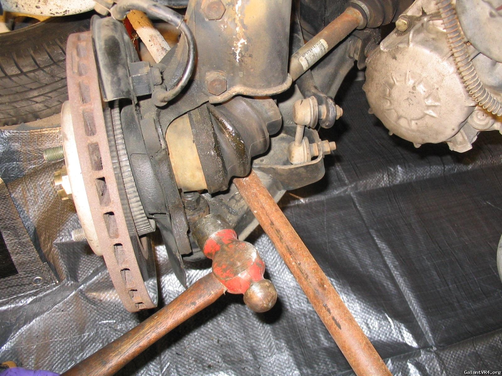

Long bar, pry down.
Hammer, hit knuckle.
This works best. Just smack it a few times where I have the X and it will pop off.
