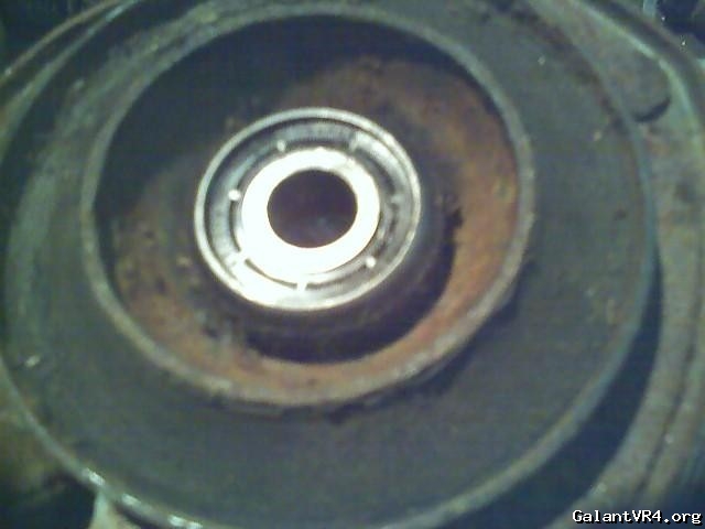

Quoting mountaineerjeff:
are you sure it doesnt have spherical bearings? they are a stock/oem piece.
my car was having the same problem, I replaced the upper strut mounts and the bump stops. unfortunately I did them both at the same time, so I dont know what fixed it, but I do know I havent had a problem since.
Stock strut tops are not a spherical bearing. Spherical bearings, otherwise known as pillow balls, are what you find in a camber plate type strut mount.

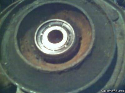

dumb, /ubbthreads/images/graemlins/banghead.gif a bit confused /ubbthreads/images/graemlins/confused.gif but now straightened up, lol. but there are bearings in the mounts, I just evidently dont know what they are called, lol. the ones in my car were worn and had fallen apart.
thanks for helping straighten it out. sorry for confusion. /ubbthreads/images/graemlins/banghead.gif /ubbthreads/images/graemlins/banghead.gif

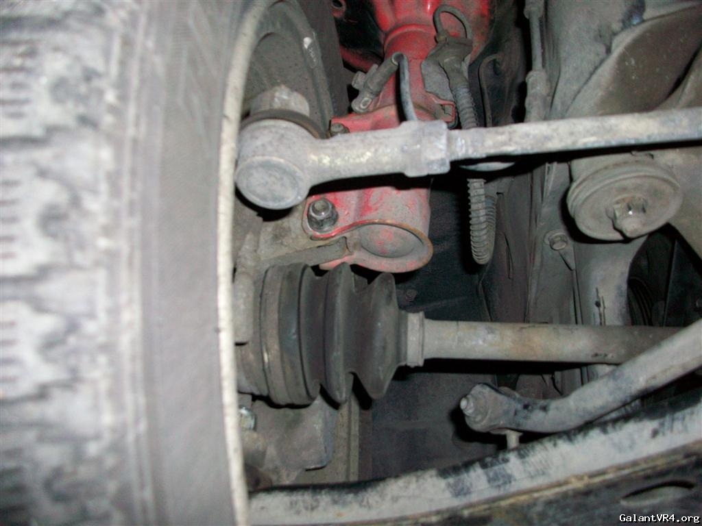

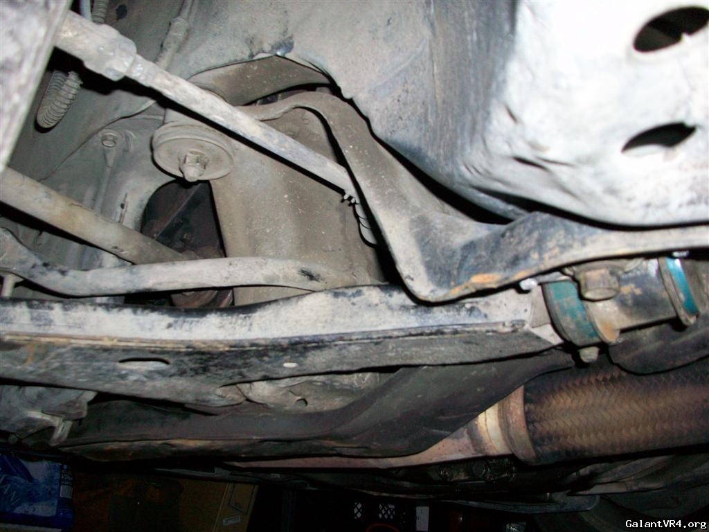

Here are some pics from underneath, not that I think it'll help much.
Jeff,
Dont be so hard on your self!!! /ubbthreads/images/graemlins/wink.gif
They do have a bearing, its just not a "spherical" It is a ball bearing. And yes they can make alot of noise when they are bad.
