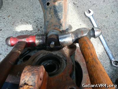

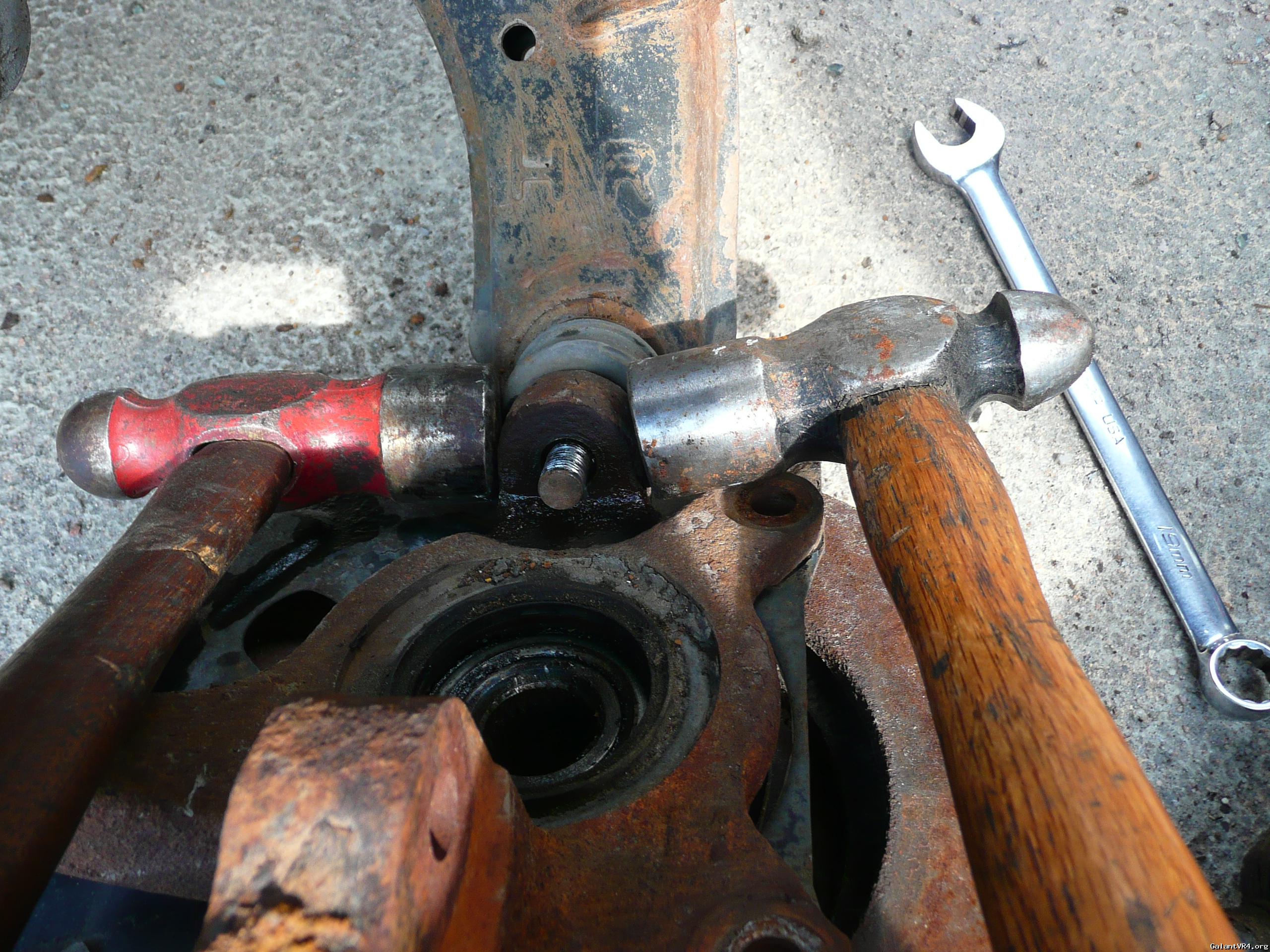

Using two good hammers, smack the knuckle smartly
If you're good you can swing both hammers and hit the knuckle at the same time.
I'm not that good /ubbthreads/images/graemlins/crazy.gif
It works just as well to hold one against the knuckle and swing the other one, aiming for a spot opposite the held hammer for maximum effect.
When the swung hammer hits the knuckle, the impact will knock the held hammer away from the knuckle. (the held hammer "acts" like a dolly, and will increase the force the taper in the knuckle will "see".)
Having them opposite each other means when the impact occurs, it'll shock the taper somewhat symettrically.
The balljoint will usually free up in two or three whacks.

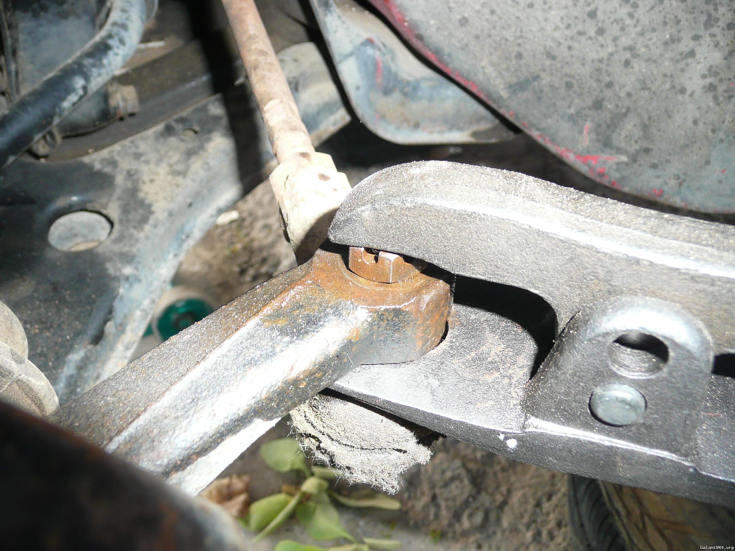

One thing about the popper:
I recommend using a nut on the end of the ball joint to protect the threads. If you do use one, you can mushroom the threads out from the popper.

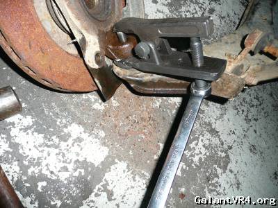

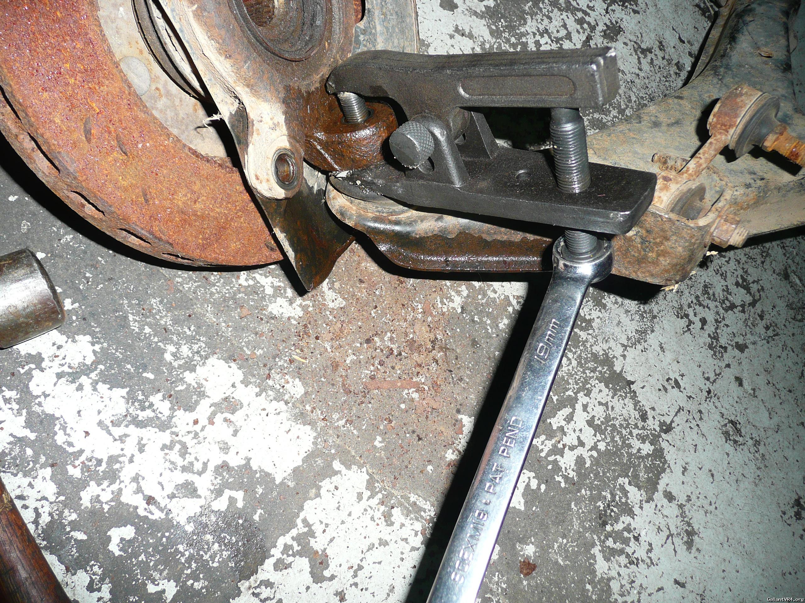

toybreaker what brand is your threaded popper? Is it a ebay $30 or the OTC expensive one that I cannot locate? Do you have any thoughts on quality of inexpensive ones?
G
Feb 24, 2004
8,896
zompton
Not sure if this works on mitsus but I tried it last weekend on my crv and it worked perfectly. /ubbthreads/images/graemlins/worthy.gif click
