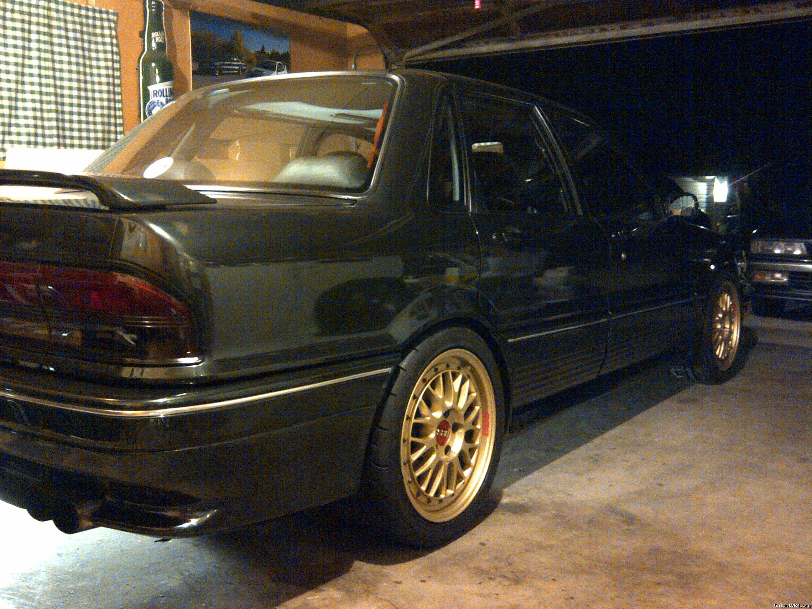

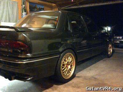

I took the weekend to do a 5-lug swap. I used FWD knuckes to lessen bump steer since my car is lowered and I retained ABS, but I haven't installed the new ABS computer yet. I just wanted to get the wheels on and the car back on the ground for now. Tires are Dunlop Direzza Z1 star specs.

Wheel specs are: 17x8 +40
I tried to find +35's but since most of these sell in staggered sets, I had to settle for these. I picked them up from a Yahoo Japan auction through the help of my little sis who's over there teaching English. Bonus points for them being the all gold limited edition F1 series LM's. They're in decent shape with a few nicks here and there, and they cleaned up really well. I may get them refinished later on down the road.
I am using 5mm H&R spacers to bring them out to the same stance as the old wheels, although they clear the brakes just fine without them. I think an ultimate set would be +45 and reverse mounted faces on the backside of the barrel flange. That would make for a lot of lip and still clear the front calipers while bringing the wheel out enough to fill the wheel arch since reverse mounting subtracts like 12mm from the positive offset.

Looks too busy for my taste. I've seen many BBS LM up close and on a German car it looks right, on the GVR4 it just looks too busy. I wonder if they wouldn't look better with the AMG smooth lower door trim panel. The way it is now looks ALMOST as if you mounted a set of the laser mesh wheels. /ubbthreads/images/graemlins/dunno.gif
Take a good side picture of the car Mark and have someone photoshop a set of smooth door trim panel. I bet it looks 10000% better.
11,971
Why you gotta rain on my parade, Andre? /ubbthreads/images/graemlins/rofl.gif
I actually agree a tiny bit, so some changes to the car may be in order. I think I'm gonna go with black trim in the side/bumper moldings instead of chrome, and I'm thinking about sourcing a new JDM front bumper and keeping the slats intact. I might also lose the lip on the front as I'm not sure I like the look of it with the new wheels. As always, it's a work in progress. I just wanted a change. Too many other GVR4's rolling around on 5zigens, yanno?
