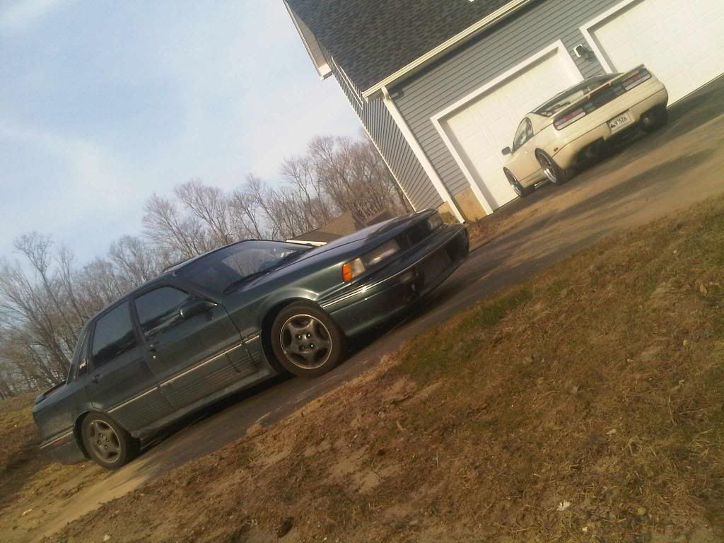

i put the 2g strut tops in, and it did level it out quite a bit. the front is still slightly higher but it's better than it was before. i've got a couple hundred miles on the built motor setup now, still on a stock exhaust though /ubbthreads/images/graemlins/frown.gif sunday can't come soon enough that's for sure... here's a shot from work the other day:

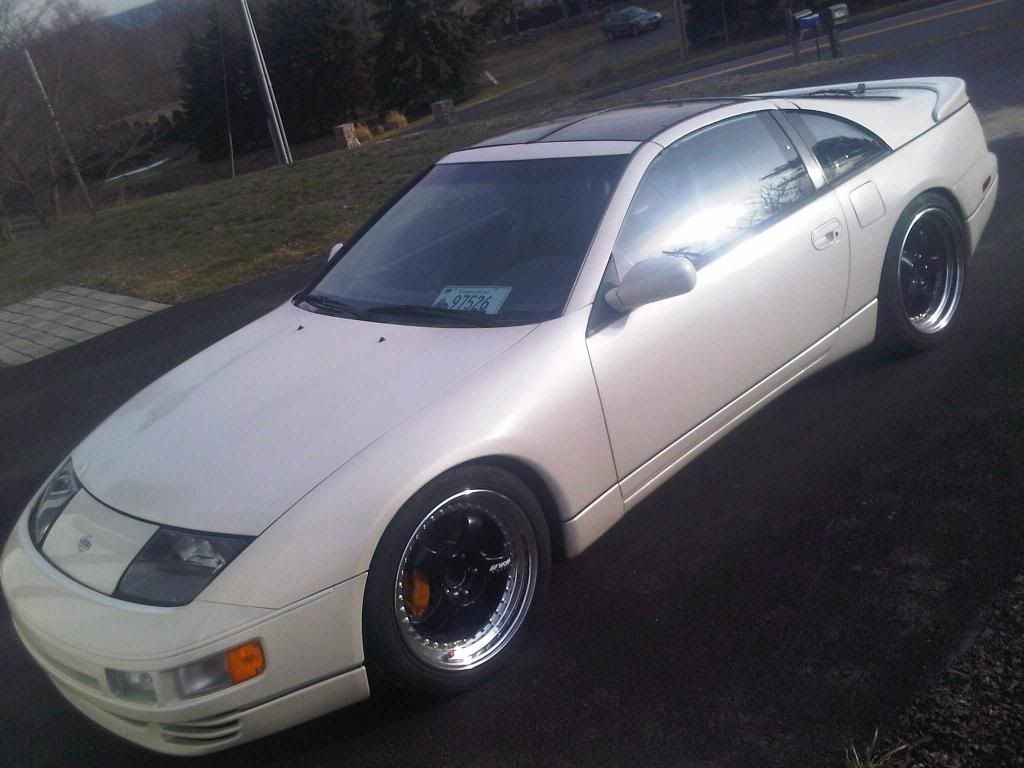

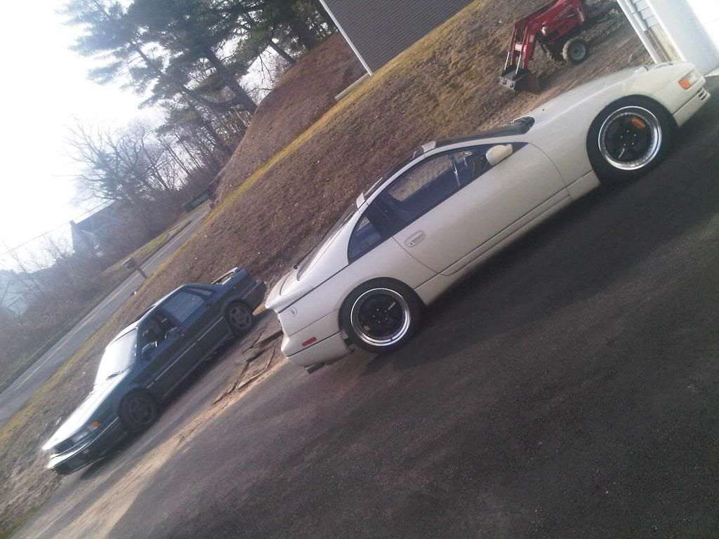

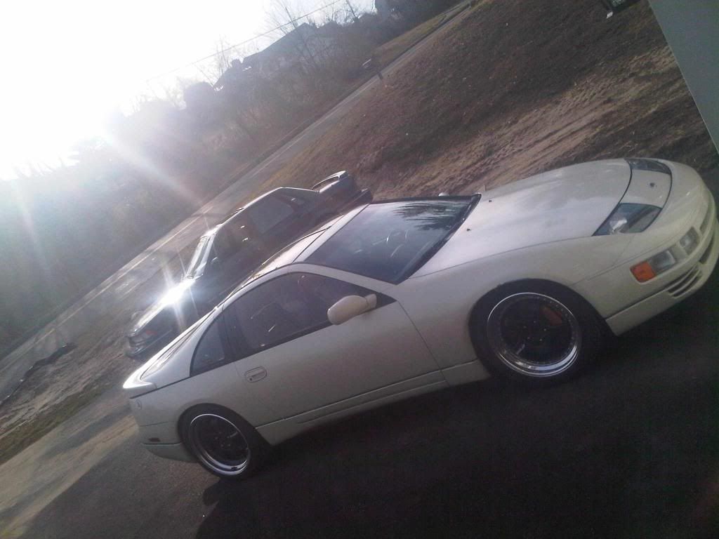

on my way home from work, i saw my friend had his nasty 300ZX parked outside. we worked together at a Nissan dealership, i had helped him put the car together. makes over 500 on pump 93 on a rich tune and 1 bar wastegate pressure... stage 3 Z1 longblock and 2860r's which spool like nothing. just an all-around very nice car. it was a gorgeous day out here in CT, perfect day to take a few pictures (and a Z beatin' run /ubbthreads/images/graemlins/devil.gif ) these are all from my phone so please don't nitpick the quality.

That is a beautiful Z. Hey what suspension are you running? I'm keeping the stock wheels forever and would like the car to sit like that, kinda...

the Z is truly gorgeous! spins 275 sized KDW's through 3rd too /ubbthreads/images/graemlins/grin.gif
Matt, i'm running Megan springs for a 1g, they are a 2" front and 1.9" rear drop, so basically 2" all around. i'm using parts store front struts, rear AGX's on 6, 2g rear strut tops. it's stupid low on the stock wheels. i can't wait to 5-lug it just to put 16's from a DSM on it and raise it slightly lol. i haven't experienced any real issues with clearance or bottoming out everywhere, but it's just a tiny bit too low for what i'd really like. i know going to 16's, or later to Evo 8 wheels like i really would like to, it will raise it up just enough to give me good ground clearance, while still having very nice fitment.

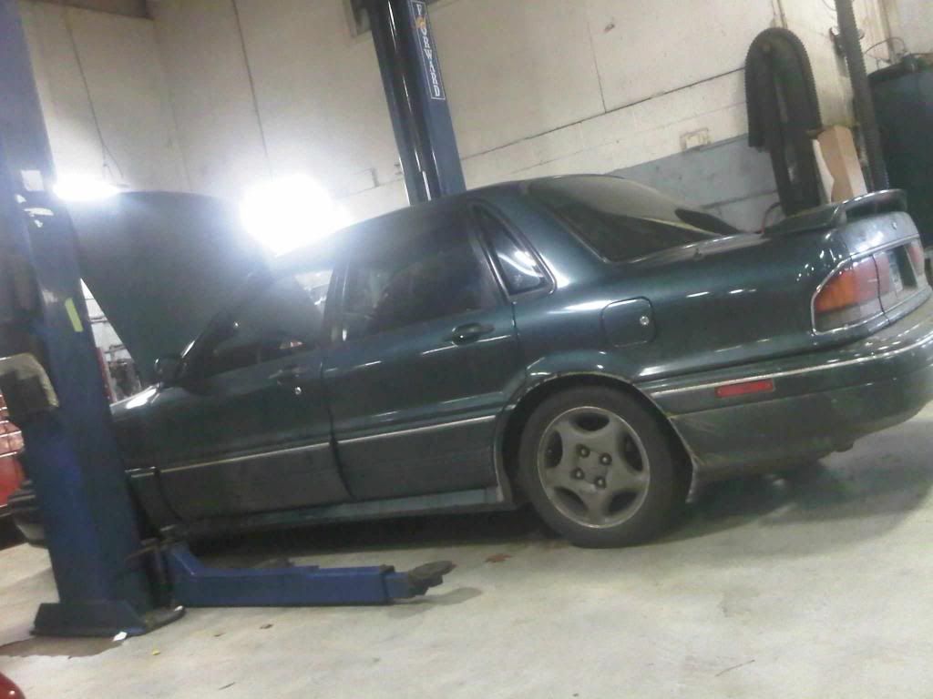

tonight i couldn't get much work done, but i managed to get the engine and trans about ready to come out, got all the ABS crap out of my car (thank god!) and installed the 3g brake master cylinder. it cleaned it up so much! i installed the non-ABS prop valve, and now i just need to finish installing the front hard lines to the rubber flex hoses. while the engine is out, i'm going to tackle this hacked wiring mess. i've got sh*t going everywhere under my hood from the PO, and i did the wrong thing by just leaving it. so it's all going to get fixed temporarily until i can get to Sal's parts car and rob his dash and underhood harnesses /ubbthreads/images/graemlins/rofl.gif
im up in the air about the meth setup that came with the car. i either plan on drilling/tapping the intake manifold for the 3.5 bar AEM MAP sensor that the meth injection system uses, and re-wiring everything clean, or just taking it all out and selling it. i've made all my power on pump 93 all these years without any help besides boost. maybe now is the time to change that? i don't know still.
