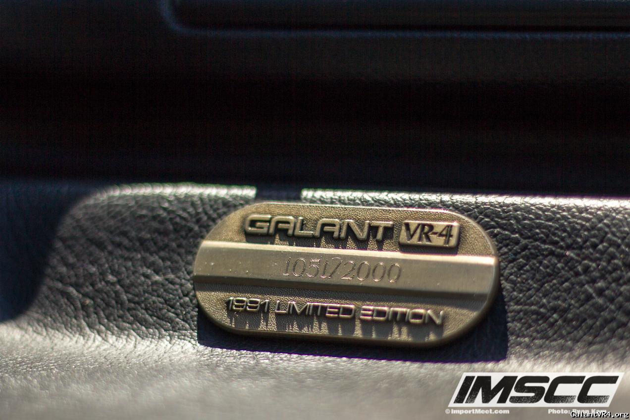

Owner: Mark Pontarolo
Message Board Name: turbowop
Year: 1991
Number: 1051/2000

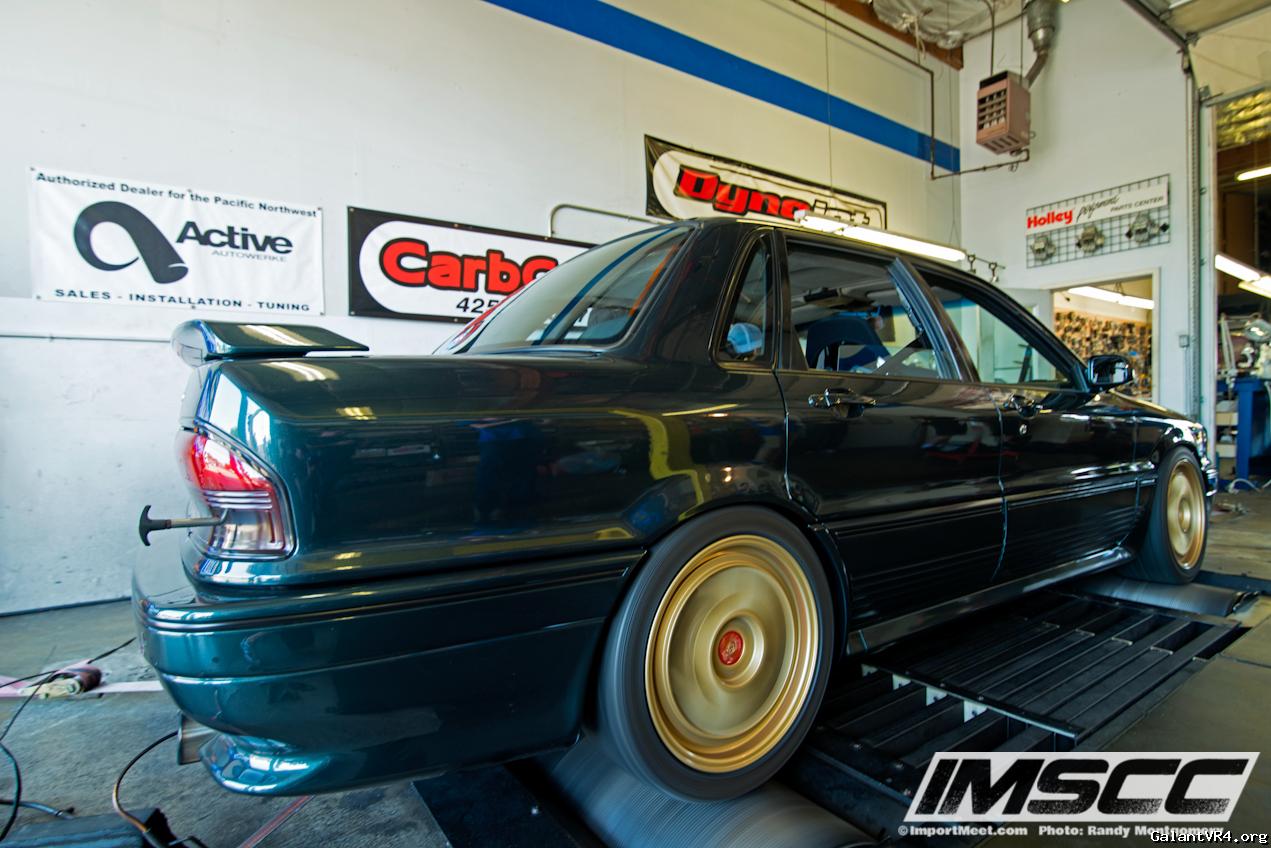

Best 1/4 mile E.T.: 11.96 (8/5/05) Best 1/4 mile trap: 121.22mph (8/9/13)
Dyno: 424whp/383ft-lbs pump/meth (8/10/13)

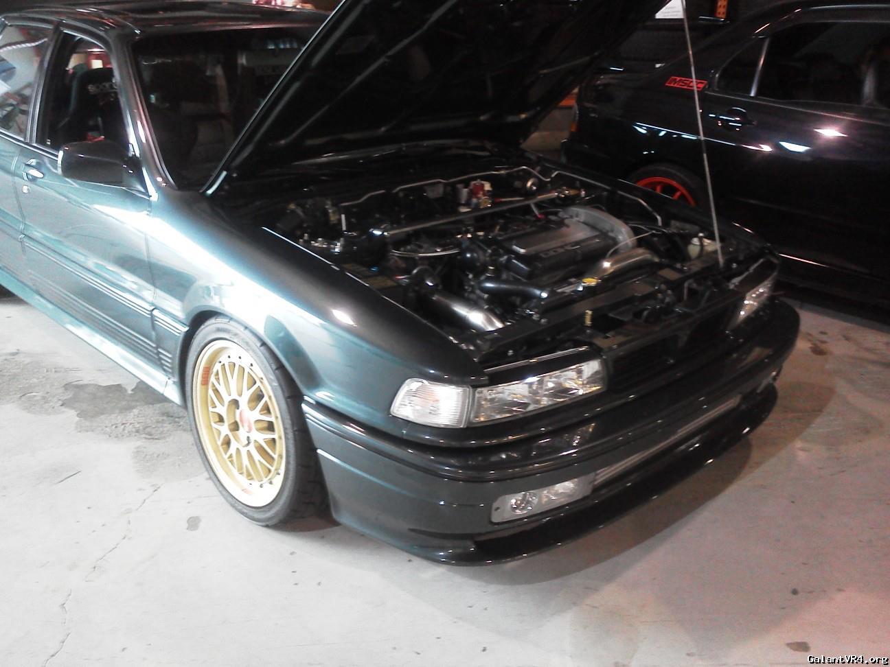

Engine:
-stock block, bottom end, and head
-balance shafts removed
-ARP headstuds
-Mitsu MLS headgasket
-Prothane motor mounts
-NGK spark plugs
-MSD spark plug wires
-HKS 272 camshafts
