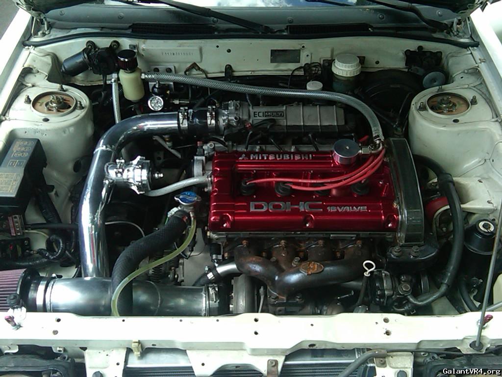

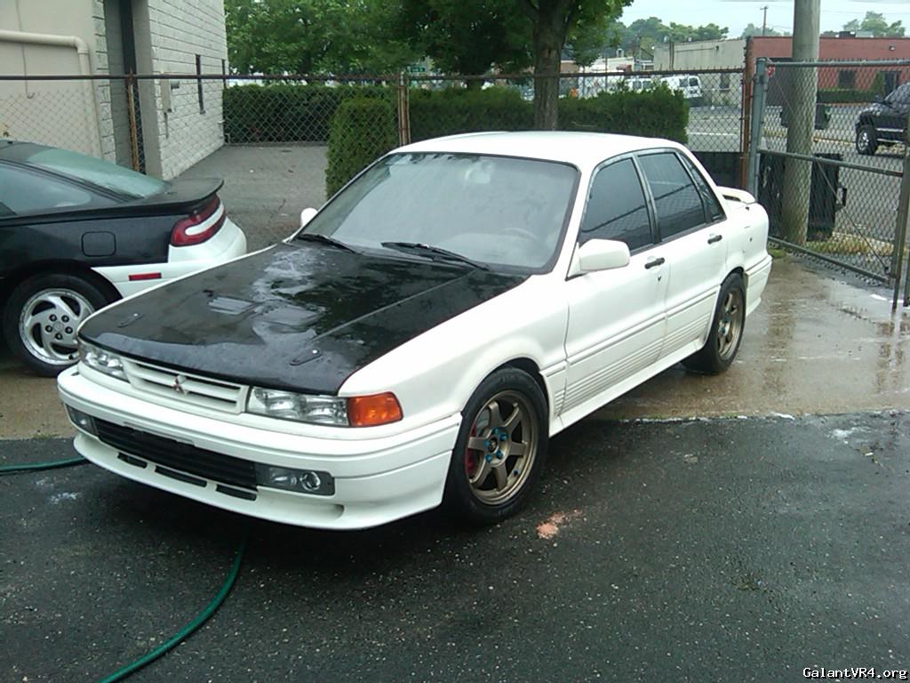

Well here it is. After many years and a verrryyy slow build process, it's up to satisfactory level for myself. I have a bunch of work (mod list to come later) done to her.
Exterior stuff:
JDM RS Front Bumper
JDM Amber Corners
JDM Eterna Grille
Fiberglass JDM hood with Aerocatch hood pins
JDM Rear Bumper
Volk TE37 16x8 +35 wrapped in Dunlop Z1 Star Specs
Engine:
JE 9.0:1 Pistons
Eagle Rods
ARP Studs, MLS Headgasket
ARP Main studs, rod bolts
Factory crank, polished
HKS 264's, BC Springs/retainers
Kiggly HLA regulator
SS 1mm oversized valves
3G Lifters
JAZ Catch can recirculated to oil pan, "Hal" custom vented oil cap
New oil pan
Trans:
TRE Stage 3 2G AWD DSM trans
Comp Clutch 1620 (6 puck sprung disc and 2700Lb pressure plate IIRC)
new clutch master cylinder
Intake:
OEM intake manifold, Magnus spacer
throttlebodys.com rebuilt N/T throttle body
2.5" aluminum IC piping
4" aluminum intake pipe, K&N Filter
Custom made ETS Intercooler (based off 1G race intercooler, just 3")
Tial BOV (latest model)
Exhaust/turbo:
BR20G
FP Race manifold JNZ finishing ceramic coating
SBR o2 housing open dump
Tial 38mm wastegate
Custom 3" turboback exhaust with Borla resonator and Apexi N1 muffler
Suspension:
Tein HA coilovers
W/L Swaybars (22mm F, 26mm R), whiteline spherical endlinks
Whiteline caster adjustable front bushing
Energy suspension front subframe bushings
boostx rear subframe and mustache brace bushings
maximal performance adjustable rear control arms
Jay Racing active toe elimination kit
New ball joints everywhere, tie rod ends (inner and outer)
DSM 5 lug setup (fronts are FWD)
Cusco front and rear strut bars (front needs to be put on)
Fuel:
Denso 720cc
Denso Supra TT fuel pump
Fuelab Fuel Pressure Regulator setup
Misc:
DSG Shift knob
Optima battery relocated to trunk
GReddy gauges (boost, Oil pressure, oil temp, water temp)
AEM Wideband gauge
1G leather shift boot
89 glove box and underdash

Ceramic coating sucks...period. Next time I am getting Swaintech coating.
There are still quite of few things to still go into the car and be done (like painting the window trim). It is on ECMLink v3 Lite and is running speed density.
BTW - car will get paint next year...hood will be white!

Well here is the mod list I was keeping track of at work...
1991 Summit White A88 - CD, No Sunroof 1157/2000
Engine: $2,300
2.0 N/T Block
OEM Polished Crank
King Bearings
ARP Main Studs
Eagle Rods w/ARP Bolts
JE 9.0:1 pistons
OEM Timing Components
Topline front case
OEM straight cut oil pump drive, driven gears
OEM BS elimination kit
Bosch Water pump
ATI Race Damper
HKS 264 Camshafts
Kiggly HLA Regulator
BC Springs and Retainers
Fidanza Cam Gears
SI 1mm Over SS Valves
Topline 3rd Gen Lifters
New Valve Guides
New Valve Seals and Locks
Multi-angle Valve Job
Blacktop CAS
Zaklee Cam Gear Cover
ARP Headstuds
Mitsu MLS Headgasket
Prothane Motor Mounts
4-ply Ex Manifold Gasket
Magnus Intake Mani Gasket
Jay Racing Alternator Relocation Kit
Bosch 90A Alternator
NGK BPR7ES Plugs
Magnecor 8.5mm Wires
Transmission: $1,500
TRE Stage 3 2nd Gen Trans
NEW 2G Starter Shield
NEW OEM Clutch Fork, Boot, Fulcrum Ball, TOB
New Clutch Master Cylinder
Competition Clutch Stage 4
Comp Clutch Flywheel
SS clutch line
2G 3Speed Scatter Shield
Symborski shifter kit
ExPSI Shifter Bearings*
JNZ Tuning Short Shifter*
Suspension & Drivetrain: $2,000
Tein HA Coilovers
4 Bolt LSD Rear End
Whiteline 22mm Front Swaybar & Bushings
Whiteline 26mm Rear adj. Swaybar & Bushings
Whiteline Spherical Endlinks
Cusco strut bars
Energy Suspension Front Subframe Bushings
Whiteline W0623 & KCA321 Bushings
Boostx Subframe bushings & Mustache bushings
Maximal Performance Rear Upper Control Arms
New OEM Wheel Bearings
Alum Driveshaft Bushings
Moog Tie Rod End Boots
OEM Tie rod ends (inner/outer)
Catch Can:
JAZ mini Catch Can
Vented Oil Cap
Routed back to Oil Pan
Cooling: $450
AFCO Aluminum Radiator Custom Aluminum Shroud
Power Enterprise Rad Cap
Perma-Cool fan
DSM Radiator Hoses
‘90 N/T Waterpipe
‘90 N/T T-stat Housing
‘90 Oil Filter Housing
B&M Oil Cooler Setup
Denso Oil Filter
Electronics/Tuning: $1,500
Greddy Boost, Oil Pressure, Oil & Water Temp Gauges
AEM Wideband Gauge
Hallman PRO MBC
ECMLink V3 Lite
GM MAP & IAT Sensors
Full Throttle SD Harness
Apline CDA-9835 Deck
JL Audio Amps
MB Quart Rear Speakers
Intake: $800
OEM Intake Manifold
Rebuilt N/T Throttle Body
2.5” Aluminum pipes
Tial Q BOV
Extreme PSI Couplers
New T-Bolt Clamps
K&N 4” Intake Filter
Custom Alum 4” intake Pipe
ETS Custom FMIC (28x10.5x3)
Exhaust: $1,700
BR 20G Turbocharger
FP Manifold Ceramic Coated
SBR o2 Housing Jet-Hot Tial 38mm Wastegate
3” Custom Exhaust
Apexi N1 Muffler
Borla Resonator
Poly Exhaust Hangers
Fuel: $500
Denso TT Supra Fuel Pump
Fuel Lab FPR Kit
Denso 720cc Injectors
Liquid Fuel Pressure Gauge
FP Rewire
New Injector Clips*
Battery Relocation: $300
Optima RedTop Battery
Summit Racing Box
1 Gauge P/N Cables
4 Gauge Alternator Cables
Longacre cut off switch
Street Wires Dist. Block & P/N Battery Terminals
Interior: $200
1G DSM Shifter Boot
DSG White Shift Knob
Spo/No switch
Eco/Pwr switch
89 Underdash & Glove Box
Custom Floormats
Aeroworks A-pillar Holder
Exterior: $1,900
JDM RS front bumper
JDM Projector fogs with yellow inserts*
JDM RS Rear Bumper
JDM RS hood (Fbrglass)
Aerocatch Hood Pins
JDM Gas Door*
1993 headlights
JDM Amber Corners
JDM Eterna Grille
Wheels & Brakes: $1,500
DSM 5 Lug Setup
16x8 Volk TE37
Ray’s Blue Lug Nuts and Valve Stems
225/50 Dunlop Direzza Z1 Sport Star Spec Tires
DBA 4000 Slotted Rotors*
Powerslot Rear Rotors
Porterfield R4-S Pads*
Liquids:
Oil:
Brad Penn 10W-30 (W)
Brad Penn 20W-50 (S)
Brakes: ATE Super Blue
Clutch: ATE Super Blue
Radiator:
Redline Water Wetter and H2O
Trans: Redline MT-90
T-case: Redline Heavy Shockproof
Rear Diff: Redline Heavy Shockproof
Power Steering: Redline
Fuel: BP or Shell 93 Octane
Deleted:
ABS using Galant GS-X Components & SS Brake Lines
Cruise Control using regular throttle cable
AWS delete using DSM rear subframe
Total Street Value - $14,650
