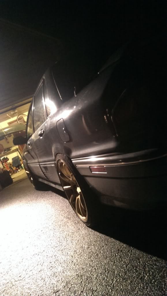

It's been awhile since I updated. Things have been going alright. Been DDing the car since I put it all together, finally got a grille for it and she got new wheels. 18x9" Rotas.... Got them for a steal. I stuck em on last night. The suspension is rear AGX's, front GR-2's, 2g rear strut tops, and 1g AWD Megan springs. Lemme know what you guys think!

Looks good Phil, glad to see shes still kicking it strong. i love the rims on there and think it looks awesome, but how bad are you rubbing? the rears look like they will slam around a bit. and do the front rub when you turn?? it looks like so much rim tucked under there.. are you going to fender flare it?? thats what i was thinking of doing to get bigger rims on my car next summer. once i get my suspension figured out 100%

Shane - thanks man! The rears rub over bumps but only if I hit them fast. Fronts can't go lock to lock on the rack. I was considering rolling the fenders and calling it a day. Evo 8 wheels will probably go back on, and these will most likely be sold. If I had all the suspension work done thats in my 1g, I'd probably keep them.
Brett - I honestly don't know. There's decent gap in between the tire and the pinch weld on the rear subframe. I was prepared to grind them down, but never had to.

The car definitely has a tough looking stance. It sucks you only have springs right now. With set of coilovers you could bring the car up a little, and I think the wheels would fit better. Either way though, I think you would end up having to do a roll in the rear at least. The pics show that damn VR4 stagger, where the rears are tucked slightly more than the fronts. I hate how the VR4 does that. With a 5mm spacer in the rear to bring all 4 corners flush, there's no way the rear wheels would clear at your current ride height.
Definitely a great look though, Phil. I love the Evo 8 wheels on the car, but the Rotas look great as well. I'm glad I'm not you, because I'd have to keep both sets!
