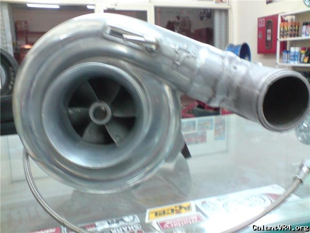

Hello'
I have seen 3 turbo at my friend shop. Any one of these is worth to buy..They are $230 each. (Note: I am not expert with turbo's)
here are the photo.

Well we are going to need more infomaition. What shape is your motor in and what maifold are you running and are you willing to buy another manifold for a turbo upgrade. Do you want top end power or bottom end what compression are you running. First figure out what you would power band you want.

OK' My car has JDM Cyclone stock engine. Fic 650 injectors. SAFC neo. I may upgrade the cams to 264/272. & 3 inch exhaust from down pipe to end. End power is not may goal as I am looking for nice acceleration from zero..

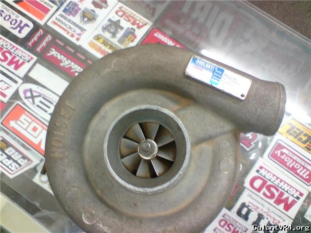

What does the tag on that holset say? Hx40 would be a sweet turbo for 450+ hp /ubbthreads/images/graemlins/smile.gif.

Quoting Jesse_W:
Which one you mean?

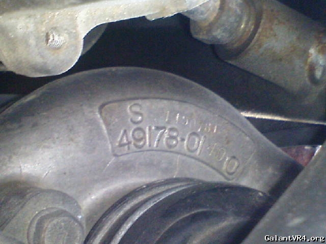

This is mine...I think its 49178-01 40 0 I am not sure if it is 16g or 14b.
I'm pretty sure that's a 14b. Here's some info I found on Tuners:
14B
49178-01010
49178-01030
49178-01400
49178-01410
Small 16G
49178-01520
49178-05200
Big 16G
49178-01420
Evo I Big 16G
49178-01450
Evo II Big 16G
49178-01460
Evo III Big 16G
49178-01470

The photo you posted above contains all the info you need to determine which turbo you have mate.
The turbos with the large square section cast into them are the cheap Ebay knock-offs which I would steer well clear of. Especially if that plate says something along the lines of "DSM -EvoIII" on it!
No, as Olson and I stated, the 49178-01410 is a TD05H-14b. You have a 14b.
