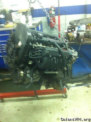

I have had the engine out of the car now for a couple months. had a few finacial speed bumps but are not back on track.
I had planned on sending the engine to a machine shop that we use at my job.
web page
my plans are simple. Have the engine disassembled, cleaned, checked, and what ever need's replaced would be replaced.
I am looking at a budget of about $2000.00 a little bit more if really needed. My main plan/idea here is not to try to build hp but more to try to restore this car back to as close to brand new as I can. I have always wanted a vr4 and finally have one.
