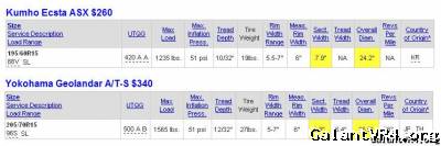

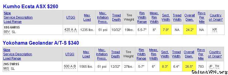

Okay, if 205/60/15 is the widest we'd go on stock wheels, what's the tallest?
I'm pretty sure stock is 195/60/15, but would a 205/70/15 fit?
Looking to run a set of Yokohama Geolandars on the daily, but 205/70/15 is the smallest size they offer.
EDIT: specs on stock size vs the Geolandars
[/jack]

A 70 series sidewall is going to be really spongy and not much fun to drive. I'd stick with the 60 series or less. Plus, if the tire is to large in diameter it'll but the front fender liner. Ask me how I know...

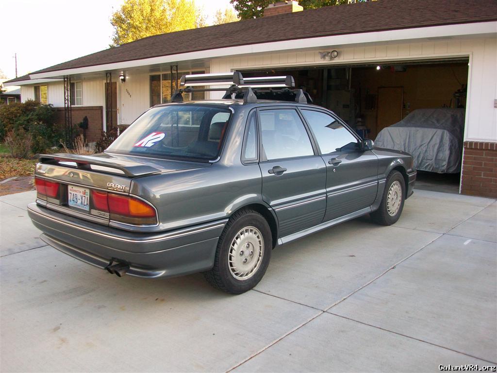

Yes 205/70/15s will fit. PM Turbowop for more info on those because he is running them.
503 in rock crawling mode
And lowered to 'normal' height /ubbthreads/images/graemlins/grin.gif

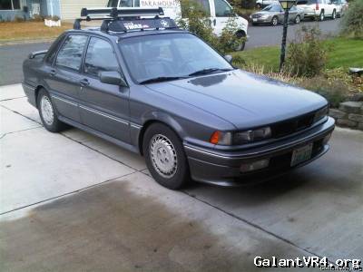

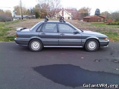

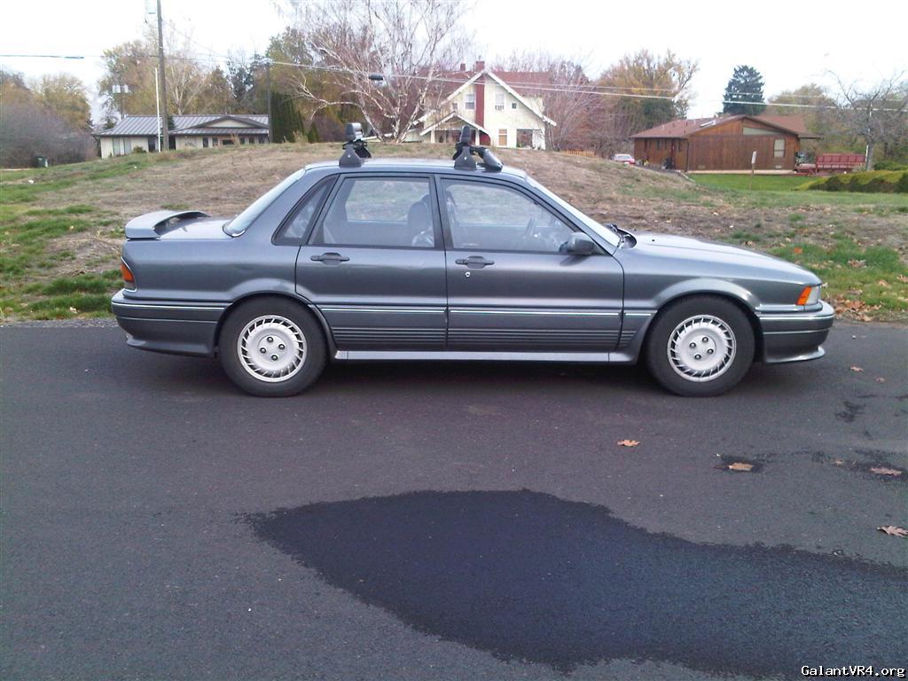

Edit: Here's a pic of my new daily. I'm running Yokohoma S74s, 205/65/15s and they rock!
