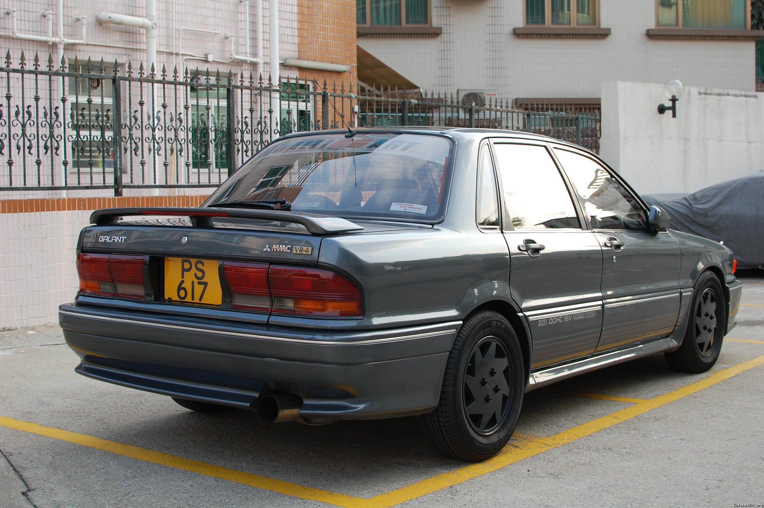

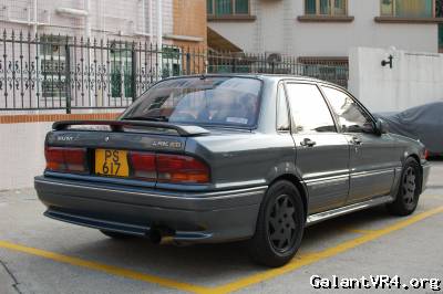

^^^ That being the case, do you really need a Hi-performance tyre?
I like the look of the 'balloon' tyres (I know, I'm weird) and I find the added protection against curb rash that they offer, plus the decent wet weather performance (it still rains in the summer over here) to be a real bonus.
I still drive aggressively enough that my wife complains on a regular basis and I really never feel the tyres are that much of a compromise. The only thing that might lead me to change my tyre choice in future is that I need to go to a larger wheel size (17") to clear the Baer brake kit that I have.

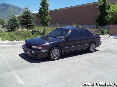

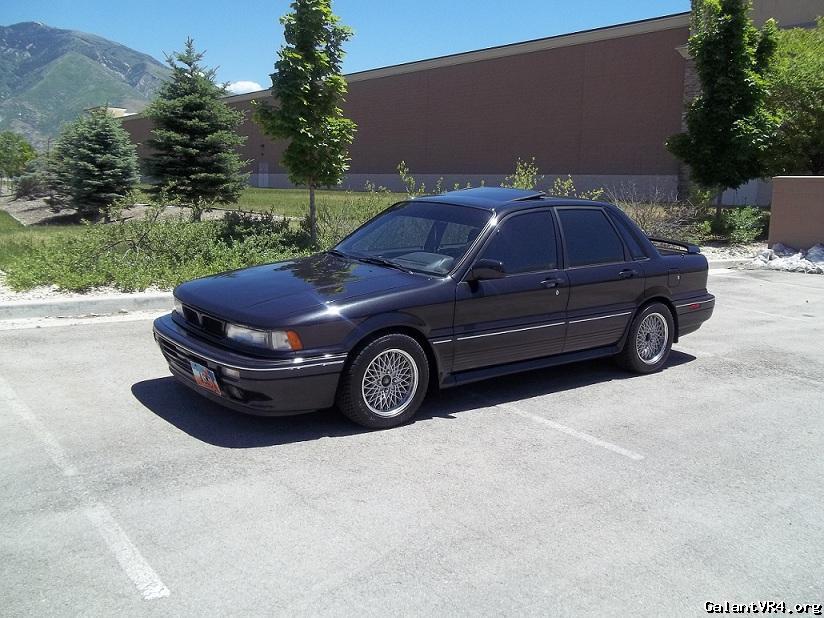

I just went with 205/55/15's on mine I love how it looks, my wheels are 15x7 25 offset so it looks pretty aggresive, rolled fenders and no rubbing tho
tires are falken ze502
