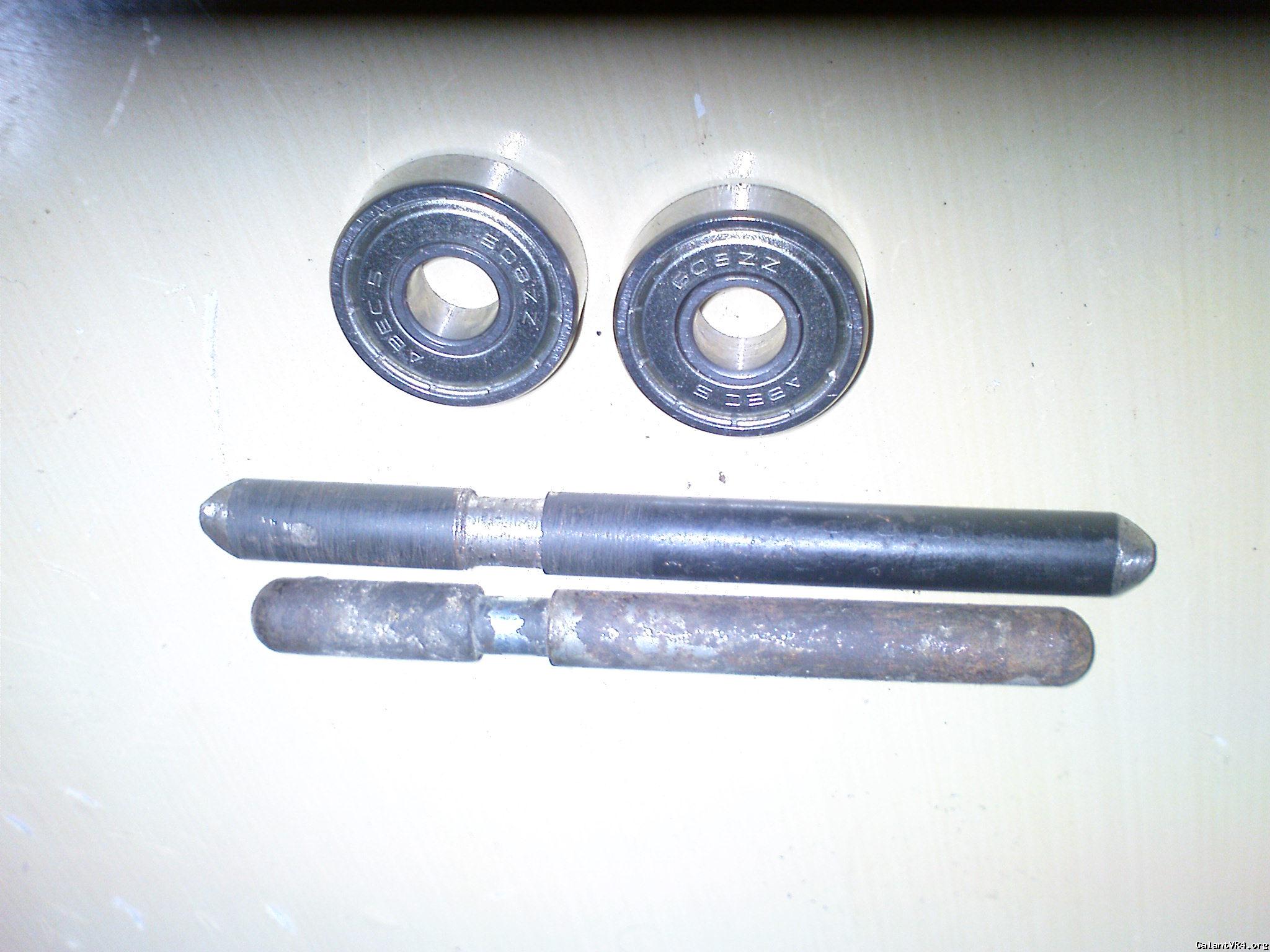

I am having difficulty to shift between gears especially on the fifth gear. It heapen after I replaced the clutch. I am suspecting the SHIFTER BEARINGS Bushings at the end of shift cables under bonnet. I will buy an upgrade & I am confused what to buy. Any experiance or suggestions please....

go to any sporting goods store and buy a pack of rollerblade/skateboard bearings .... they press in nicely with a clamp and fit snugly over the pin.

Nice idea! Is it universal size or should I ask for specific size?

Clutch is OK.. I can feel some thing wrong when moving the shifter. It is cable adjustment or buishings problem. I spry white grease on the shifter and under bonnet shifter bearings. It feels better when shifting.

OK..Got them. I just call my liitle brother he has some extra bearings.

cant be any worse than slopy dried out rubber inserts .... the inserts make it so that there is no flex in the shifter bushing ... so if you have any "notchyness" to start with it will amplify this feeling since there is no rubber to absorb this feeling. The bushing/bearing mod won't make you miss gears, on the contrary it make is much more clear and precise where each gear is

I just don't like the way it feels. I never had any problems shifting with the stock bushings and I thought this would firm it up a little but it made it kind of notchy IMHO. I guess its better than worn out stockers if yours are really whooped but it sounds like you might need to shim the clutch fork pivot ball inside the bellhousing and maybe replace the fork. Also, if you had the flywheel machined the step could be cut wrong. The problems started after you replaced the clutch, I would look in that area first.

Actually there where a problem before I changed the clutch. And I hit the cables when I was trying to fit the trany back several times. Also after I grease the bushings I add washers to them it improved the shifting. Also I am not sure if I put back the lever (gearshift rev) correctly. (the thing which i should fit shift cable in). I will start with the bushings which is the cheapest.

I've had the roller bearings, and while I didn't mind how they felt, I hated trying to take the cables off. I could not get the one cable off the shifter shaft to save my life. I had to un-bolt the 90* selector arm and leave it on the cable to remove the trans. This was only about 6 months after putting the bearings in. They had pretty much seized tight to the shaft.
JNZ sells delrin ones for around $20 IIRC.

I had the same problem with the skateboard bearings in #36. In #246 I am using the underhood bushing kit that AMS sells, and I like it a lot.

The JNZ delrin ones sound like a much better option. I'm going to have to order a set of them when I do my motor swap. I'm sure my bearings will be seized onto my shift arms, they've been on there a couple of years.

I am getting better shifting now. I used the Bearings & Extended clutch slave cylinder rod. That is cheap options.
