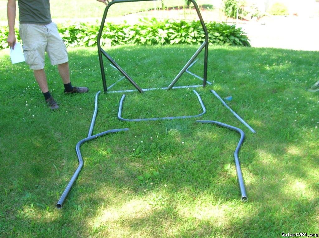

It should've been done already, but the guy's house burned down, so he has been a little preoccupied. Here's a picture of when I had the cage bent up over the summer, don't mind the black socks, it was laundry day.

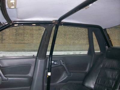

Quoting number3:
The way that the c-pillar bars and everything fit through the rear deck and along the roof passed tech for 11.49-10.0 spec? Seems like the back seat was still fairly usable with that cage. Also curious as to adding the a pillar bars to a cage like that. I don't like the way the bolt on cages go around the dash with the bend, seems like that would cause a weak point.
11,991
I don't know if it matters, but Harry's cage was put in when the rulebooks were still requiring 11.99 and quicker needing a cage/rollbar.
Spoke to a man recently who builds roll cages and the roll "cage" in 3/1000 really isn't legal for most racing at all. Its mainly just a harness bar and roll hoop. Thats what I was told. /ubbthreads/images/graemlins/dunno.gif
And yes the back seat area is still plenty accessable to average sized people.

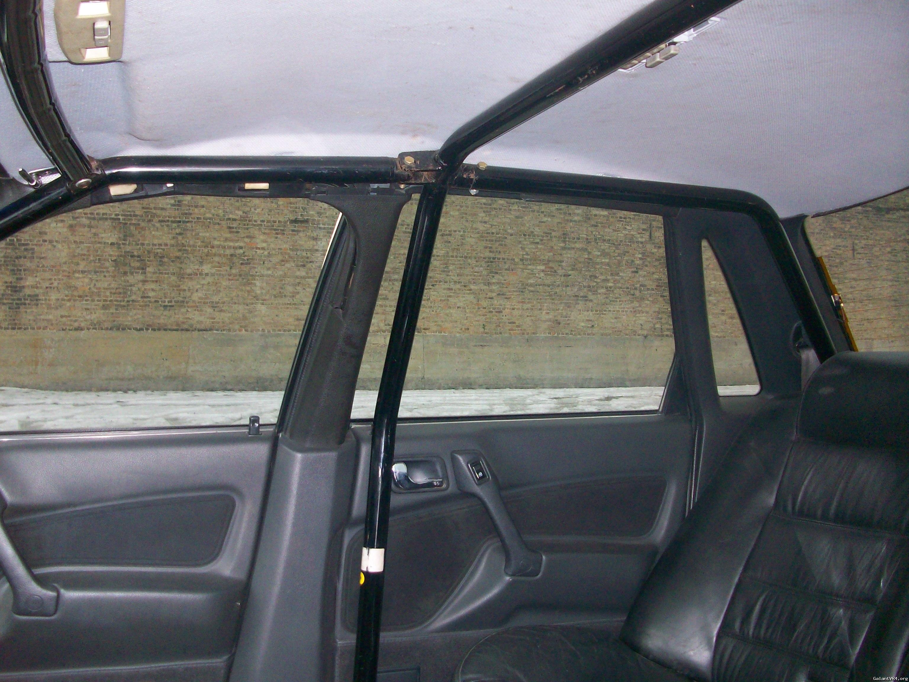

BOLT ON BARS ARE JUNK. Look here.
Harry's Roll bar is good from 11.49 to 10.00 If you go faster then you need a pillar bars as well as halo.a full cage for that matter.This full cage is good from 9.99 to 8.50 faster then that things get a little complicated to explain theres stock floorboard rules blah blah.You'll also need an nhra comp license if you go quicker then 9.99 or faster then 135mph check with nhra because rules are always changing.

I agree bolt in bars are junk, from only dirt track racing stock classes helping my friends out bolt in bars arent a complete waste if they are reiforced like a regular weld in cage at the bolt points so they can still be bolted down easily removed for some reason, and be a little more useful than just ripping straight threw the floor pan when actually rolled over
my cage came with the car and its made for galants. so im just gonna leave it there. my car wont run fast enough to require anything better. and its a huge pita to get apart. she's tight!! i'll get more pics so you guys can talk about how gay and worthless it is.
