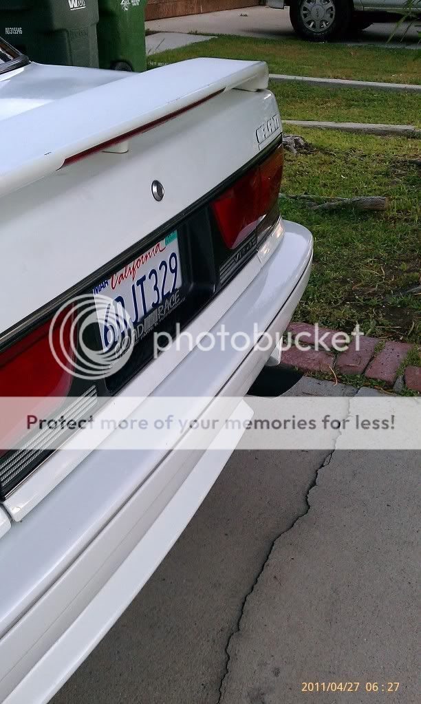

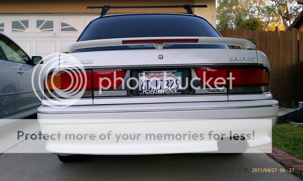

Quoting KiNgMaRtY:
I have a RRE 3" Stealth No Restrictions Exhaust. It is so quite, too quiet. Not much louder than stock
Can you post underneath pics? What all does it consist if? I don't see this on their site!

Quoting KiNgMaRtY:
Can you post some measurements up on the muffler please, i would appreciate it thanks.

I just saw the request. I'll try to take some underneath pics this weekend. No video for a few weeks as I shipped out my clutch pedal to Shepard for a rebuild.
