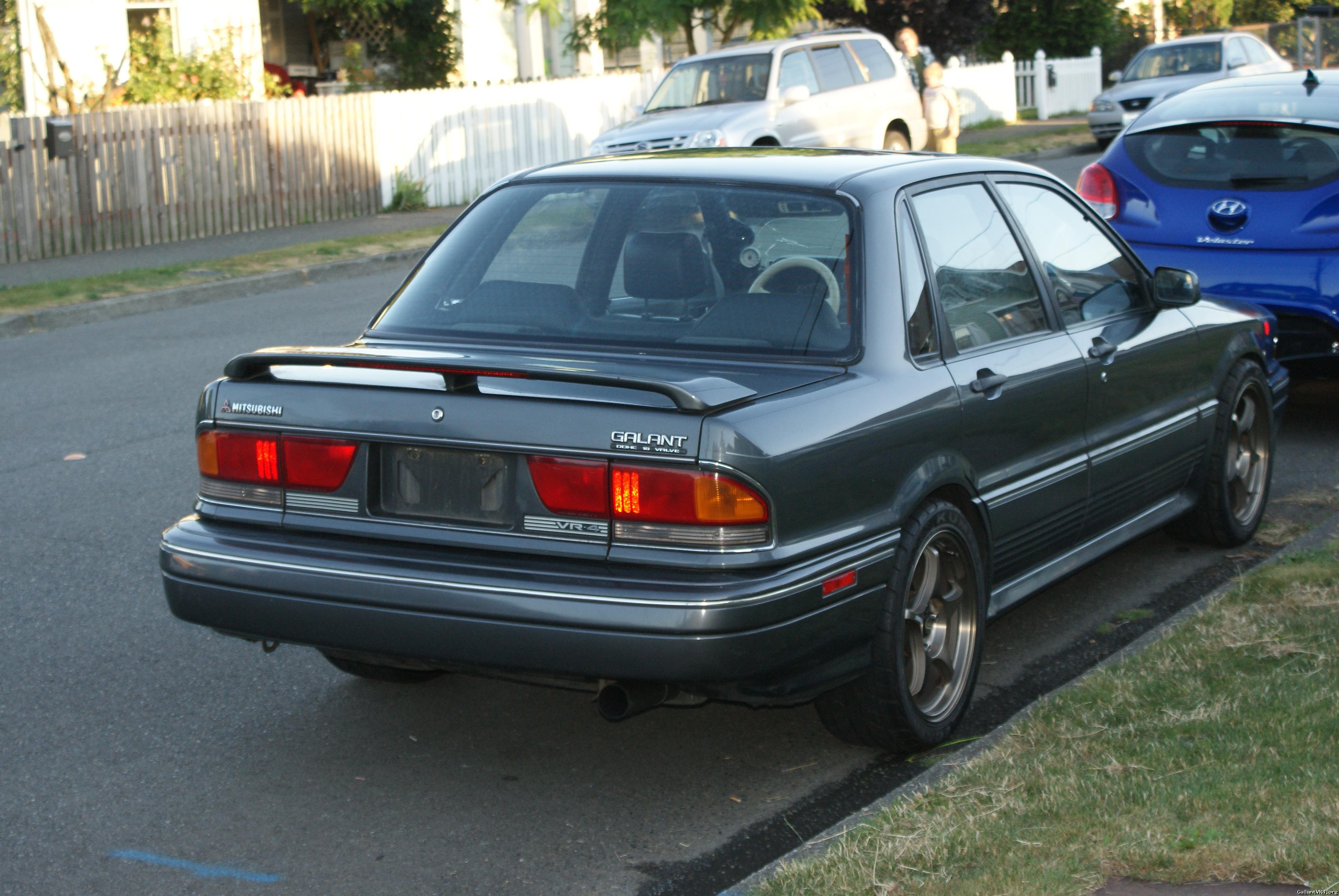

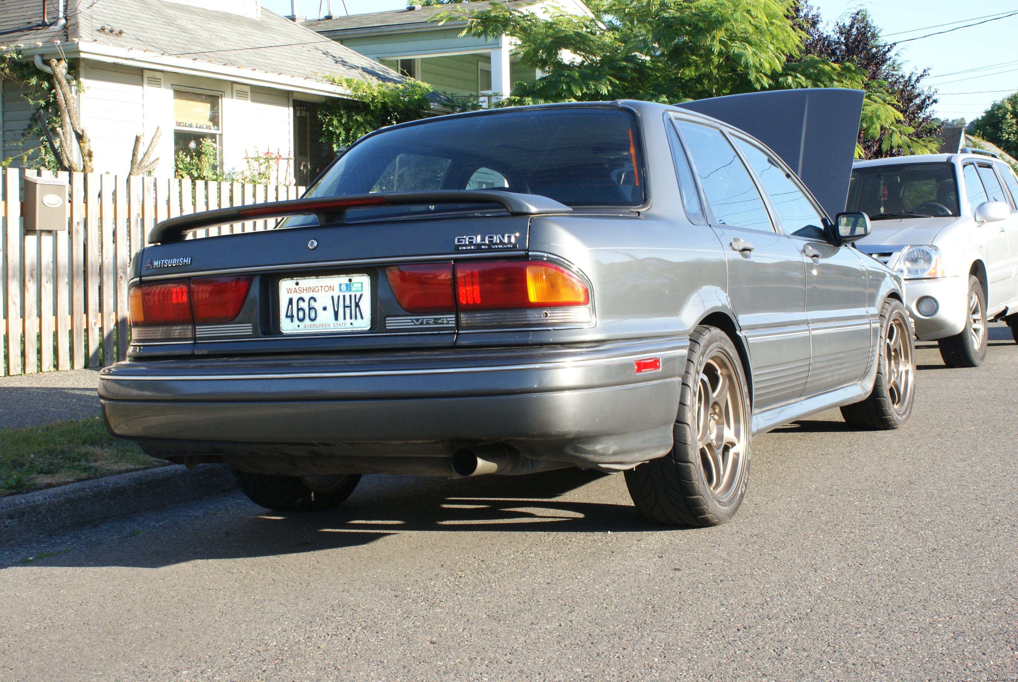

/ubbthreads/images/graemlins/dunno.gif I think a straight 3" out looks pretty stock-ish, myself. This is what i like, so this is what i did. To each their own...
Now tell me.. just how "non stock" or modded does that look, to someone (most people out there) who doesnt know our cars come with dual tips?

How'd you get that hole in your tail light?
Yeah, adds to the sleeper look for sure.
