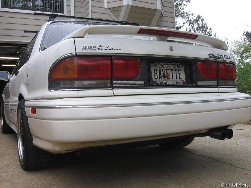

I have a 3in and out Edlebrock turbo muffler that Extreme Motorsports put on. I then had some Vibrant stainless twin tips on that.
To be cheaper I'd just get that muffler that raptorreed suggested since its everything in one. Twin round tips always look good and low key but you still get that full performance without being obvious. Just dont get those mufflers that go 1 into 2 and are made for you to have pipes coming out of them but people just leave that as the tip. That looks like junk. The spacing is like 6 inches apart and its obvious its not a tip. The vibrant tips are close and look right.

This is same thing I have but mine is 3 1/2" straight threw with custom tips looks like this tho
