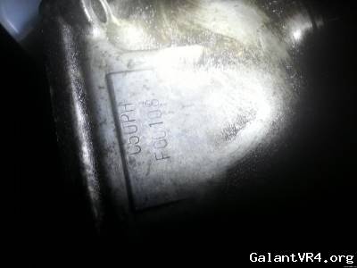

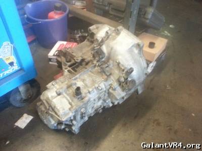

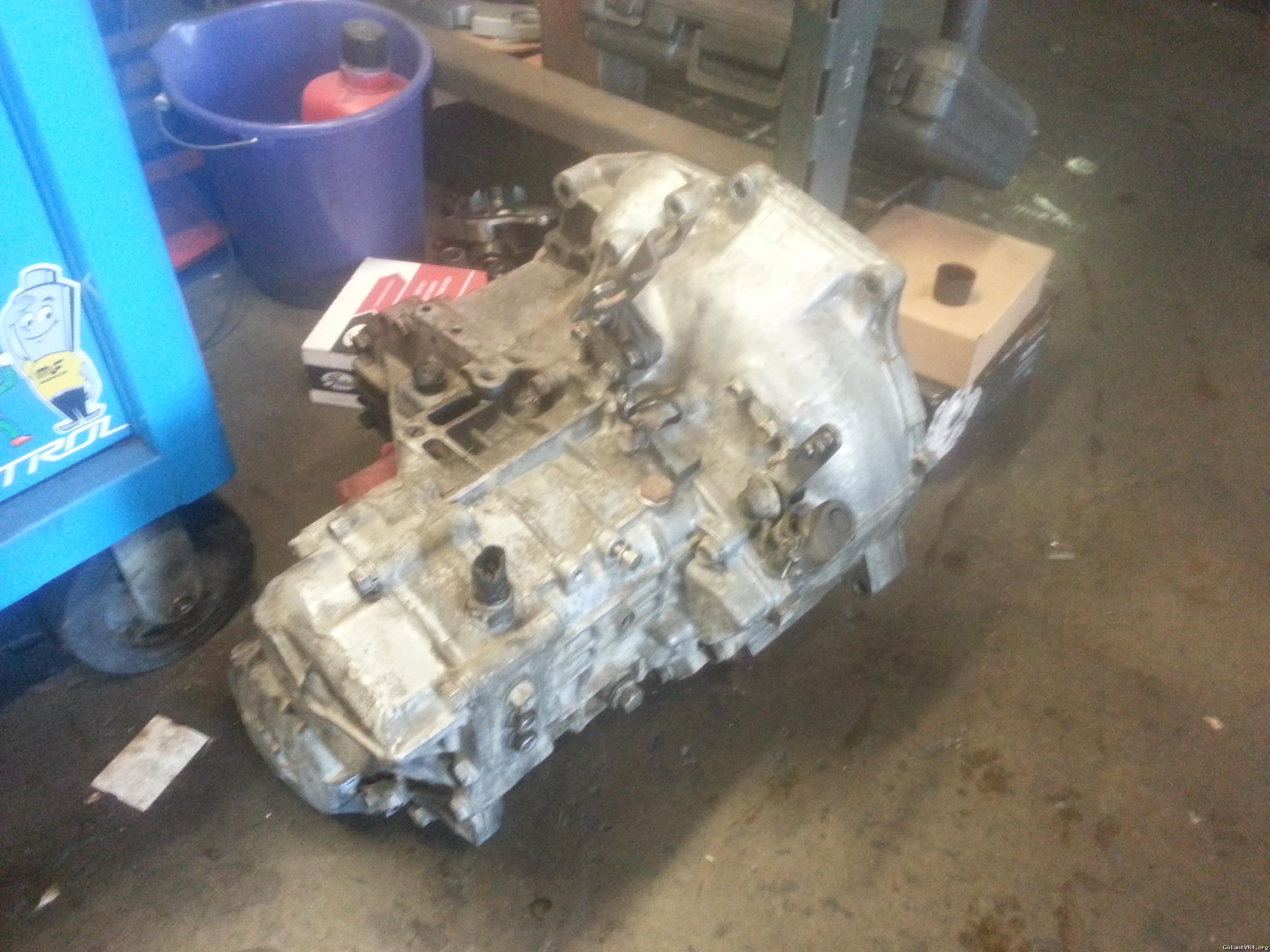

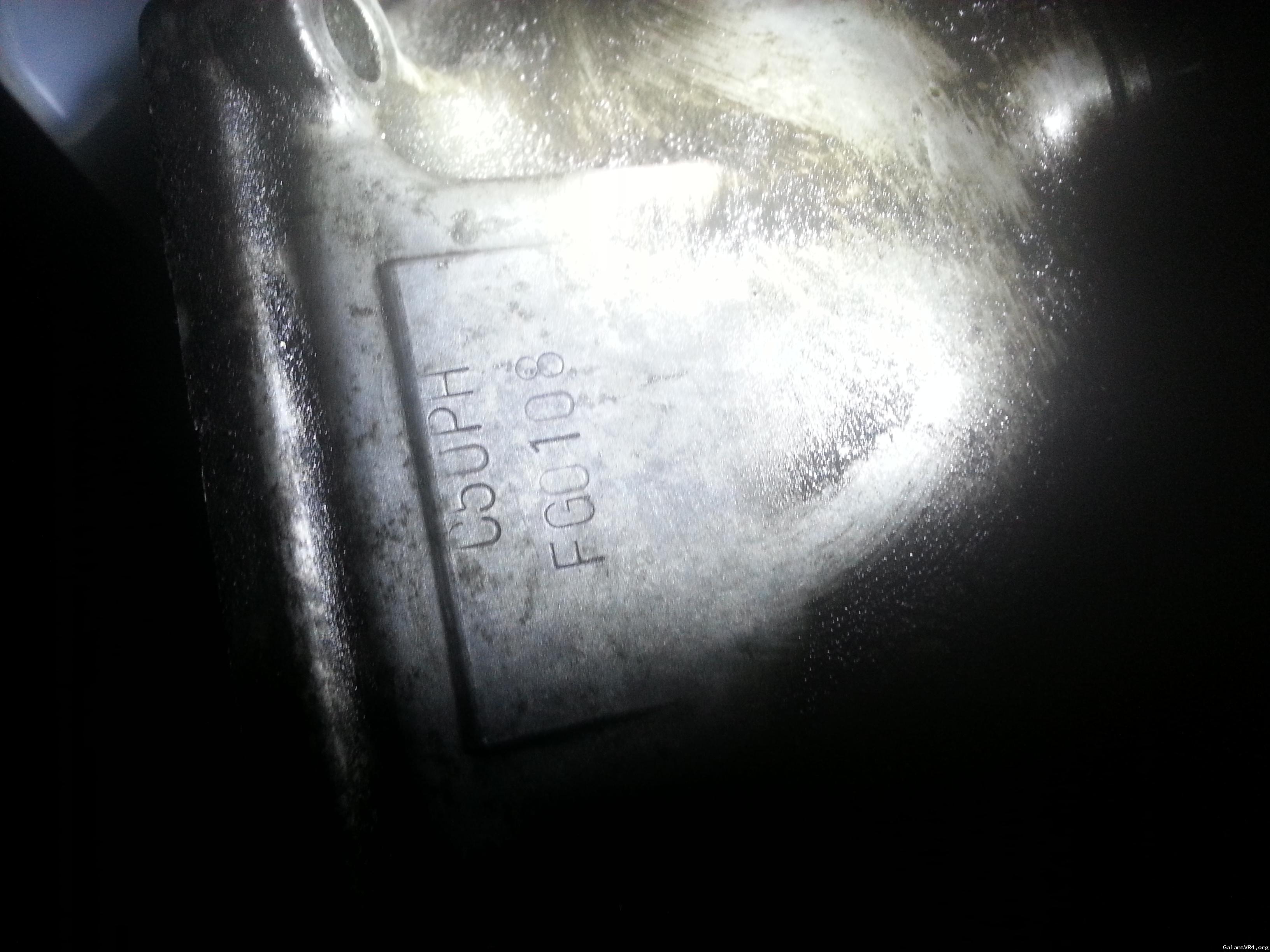

Picked up a used transmission yesterday. Its a Jdm box "C5OPH FG0108" switchable 2wd/4wd 22 spline 3.545FD. Its said to shift like butter. Came from 554/1000 to the best of my knowledge. I havent been able to track it any further back than that.
Hoping to swap it in very soon. Gotta pick up some new axle seals and clean it up a bit more. I plan on picking up the matching transfer case too otherwise I will be swapping out the 22 for my 23 spline shaft if possible. Hoping this will be a good temporary solution to my synchro blues!

Replaced the transmission today with the jdm switchable box I picked up. Shifts great now. Had to put my 23 spline output shaft from my usdm trans in. Worked out very well. I also replaced both axle seals and the output shaft seal. This time around I used 75-90 valvoline gl4. It's just amazing to be able to up and downshift without grinds, lockouts etc.

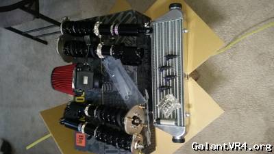

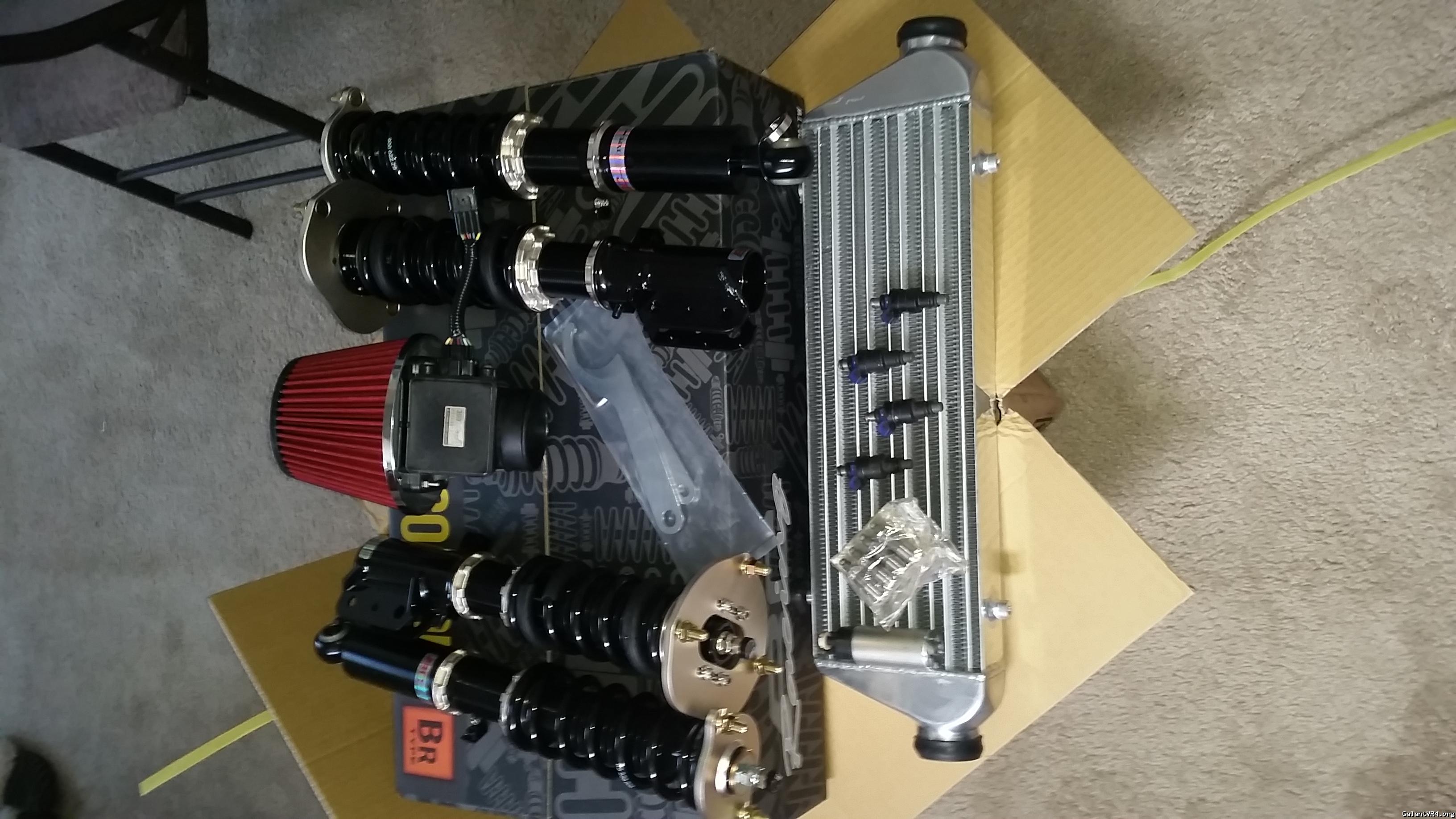

I have been collecting parts for the car since my last update. So far I've picked up...
3g lifters
A used drivers side auto seatbelt assembly
A used master window switch - Installed already
New OE radiator hoses
399 maf with Blox filter and adapter harness
Denso 660cc injectors
Evo 9 fuel pump
Hood strut kit- installed already
New BC BR coilovers
27x7x2.5 FMIC
Should have the coilovers installed and the car re aligned tomorrow. I'm hoping to get the MAF, injectors and fuel pump in very soon and get it tuned again. Then I will be taking it to a local Tig guy when I have a chance to have custom charge pipes made and the intercooler installed with another tune as well.
