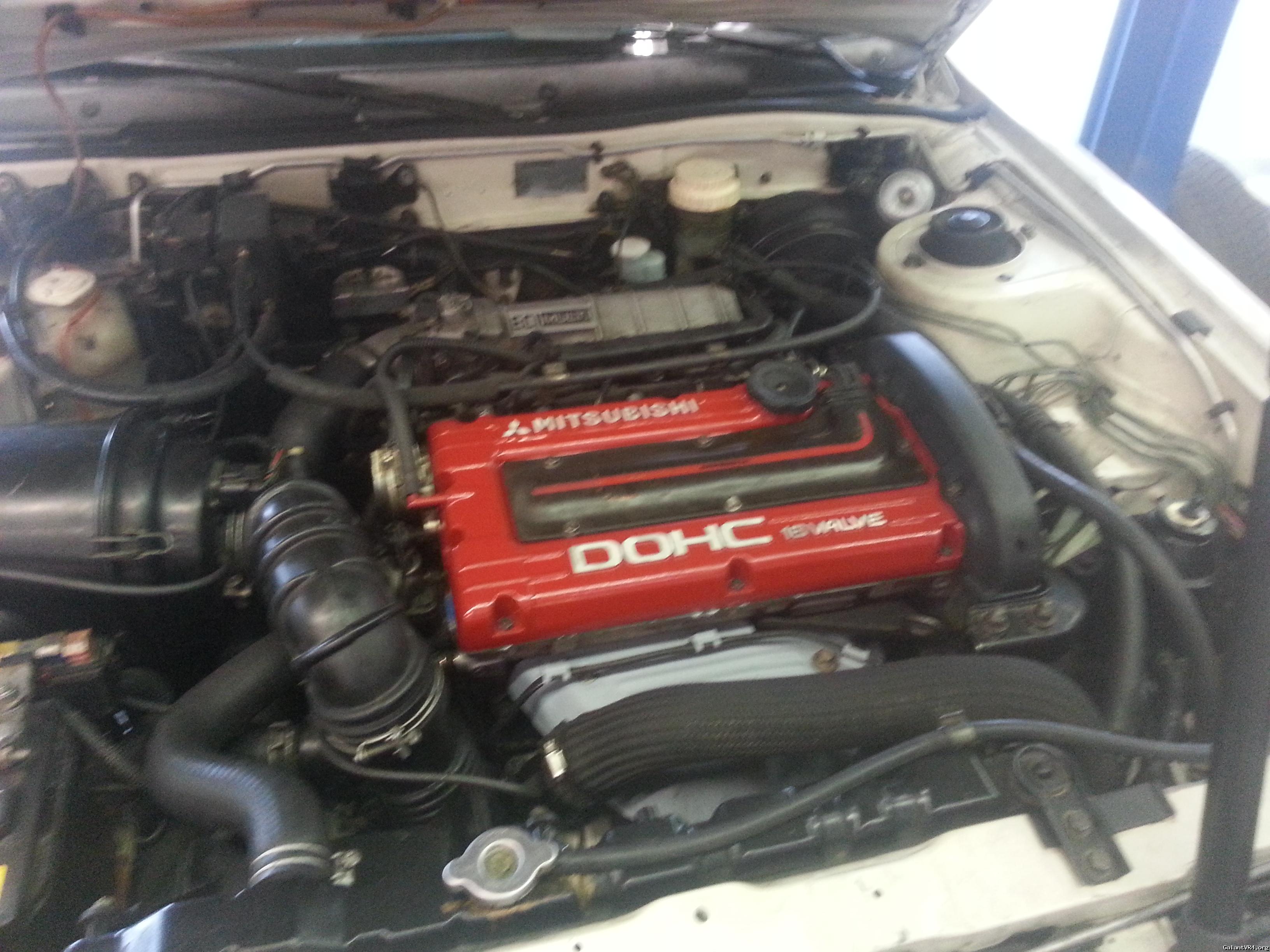

Figured the power issue out. I connected my new boost gauge and I was only reading 6.5 psi. Looked over my vacuum routing again and realized that I had the bcs line and j pipe lines mixed up. Got everything connected and routed properly and now I make 11.5ish psi at about 3400-3600? rpm. Its how the lines were routed when I got the car and I just put them back that way without looking at the underhood diagram closely when I was re assembling everything. Oops /ubbthreads/images/graemlins/blush.gif
Now it runs like a champ, much quicker than I expected! Its hard to resist and stay out of boost for the new clutch's sake! Drives very smoothly and the boost comes on like a charm. All the numerous old magazine articles and test drives write ups I've read have now come to life. What a great feeling car all around. I'm now very glad I decided on a vr4 instead of a 2.2 turbo legacy or dsm!

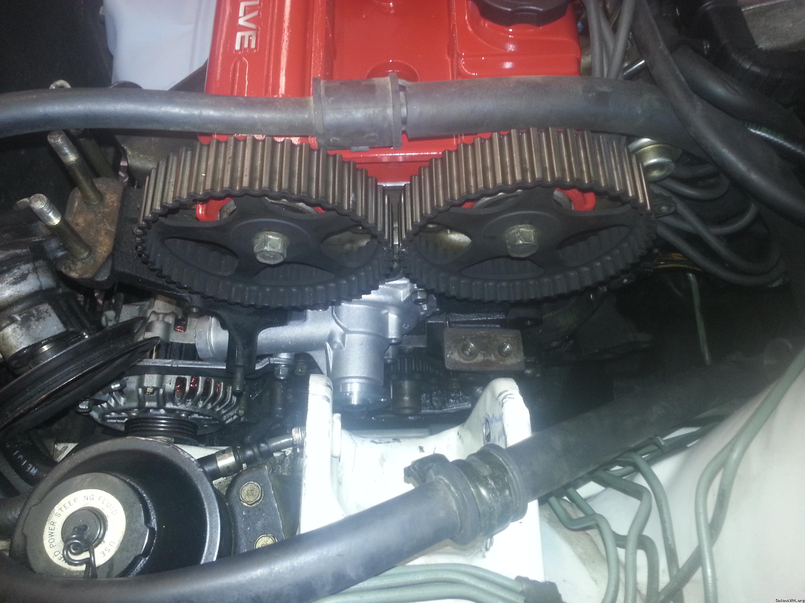

Glad you are getting her sorted out, that chassis looks pretty clean. Any rust in the rockers? Or bottom of the doors?
You never mentioned if you got the water pipe leak fixed but it's just a rubber o-ring holding it in with a 12 or 14mm securing it to the front of the block. You likely got it since you did the water pump and are obviously capable of working on cars.

Hi and thanks! She has been quite the project so far. As for the rust I haven't found anything but the battery tray and a small area underneath it but its all surface rust. There is a very small area on each pinchweld under the rear bumper that I plan to fix asap, its just surface rust at the moment and its difficult to notice. I haven't pulled the front fenders to see the situation there. Im guessing its minimal. Nothing on the rockers/doors whatsoever. It is fairly clean inside and out. It has a few door dings and imperfections you cannot see in the pictures though. The ancient tinting is very ugly too.
Yes I did get the waterpipe sealed. It seems that I've gotten all of the leaks patched up proper. Ive put 130 or so miles on it since I got her running and its clean and dry still.

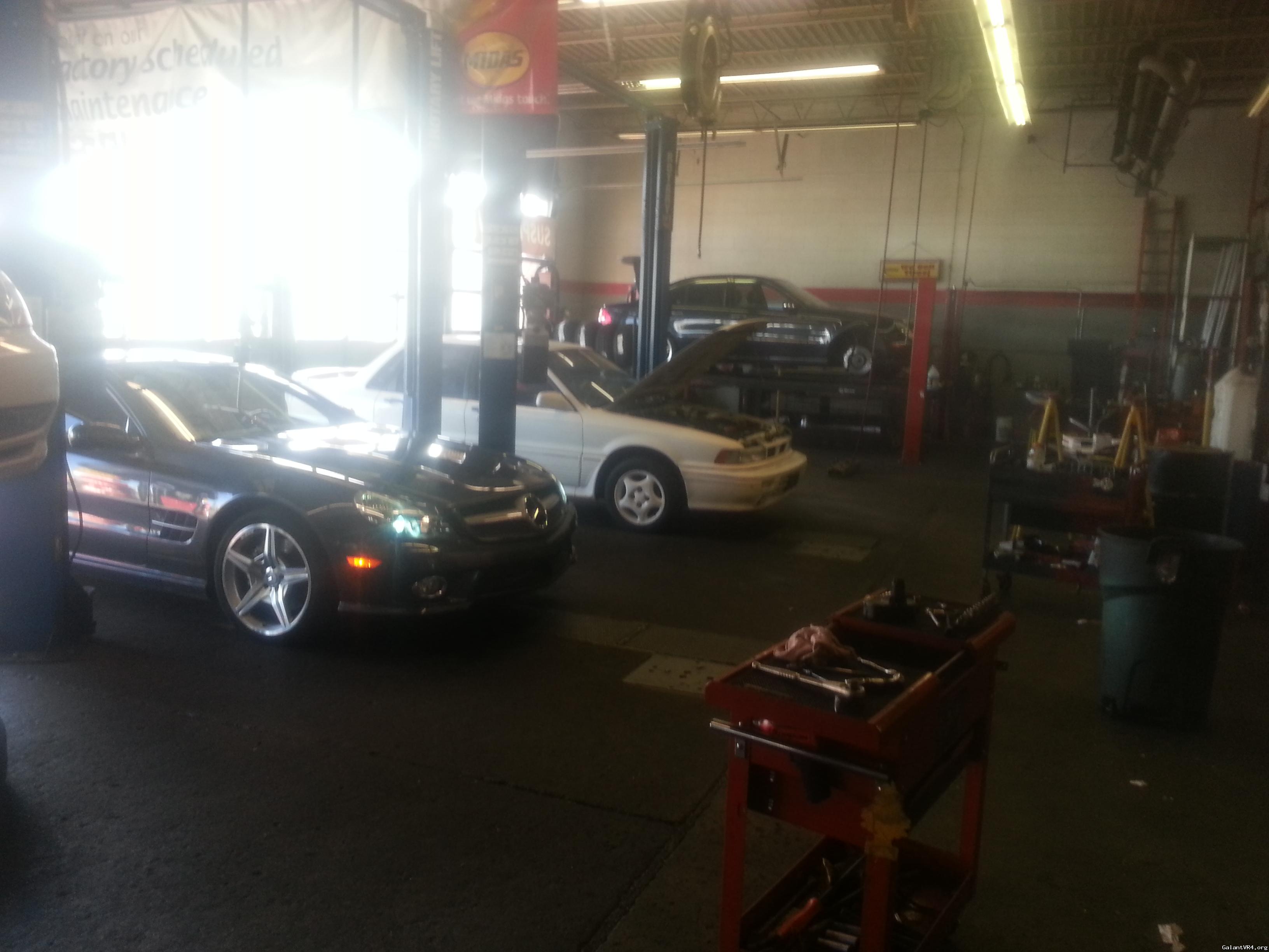

I actually work for Midas very near a firestone on west colfax. I grew up in Morrison.

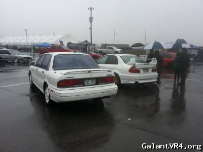

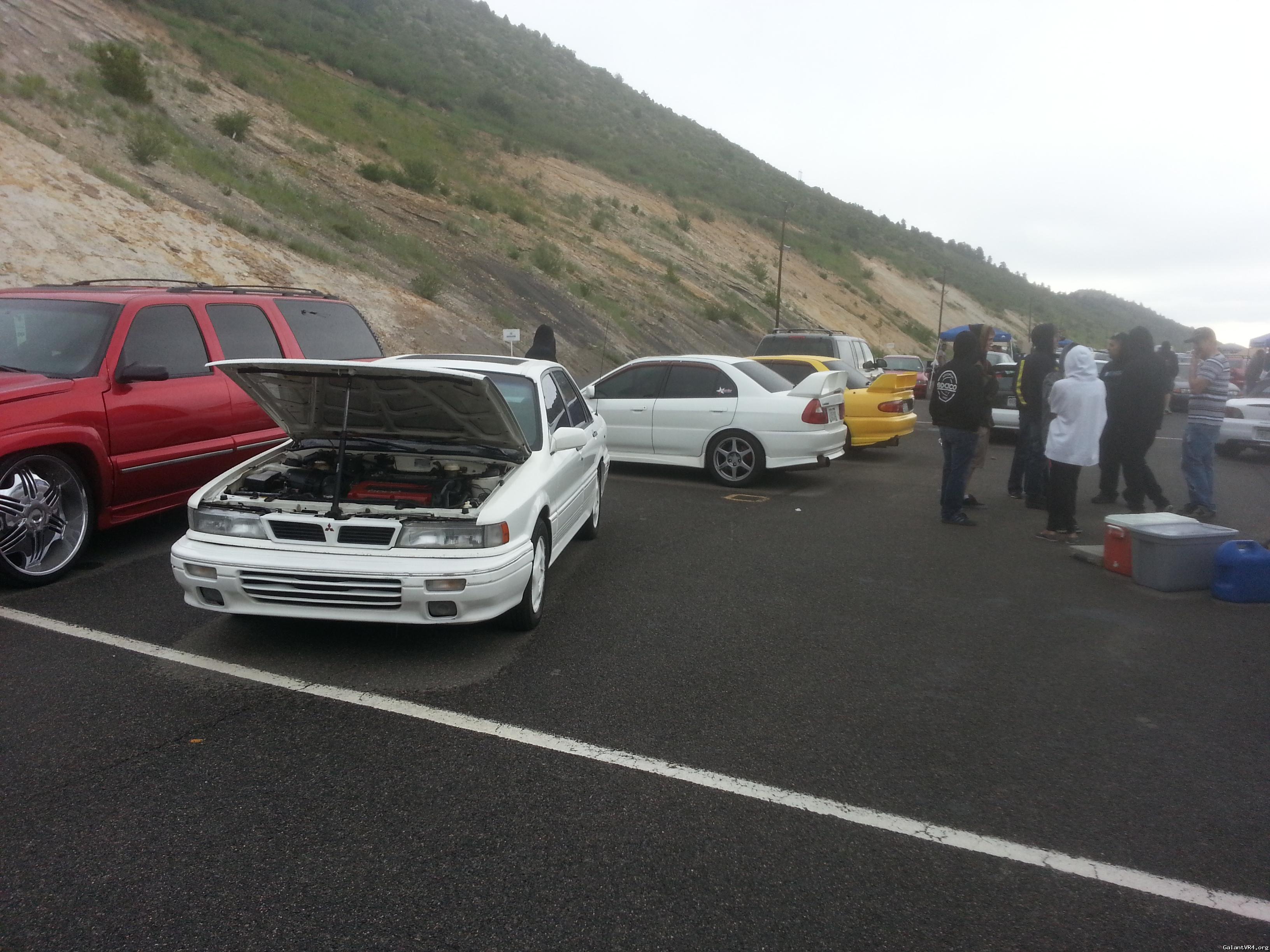

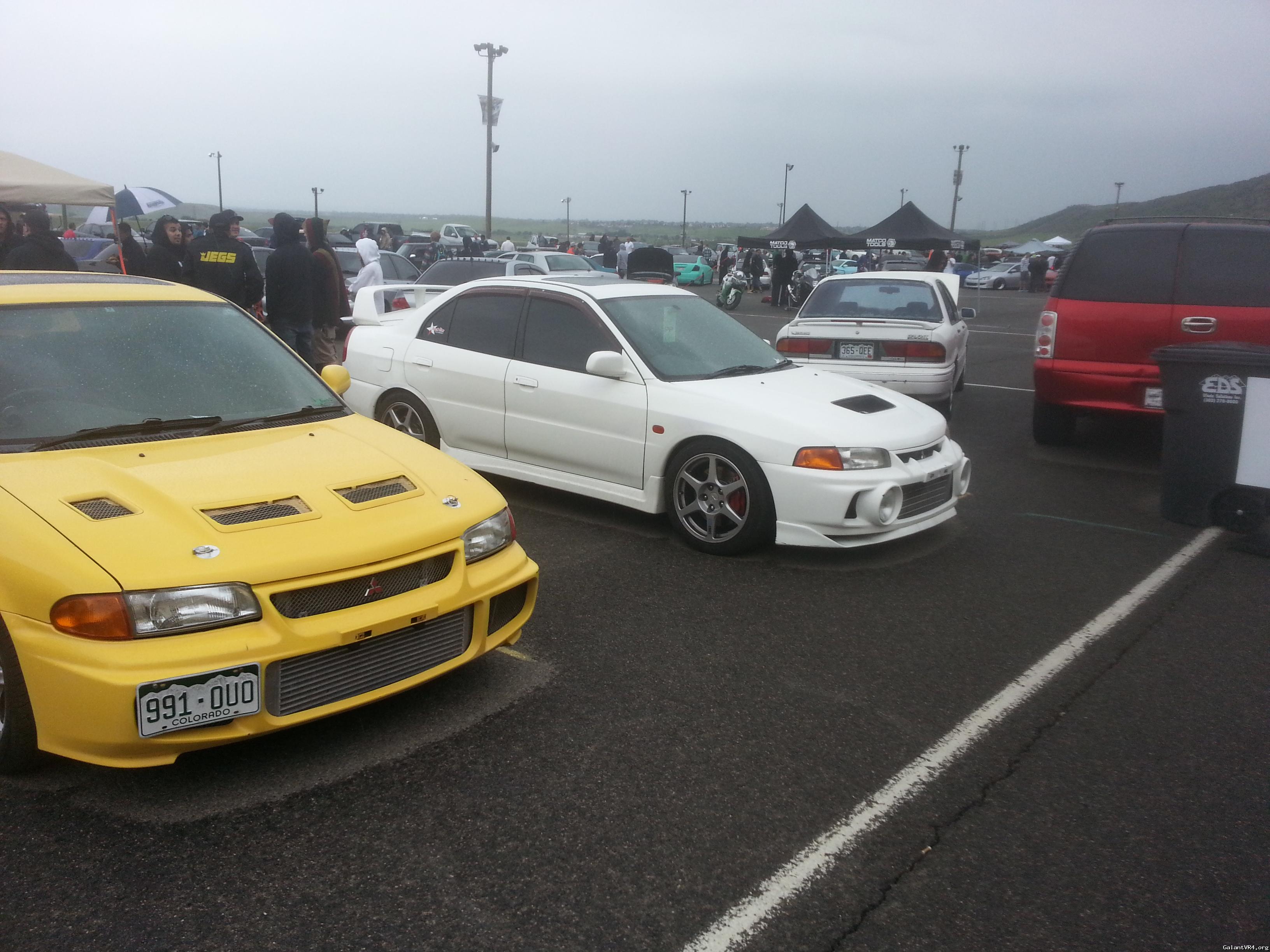

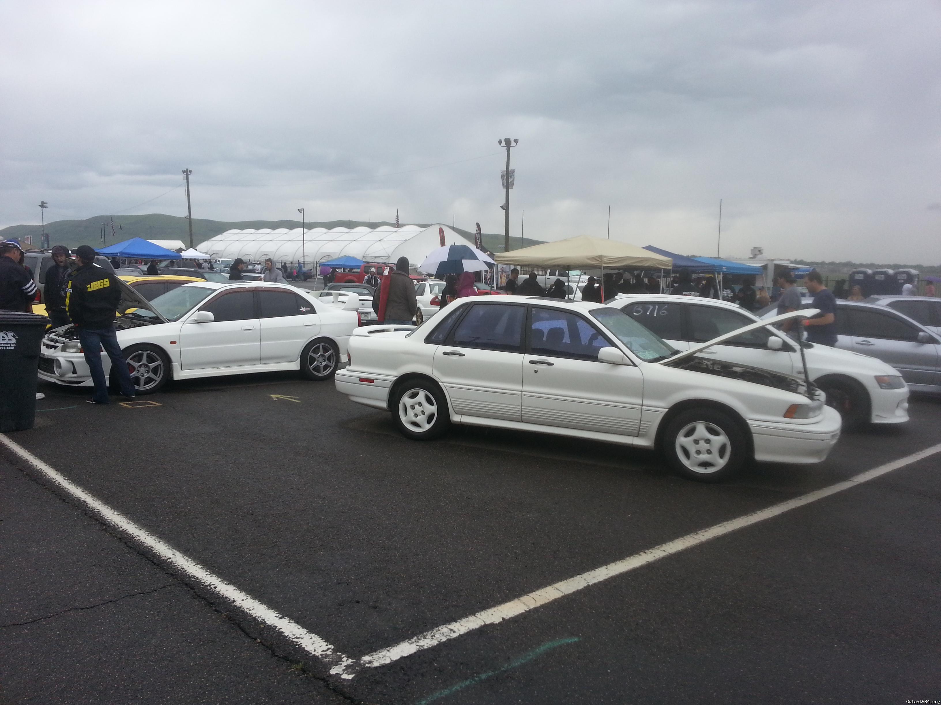

Put the galant in the IDRC drags/tuner mayhem car show at Bandimere speedway today! She was washed, clay barred, polished and waxed for the show. She got a lot of attention.
The show was pretty cool other than the rain. I didn't stick around for the awards show as I wasn't expecting to win anything. I had the only galant vr4 in the show but, 559/2000 was there racing. I had a great time and got to see some cool old evo's and a few other very cool cars.
