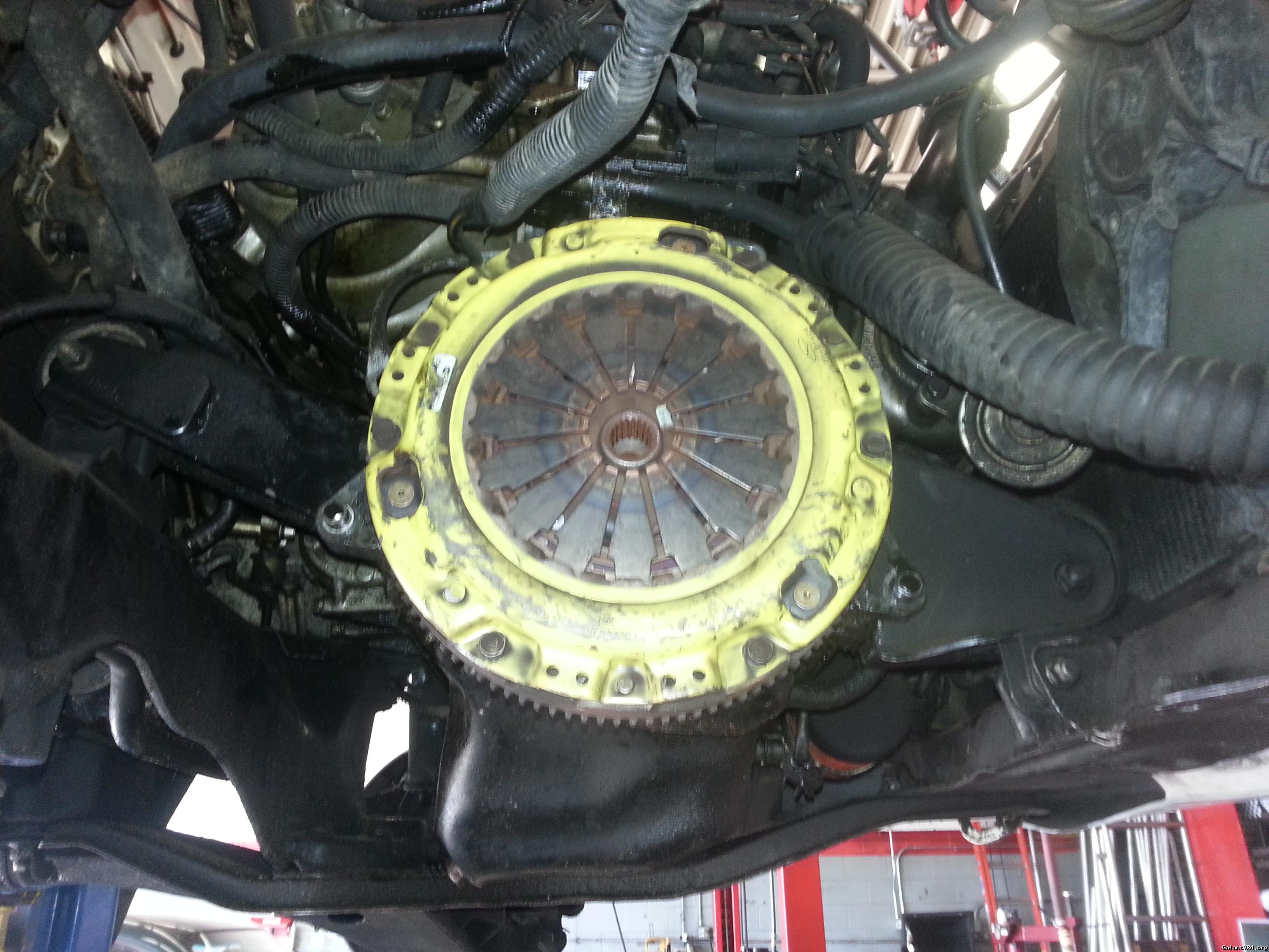

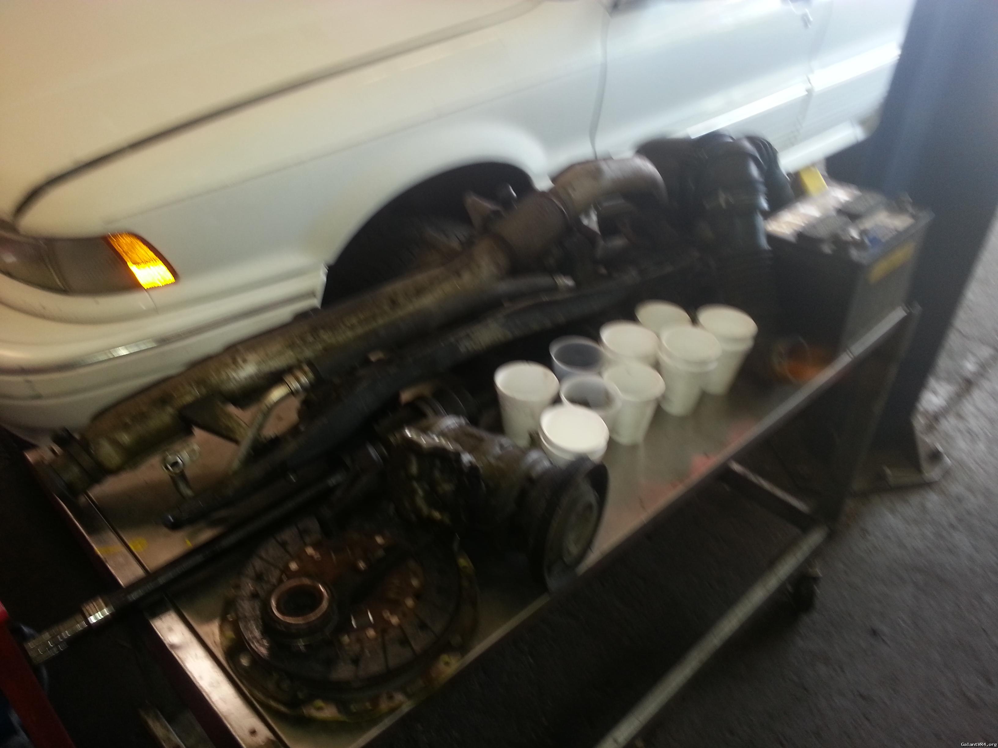

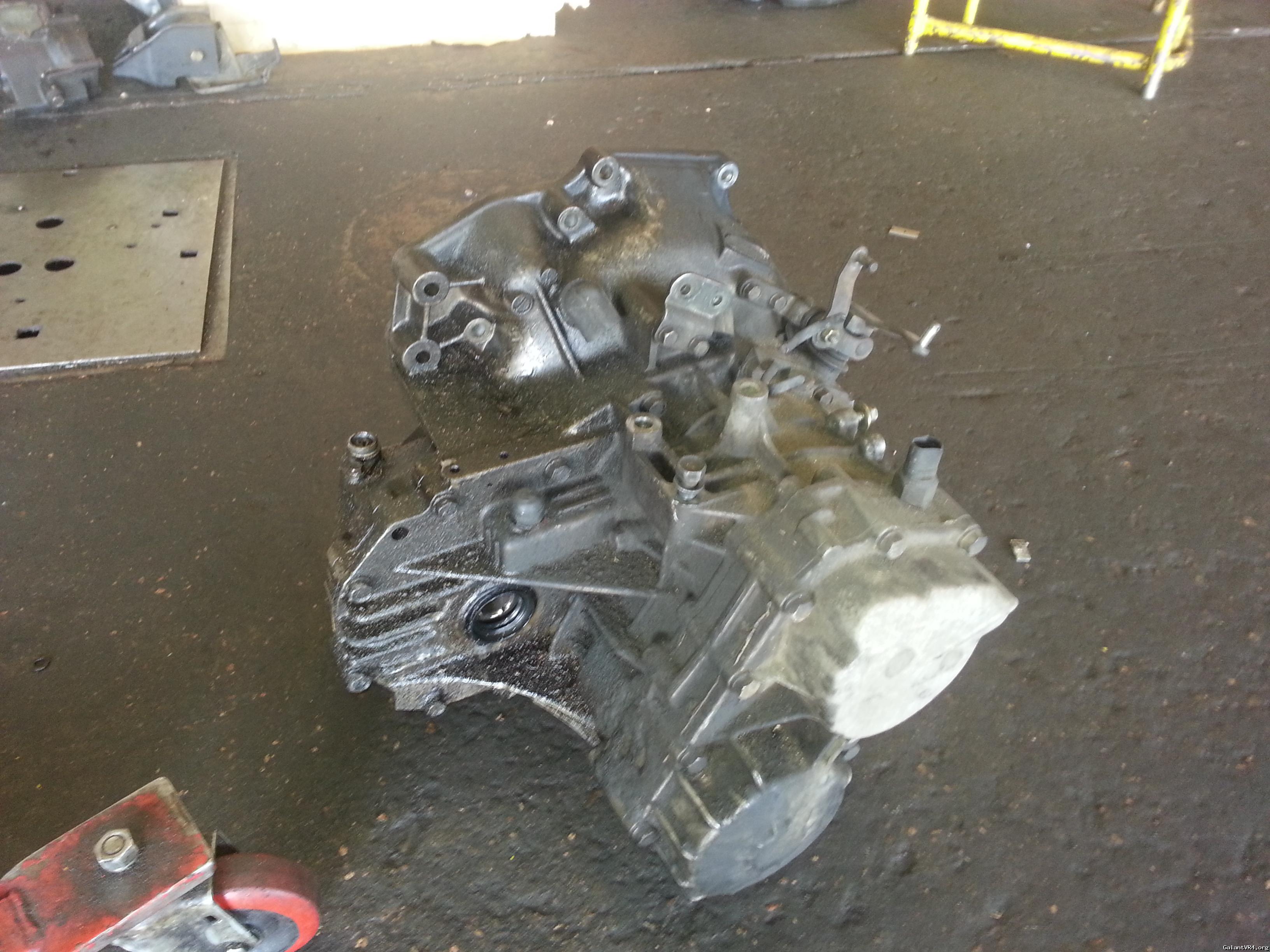

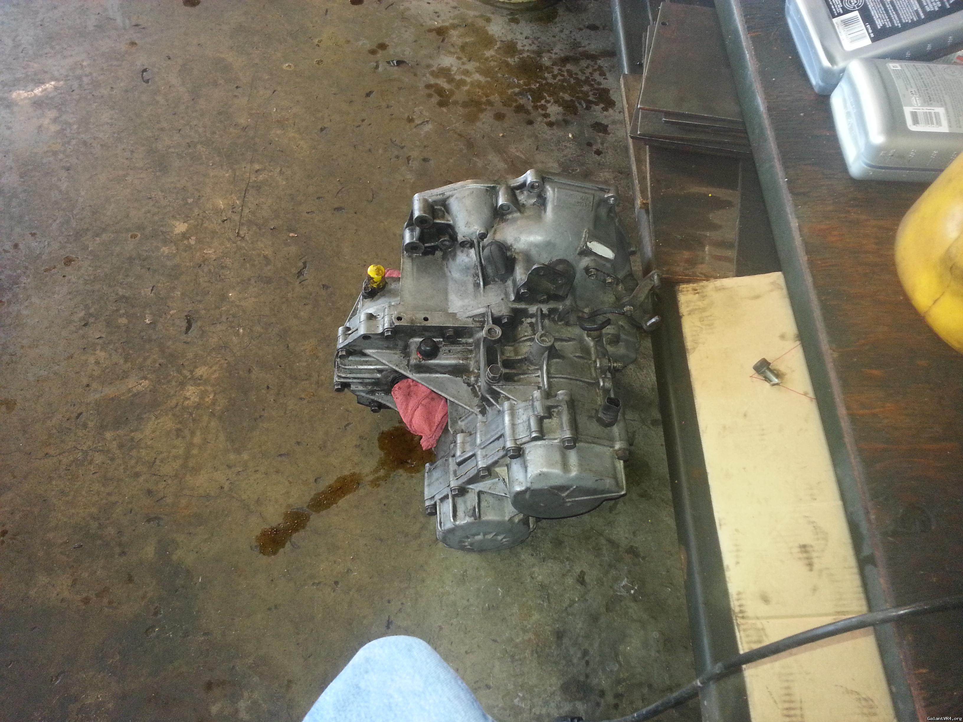

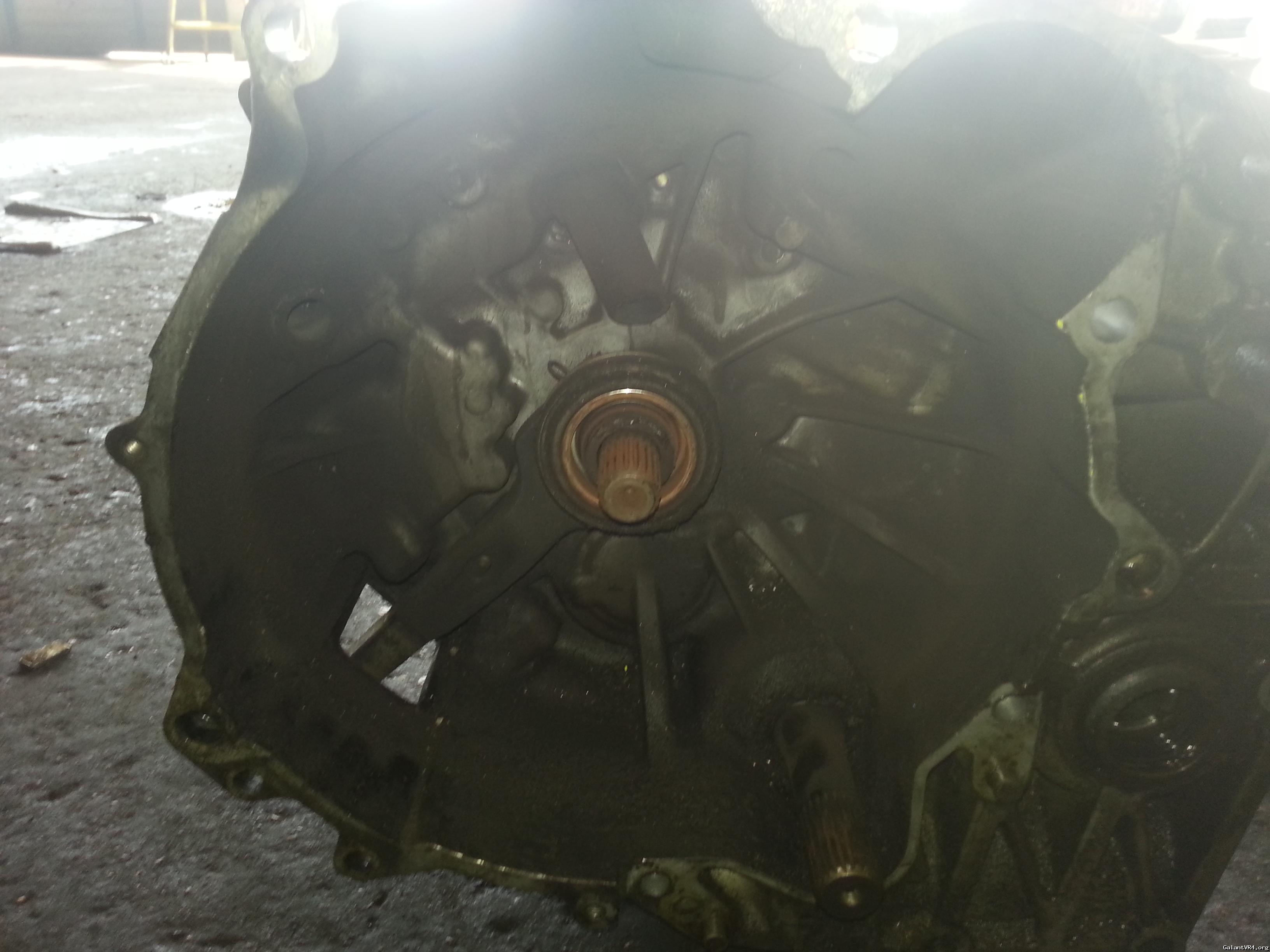

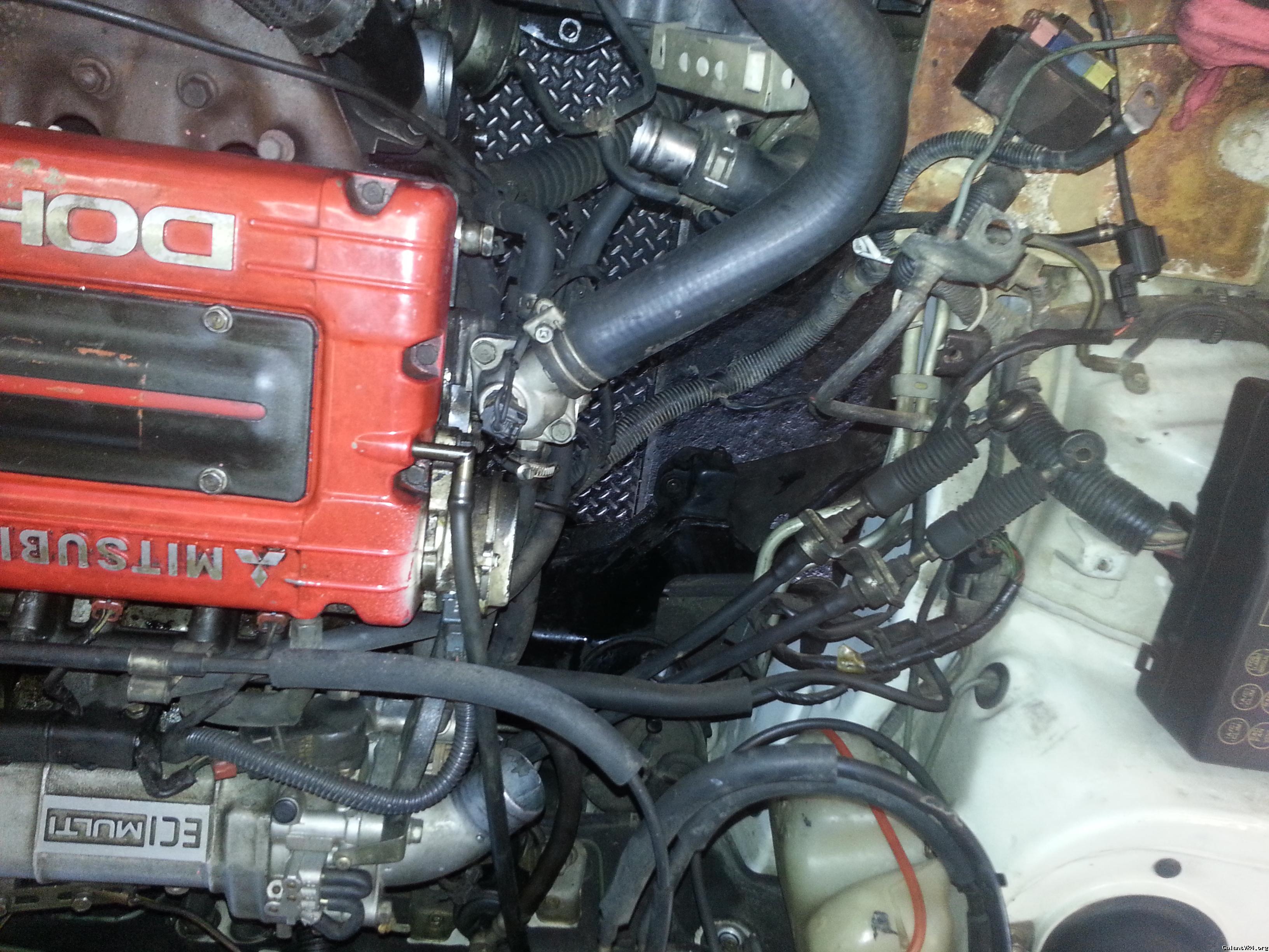

I was finally able to tear the car apart today. I removed the transmission and found my clutch and tob to be in bad shape. The fingers on the pressure plate are worn and uneven. Throwout bearing was complete trash and I don't understand why it wasn't making any noise. Disk was worn and a bit glazed. Flywheel looks to be ok-ish and I'm having it machined in the morning. I should have the clutch issues completely resolved upon reassembly.
Ran into a few snags.. I spent about an hour per side just removing the upper eccentric on the lower struts. Never struggled with them like this and I have removed more than I could ever count. It was bs. Found my one of my two trans mount bracket bolts to be cross threaded badly, will need to be re threaded. One of my lower transfer case bolts is helicoiled poorly. My reverse switch was not plugged in due to a damaged socket, it will need replaced to plug it in. My brake master cylinder is leaking, didn't even notice it till I was removing my ac compressor and lines. Also I found a hand full of bolts that don't belong to this car being used in random locations. And it looks like my water pipe on the front of the block leaks ever so slightly where the pipe goes into the water pump housing. It seeps slowly down and ends up hanging a drip off of the oil cooler/filter adapter, it makes it look like the oil cooler is leaking lightly and kinda freaked me out. In the month or so the car has been parked in the same bay in my shop and hasn't dripped any fluids at all amazingly.

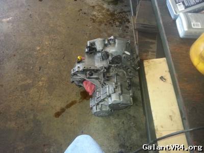

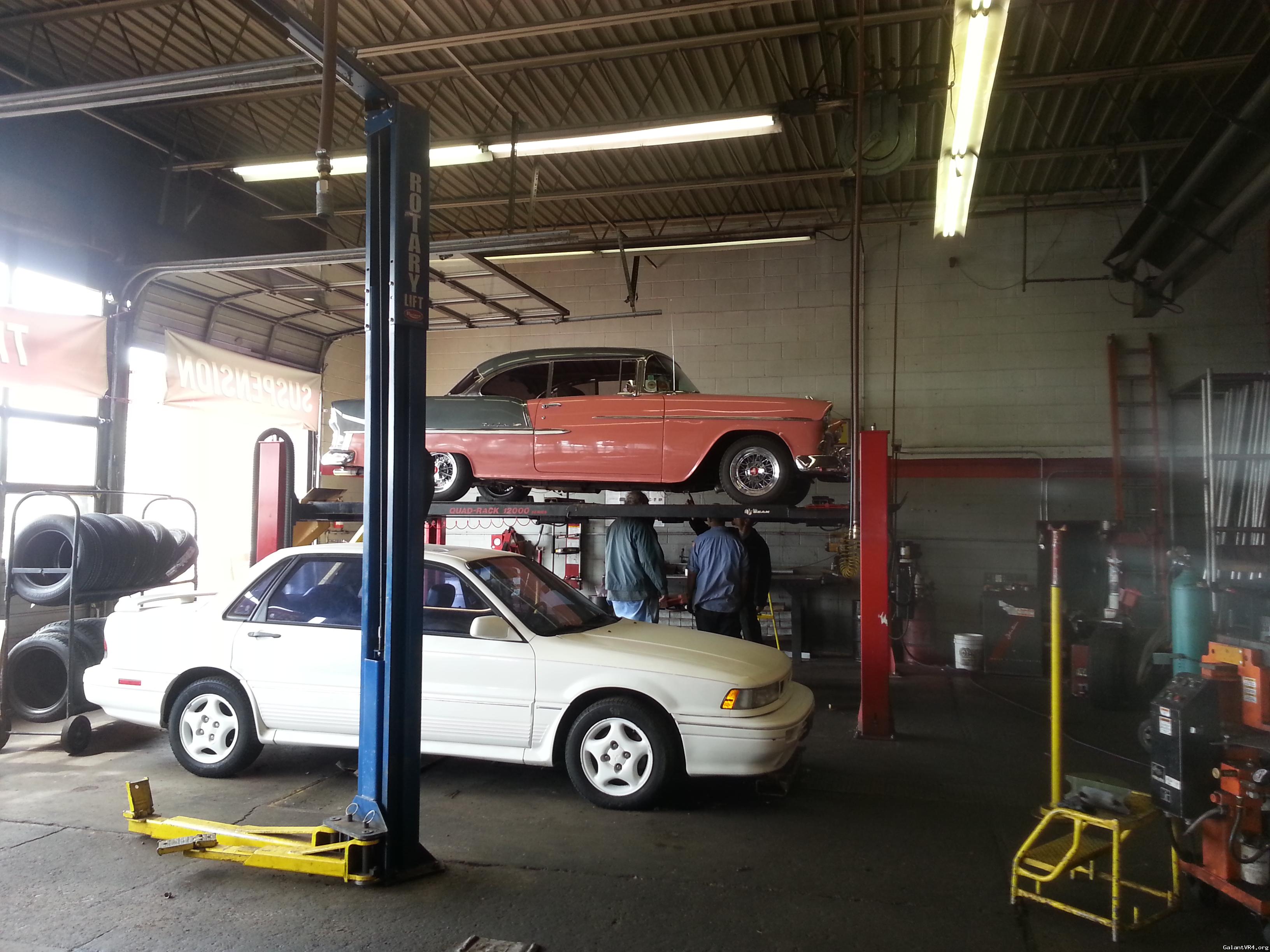

I spent 10 solid hours on it today and made some good progress. Got the engine bay much cleaner on the pass side and firewall also. Just a few more weeks and I'll have it back running like a champ. Here are some pics I snapped while working on it today including before and after cleaning the tranny and one of it from Saturday with a 55 bel air that actually caught on fire in the shop later that day.

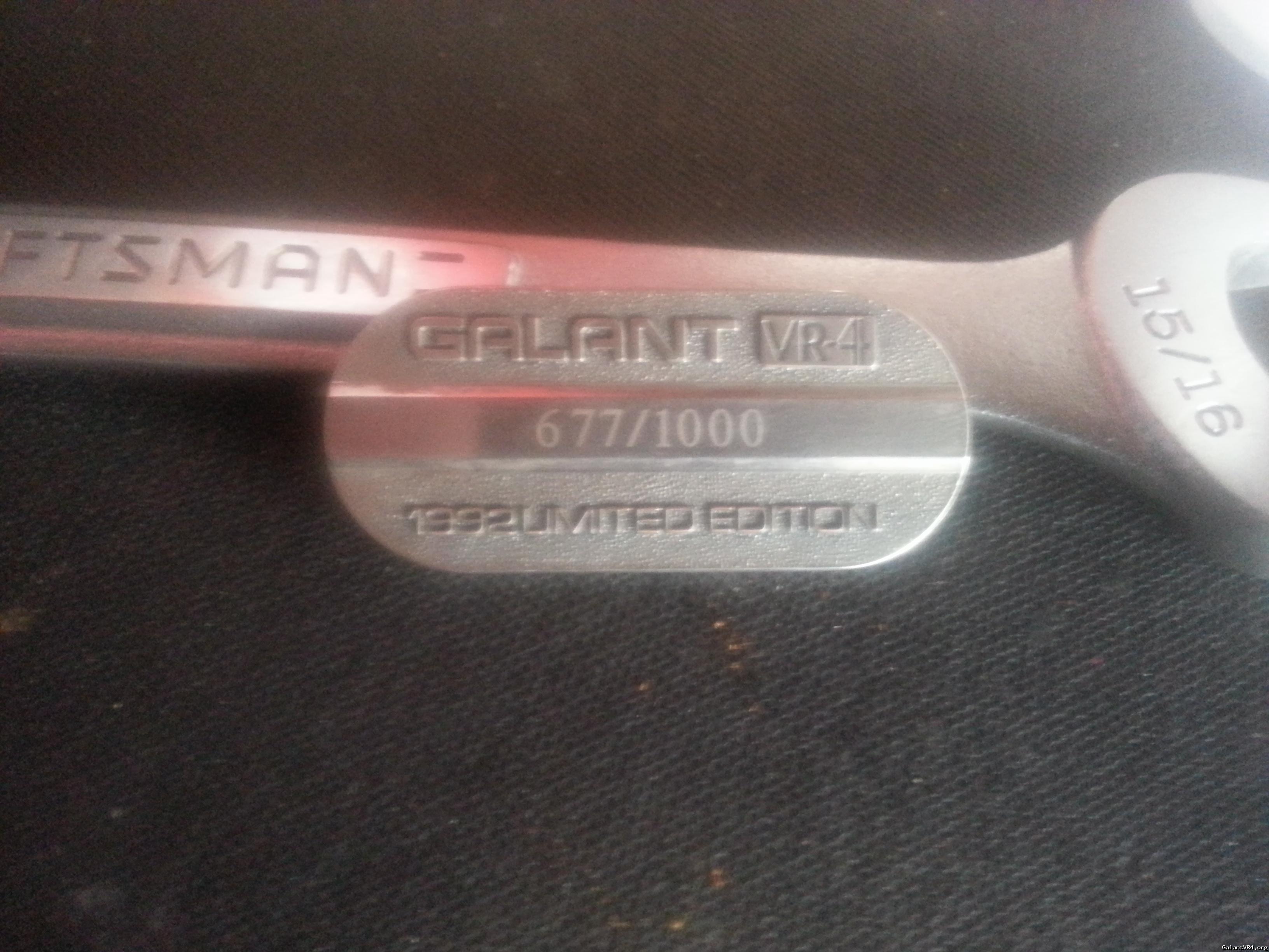

Look what I got! A big thanks to the previous owner of 677/1000 for hooking me up with this badge! It's sad that the real 677 is dead and rusted out, but it's pretty neat knowing she was a summit white w/sunroof also.

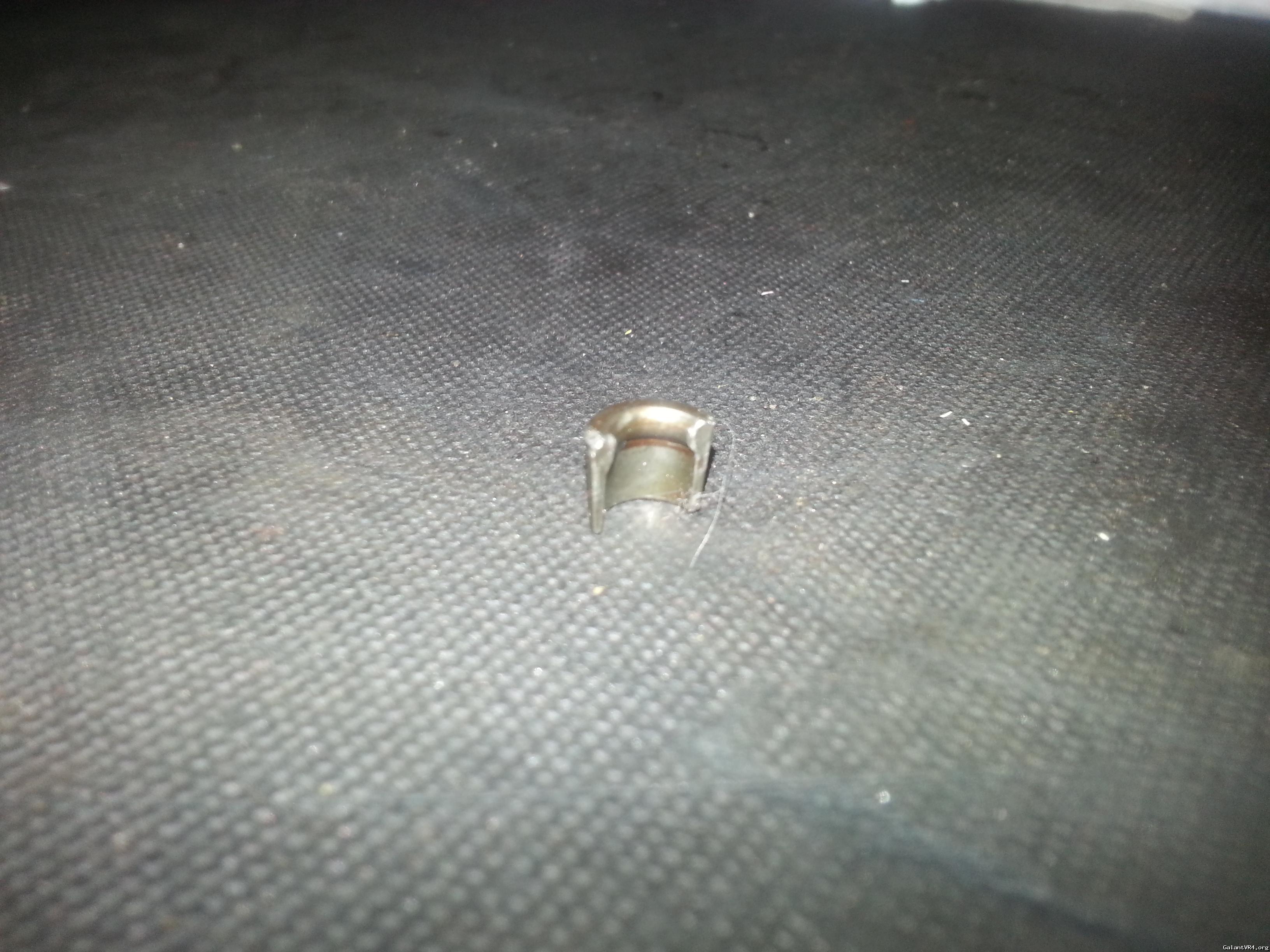

I was very shocked when I found a valve spring retainer lock in my oil pan along with some other large debris. Nothing was recognizable but the retainer. So now I'm in for a bit more work if that lock actually popped out.
Im curious, I haven't had my valve cover off yet too see. Are the retainers visible after just removing the valve cover or will I need to pull the cams?

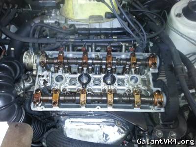

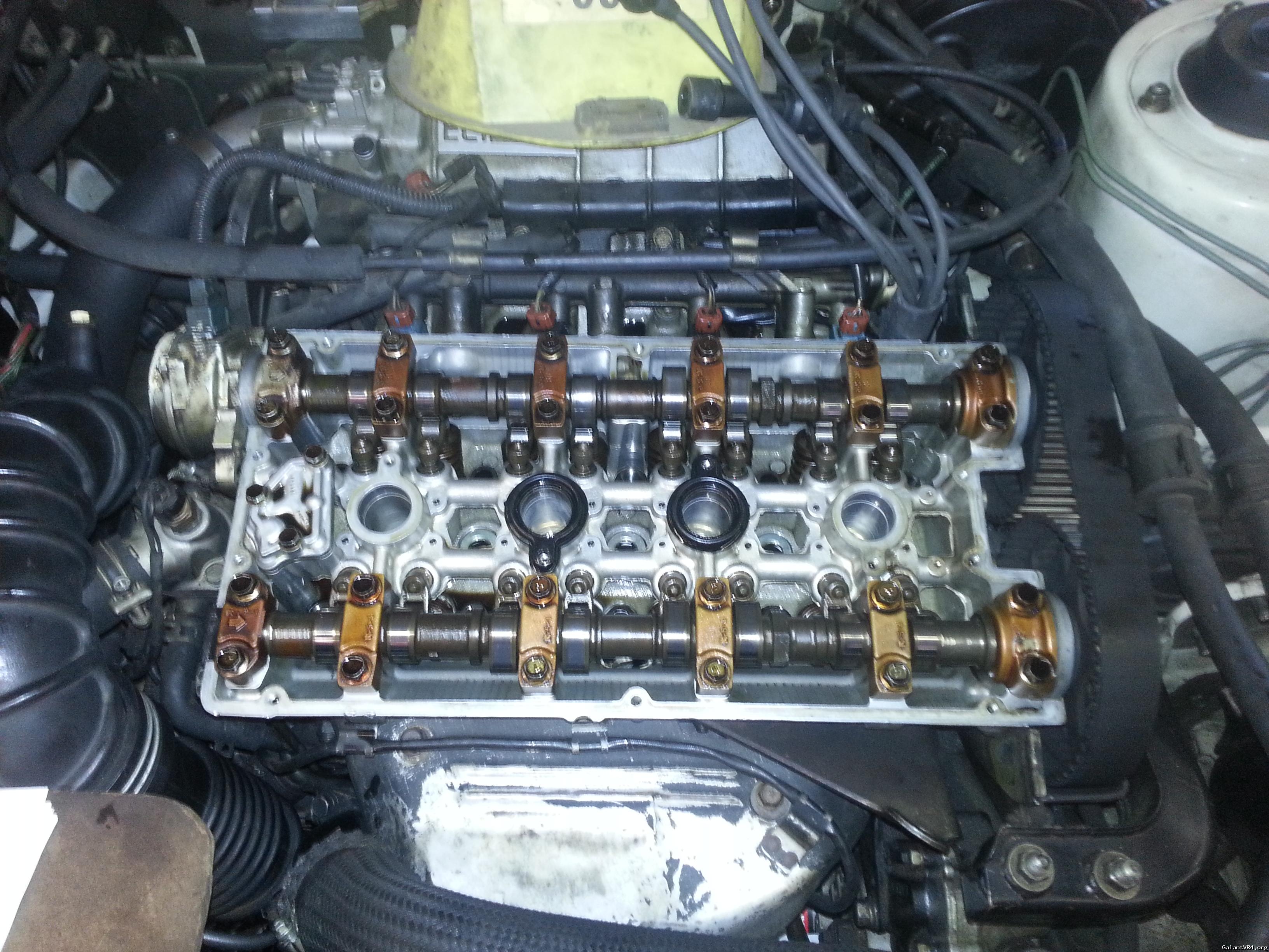

Today I was able to get a bit of time to remove the valve cover and inspect the valve retainers/locks. I confirmed that all of the locks are installed. I was very worried about it. It appears my head has been freshly rebuilt also. Upon obtaining the car one of the first things I noticed was how clean the head was compared to the block and intake manifold. Im not sure how long ago it was done but it looks to be fairly recent.

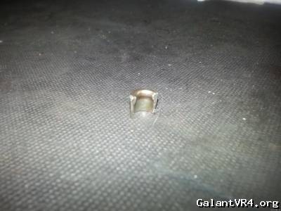

Here is the pesky lil guy I found in the oil pan when doing the rear main etc.
I am very relieved that all the locks are in place but at the same time im extremely curious how this ended up in the pan. Is this not a valve retainer lock? It sure looks like one to me.
So now she is almost ready to drive home. Just gotta do the timing belts and components, front wheel bearings and tie rods, align it and go take an emissions test. From there its a matter of getting the plates on and breaking in the clutch. Im so excited to drive my first vr4!
Not sure if it will be safe to rev with the b16g on a bone stock car but I should be able to drive her back and forth to work safely while I break in the clutch and work out the kinks.

It probably fell down one of the oil passages. They can be a pita when removing valve train parts manually while the head is on the block.

I just dont understand why someone would machine and clean the head up and then proceed to replace the guide seals with the head on the block. It was probably done earlier and they then realized it needed a head gasket or something.

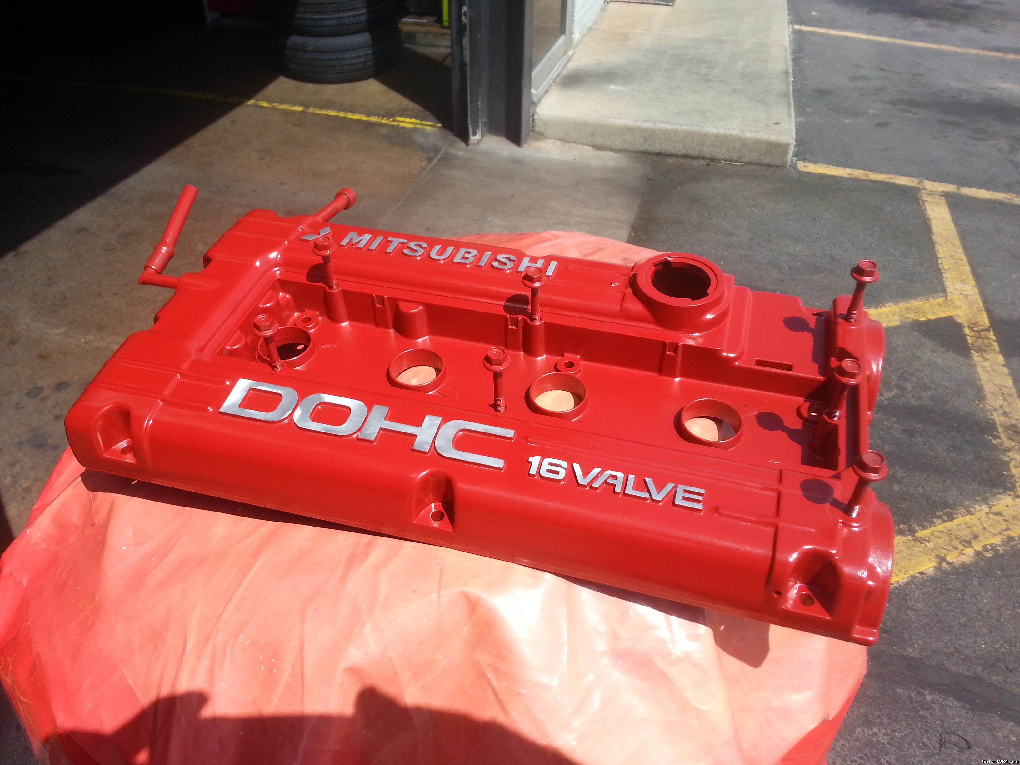

Painted the valve cover today. Came out ok. Clear coated it also.

It could have fell down 2 owners back. He may have replaced the valve seals or something.
